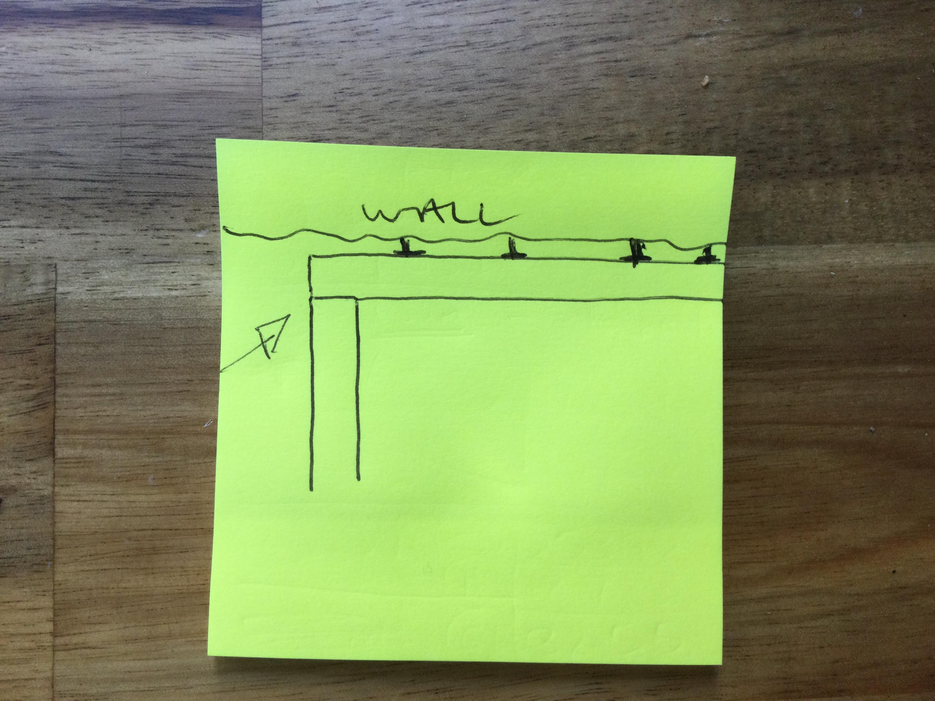

How do I fix these two outer timbers together at the back here?
Hangers will only go on one side. (I am cladding these outer sides with another 6x2 later so fix won't be seen)..

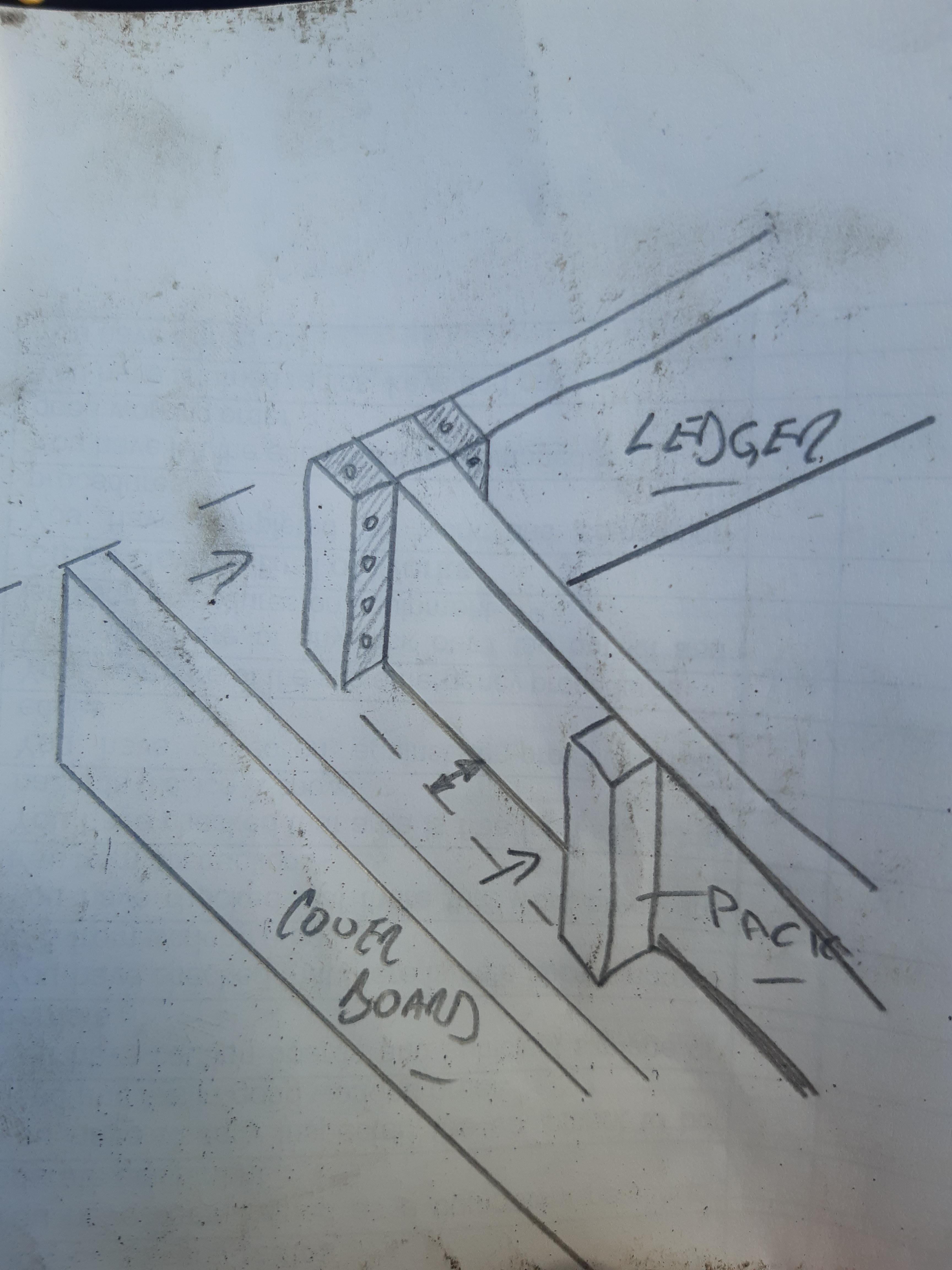

I'd just set the end ones in a bit and use another joist hanger. Much stronger detail that what you've drawn. Then add some "2x2" packs and face with another 6x2.

That's a good idea.. understood. The surity of the doubling of boards on the sides though.. might be a bit compromised? Id prefer them as my yellow drawing, if there's a way.
Could I bend the LH hanger wing back.. & fix to side of ledger?

If you have bought 6x6 posts, measure them and inset the first joist by the same amount. Then “sandwich” the post between this one and the new outer 6x2. Will be very strong as the post will be supported 3 sides.

Do what I sketched, don't have the outer 6x2 and skin the outer 3 sides with white upvc fascia instead?

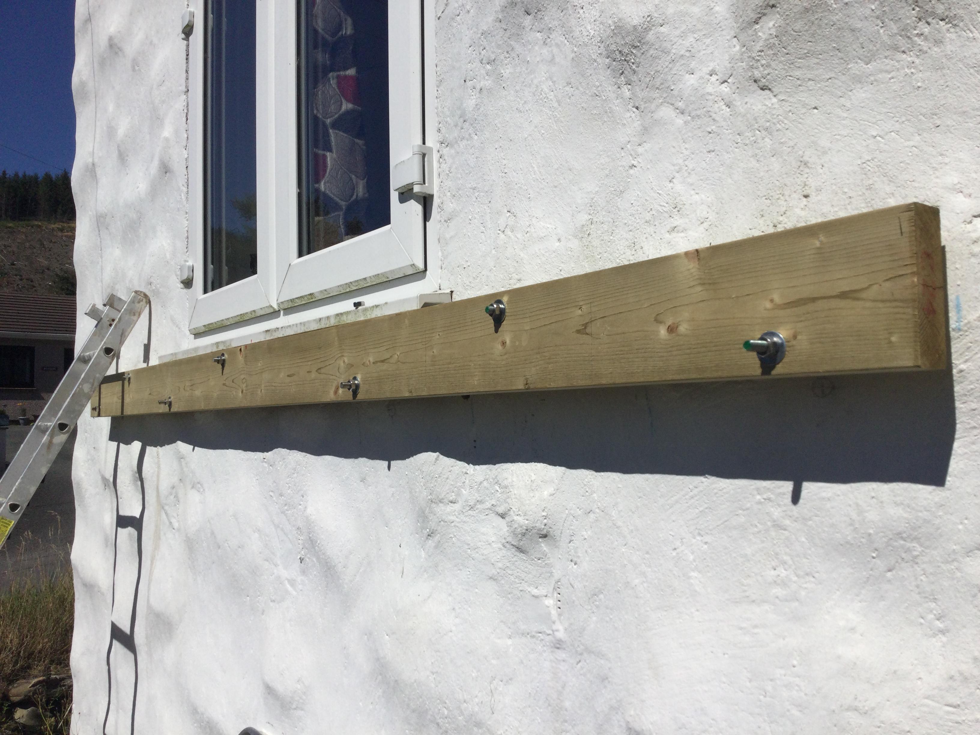

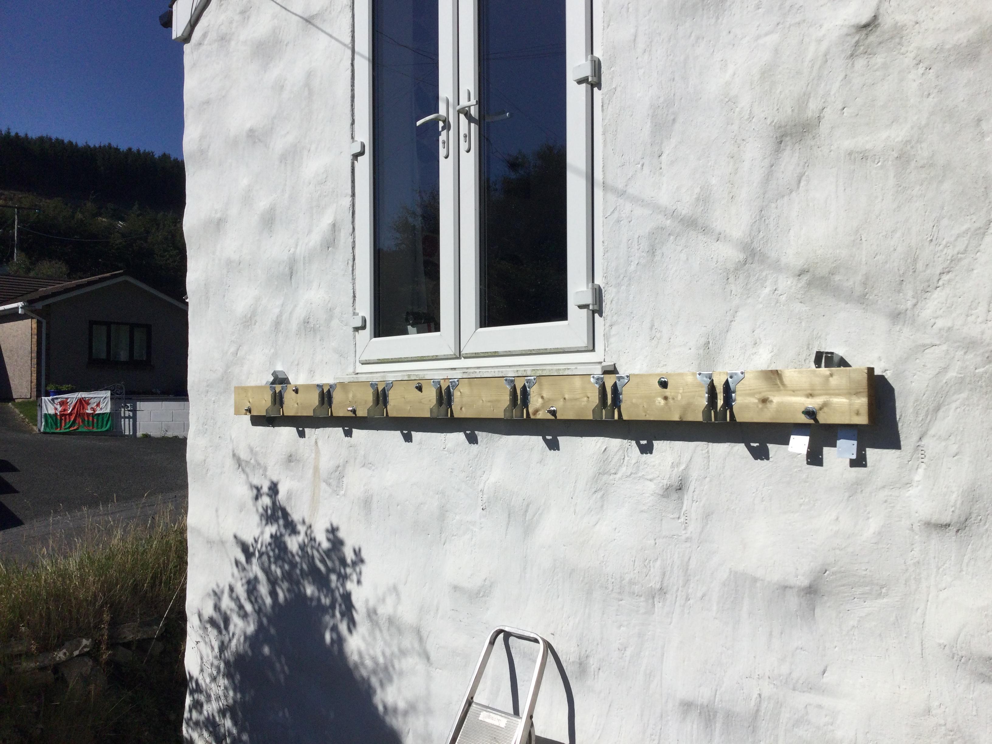

Offered up ledger to see what's what, tapped it once & stuck.. so had to continue. Alot of sledging to get on.
So good results, firm as hell. Level. RHS plumb, LHS slightly off. So I'll have to get joist hangers on like so.
Middle 3 joist hangers can't even fix to the ledger top tho.. cill in the way.

I'd still be worried about the 3 hangers under the cill not hooking over the top of the ledger. You might be able to skew a screw up from the bottom at 45deg or screw some neat plates up from underneath...
