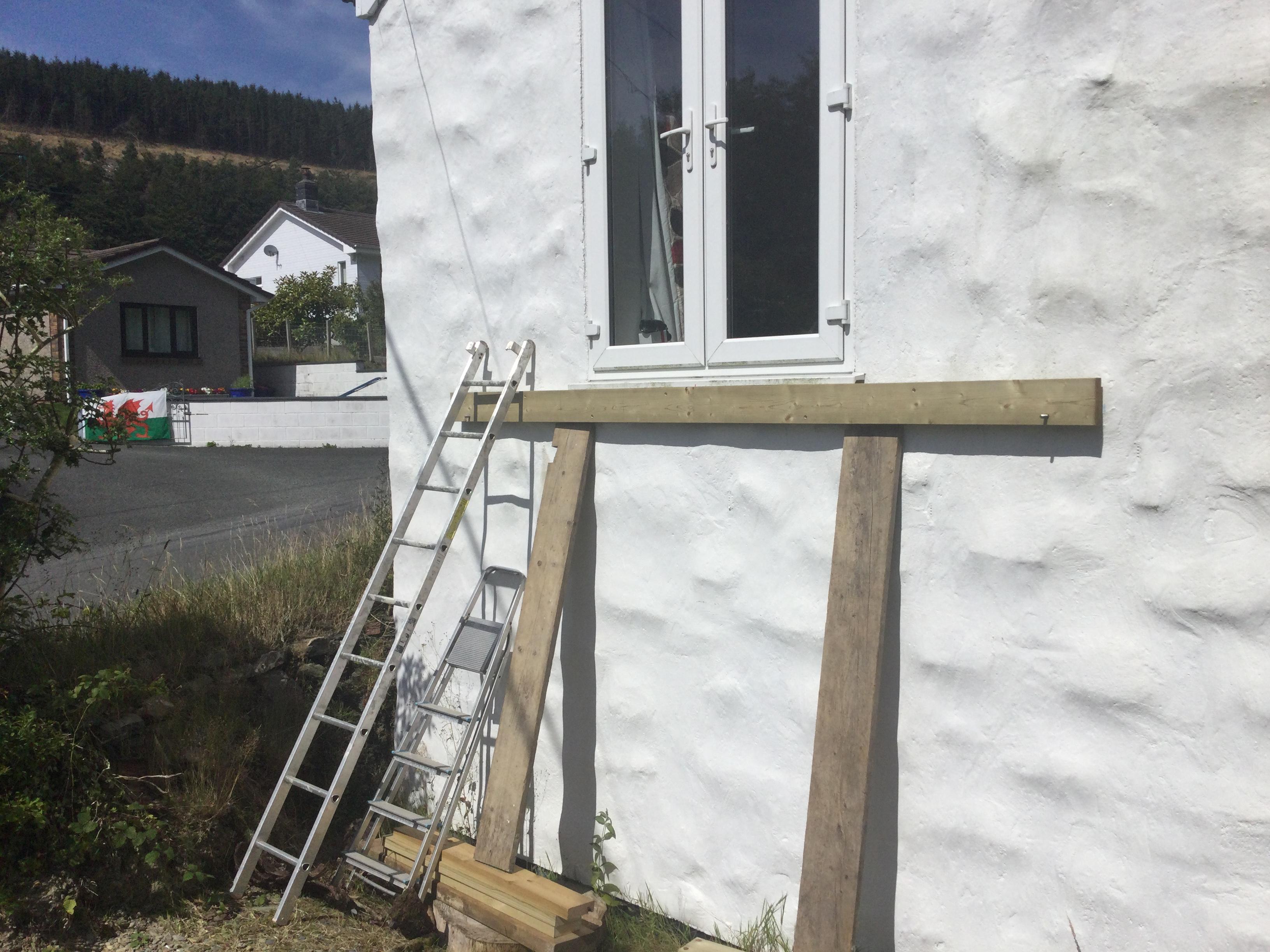

Chaps,
I think I'm set to fill my outer two holes & set the 200mm rods in with the fischer stuff.
What I need to know is how the rod can be centred, in the resin-filled hole, in order for it to set properly. Surely it'll sink down, being sticking out from the wall. Or the front extended 12mm's weight, will cause the front to dip down.
My concrete pads job, this was vertical rod.. so whatever I did to centre it within the resin filled hole, was made much easier.
Thanks, zh
Put the timber back in place and then set the rods, or push a small twig into the hole under the bolt to keep it level
Matchsticks or cocktail stick to help keep the studs level.
Put the smaller washer at the back of the tube if you want. I can't remember what it was for! 😂

@Onoff same fischer stuff as my cabin pads, you were right   ( i have a same red nozzle thing from that job/ matches this tube bought today).
As per that job tho, the fischer instructions are absurd. No idea at all. Ok I've brushed out hole, & vac'd it well. All set.
So can you remind me is it fill hole, twist rod in, offer timer up ( & wedge in place) put markc twig in place.. then wait for an hour? And then i can tighten a nut on? Seems remarkably soon to do so.
Thanks Zoothorn
@zoothorn if you are putting timber in place then no need to wedge the threaded rod unless it will always be seen so you need it looking perfect.
most chem fix will be hard in an hour to tighten nut (check on tube). If you are unsure, spin nut on finger tight, set all the other anchors then come back and tighten everything up after a day or so.

Ok do I A) fill my two holes, offer timber up, put rod through timber it & into wall? Then use a twig get it centred. IE forget the washer/ tube/ square washer between them for this.
Problem here, is once set the hardened squeezed out resin will inhibit the 1st washer sitting flat on the block.
Or B) just fill one hole, twist rod in, wipe off resin excess. No timber yet. Wait 1 hour, put washer/ tube/ sqaure washer on. Timber on LHS. Lift up RHS pivoting on this firm stud.
Prob with B is how do I get this rod to set & sticking out without drooping, bodging up my timber from getiing it level?

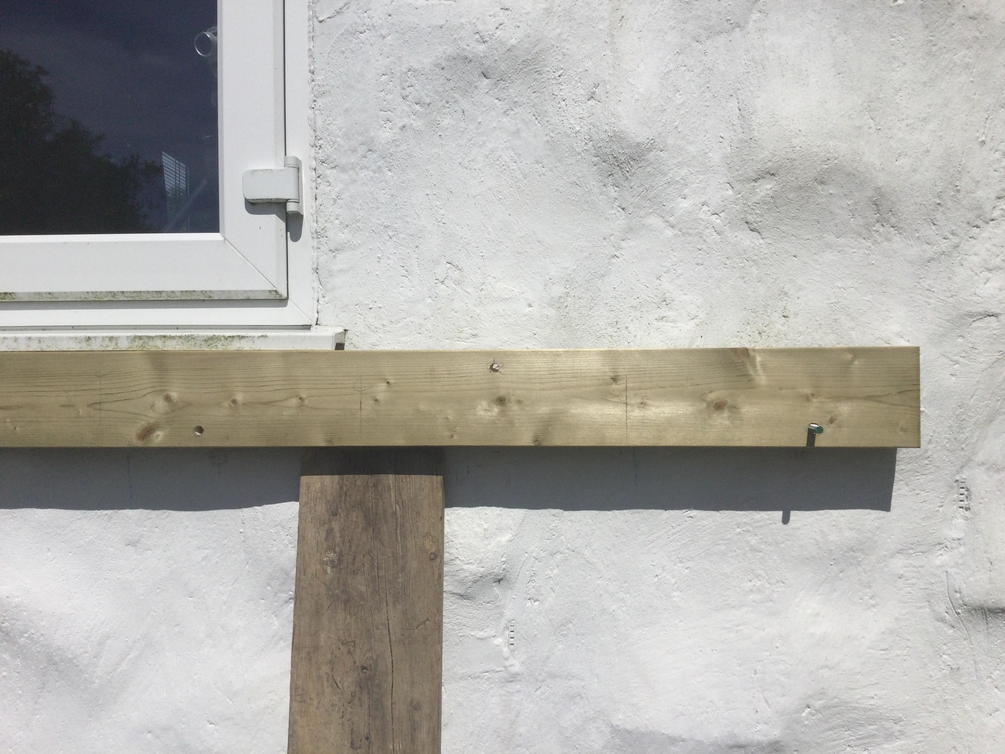

Thanks, got two studs in ok. Kept nozzle on.
Innevitably board slightly wrong positions tho- drilling perfectly  straight into wall.. was never gonna happen.
So. Ive got my ledger board 5mm too high ( its jammed underneath the doors sill: I had allowed a 5mm gap, but this has fkd off into ether then).
Can I enlarge my two 13mm timber outer holes, to a 16mm hole ok? Or even a 18mm hole? M12 stud.
I mean does it hamper these two fixings if two bigger timber outer holes? The timber will of course sit 'down' upon the tops of these 2 big holes, plus the other 5 holes are drilled at 13mm, I'll get these following 5 better aligned now the damn thing is actually up in place, albeit temporarily to mark their 5 places onto the wall spot on.
Thanks, zoot.
Edited by zoothorn
Yep fine - but pushing it up tight under the cill may be ok. How thick are your boards and how thick is the edge of the cill..??

Hi Peter I needed to enlarge both to unstick it from cill.. then LH one even more to 20mm, as I had it a bit off level.
Acceptably level now. Strewth taken me all morning just that.
I want rightup to cill ( bar 5mm safety gap/ now got) as Im scrimping for every inch in H of the balcony. The last consequence of the build a foot-too-low fiasco. Argh. It'll be stupidly low as it is you see. Head H the deck, from drive. Double argh.
You could glue in a round of timber, let it set and re-drill the hole(s).
Made a start though so 👍

4 hours to drill & prep two more holes. So got one more stud in.. then I go to use gun to fill hole no.4 ( 2 mins after filled & studded hole no.3).. & nozzle rock hard.
So. I've got to tomorrow: drill & prep holes 5,6,7. Then fill all in one go, & get washers in, then studs in & centred.. with one ( thank god) nozzle left.
The problem is prepping the front of the holes, so a flat (23mm) washer can sit within it. When I have only a 22mm flat  bit to do it with. And the render so thick & deep on a hump, I cant see what im doing well at all. Awful job.
Also, how do I get my top line of three tubes, level with the lower row of 4? The lower 4 Ive used a stringline. But Ineed to get these, plumb withthe top 3.
