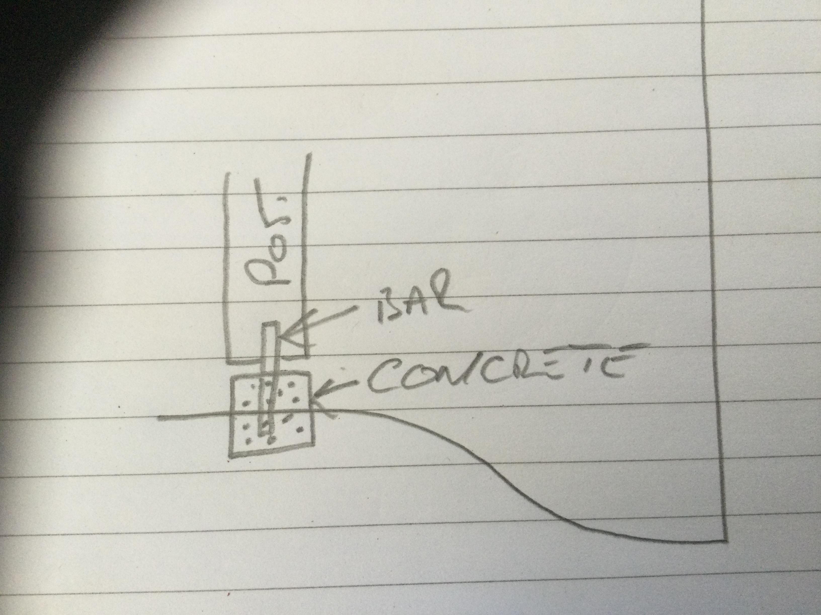

Zoot why don’t you build two concrete pads, into the ground and 100mm above ground level with a bit of bar sticking up, drill hole in the bottom of the post and it won’t move.

What he did, was have a 6" or so round concreted pad hard, with a rebar midpoint set into it, sticking up. Drilled a hole for it in centre btm of post. Etc.
Difference maybe thus; his has preset concrete pad, & I think your idea would be get both pillars set level & plumb.. & THEN maybe pour the concrete to set around the pillars spikes-?
Great help as always, zoot
Hi J.
This idea is as per my 'mericun youtube video. I think 2 things seem tricky tho?
1) how do I possibly get that pad, at exactly the right height prior to putting post on?
2) I have a galv shoe thing on my csbin pillar btms.. but seems to me like the bases will rot.. wouldn't this idea be the same?
3) I have the additional issue of where my red line is/ the base of the post ( in the photo above).. is above the ground: so I need to pour the concrete into something, which sits both in -&- sticks up/ out 80mm proud of the ground.
Thanks, zoot

Buy two cheap builders buckets, the 99p jobs, cut the bottom out with a jigsaw. Instant round pad formed.
Dig holes, check some rubble in the base and whack it down. Drop the bucket in and set it level. Fill with concrete. Cut the bucket off when set.

Bucket idea understood. Now Peter's original idea was a scaffold section, inserted in pillar base, & these two pillars then get into place & braced. Level, plumb etc. Then the concrete is put in to set around the pole. I think this was  the idea.
The scaffold pole tho, compared to a rebar, is alot more for me to try & do. How do I cut it, & where do even I source a 1/4 of a pole from? Etc.
The idea of J90's is simplest, & so maybe easiest for me. It tallies with my video clip. Certainly cheapest. Caveat being tho: the pillar sits in water, like my cabin pillars do in their shoes. I wonder if I can do this idea.. but have a standoff something between pillar & concrete?

No need to worry about height of concrete pad as long as it’s above the 70mm you are short of. (Why I said 100mm) Bung the post on top and cut it off where necessary to match the rest of the platform! The shoe is a great idea, stops the post rotting in the ground.

Better to have timber, even  if temporary wet they can dry out in between, in the ground they are permanently damp..
