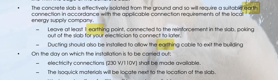

Hi,
Can anyone who has built an insulated raft foundation tell me what exactly they bought to attach to the reinforcement mesh to earth the slab?
Any links to products to buy or photos would be great as I'm going to need to have the right thing for next week.

@PeterW Yes its 250 EPS and then a 200mm structural slab with 2 layers of reinforcement, the manufacturer suggested an earth tale(not sure if that was typo and he means earth tape) and a spare duct next to it poppingup in the plant room but could someone whoes done an insulated raft explain how they did this and what they used exactly

Isoquick mentions earthing the slab in their tech spec.
First electrician I engaged thought it was pointless but told me to fix an earth rod to the rebar coming up in the plant room. Second electrician saw the rod and cut it off
As above we had an Isoquick insulated slab installed and they left an earthing tab which the electrician said wasn't needed so we cut it off.

It just advices this earthing the reinforecement mesh
in the isoquick guidance, i spoke to my electrician in a brief call as he was on holiday in Lanzerote and he said this is total overkill
Did anybody with a raft foundation do this?? please send advice and insulated raft people
