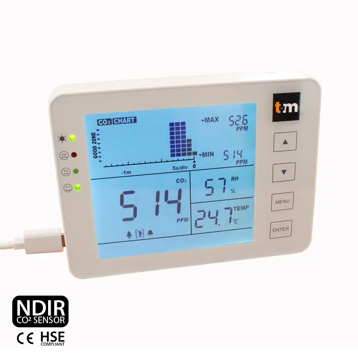

joe90 Posted April 9, 2017 Share Posted April 9, 2017 I still think that the MVHR should be run like a heating system, the thermostat tells the heating when it's needed, I.e.sensors ( co and RH) switch the MVHR on when it's needed, or manually over ride it when you decide. I think I have been told the co sensor is expensive. ( I too like having windows open in summer and can't see the reason for using electricity ( even if a small amount) when it's not required. Also the whole unit will last longer, not need servicing as much if used less. 2 Link to comment Share on other sites More sharing options...
Jeremy Harris Posted April 9, 2017 Share Posted April 9, 2017 Non-Dispersive Infra Red (NDIR) CO2 sensors (the very reliable and accurate ones) are around £80 - £100. I have a few that I bought for around £20 each, that were surplus, sold off when a building monitor manufacturer went bust, that I use to monitor the house CO2 level 24/7, with the data logged to a USB stick. It would be easy to add a system to switch the MVHR on and off, but I can't really see any benefit for us. For most of the year (like now) we generate far more electricity than we use, and we get paid the same whether we use it or not, so the few tens of watts the MVHR uses makes no difference at all during the day, and at night the chances are we'd want the MVHR on anyway. Link to comment Share on other sites More sharing options...
