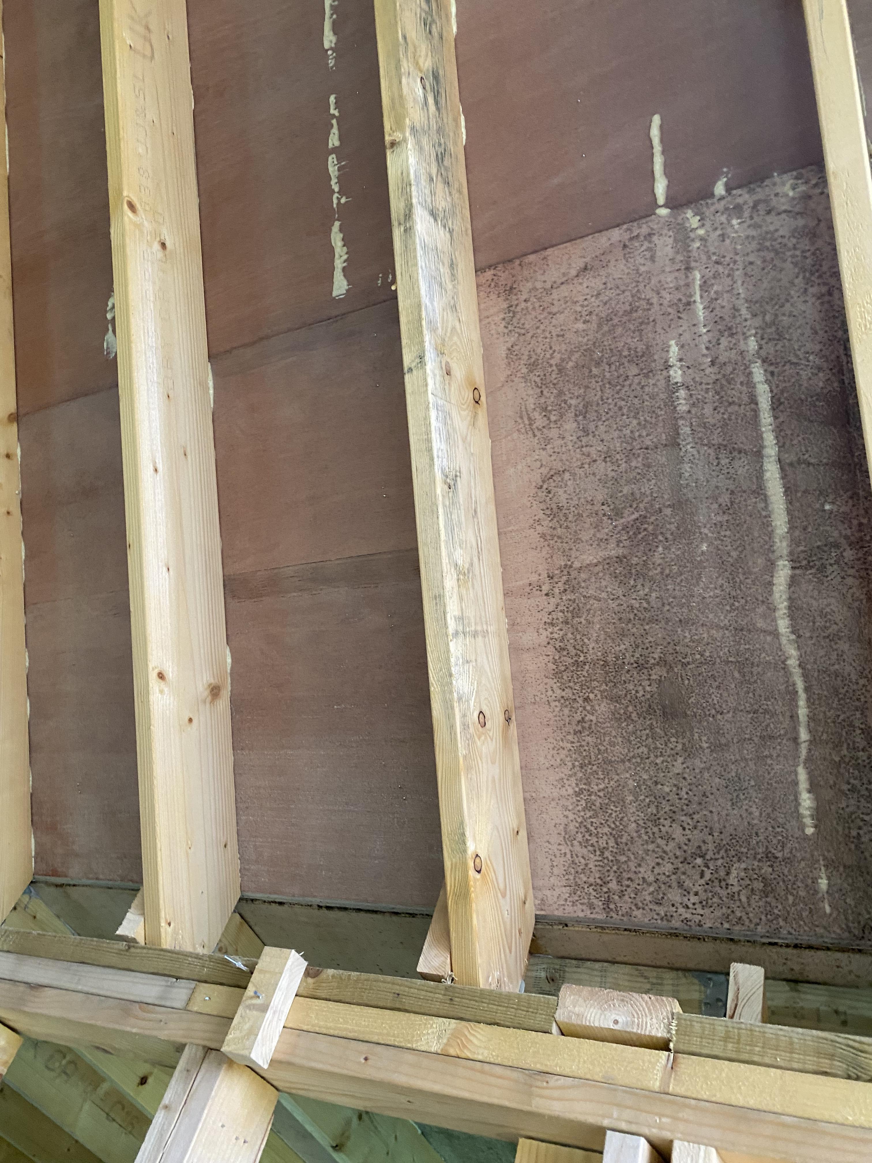

Mildew all over plywood walls
46 minutes ago, SteamyTea said:
Just need to find an offcut of clean ply, char one side and leave in a shed.
good idea. We have a blowtorch here and some ply that has stayed unaffected. I’ll do a controlled test - one Japanese charred and one not. See what happens!
However, for my workshop, I don’t favour the “had a fire” look, so will be trying the zissner paint first.

Reading this topic with interest as we are having a similar issue with exterior ply boards which were fitted to our roof a few months ago.
we have no windows nor doors yet and there has been a fair bit of moisture in, the south facing roof pitch is unaffected and it isn’t all boards.
I don’t have the option to remove as the roof is on so I’ll need to clean then treat I think.
any suggested products would be appreciated.
many thanks.
All of our ply in the basement got mildew within days. The sheets I picked up from the builders merchants the other day came pre applied with mould.... For whatever reason mildew and fungal mould love cheap softwood ply.  It'll stop growing once heating is one and humidity drops.
My recent experience of ply boards used in a building project.....
Expensive sheets of graded marine ply from a dedicated Timber yard = no problems with mould, even with the scrap off-cuts left outside!
Cheaper sheets of ply from a Builders merchants  = mildrew and fungal mould appeared at the slightest sign of cold or damp in the air.

Has no one tried blow torching to slightly char the surface yet.
I haven’t yet tried this, no, but will be down there in a fortnight so will give the experiment a go.
On 09/01/2022 at 21:39, TonyT said:
Spray bleach onto it?
We have washed one of the ply panels with a strong bleach solution and it did clean it up a bit. But we have left the rest for now as we had other more pressing tasks to get done. Once the workshop is complete we will wash all of the walls with bleach (we dissolved lots of tesco bleach tablets in water to make a strong solution) then will paint with anti mould paint.
Driving up to Bucks and Down to Cornwall all the time now, quite happy to deviate to yours and set fire to it.

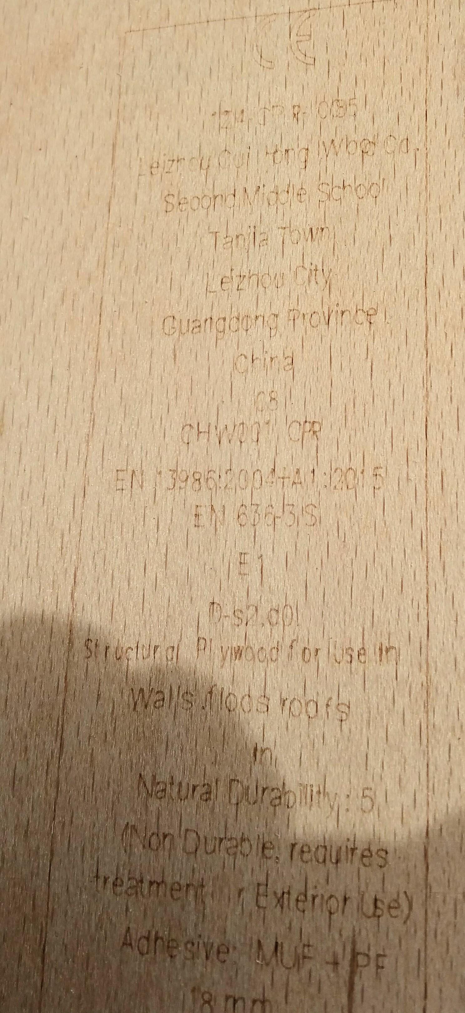

I don't think it matters whether you use osb or ply. It can be easy to assume from this thread that all ply is the same. It isn't. A decent quality sheathing plywood will be fine for the life of the building. The problem is that there is some real rubbish out there supplied from builders merchants that don't have a clue about the timber they're selling and people want cheap, cheap, cheap. Any timber product, including osb will deteriorated if moisture levels are too high. My suspicion re the mould in the OP is that there has been condensation on the plywood due to natural humidity fluctuations and this has fed natural sugars in the timber, plus there have been some spores from old furniture that have added to the problem. Once the moisture levels in the building settle down and the sugars in the wood have been consumed there will be no more growth.
If your SE has designed the TF with sheathing, then yes. But basically all timber frames need some form of racking resistance. This is supplied using either diagonal studs at required intervals within the frame, or you use plywood/osb.

20 hours ago, Radian said:
Second Middle School? WTF China???
All part of the Chinese long game. Our houses made from their cheap crap wood will fall apart. We'll have to spend more on them buying tools and materials made in China!
1 hour ago, saveasteading said:
There's a thought.... a lot of our timber, and not usually the best,  comes from Russia. Not any longer!
I worked with a few timber merchants (building for them) and heard some bad stories about bundles of timber with rubbish and barked lengths hidden in the middle, coming from Russia and deliberately packed to conceal illegal bits.
I've had some cheap Chinese hardwood ply that was full of voids. Possibly okay for basic sheathing purposes, but not nice to work with. I was also at a merchants recently to buy a particular grade of ply. When I checked, the product they wanted to sell me only had 6 plys and obvious voids whereas the product I was asking for had 7 plys and much less visible voids. They even had another pallet of the 7 ply stuff but refused to open it for me and refused to accept it was a different product. So off I went and spent my money elsewhere...
