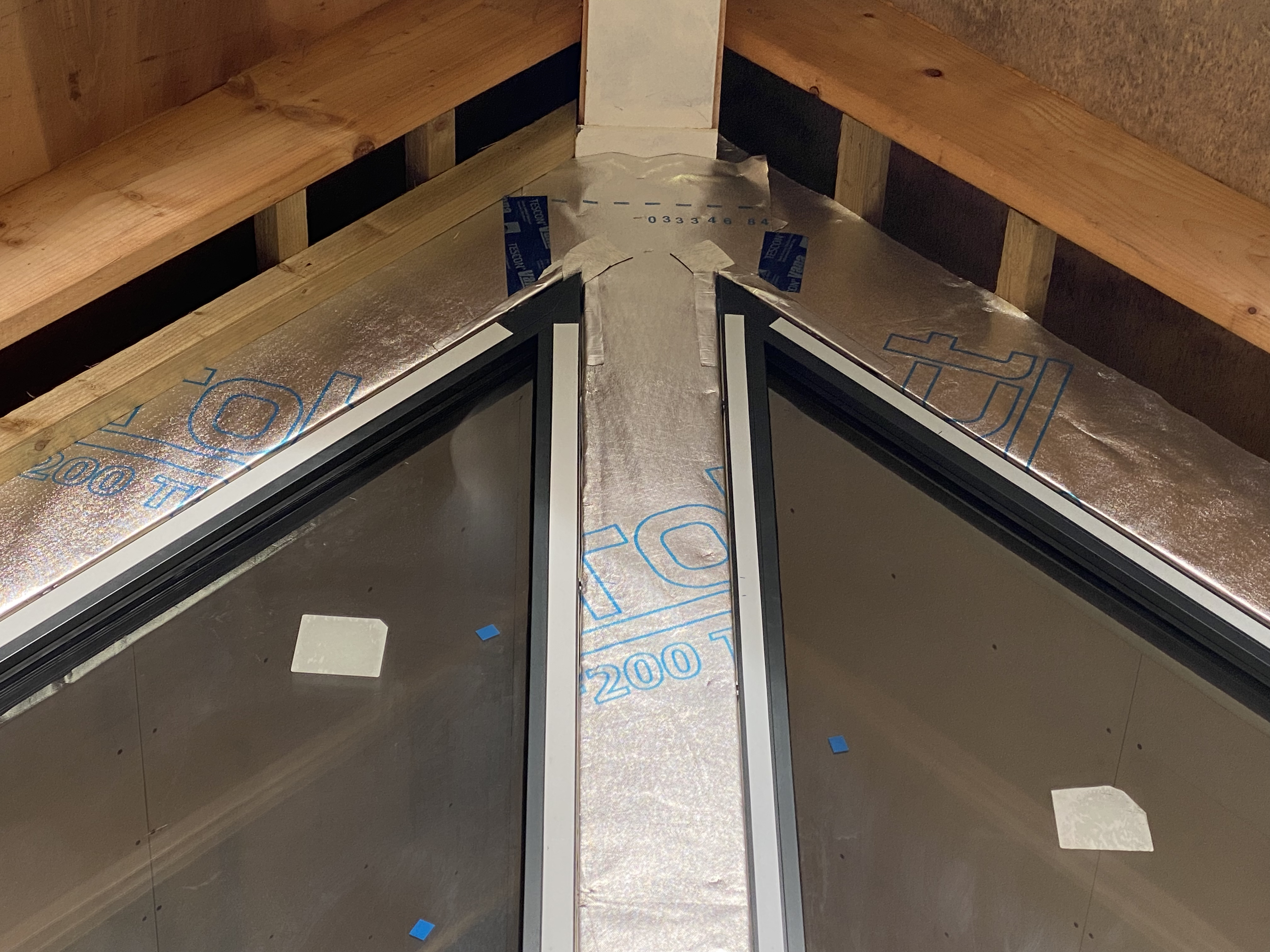

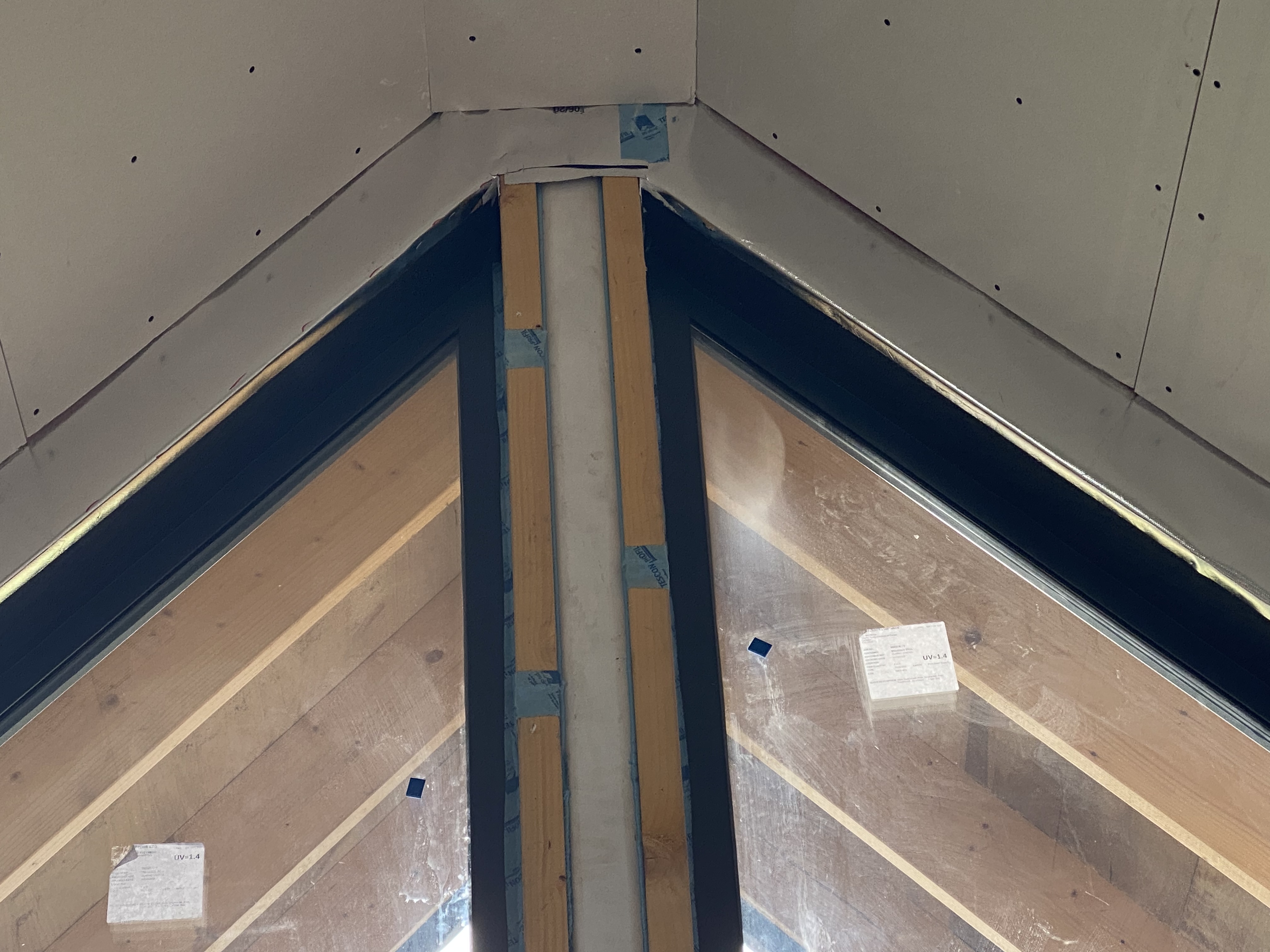

Hi all, we have not long had our windows (triple glazed alu) installed. I was present at the time to help with some of the lifting and shifting and it was all done very carefully with a scissor lift. All four shaped windows had what looked like mist in them in a very small part of the top corner which has now gone. (Inside the unit) This morning it came back fractionally when the sun came up. The installer (who did not supply the windows) said he had seen it before and it had cleared, my concern is obviously that the unit(s) are blown - I have seen this before but it looks different to this and it’s not condensation drops. I wondered if it’s because it’s very cold here and there are no doors and not all windows in yet, so inside is as cold as outside! Any thoughts before I hit the manufacturer on Monday?! Thanks
Hi, there are probably better off the shelf products. Do you have a sketch or pictures of the build up? something like Alutrix or Sigawetguard sound more suited. what’s the next layer over that?
Hi folks, Our triangular shaped windows were fitted at the weekend and I helped in this process due to the weight and size - they are in the gable end above bifolds. I mentioned that the beads are on the outside where normally I have seen them inside before. They are triple glazed aluminium by Aluk. The installer said that the weather seal was in the beads, the windows were marked and the drain holes were to the front! They look great and I’m happy but would be reassured to hear this is (or is not) normal!? Thanks
