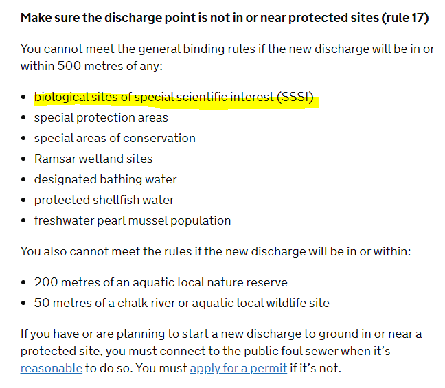

2 hours ago, Dave and Helen said:
As the output is less than two cubic metres, I don't believe I need a permit from the Environment Agency, but if I do then we can apply.
The limit is 5m³ discharge a day. As long as you meet the general binding rules, you do not require a permit from EA to discharge from a small treatment plant to a watercourse (in England).
https://www.gov.uk/guidance/general-binding-rules-small-sewage-discharge-to-a-surface-water
and
2 hours ago, Sue B said:
...We will need a permit as we are within 400m of a SSSI.  ...
@Sue B, where is that requirement  to be found, please? I've mis-read the GBRs perhaps?
The reason I ask is that you'd have to have a huge house and as many bedroom as Blenheim Palace  to get to 5 cubic meters a day..... So whats the scientific logic behind the requirement?
Link to comment
Share on other sites
There possibly isn't a lot of logic. Much like abstractions  they set a fairly arbitrary (albeit with some basis) threshold in order to manage their workload.

1 hour ago, Russell griffiths said:
...  My treatment plant will discharge into a pond  I have constructed, which sits right slap bang in the middle of my site, which the whole site is a SSSI.  So work that out. ...
Which is exactly why I asked what the scientific rationale is for the requirements in relation to SSIs. None, it would seem. Maybe the requirement is about volume of discharge....?
A simple explanatory sentence in the guidance would clarify the matter. (Hmmm, I wonder....)
