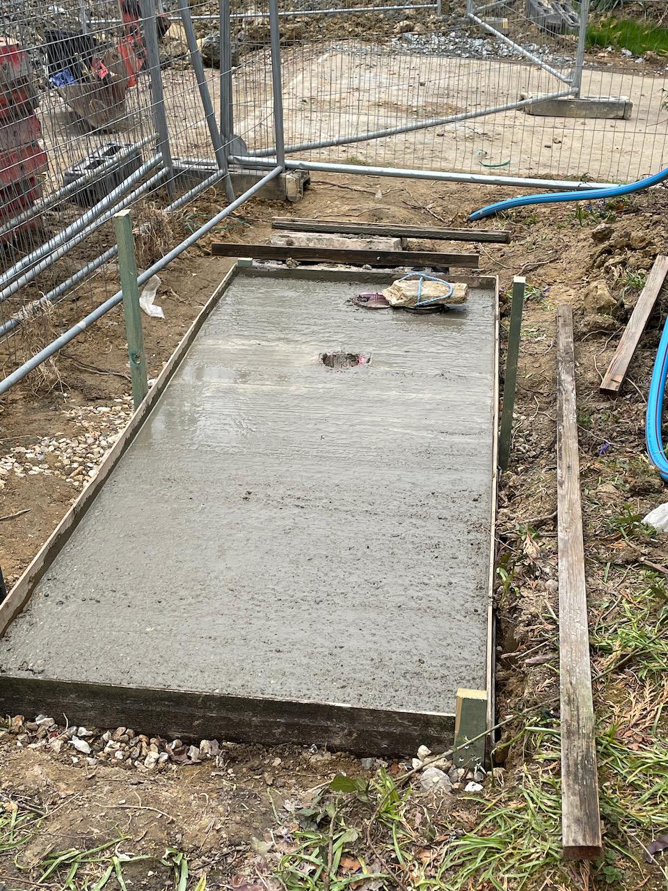

Thorfun Posted May 9, 2021 Share Posted May 9, 2021 Today I learnt to lay a slab. it's my first one and not a very important slab as it's just to house the GRP electricity kiosk from CCF Fibreglass and a couple of wheelie bins. it was about 0.2m3 and I mixed approximately 1 part cement to 6 parts sand/ballast pre-mix with some water by hand in a wheelbarrow and then tamped it down to get a rough but level-ish finish. There are 3 x 150mm ducts in the slab for the electricity supply in, out to the house and out to the STP which is nearby so these got in the way of getting a nice tampered finish but, all things considered, I'm very happy with what I've achieved today and think I did an alright job for something that I really didn't care how good it looks. I'll have another one to do to house the ASHP further down the line which I'm sure will be better. what did anyone else learn to do today? 6 Link to comment Share on other sites More sharing options...

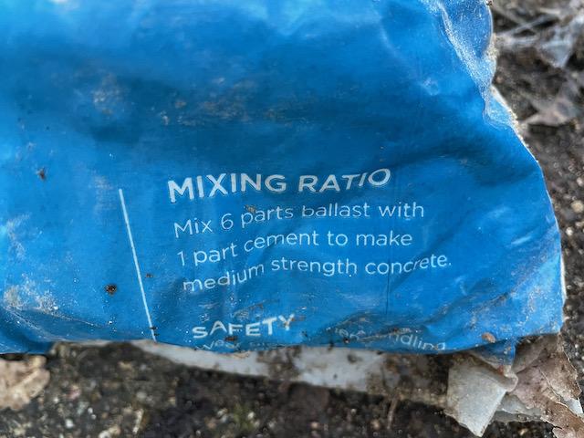

scottishjohn Posted June 10, 2021 Share Posted June 10, 2021 very weak mix for concrete 6-1 with ballast!! looking at the cement bag it says 4-1 with ballast mix maybe not a big deal with that size for a grp box --but bear in mind its something like a foundation for a wall Link to comment Share on other sites More sharing options...
Thorfun Posted June 10, 2021 Author Share Posted June 10, 2021 4 hours ago, scottishjohn said: very weak mix for concrete 6-1 with ballast!! looking at the cement bag it says 4-1 with ballast mix maybe not a big deal with that size for a grp box --but bear in mind its something like a foundation for a wall interesting you say that as you're right that the cement bag says 4-1 with ballast mix but the ballast bag says 6-1. so I just made it up as I went along. like you say, it's just a light weight GRP box. Link to comment Share on other sites More sharing options...
scottishjohn Posted June 10, 2021 Share Posted June 10, 2021 (edited) 1 hour ago, Thorfun said: interesting you say that as you're right that the cement bag says 4-1 with ballast mix but the ballast bag says 6-1. so I just made it up as I went along. like you say, it's just a light weight GRP box. so you went for the cheap choice - as the cement is the active part in the mix--and the people that would get sued --then I believe the cement bag mix is correct . more cement will give you a better finish if you float the next one Edited June 10, 2021 by scottishjohn Link to comment Share on other sites More sharing options...
Dave Jones Posted June 11, 2021 Share Posted June 11, 2021 On 09/05/2021 at 16:50, Thorfun said: Today I learnt to lay a slab. it's my first one and not a very important slab as it's just to house the GRP electricity kiosk from CCF Fibreglass and a couple of wheelie bins. it was about 0.2m3 and I mixed approximately 1 part cement to 6 parts sand/ballast pre-mix with some water by hand in a wheelbarrow and then tamped it down to get a rough but level-ish finish. There are 3 x 150mm ducts in the slab for the electricity supply in, out to the house and out to the STP which is nearby so these got in the way of getting a nice tampered finish but, all things considered, I'm very happy with what I've achieved today and think I did an alright job for something that I really didn't care how good it looks. I'll have another one to do to house the ASHP further down the line which I'm sure will be better. what did anyone else learn to do today? looks good! A cheap float to make a nice finish, if you have a multitool tape it to a length of 2x2 or 4x2 to use as a handle then screw another piece on the end the width of your pad. The vibration will make the conc come up lovely. Wait a bit till its sets a little and the water comes to top. 1 Link to comment Share on other sites More sharing options...
