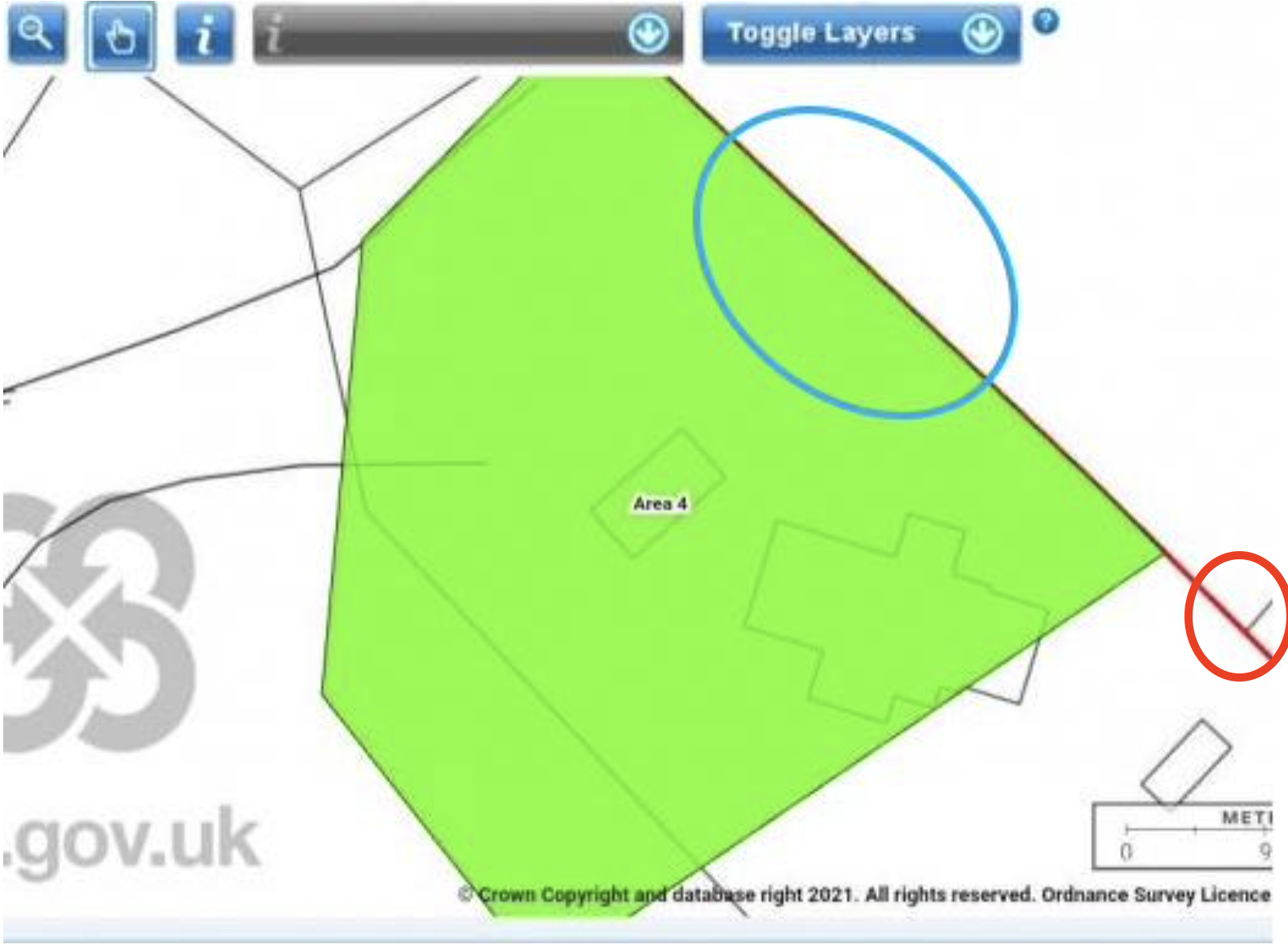

Highland girl Posted February 3, 2021 Author Share Posted February 3, 2021 51 minutes ago, pdf27 said: Just to confirm - is the image above the one showing what you own, i.e. the one with the land registry? The maps are all inconsistent with each other. IF this is the correct map, then we have a good datum on the ground for where your land starts - the corner of the boundary with the other house marked (2). Note that the green area marked on the croft map is inconsistent with this because the corner does not match the boundary shown - the discrepancy is something like 10m scaling off the 51.3m length marked. Yes this is the drawing the architect done and he has marked 51.3m and the green drawing is what is on the land registry the figure of 51.3m does not come down as far as archtect indicated. Link to comment Share on other sites More sharing options...

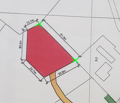

pdf27 Posted February 3, 2021 Share Posted February 3, 2021 (edited) 18 minutes ago, Highland girl said: Yes this is the drawing the architect done and he has marked 51.3m and the green drawing is what is on the land registry the figure of 51.3m does not come down as far as archtect indicated. What is the distance on the ground along that boundary between the two features? What does the deed say - does it have a measured map in it, for example saying that your land boundary is 51.3m long, on a bearing of 135° true from datum A, or does it relate to features on the ground. The green drawing is from the croft registry, taken from land registry data, correct? For something like this I wouldn't rely on it being absolutely accurate. They use OS data, and their published root mean square error in rural zones is <±2.8m (https://www.gov.uk/government/publications/land-registry-plans-the-basis-of-land-registry-applications/land-registry-plans-the-basis-of-land-registry-plans-practice-guide-40-supplement-1 : 99% confidence interval is <±5.8m). Given that the discrepancy between the map and your boundary is only 4m, the map by itself is insufficient to prove with certainty where your land ends - on the north side you've got it running along what is marked up as a fence/wall or something like that which gives you a good datum. However the south boundary is hanging in the air so you could potentially be anywhere from 2m inside the line to 10m over it based on the map alone. Edited February 3, 2021 by pdf27 Link to comment Share on other sites More sharing options...

Highland girl Posted February 4, 2021 Author Share Posted February 4, 2021 It is the green map that has been decorated they went on the written measurements that the architect wrote on the red map his drawing and measurement at back differ.The title deed is the same as green map. Link to comment Share on other sites More sharing options...

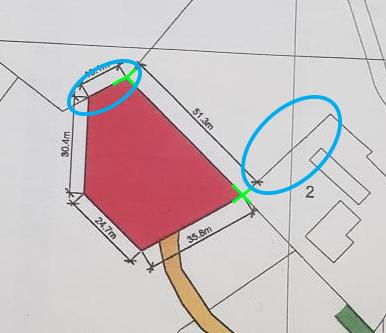

Temp Posted February 4, 2021 Share Posted February 4, 2021 (edited) My guess is he intended to gift the land on the red map and this somehow got messed up when it was measured and sent to the land registry. The reason I say this is because it shows the right hand boundary running between between two "features" which look like field boundaries or boundaries with other plots of land. Whatever they are they appear on both red and green maps. I think it very unlikely that he deliberately intended your plot to start "51.3m from the top right corner" unless there is another feature at that point that is not shown on any maps. Why not 51.3m from the bottom right corner? It is much more likely he intended it to run between these two points and the plot was measured incorrectly. If you measure between these two points now is actually 61.3m rather than 51.3m ? This also explains why he hasn't noticed a problem. Your house is still above where he thinks the boundary is even if it is in slightly the wrong place. Edited February 4, 2021 by Temp 1 Link to comment Share on other sites More sharing options...
ToughButterCup Posted February 4, 2021 Share Posted February 4, 2021 20 minutes ago, Temp said: ... I think it very unlikely that he deliberately intended your plot to start "51.3m from the top right corner" unless there is another feature at that point that is not shown on any maps. ... @Temp's post got me thinking. Are the two lines with a blue elipse round them fence lines? Or clearly visible features on the ground? Because if they are, then that would explain the 51.3meter measure. Link to comment Share on other sites More sharing options...

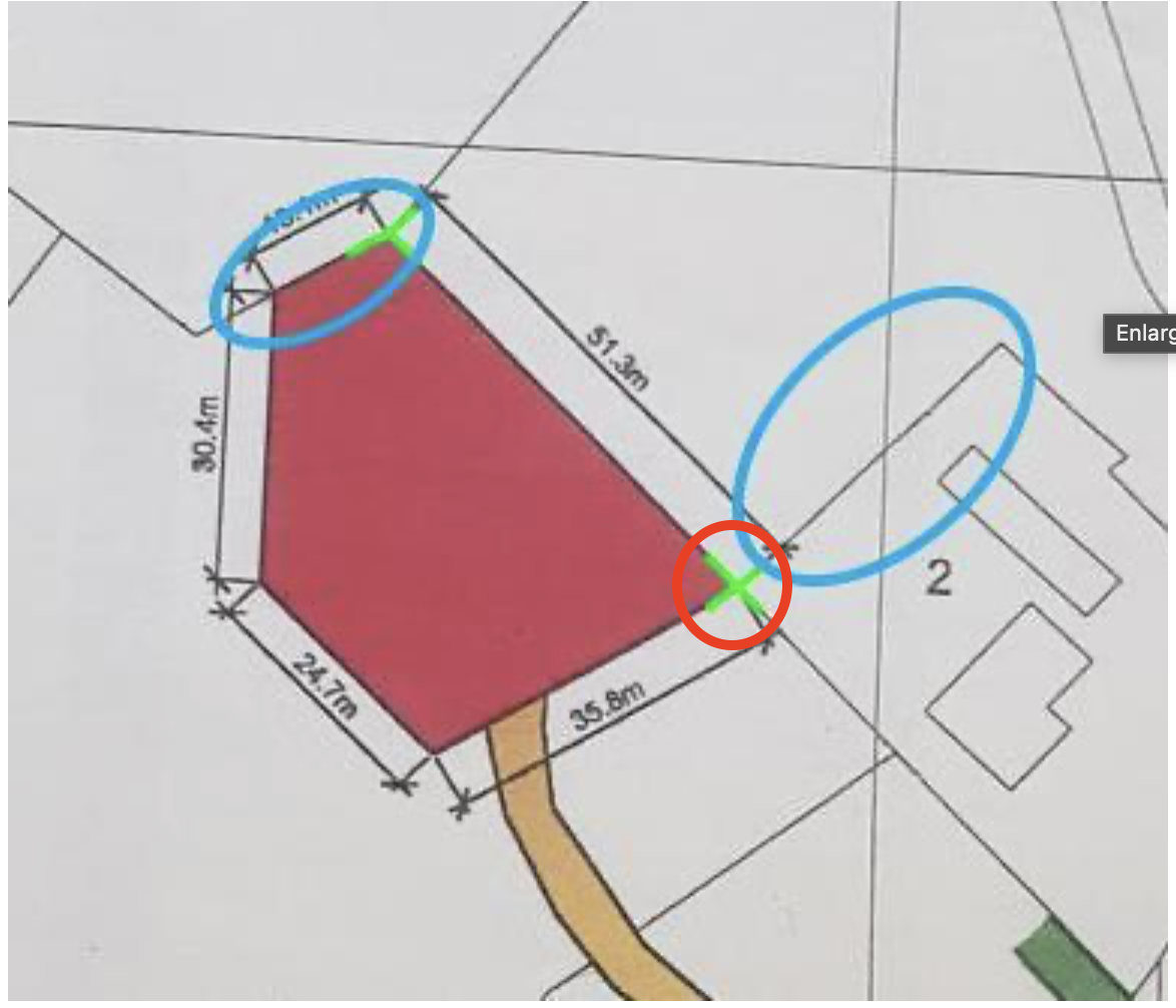

ToughButterCup Posted February 5, 2021 Share Posted February 5, 2021 (edited) Ok, this is starting to get interesting This image is on the title deeds and this is image is the land gifted to you. Comparing the two is difficult at this remove. So, a question........ And I'm guessing here, is the line indicated by the blue elipse below the same line as the one marked 51.3m above? (PS, not one of the elipses) Edited February 5, 2021 by ToughButterCup Link to comment Share on other sites More sharing options...
epsilonGreedy Posted February 5, 2021 Share Posted February 5, 2021 18 hours ago, Temp said: If you measure between these two points now is actually 61.3m rather than 51.3m ? This is excellent news. If the red mapped area is the original offer from the farmer that @Highland girlaccepted, then she just has to persuade other conveyancing professionals to accept they mis transcribed 61.3m to 51.3m then tell'em to sort it out. 1 Link to comment Share on other sites More sharing options...

Temp Posted February 5, 2021 Share Posted February 5, 2021 2 hours ago, epsilonGreedy said: This is excellent news. If the red mapped area is the original offer from the farmer that @Highland girlaccepted, then she just has to persuade other conveyancing professionals to accept they mis transcribed 61.3m to 51.3m then tell'em to sort it out. Don't get carried away, I was asking _if_ there had been a measuring error. Not stating there was one. Link to comment Share on other sites More sharing options...

ProDave Posted February 5, 2021 Share Posted February 5, 2021 I keep reading this and I keep coming back to the RED map the boundary lines up with the fence line of property "2" If that is what was actually intended and you have documents to prove that is what was offered then it appears to be a conveyancing mistake. your problem is the "vendor" no longer appears to be supporting that position and not prepared to agree that is what he intended? 1 Link to comment Share on other sites More sharing options...
Thorfun Posted February 5, 2021 Share Posted February 5, 2021 so the line I've circled with red on this plan that's from the land registry: sure looks like the fence line circled red on this map that you said shows what was gifted to you: so, if that is the case, then that looks to me like the land registry map is wrong when compared to what was gifted to you. I don't know how to resolve that but I'd be checking the fence line to see if it is the case and then seeking legal advice as to how to rectify. 4 Link to comment Share on other sites More sharing options...
