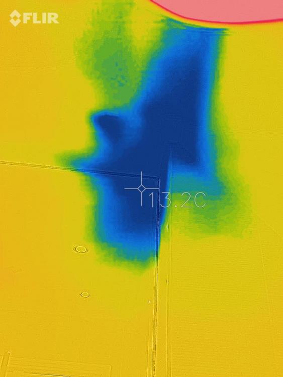

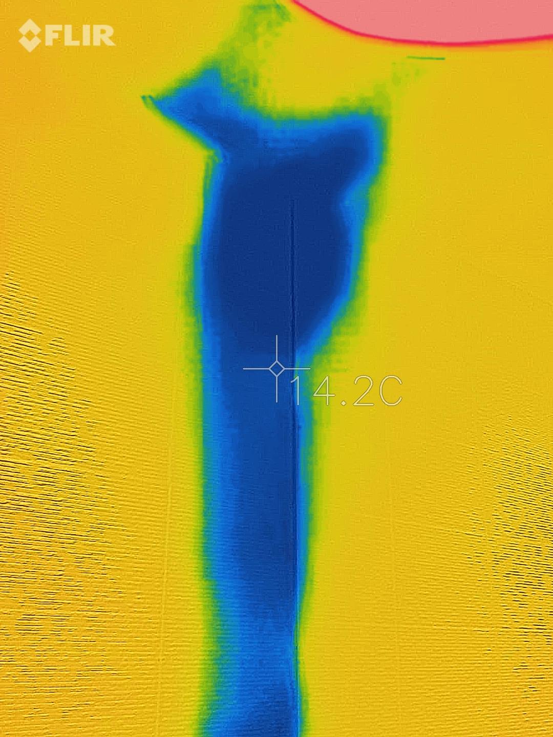

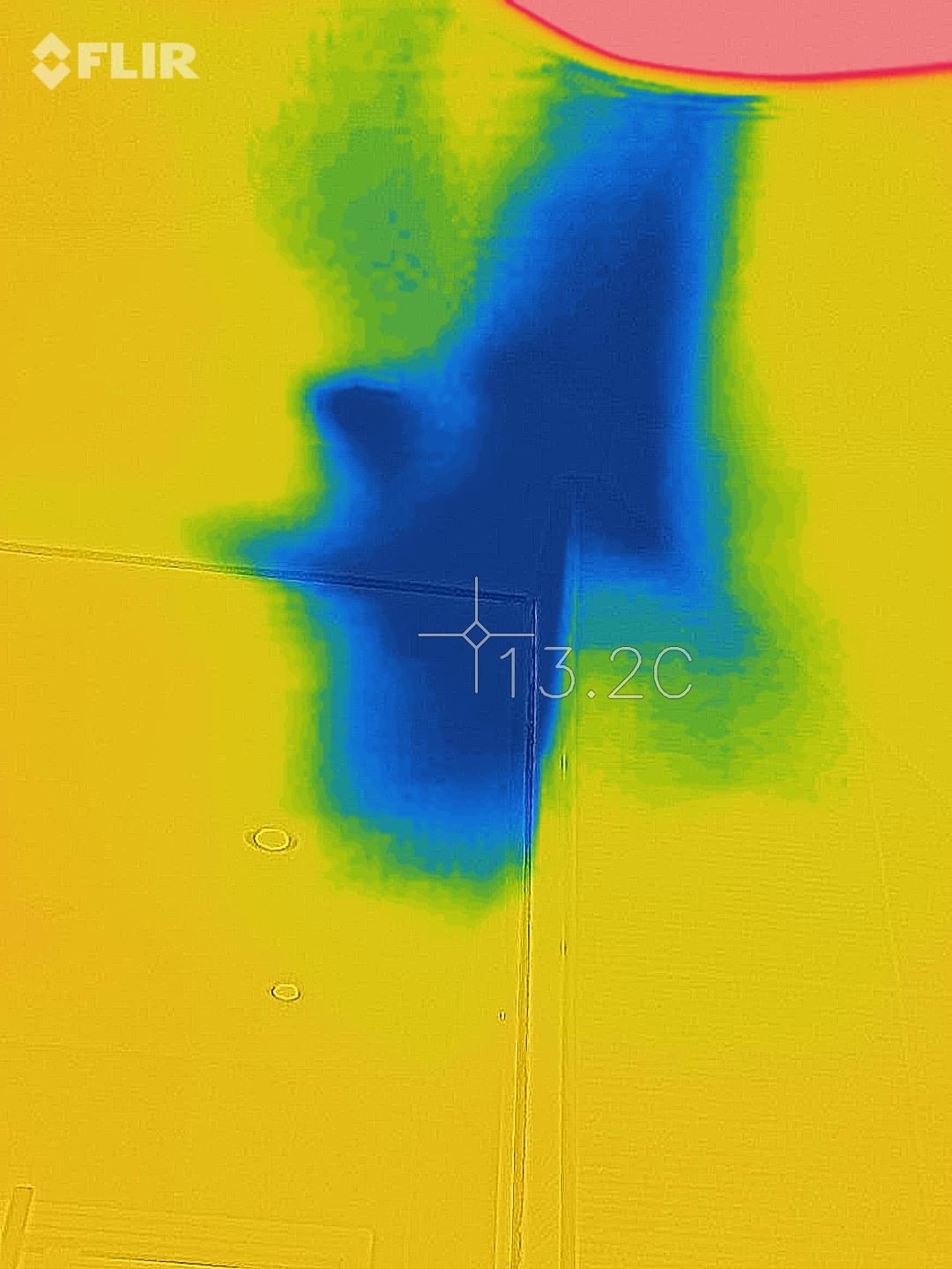

A few things surprised me. The walls with stacks  in them got very cold. After he left I check in the loft and the holes in the ceiling were not sealed. They go into a small area of cold loft. The insulation covered them and the loft is not ventilated so I can’t usually feel any air movement up there. But once we depressurised the house air was flowing and getting pulled in around the pipes. I can easily seal this.
We also found one gap I had missed sealing in the eaves where there was a gale blowing.

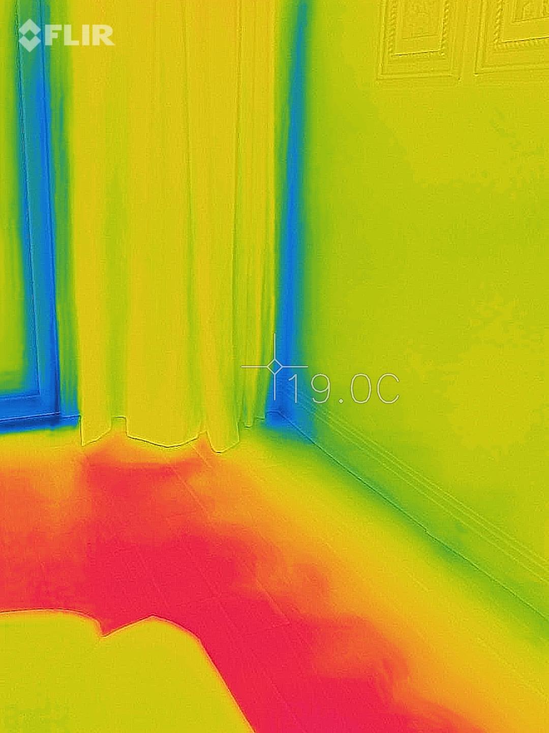

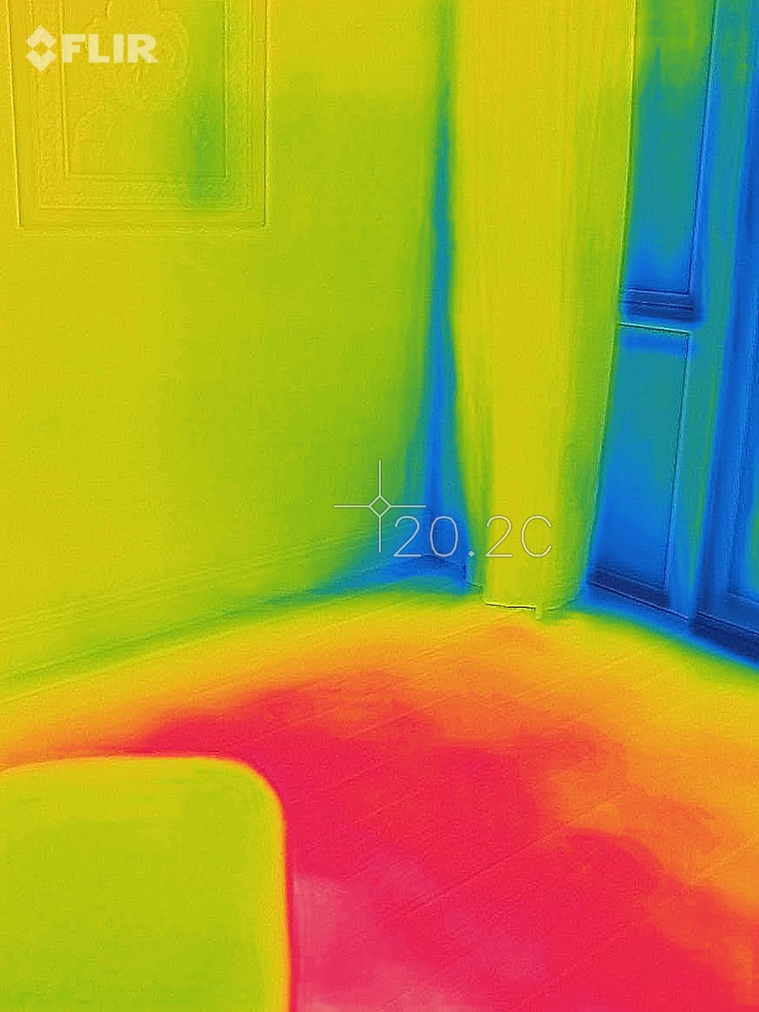

The other surprising thing is that we have wooden floors upstairs. When we moved in I checked everywhere for draughts. They were only in a couple of places and I sealed them. But again with the house depressurised it drew cold air through the join in loads of places there has never been an issue.
The last big issue I think is two small areas of cold loft off our bedroom. I have been in one of these areas and it is the only place in the house where the top of the cavity is exposed and you can feel wind in the loft. I wonder if air was being drawn through the cavity then into walls and roof spaces connected to these areas. It might have accounted for a massive amount of the rest result. I will speak to the architect on Monday but I suspect that the top of these cavities should be closed irrespective of the impact on the test result.

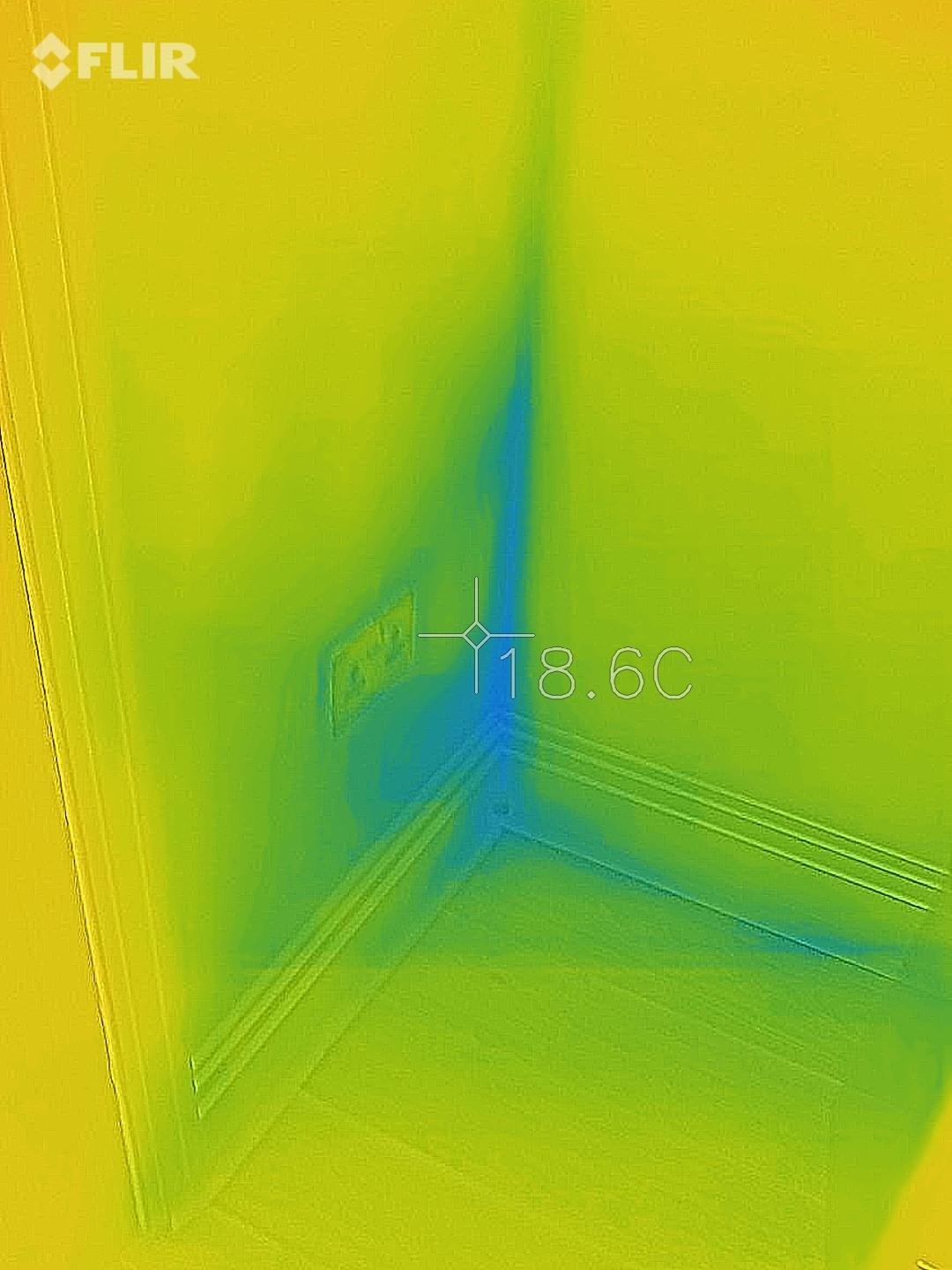

I will seal the stacks up next week and will have to mastic the skirting to the wooden floors which I had suspected would need done. But I think I need to get those cavities closed, annoyingly there is no access to one of the two areas.

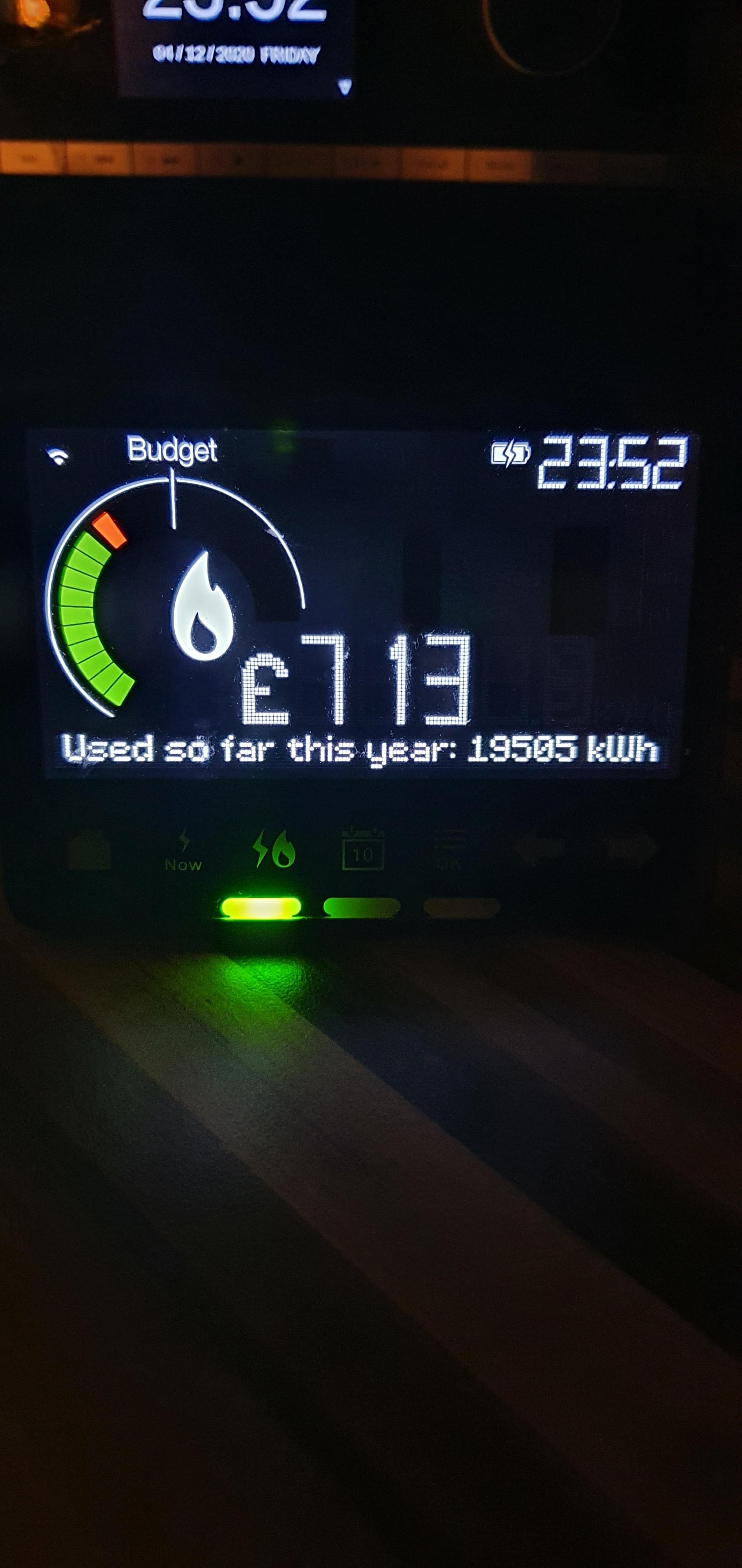

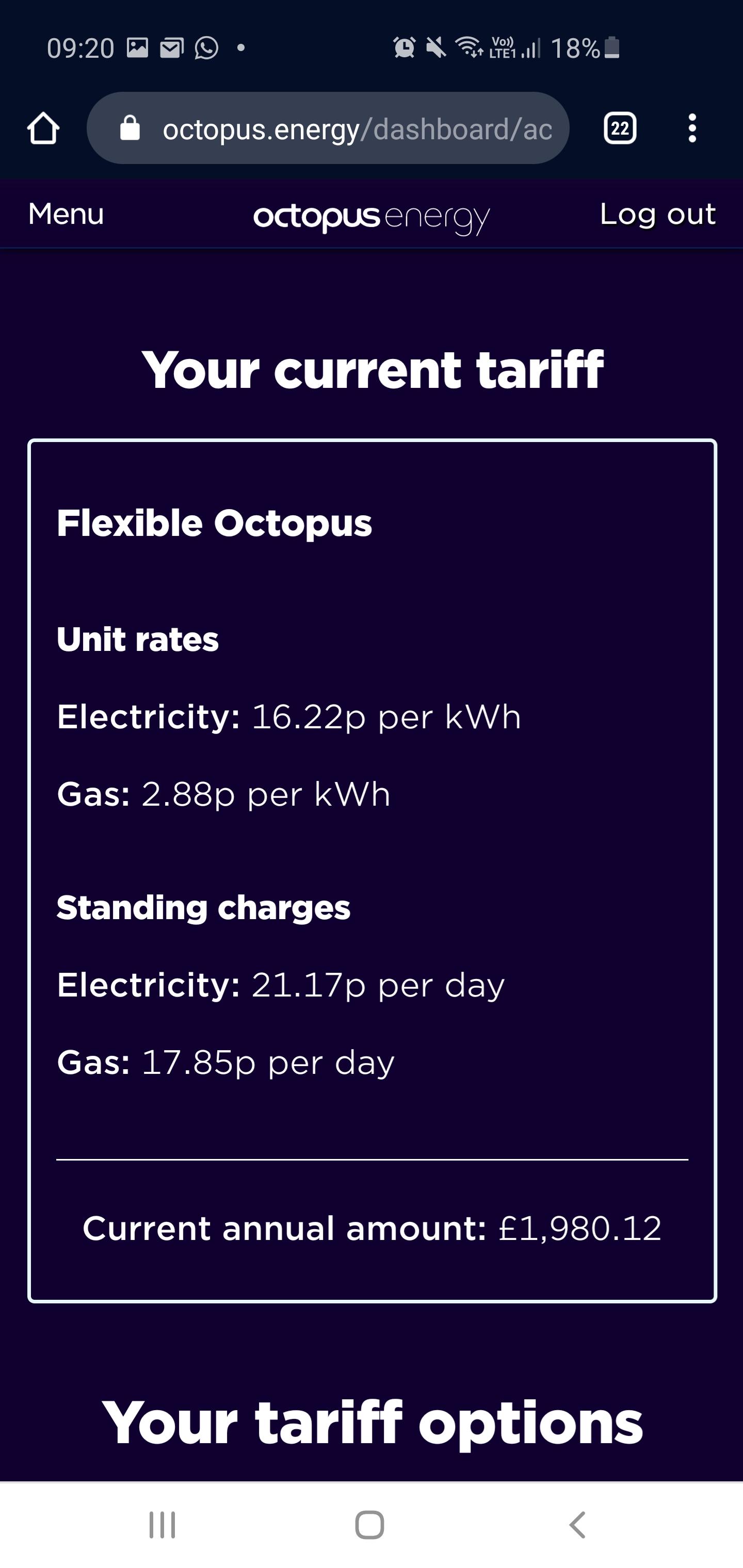

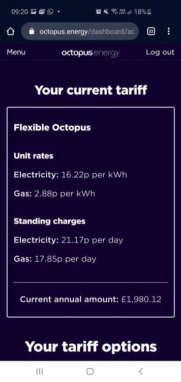

Also - cost for gas seems off...I just checked my meter and got the following...and I'm with octopus.
Thanks @SuperJohnG just woken up by a second round of the "thundersnow"
Yes, the house is big, it is just under 900sq metres, so the heating bill is very low for its size. We considered buying an old stone built house in Edinburgh before we built this and they were coming out at roughly 6x as much to heat for what were smaller houses.
I just renewed my gas at 2.1419p per kWh. Is your system updated with your actual cost of gas, as you are coming out a 3.655p which would be crazy high? Most of the best deals for gas are less than 2.5p per kWh. TBF when gas is this cheap it doesn't necessarily pay to have your house as energy efficient as possible.

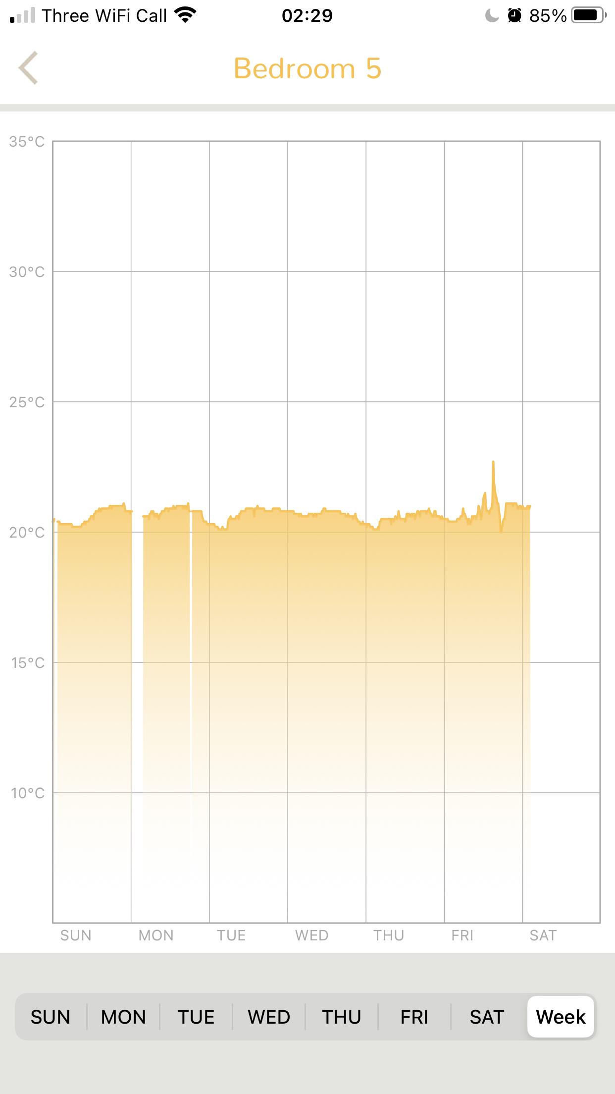

A good example os the two spare south facing bedrooms. The heating is never on in these rooms and the temperature never really varies. In fact I can attach the Heatmiser charts for these rooms where you can see the temperature stays in a steady 0.5C range. The warmer room does have a eating manifold in the cupboard which provided a bit of heat. In both rooms when the blower was on you could feel cold air being sucked in under the skirting board. It was a nice cold night so easy to feel. Normally I have never felt this and it seems to have no impact on the temperature, but you can see what happened in one of the rooms where the temperature dropped during the test. Where the pipework comes up through the floor to the manifold, a hole has been made in the slab and it was very draughty, so I will get it sealed.

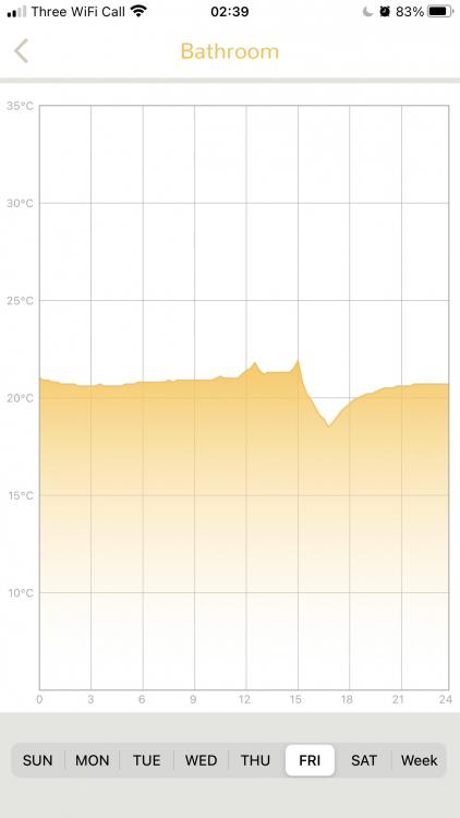

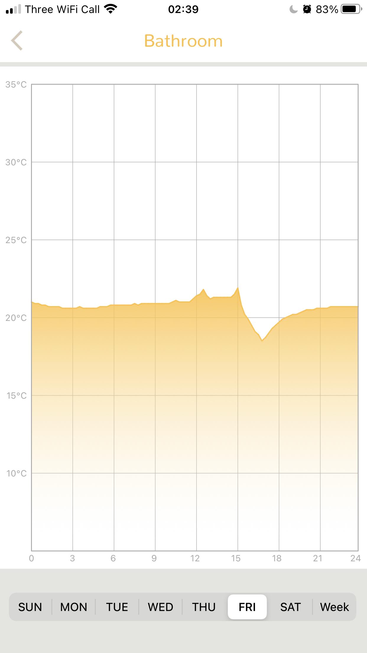

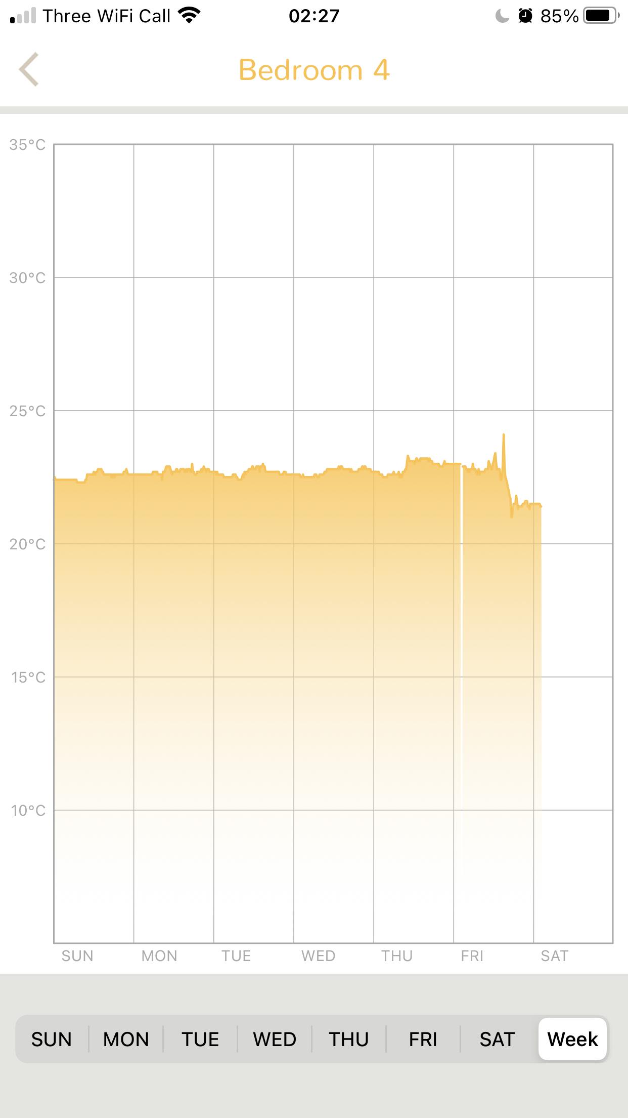

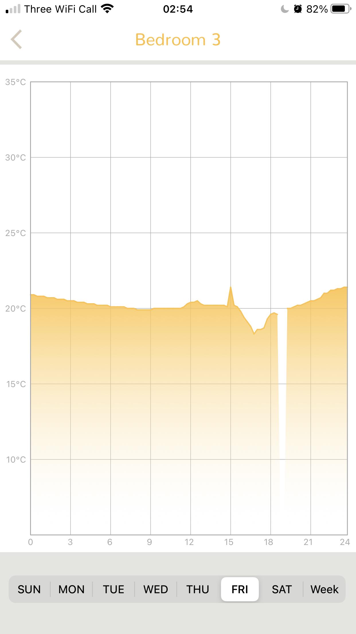

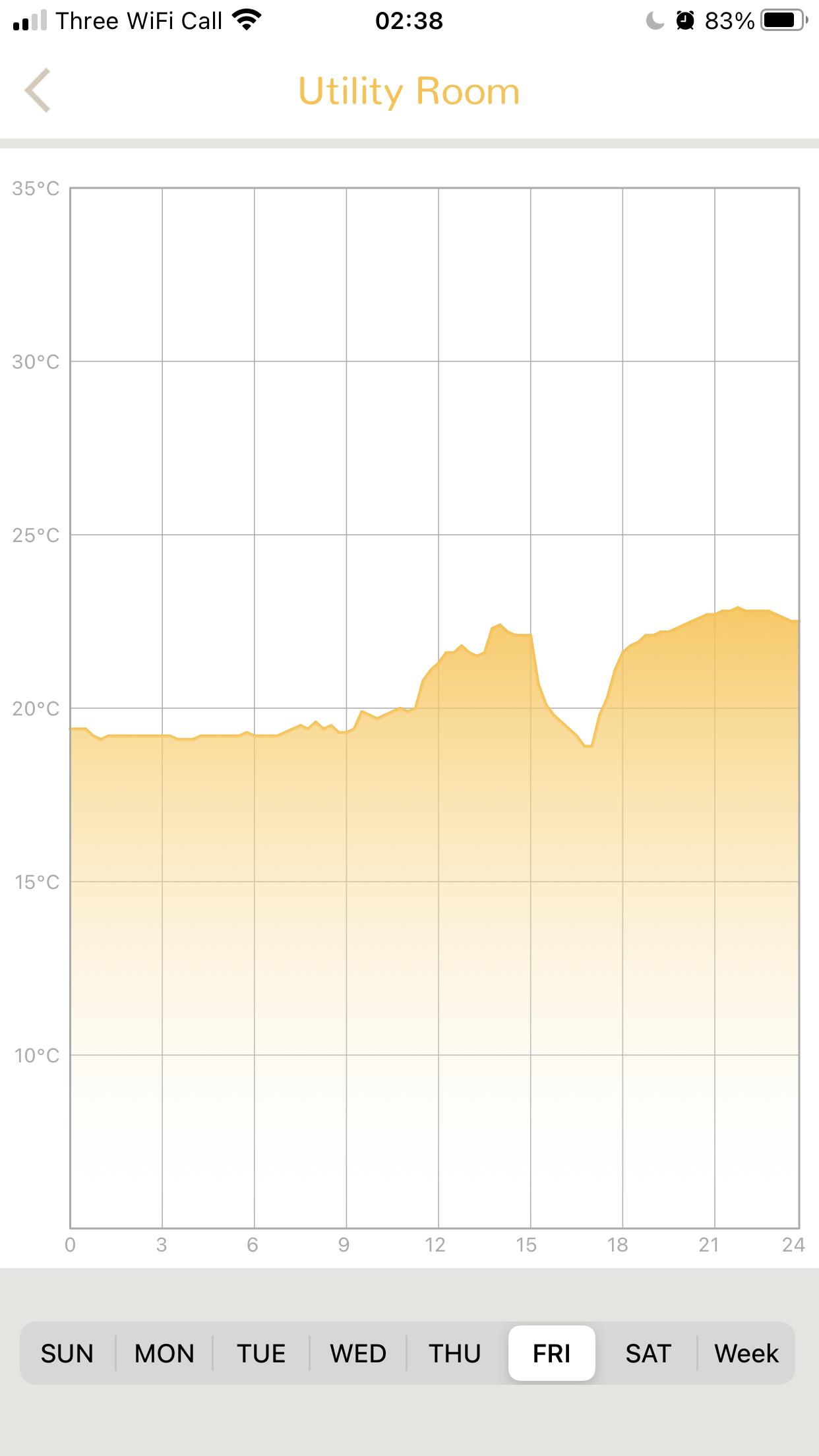

Actually this has now made me realise I can use the Heatmiser charts to see what rooms have issues.What I can see looking at the charts is that the rooms with pipework in them tended to drop around 2C versus around a 1C drop in rooms without pipework and the main issue was the rooms where the pipework leads into the cold roof, so this is the area to get fixed. Bedroom 3 is where the gap in the eaves was found.
The thermostats showed a massive drop in the hall and pool, these are the only two thermostats on outside walls, so I suspect a little cold air was getting drawn from the wall messing up the reading. There's a thermostat in the upstairs hall and it didn't show the same drop at all. I have mentioned this before as I had this issue in my last house. In general putting a thermostat on an outside wall is a bad idea unless your house is very well insulated and airtight as the reading will vary much more than the actual room temperature.

sealing skirtings to floor will still leave draughts in the floor void which can come out behind architraves and other gaps internally.

Yeah that's updated live costs, I have a gen 2 smart meter.
Its a fully burdened cost and hence includes standing charge.  But gas is it 2.8p /kWh. The standing charge is part of a gas cost regardless as you have to pay it.
It is dot and dabbed (not what I wanted but I was told it would be too difficult to attach all the plasterboard to the Porortherm with screws), luckily the floors are concrete up and downstairs, so there are less paths for cold air. In the main it was coming out under the skirting on outside walls or walls that were attached directly to the outside walls, as you got further from the outside walls it diminished a lot. There was some air coming out from wall lights in the hall, but very small. All the sockets and light fittings seemed fine, however, I did notice that the sprinkler heads in the roof may be an issue, they are just in one room.
We did use my FLIR camera to check the walls and ceilings after the blower had been on for 2.5 hours to see how much cold air was being sucked in behind. There were thankfully few issues where so much was being sucked in that the wall was getting cold. They tended to be right in the corner of rooms and not extend out(see pictures). The only exception to this is the kitchen, where even without a blower test I had noted that the corners of the square bays were cold above the ceiling using the IR camera before. This time the ceiling started to cool down and you could see the strapping.
Here is the offending soil stack inside a wall in an ensuite, taken from both sides. As I say this has never been an issue. When I went up into the loft I had to remove a few hundred mils of rock wool to actually find the hold in the ceiling, so it may be that cold air doesn't get in at normal pressure levels. Also the cold isn't showing up over a large distance inside the wall, so it may be that air was getting drawn into the stack via plug holes and not actually via the roof.
I suspect that in the kitchen I need to drill small hols in the corners of the ceiling and inject a little  foam up behind the strapping if I can to seal the corners. I have been hoping not to have to do it as it will be messy.
