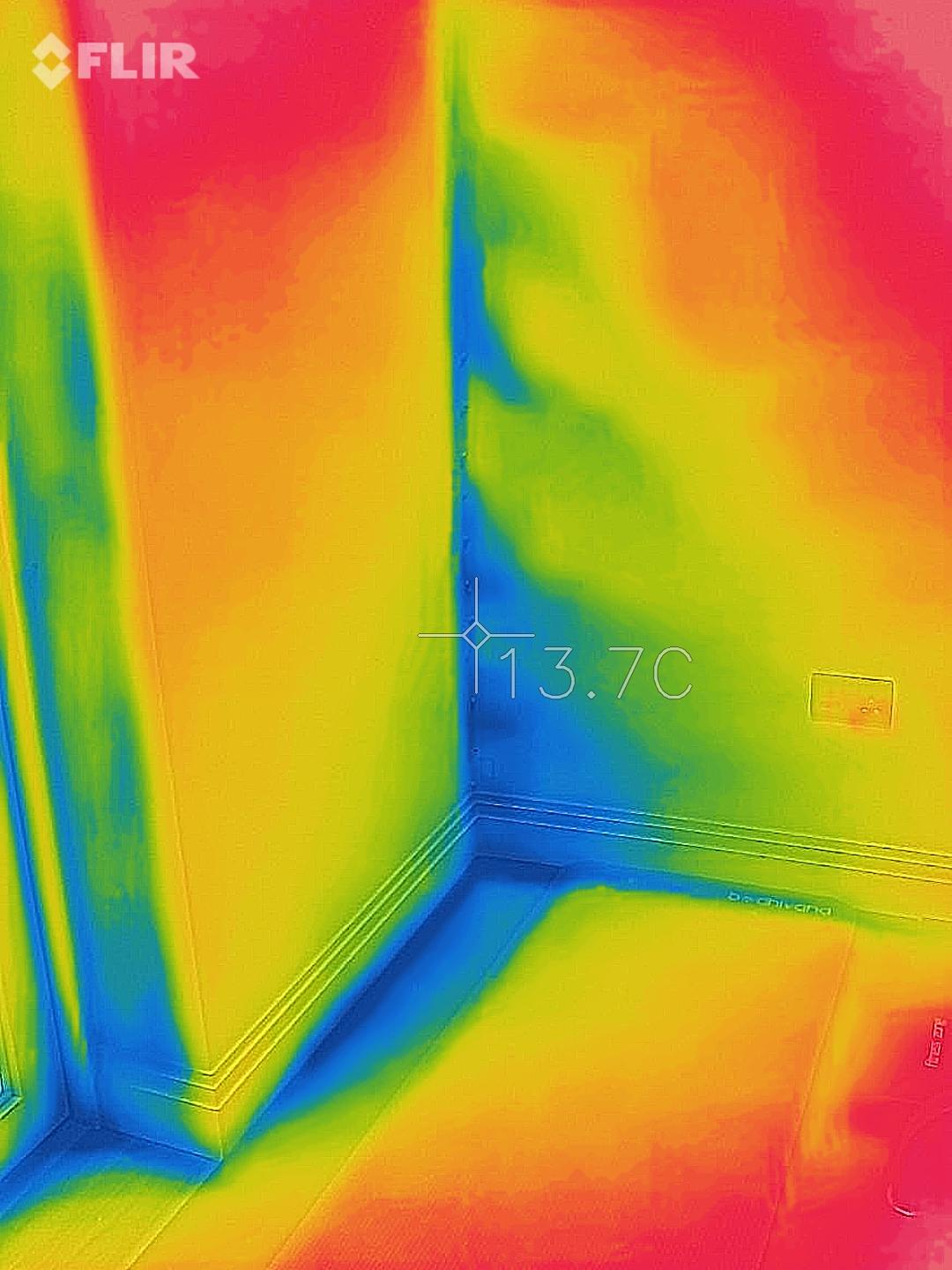

Further update today. The area around the WC is much improved, so much that I had to turn up the thermostat there. Historically I ran it 2-3C lower than the rest of the house as it was so much colder in that area that if I ran the thermostat at 21C the heating would hardly ever turn off.
What is weird is even once all sealed up I could still feel a slight draught in the roof cavity.
This got me thinking to the windows and is air coming in around the windows.

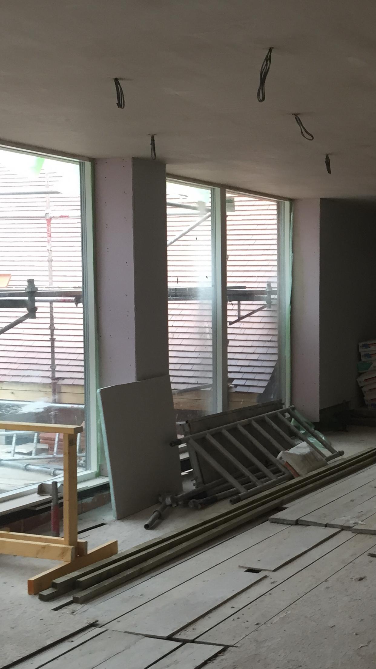

Now my windows are sealed to the render on the outside, but thinking about it, they are still attached to the cavity behind that, so air can still get in from the cavity. Watching the windows being installed, I was going to ask for them to be taped up, but the builders put plastic sheeting around the frames and taped that up, so I thought they had air tightness sorted. I cannot remember exactly what the detailing was. You can see the plastic poking out in the picture below.
Looking at it, I think the plastic is designed stop air getting into the rooms. And indeed we have no draughts anywhere. But what it does not stop is air betting behind the plasterboard.

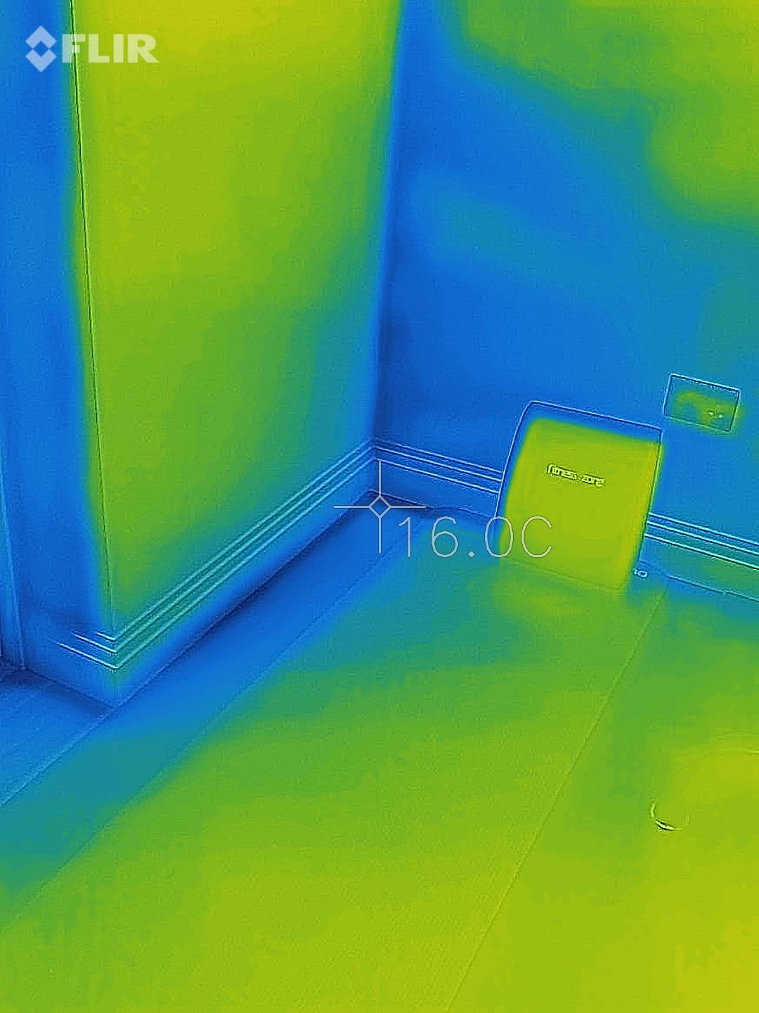

I have been investigating in the gym, as the wall is getting beaten up by gym equipment anyway. If you look at the first IR picture taken on a very cold day, you can see the window reveal is cold, the outside wall which has insulated plasterboard is warmer and then the partition wall which has plasterboard on dabs on a block wall seems have cold air getting behind it.
At first I tried sealing up the corner there by pumping foam into the small cavity. This improved but did not fix things. Any I keep thinking where is the air coming from.
I pulled out a spotlight and I could feel the air was moving above the ceiling.
So as I am already suspicious that there is an issue around the window, I cut a hole in the window reveal
What I found was immediately behind the wall I hit the green plastic sheet. This was doing its job of stopping air getting into the room. But immediately I punctured the sheet, I could feel the cold air behind it.
The problem is that I think the sheet is sealed to the plasterboard in the reveal not to the block wall. Thus it lets cold air get behind the insulated plasterboard. This air can make its way up into the ceiling void and along behind the insulated board coming out behind the skirting and round the corner behind the non insulated board.
I have pumped the area behind the plastic sheet with foam. If this works to stop air getting behind the plasterboard, I will have the simple but laborious job of drilling holes in the window reveals and filling them with foam.
I suspect that this has a larger impact on the air tightness test than heating costs. There are no draughts anywhere from behind the plasterboard into rooms that I can feel, other than occasionally at the bottom of the skirting board. Thus the amount cold air getting into rooms under normal circumstances is small. But I am probably heating the air in the cavities constant which will be increasing my costs. When you run the air tightness test the higher pressure involved starts to draw air out under skirting and in other places that are tightly enough fitted to stop normal draughts.
As an example of the lack of actual impact on heating costs, the heating has never been on in the gym shown with the cold air behind the plasterboard. There is a UFH manifold in the wardrobe and the heat it generates seems to be more than enough to keep the room warm. Indeed we usually have to open the door when we exercise. Even below 0C outside the temperature in that room stays above 20C.
