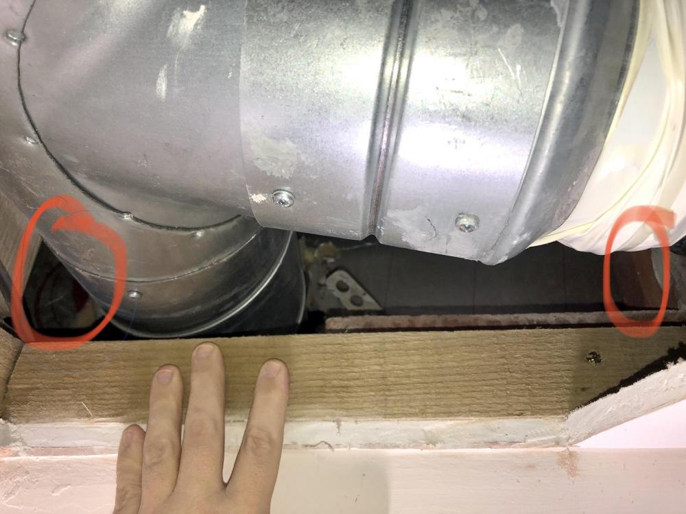

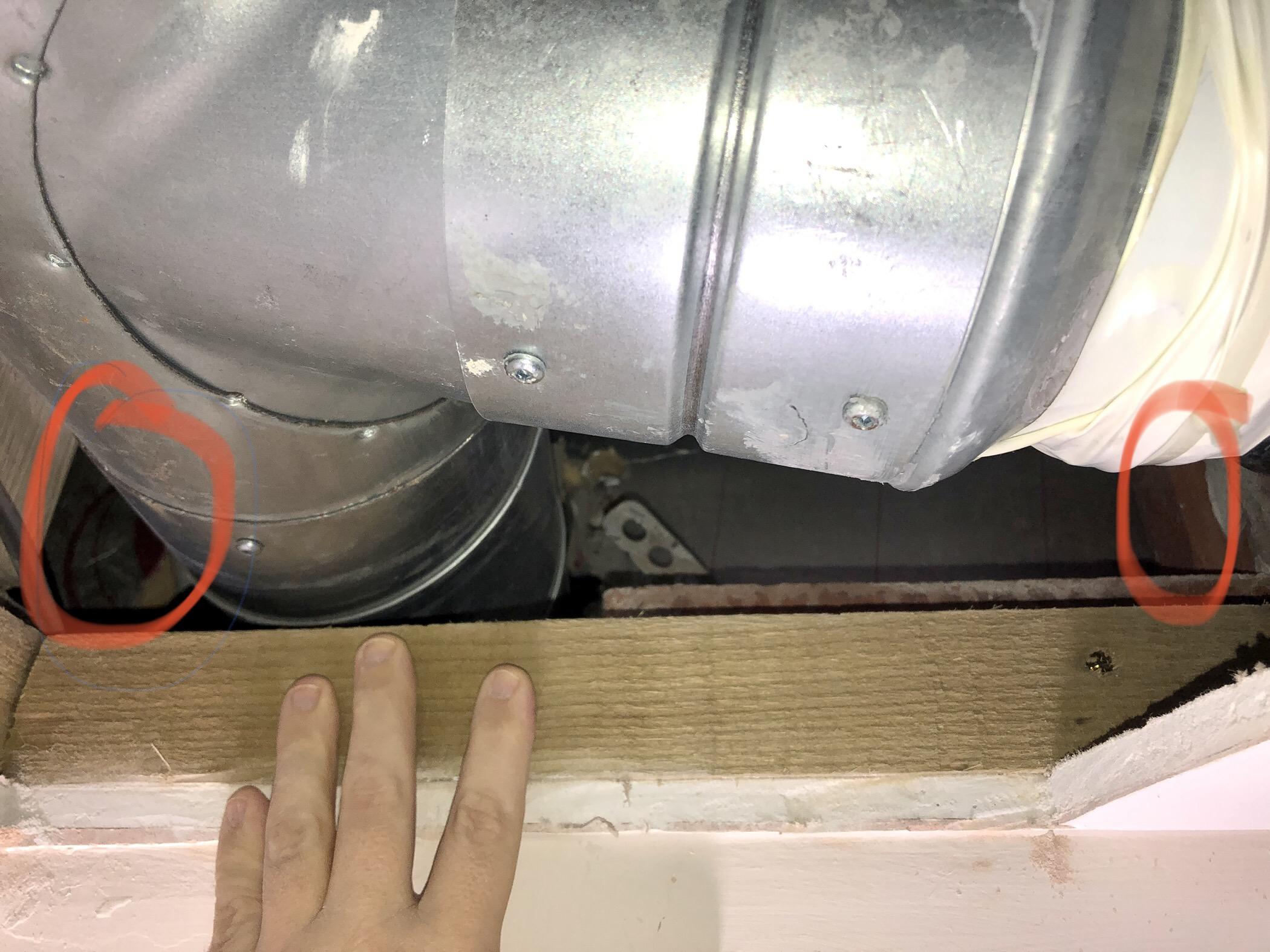

This is what I am grappling with.
For a modest area I don’t mind using foam but the area to be filled here is around 400x250mm with the duct through the centre of it.
Most likely it will never be seen or touched again so I should just get spraying. I just need to think about it.
The builders have actually parged the blocks and sealed the edges with foam just along from here. Seems rather pointless when you have left a gaping hole right next to it!
There was a bigger gap in the eaves that I had to fill. There I cut pieces of PIR and then foamed around them so I am considering that option. Access to do this would be difficult though and even without this I am considering that I might need to bite the bullet and take down more of the ceiling. Because the ceiling is suspended and the duct is in the way it will be pretty difficult to make sure I have got everywhere filled.
I would give it all a spray of water to moisten slightly, get the foam gun nozzle right to the back and squirt in.  Don't apply so much that it drips or falls out.  You may need to do a few passes after the first has partly cured to make it fill properly.
I had to cut a bigger hole to get at it all and have started to fill it in.
I have started with expanding foam right at the back where the pipe comes through the PIR and where the PIR goes around the corner behind the wall to the side of the MVHR duct.
My plan is to do it in two layers, one sealing up the PIR and another one in front inline with the missing blockwork. I have made a start on the rear layer and am going to let the first can of foam expand and dry before I see if I have missed anywhere.
I have bought 10M of 6mm ID 8mm OD pipe to attach to the foam cans as I have had the issue elsewhere that you cannot get the can close enough to where you need to fill. The is exacerbated by the cans needing to be upside down. If you attach a couple of feet of flexible pipe you can keep the can out of the way. The first time I did it I thought I would clean out the pipe but that was pointless, so I bought 10M from EBAY on the grounds that I will use about 60p worth and just bin it each time I need to get a can of foam into an awkward space.
I also recommend proper disposable latex gloss and not the thin ones supplied with cans of foam. The foam comes through these as they have little breathing holes.
I took a picture with my hand to give you an idea of the size of the hole in the inner blockwork. If you look at the pic you can just see the block to the left of and in front of the ducting and the edge of the block to the right of the ducting. This whole section of inner leaf is missing. It was above the ceiling but the ceiling has various penetrations for lights etc and also connects to the area behind the WC where the cistern is. It must have had quite the impact on the airtightness test I assume. Between the cupboard and the WC there are 5 lights, 2 sensors, 2 sockets, the WC wall fittings and the WC flush plate all where air can get through.

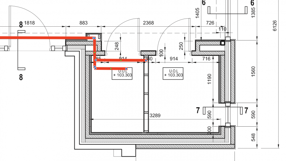

The big hole is all filled in, but there was still a bit of air getting in from somewhere.
If you look at the plan I posted the issue continues to be the interior cavity spaces.
Basically the roof of this area is a single concrete slab.The builders have sealed what they thought were the three outside edges.
But the inside edge between the hall and the cupboard/WC is open to the cavity between the two layers of Porotherm.
As they considered this an inside wall they didn't seal the edge of the slab. In the cupboard I have filled it between the hole I cut in the corner and the hole the MVHR duct comes through.

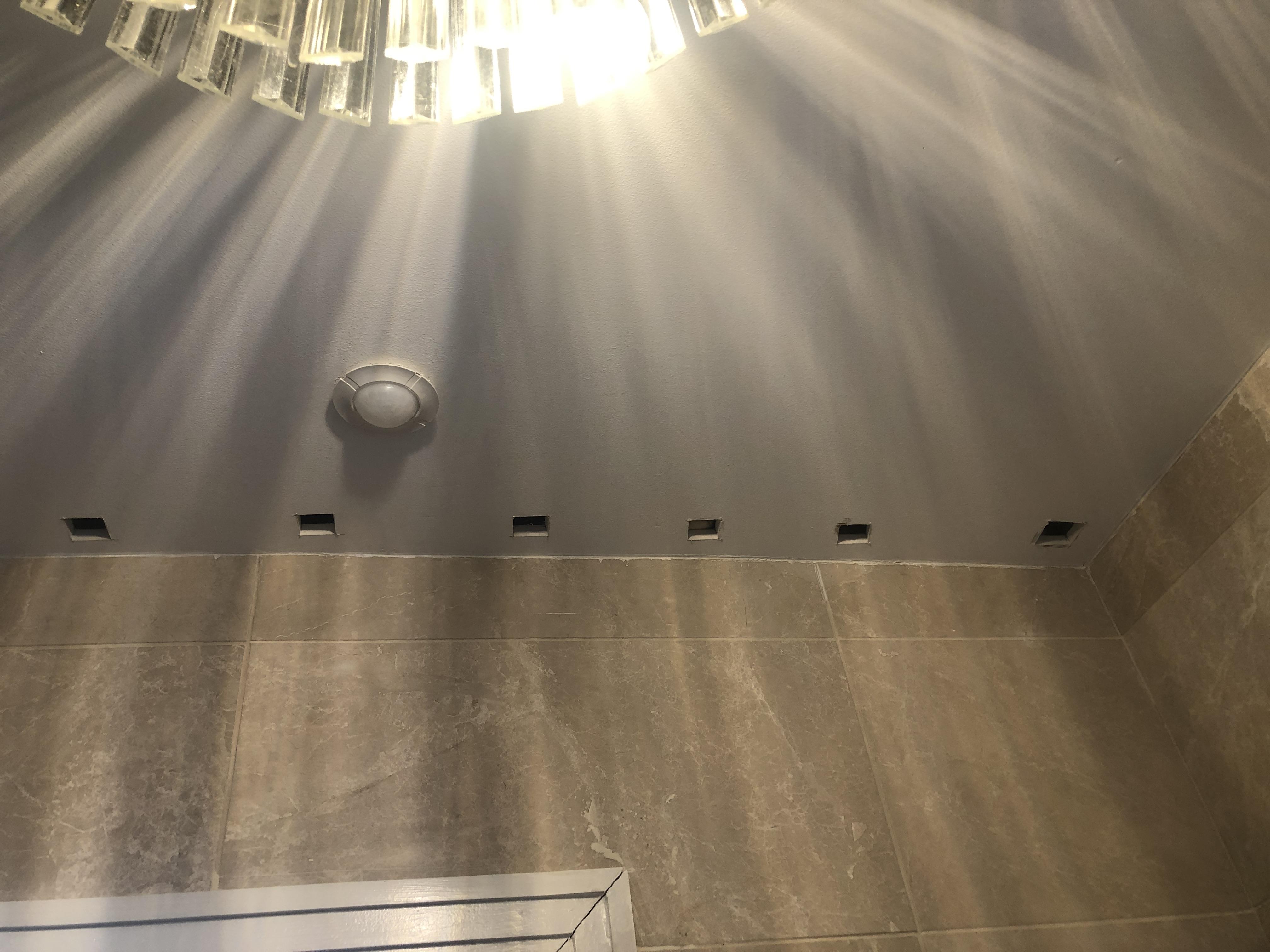

No ready made hole in the WC, so I have peppered the ceiling with holes and sure enough as soon as I cut the first one I could feel the draught.
There is around a 10mm gap between the Porotherm and the slab all the way along above the doors. In the very corner I knew the water pipes came through the wall into the WC and this was sealed.
The frame that holds the ceiling sits in front of the gap and in some places there is only a 6 or 7m gap. So the 8mm PVC pipe I have been using attached to my foam is too thick and I will finish it off when some 6mm comes.
I was almost done in the cupboard when I got a bit too enthusiastic with the foam and blew the pipe off. Do you like my new designer shirt?
As I think I said this little area has always been the coldest part of the house but I didn't know what the problem was. I even got the builders to take down the WC ceiling, but they still didn't figure out the gap to the hall side was the problem. I will be very happy to have this fixed.
