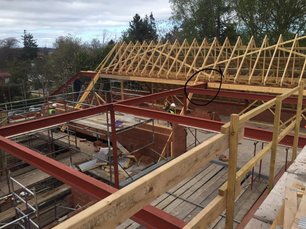

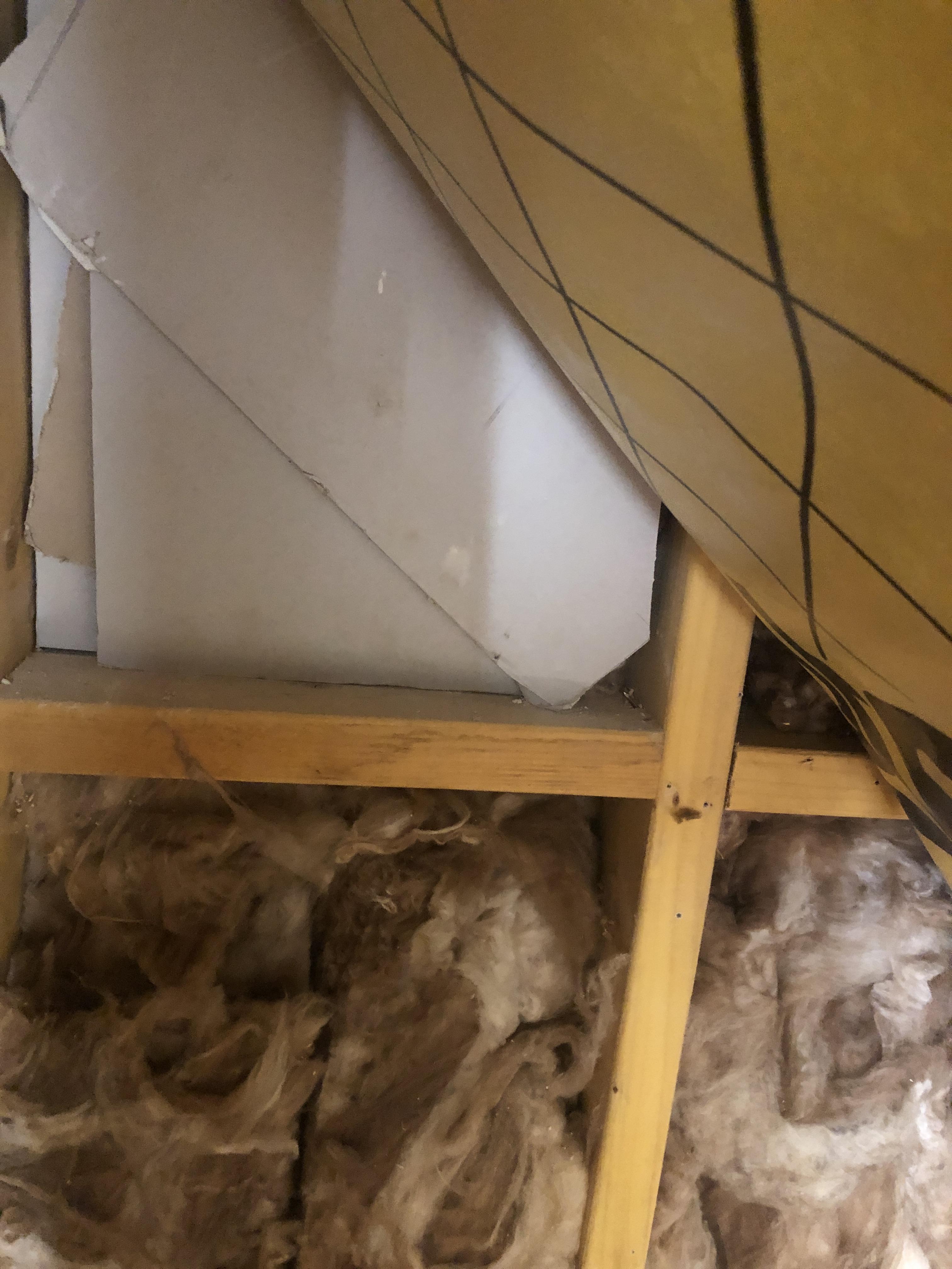

So I opened up the area that I had found was an issue after we moved in and asked the builders to fix. Basically they had filled the partition with rock wool and put a layer of plasterboard on it, but not sealed the actual area where the air gets in. The problem is that this area connects to the area where the MVHR is above the ceiling on the ground floor and thus impacts most of the house.
I took some pictures but its s had to see.

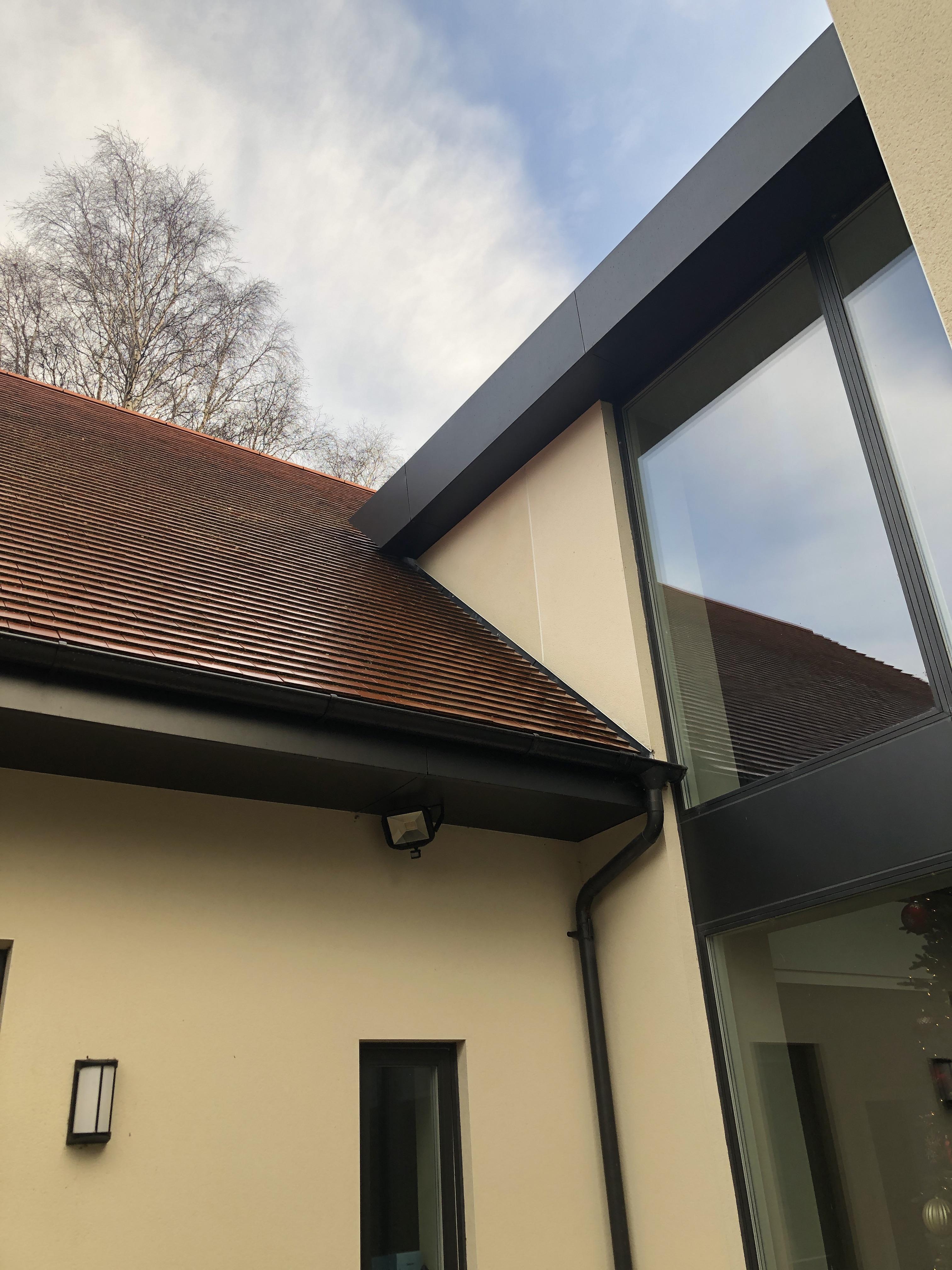

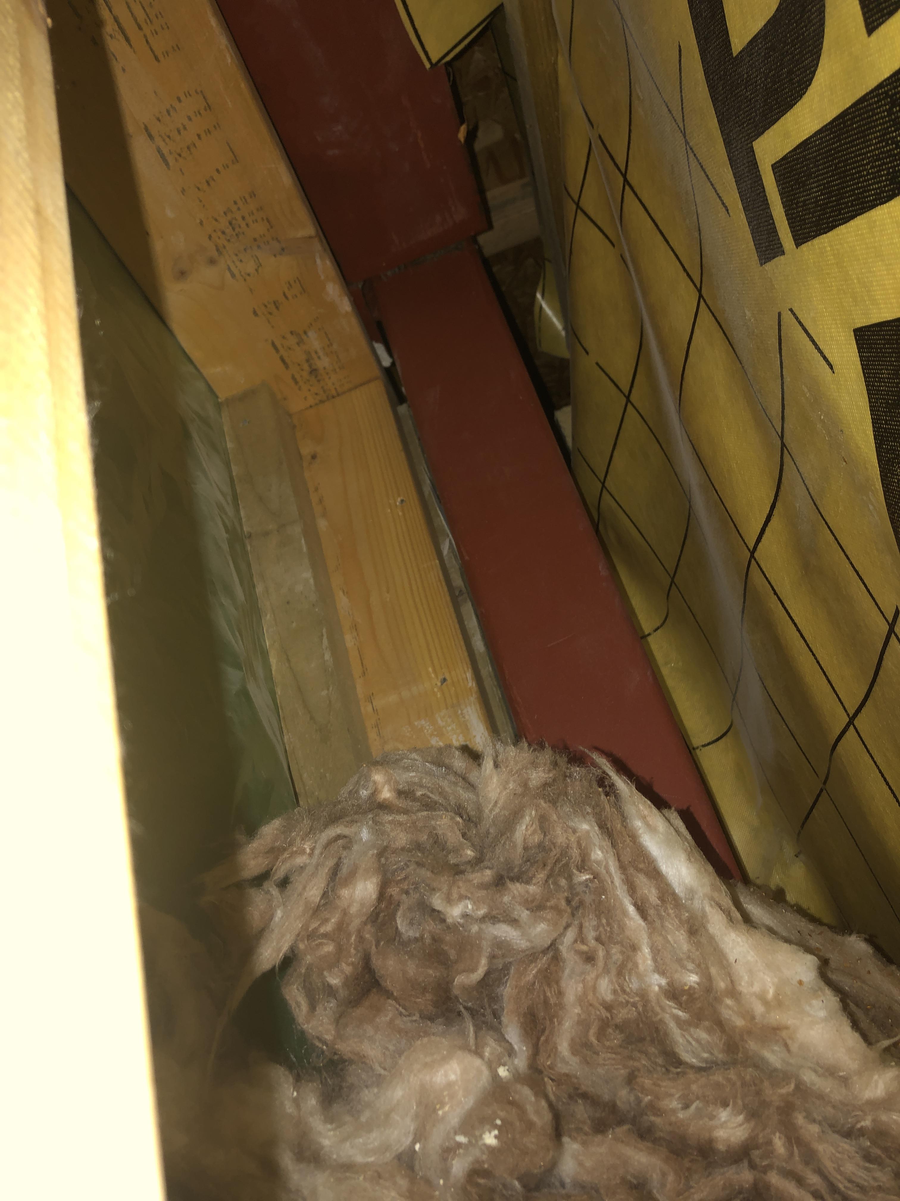

f you look at the picture from outside, we have an area where a sloped and flat roof meet.
If you look at that area from inside the hall you see a cross. There is a vertical steel in there that you can see from the pictures taken inside the offending area.

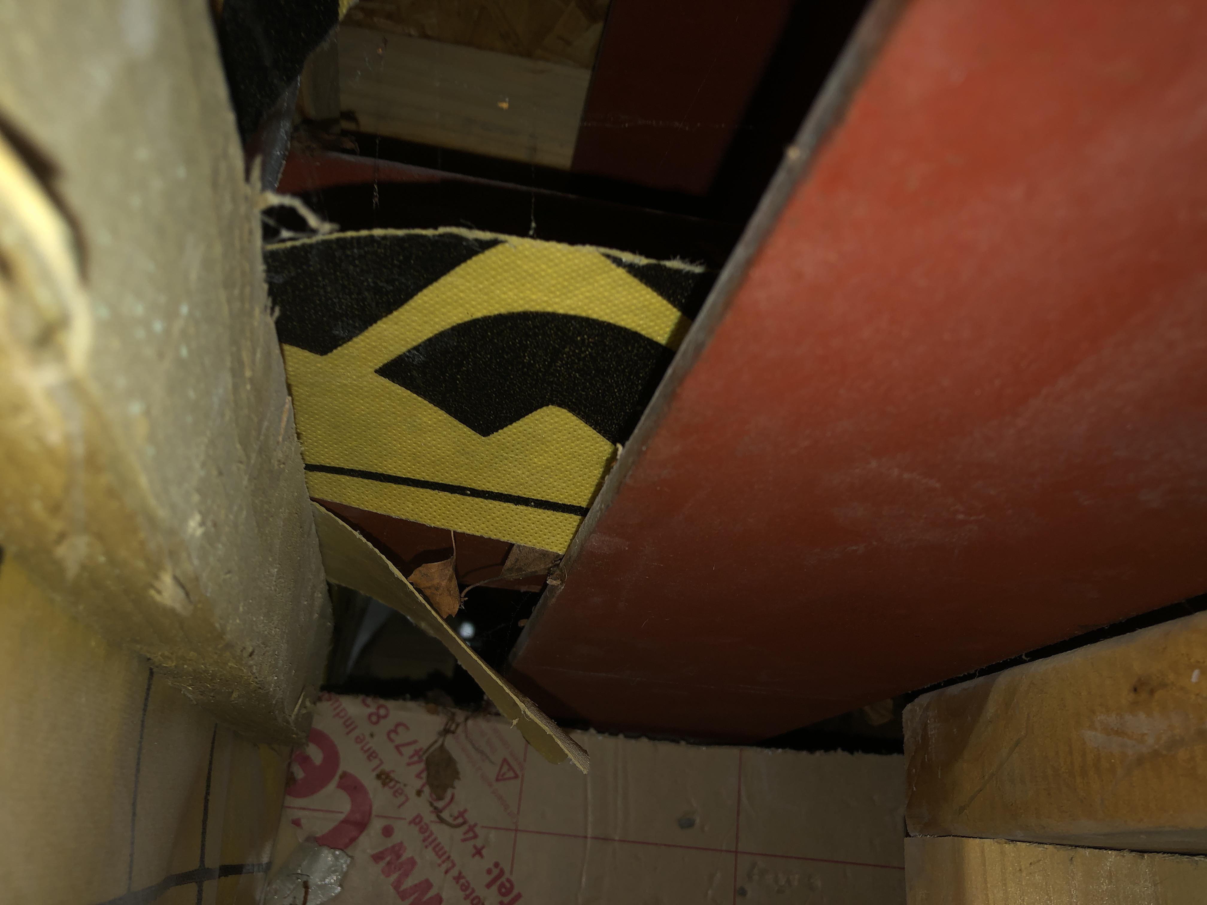

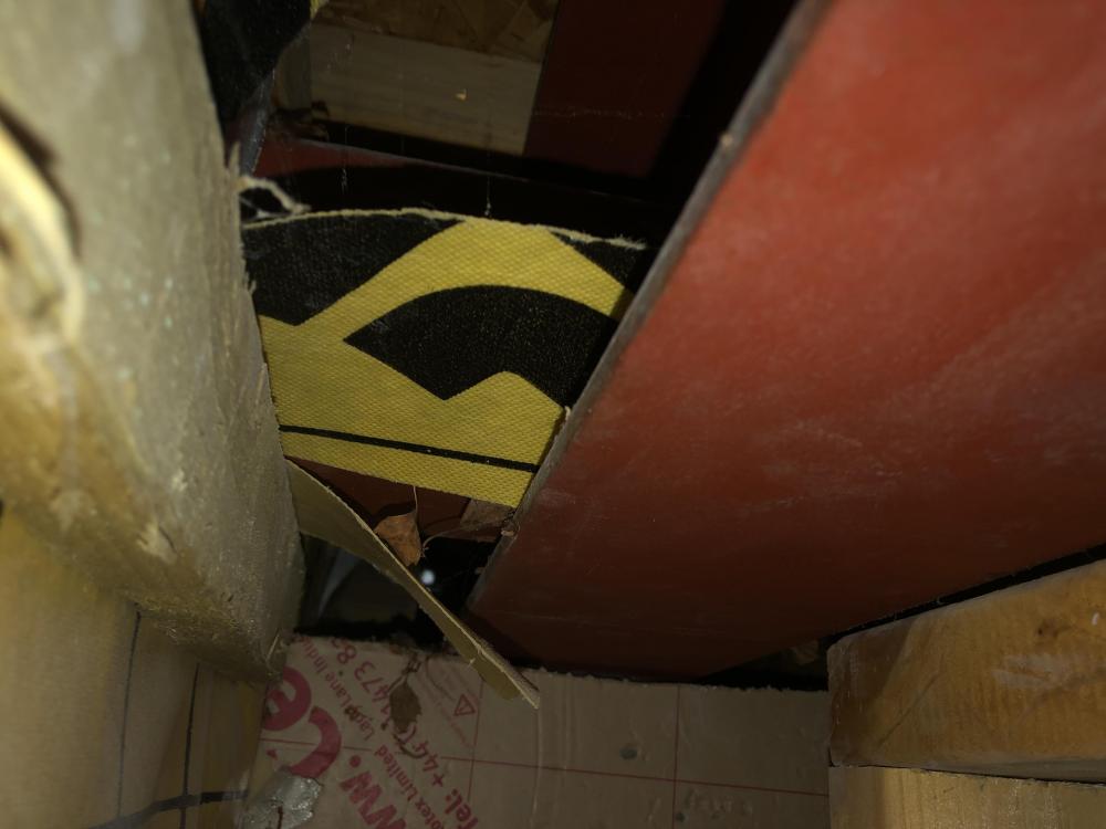

So if you look at the pictures where you can see the airtightness membrane, that is on the end of the sloped roof, but the area of render board is not airtight and is open behind the plasterboard cross own the hall which connects to all the downstairs ceiling and the MVHR run to the WC. Effectively if cold air gets in here it can get all over the house and the unsealed area is large.
Now how do I seal it? 'the gap between the end of the roof and the stud work is only around 100mm wide, effectively this is where the builders had sealed it, they foamed in some plasterboard (They also put some odd bit of plasterboard inside the studwork when they ran out of insulation!), but all the air above this could still get into the walls and ceilings. The only thif I can think of is firing spray foam up to the top of the gap all around the steel to seal it in. I don't like filling a massive void with foam, but there is not way to physically get up into the space and seal it up.
Edited by AliG

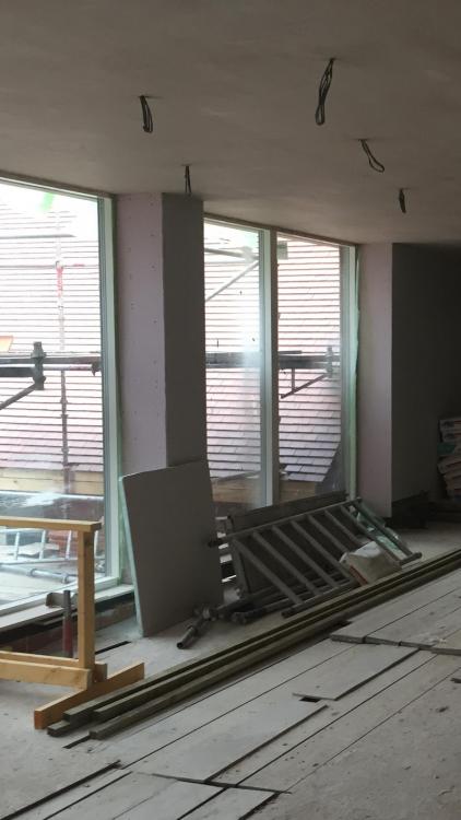

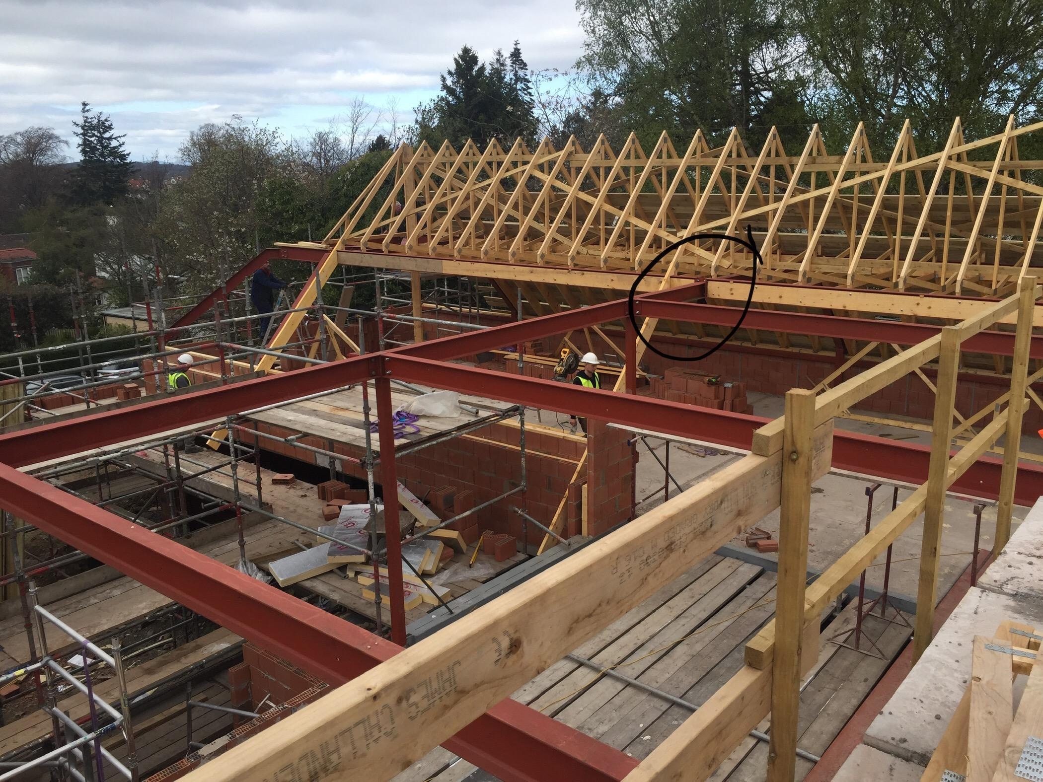

I have been through all the pics I have of the build. The problem area is marked up between the end of the roof and the steel. It just seems there was never any thought given to the point where they meet.
Now I have these it looks like the vertical steel I can see in the space has Porotherm blocks on the far side of it so I think I can safely seal it to them with foam.
The issue then is sealing the top area. There is a point where I managed to get a picture showing some light and there were leaves in there so it is def open to the outside.

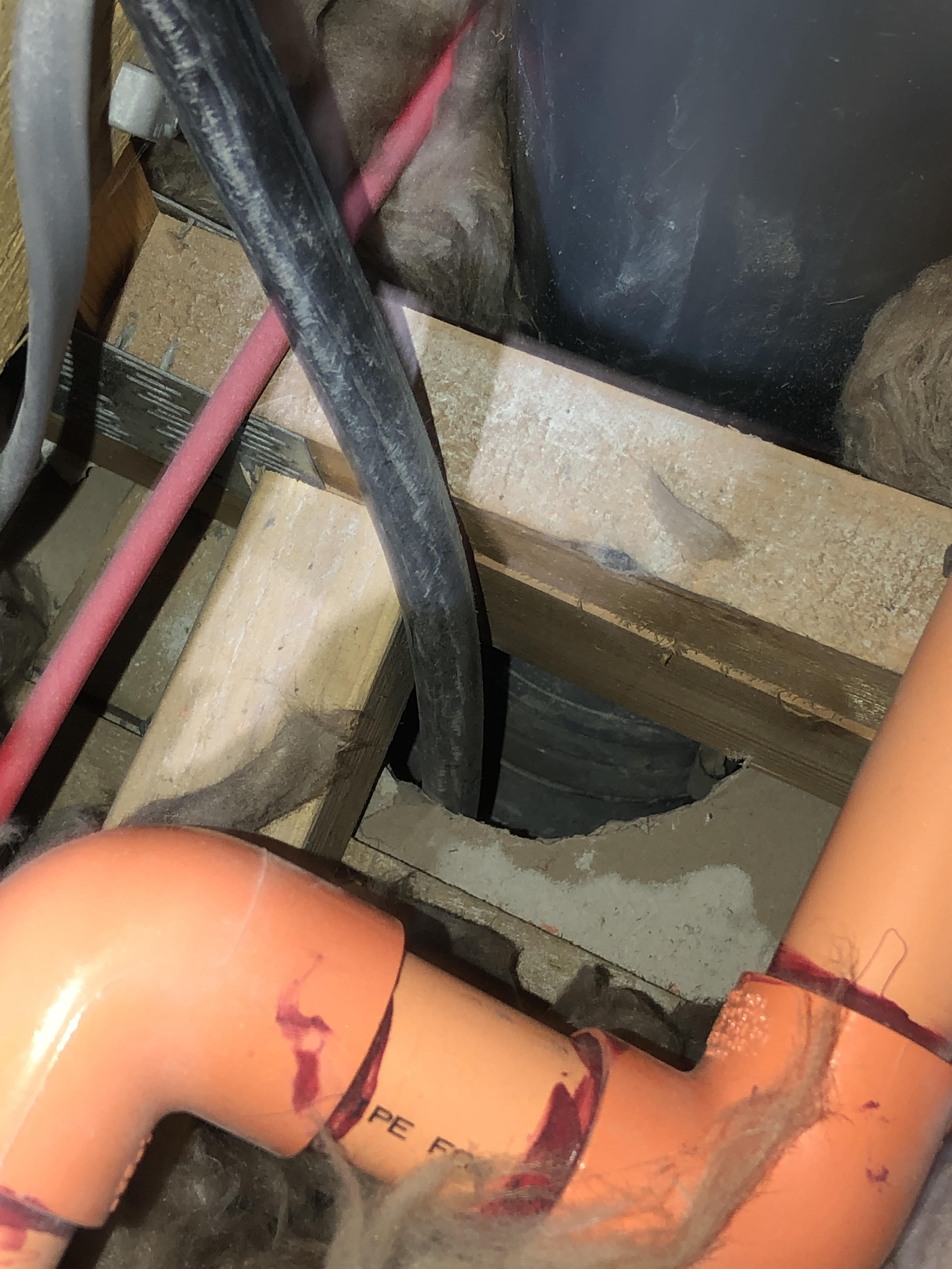

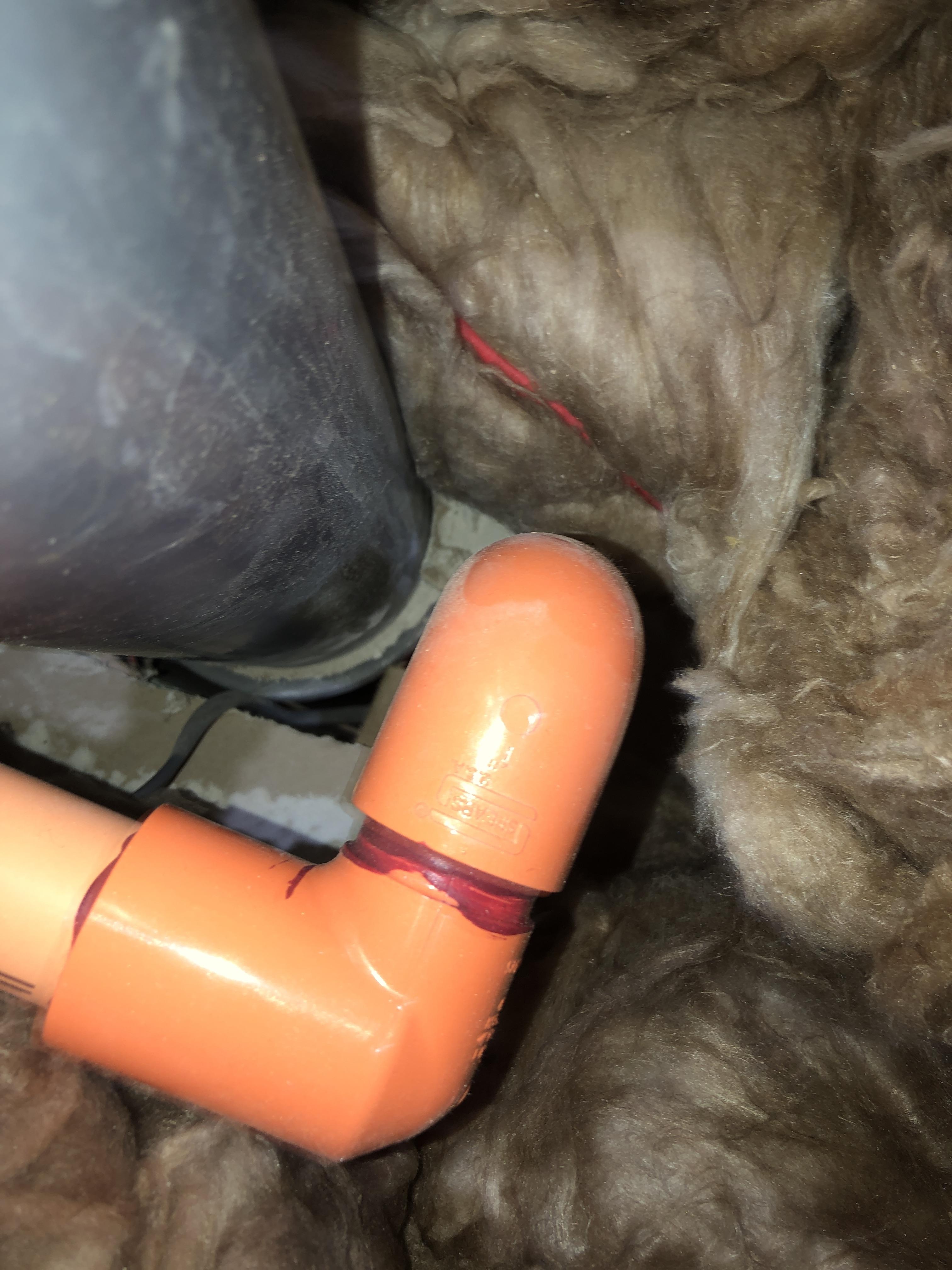

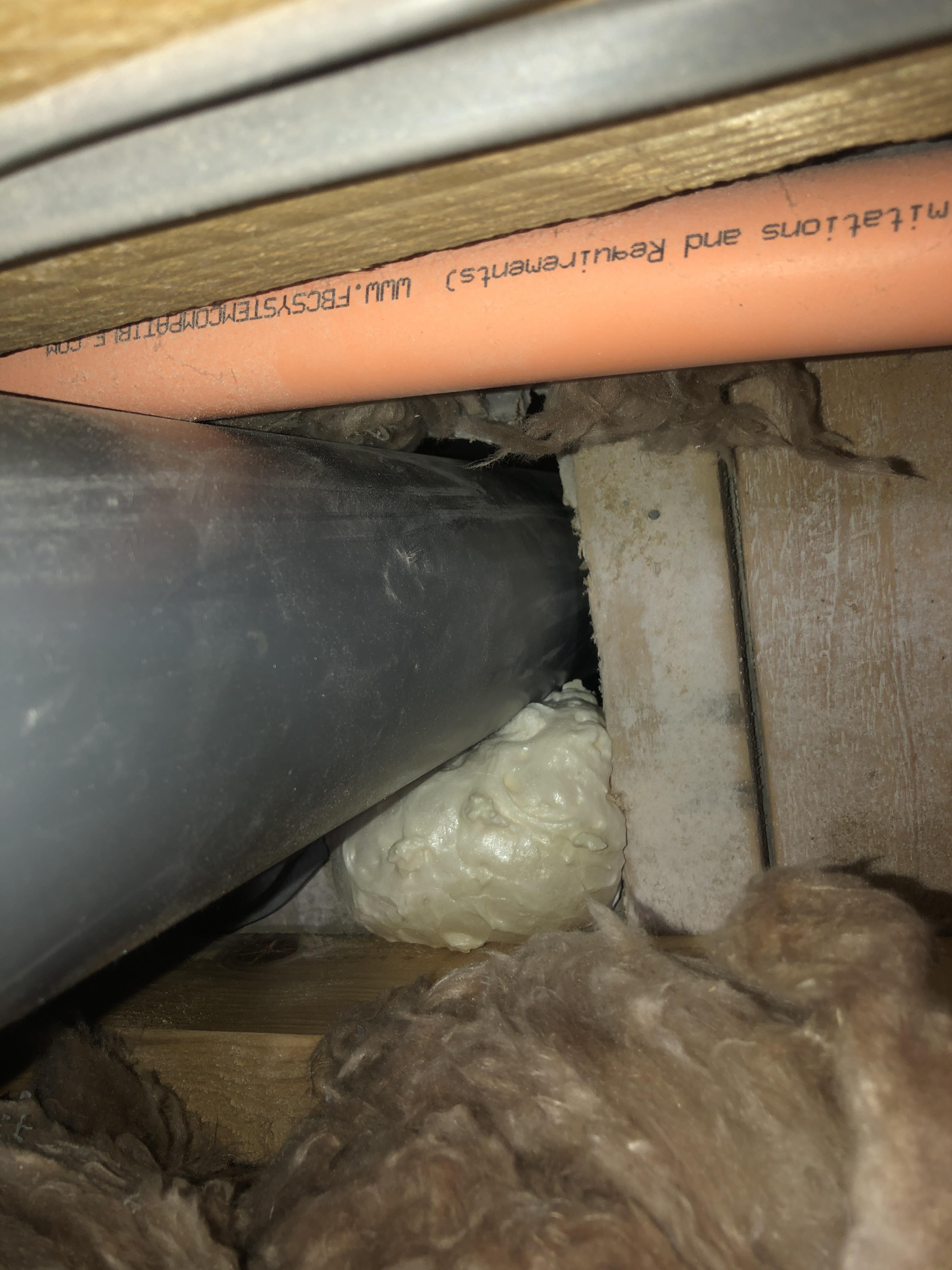

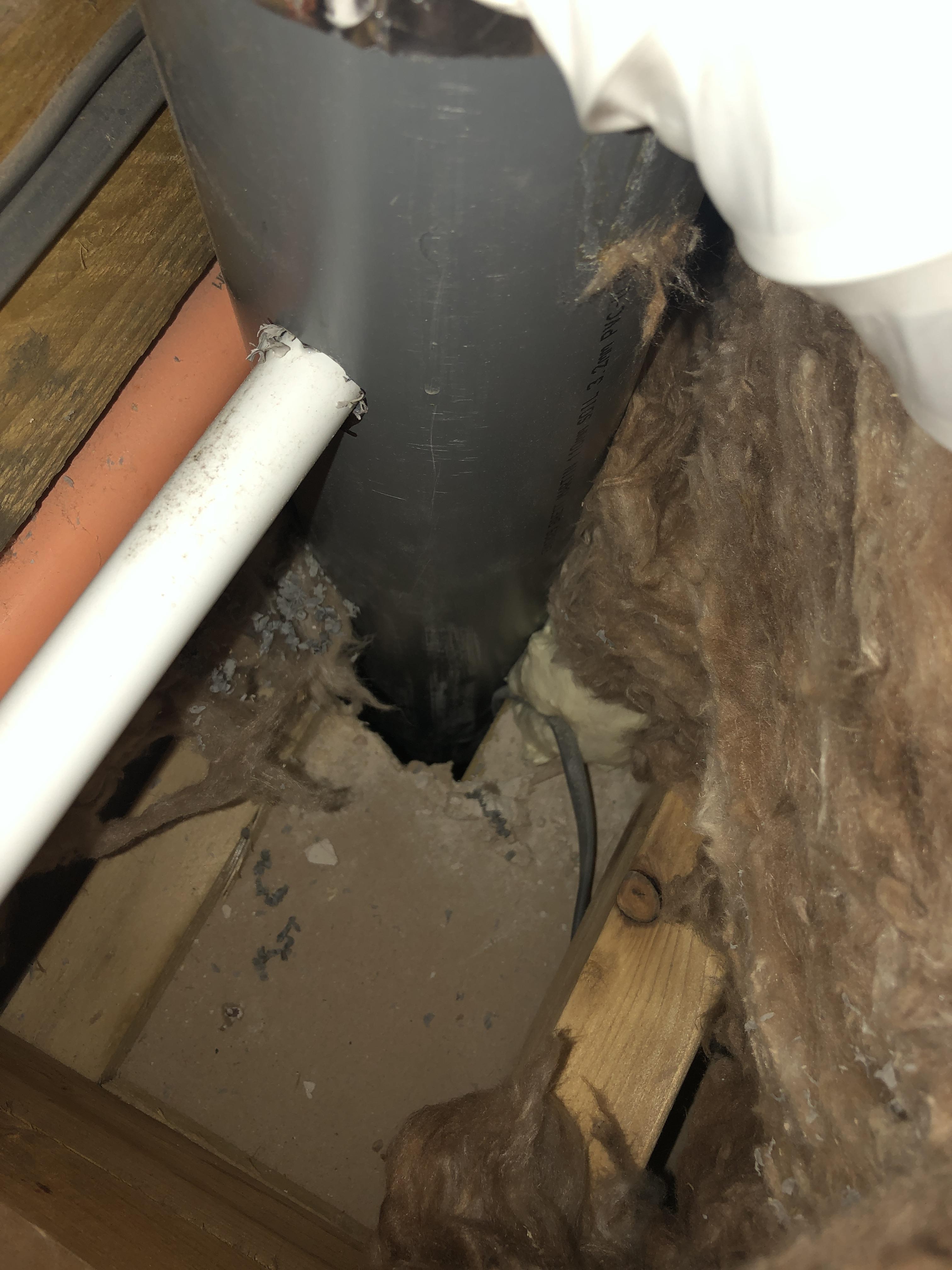

I have spent the last hour up in the loft investigating where there are holes that I can seal up.
Around the stacks and other pipes that come up from the ground floor once I pulled up the rock wool the bottom layer of it was warm.
At least this is a relatively easy fix. Someone had made a feeble effort to seal one of them

I thought I should clarify that the feeble effort at foaming up the hole was not me.

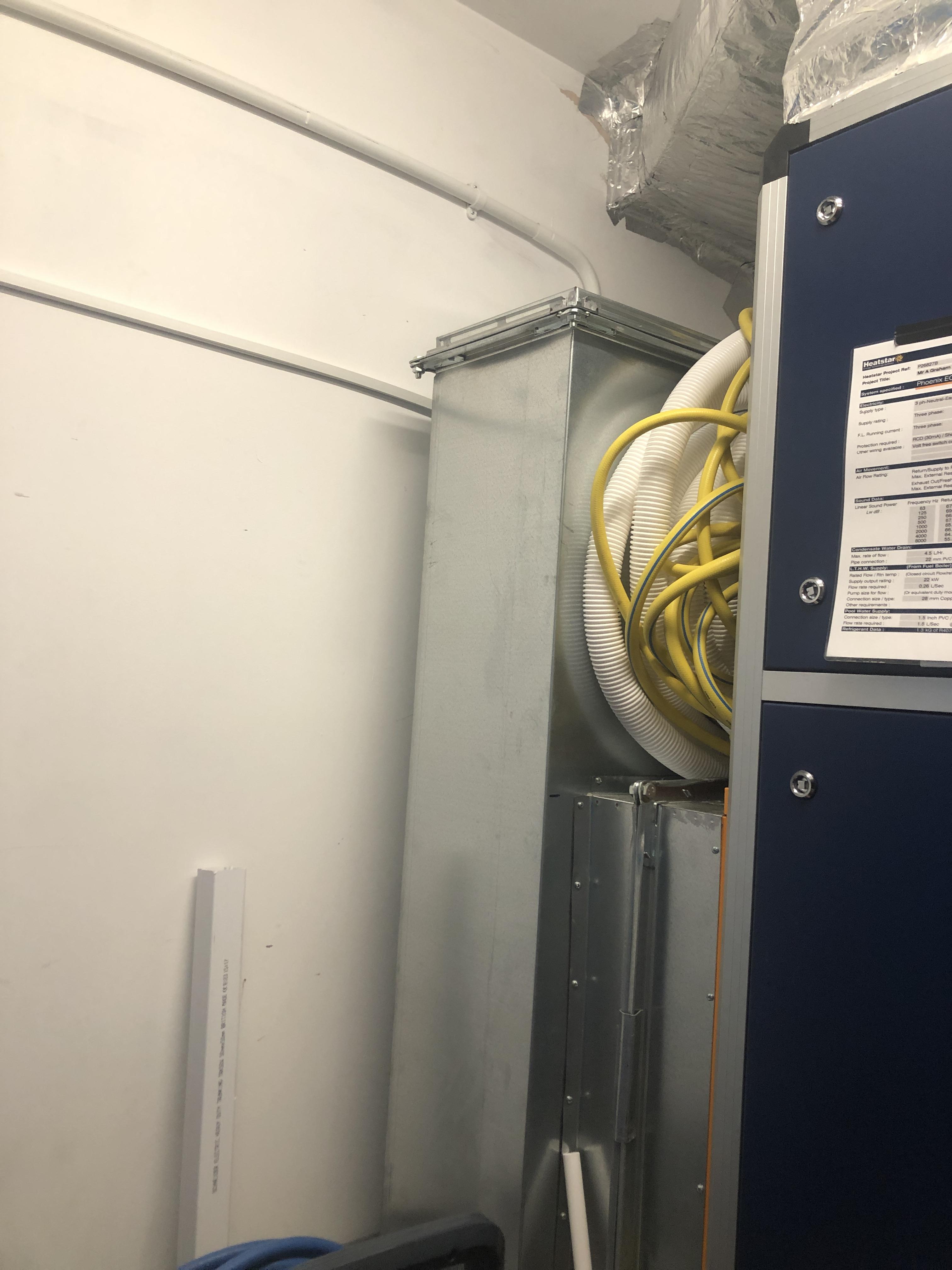

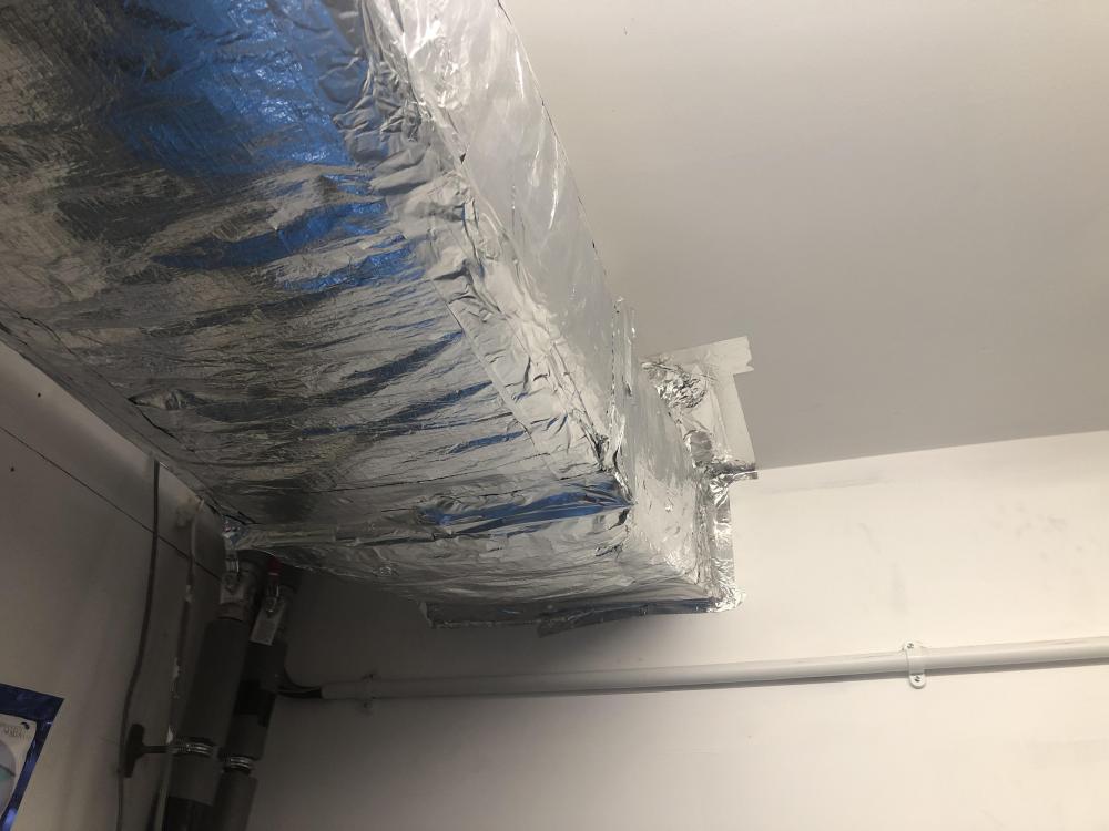

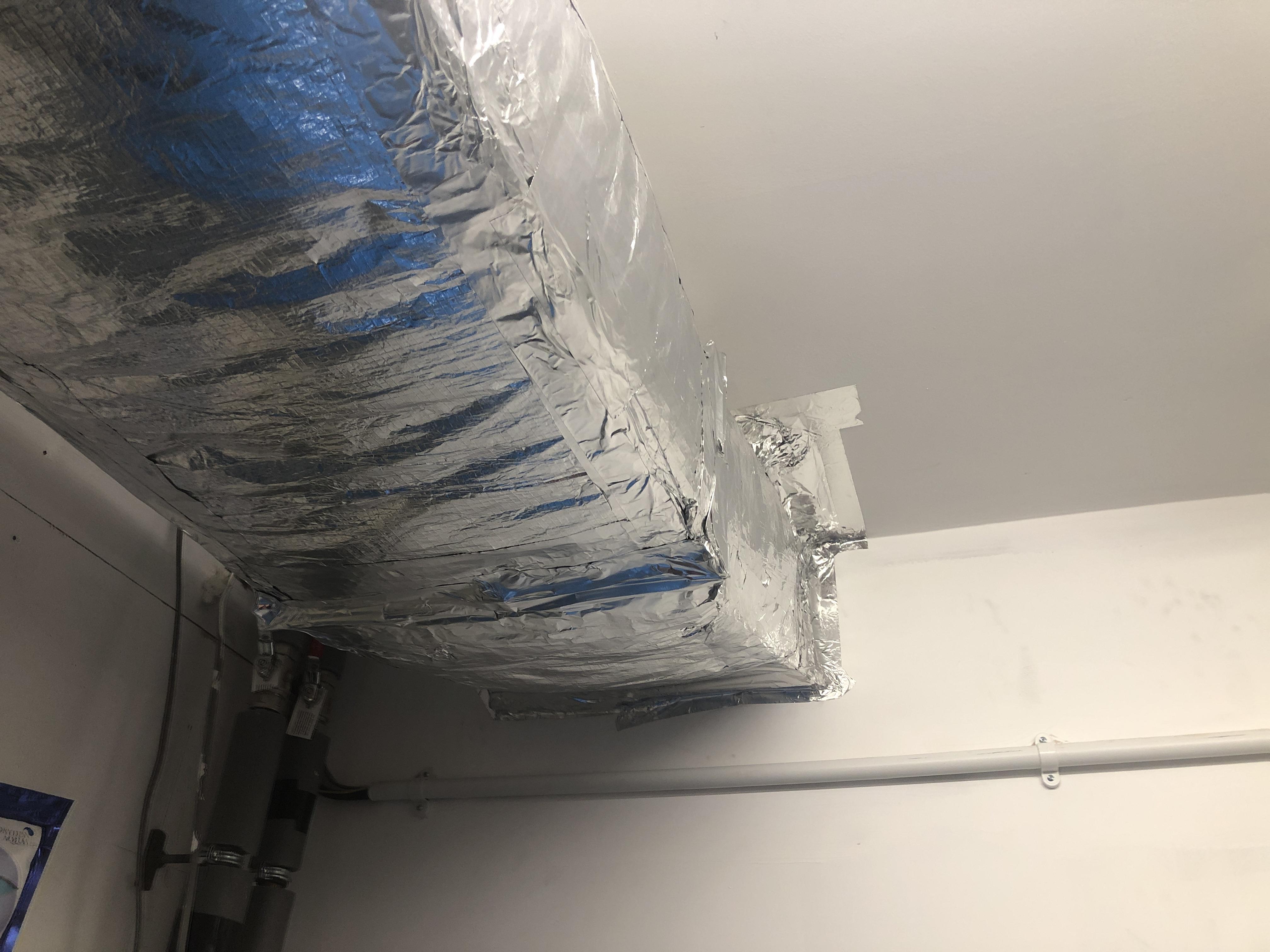

When the test was done the ducts for the pool dehumidifier had insulation filling the gap as they went through the wall but it was not taped up so I did that.
I discovered that one of the ducts was not sealed up on the far side as to do this required me climbing on top of the ducting, which thankfully easily took my weight, and lying in my back up in the air to tape up the space above me.
My hope is that 5 or 6 areas like this we have identified as quite big gaps are the main culprits in the low airtightness score.

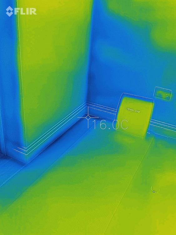

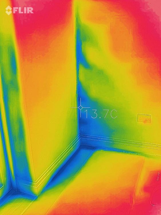

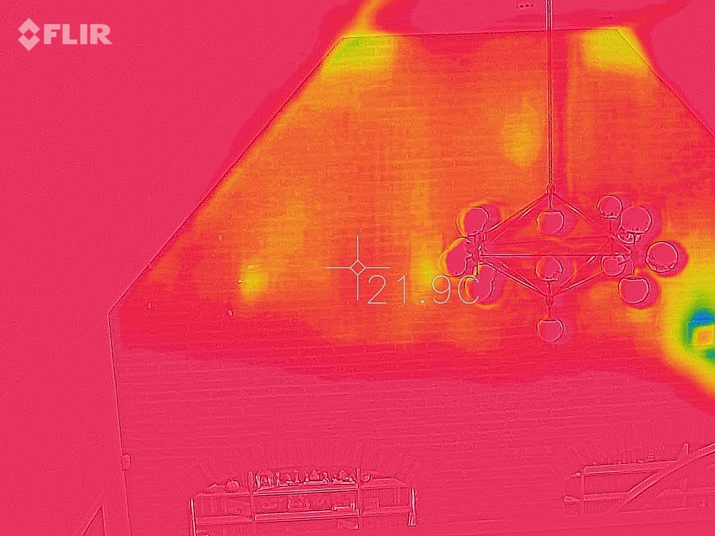

I did also discover another thing. There is an area of about 15 sq metres of wall that seems like an interior wall but is above the loft insulation so should have been insulated. It is currently landlocked in the join of the T in the roof so I think just no one noticed it.
I have attached an IR picture where you can see the area of wall that is a couple of degrees cooler.
IMO having started this work. Tape is the way to go to seal stuff up. Foam is nasty stuff that works well if you have a narrow gap but often just falls out of holes and goes everywhere.

Is that one of the Flir Cams for iPhone / android?
Yes, it is absolutely fantastic for checking things over. I managed to get a refurb one so got a reasonably good deal on it. It is very sensitive and you can see quite small temperature changes.
