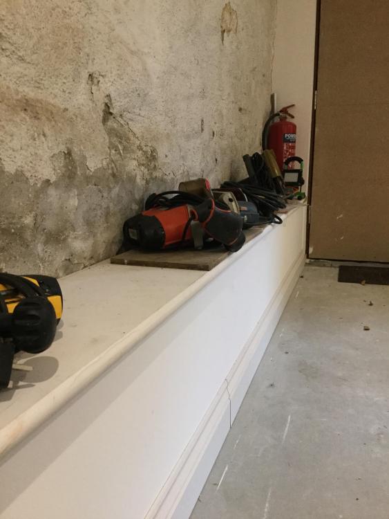

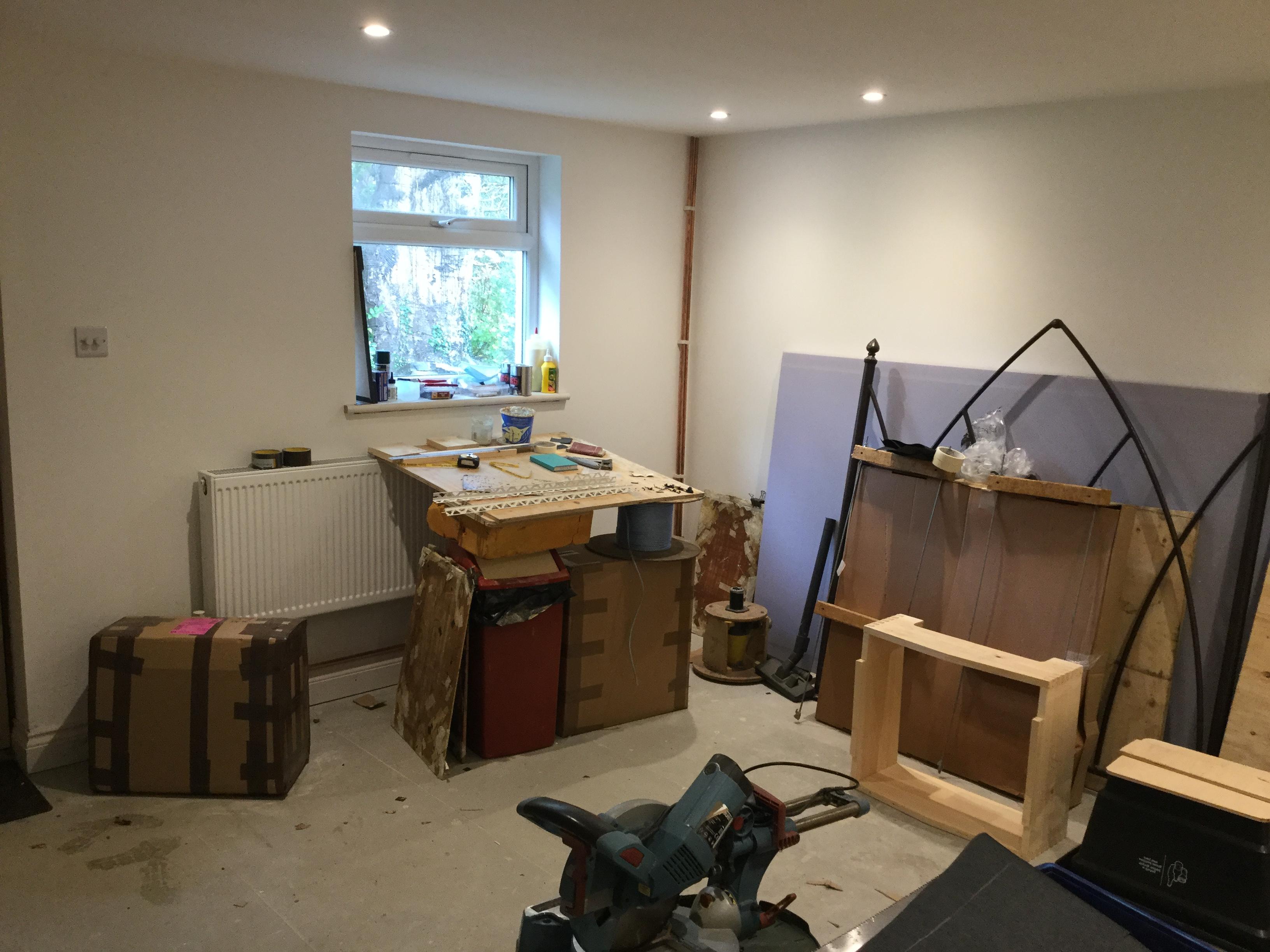

zoothorn Posted October 25, 2020 Author Share Posted October 25, 2020 @PeterW my lower room's in quite a pickle.. shoved it all in for now temp etc/ to make worktops later, would it even be wrong to fit worktops before its signed off I wonder? Is this acceptable for the BCO to sign off in this state, Or is it rude? My shelf bit has turned out ideal for cabinets @ 9" d. I also wonder if he,ll pick up on some rendering patchwork needs doing just above it, a bit of damp actually here comes and goes.. its the outside ground level this shelf line you see, shouldn,t be this low of course so would be hidden over, if only...... Link to comment Share on other sites More sharing options...
joe90 Posted October 25, 2020 Share Posted October 25, 2020 If you call out BC, he will tell you if you need anything else done before sign off . Link to comment Share on other sites More sharing options...

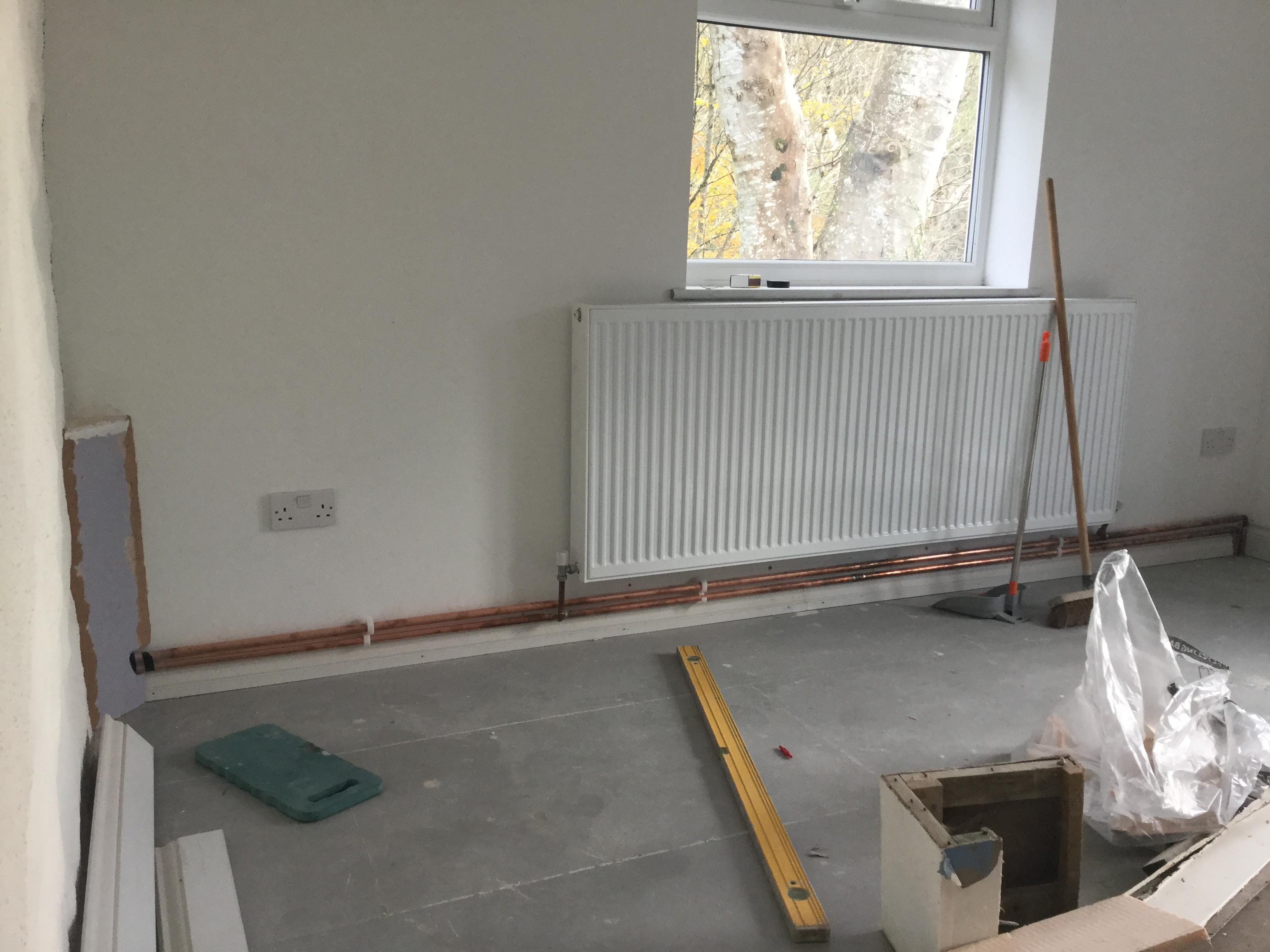

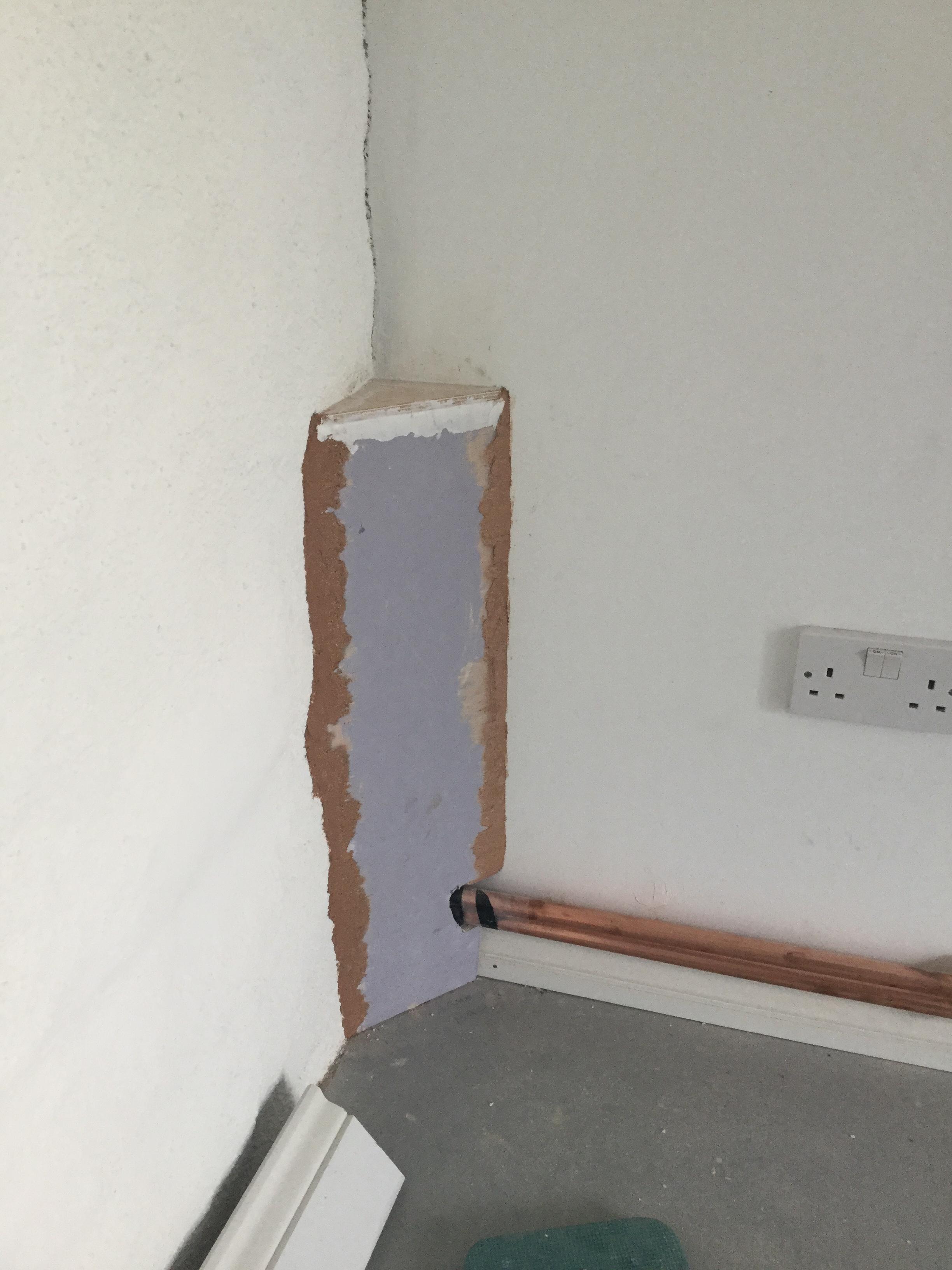

zoothorn Posted October 25, 2020 Author Share Posted October 25, 2020 Im a bit stuck here. ive done my corner pipe boxing, took a whole wknd, but got this pesky pipes gap at btm.. ideally Id box the whole length of pipes in to hide this too, as you would do.. but I just cant face the time it,ll take me, pB plus those wretched placcy cnr strips again/ plaster / sand.. i just cant face it. So what can i do to finish off here? I guess im painting the flippin pipes, but this still the better option for me, even tho it wont look as good. Thx zh Link to comment Share on other sites More sharing options...

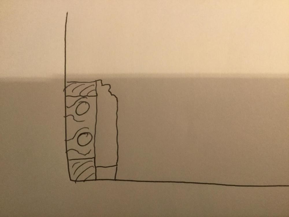

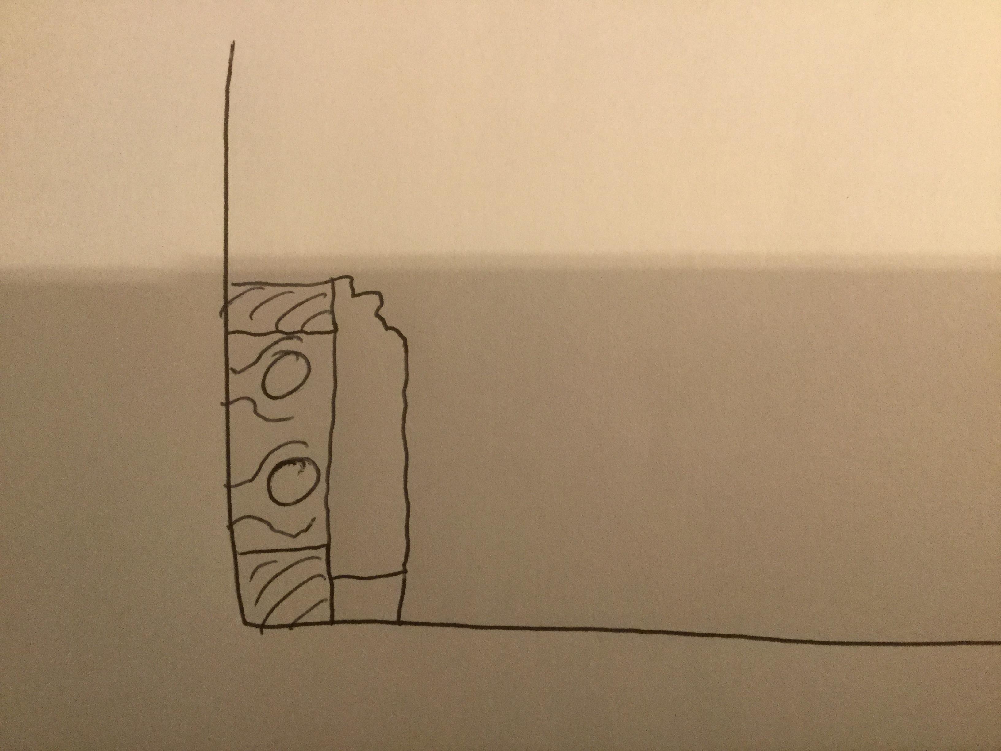

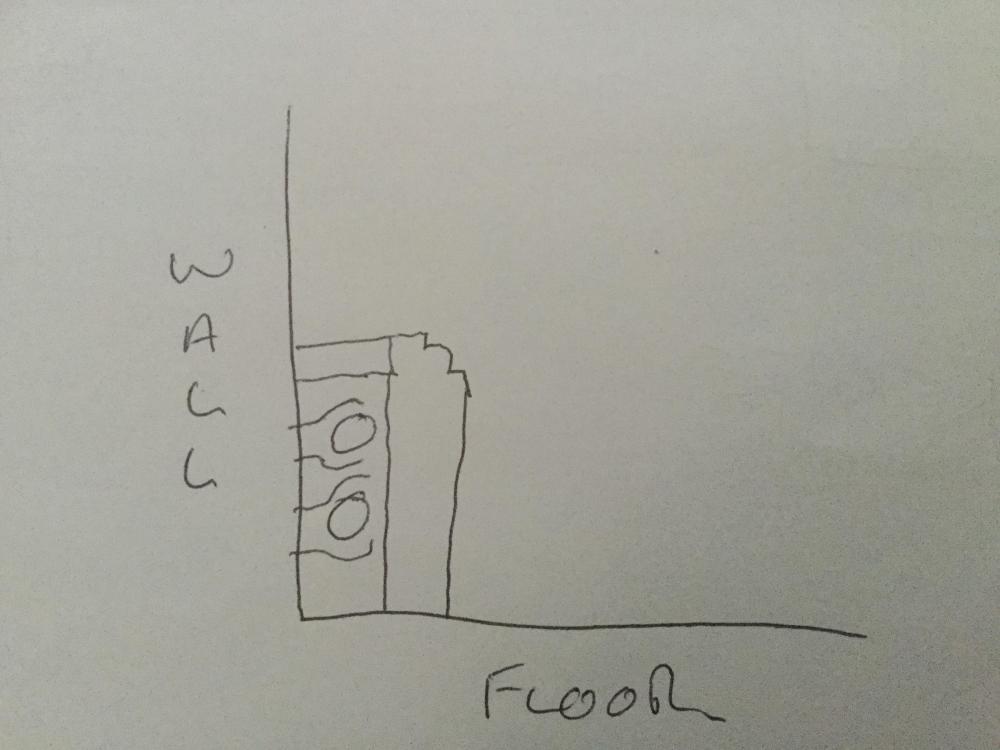

joe90 Posted October 25, 2020 Share Posted October 25, 2020 If it were me (again) and your skirting is big enough or your pipes low enough I would do this.... 1 Link to comment Share on other sites More sharing options...
zoothorn Posted October 25, 2020 Author Share Posted October 25, 2020 @joe90 skirt short by 1".. annoyingly so/ thought of this. the only thing in my favour is two 22mm pipes hug the wall.. so if boxing would only need a shallow box., like your pic. 1 Link to comment Share on other sites More sharing options...
Onoff Posted October 25, 2020 Share Posted October 25, 2020 2 minutes ago, zoothorn said: @joe90 skirt short by 1".. annoyingly so/ thought of this. the only thing in my favour is two 22mm pipes hug the wall.. so if boxing would only need a shallow box., like your pic. You can get 6" skirting. 1 Link to comment Share on other sites More sharing options...
joe90 Posted October 25, 2020 Share Posted October 25, 2020 47 minutes ago, Onoff said: You can get 6" skirting. Have you bought the skirting yet? If so..... Link to comment Share on other sites More sharing options...

zoothorn Posted October 26, 2020 Author Share Posted October 26, 2020 @joe90 that's an idea that sprung to mind yesterday too, raising the skirt up on a plinth. @Onoff Even up to 6" skirt would still be 1/2" short tho. I do have to think about boxing these now. Ive just seen its actually impossible to paint the lower pipe, bc top one hampers access.. so it'll always be a poor paint job. Jeepers I got my work cut out doing this & the frame. Take you guys an afternoon/ me weeks. Ok so if I buy some 6" skirt, its still got to sit on a plinth. The plinth needs to be -exactly- the same D as skirt, in order to then have something the main skirt attatches to. But I cant see how I can make this plinth so accurately. Also how does the top 'roof' bit attatch perp to the plinth-? Link to comment Share on other sites More sharing options...

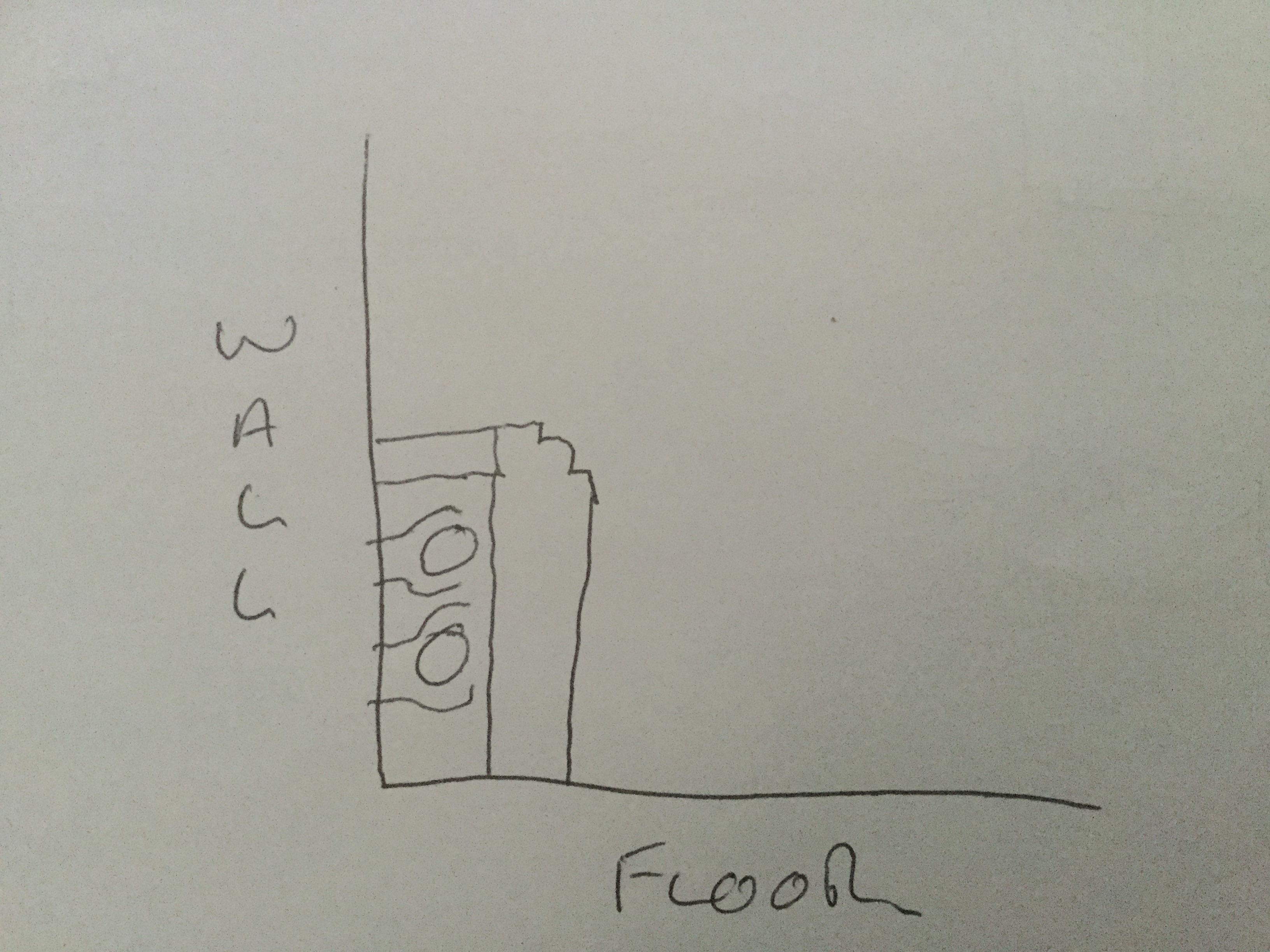

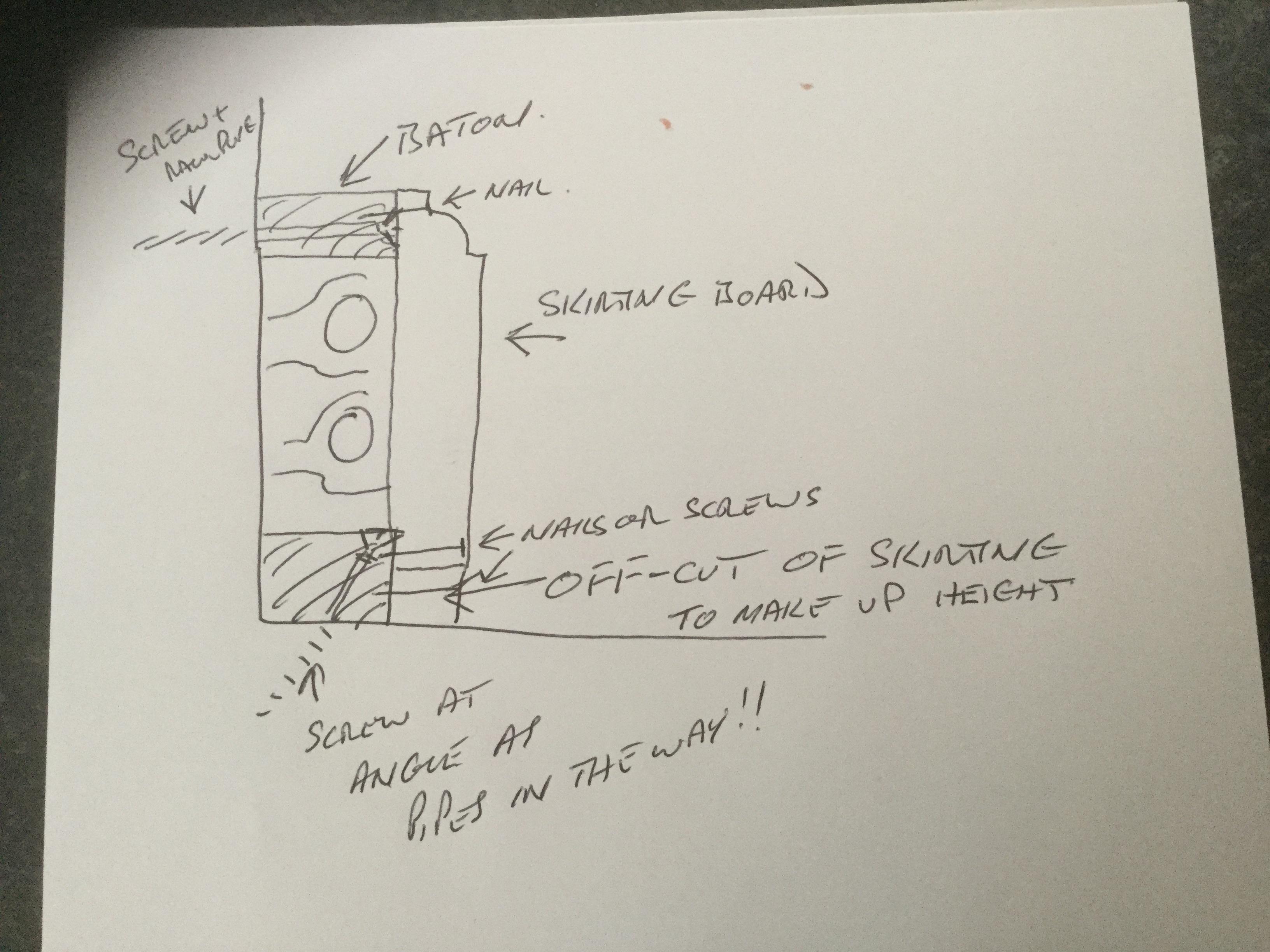

zoothorn Posted October 27, 2020 Author Share Posted October 27, 2020 (edited) On 26/10/2020 at 10:53, joe90 said: I didn’t realise (notice) you already had 3” skirting in place. Joe, going pretty well/ got my two 168mm H skirt pieces, & 2x1 it fits to, all cut ready to fit tmrw. My 'roof' long thin bit I've got a plan but if you could cast an opinion. Right, it would be alot easier if I roofed LHS up to the rad....... left a roof gap under the rad (so close to rad no roof wont be seen)....... roof it onwards from RHS of it to wall. So no roof under rad. Is this gap any concern re. mice? they dont have access to it, apart from across my room: IE no nasty wall cavity pipe holes they can get into the boxing. Do you think they'll walk across my room & go inside my roof gap under rad? it would be kinda cosy in there with the warm pipes.. but its quite a high 'wall' @ 168mm to climb. (Ref pic is 18 posts back). thx Btw I found another angle of your face on a diy forum! thx zH Edited October 27, 2020 by zoothorn Link to comment Share on other sites More sharing options...
joe90 Posted October 27, 2020 Share Posted October 27, 2020 Zoot, I would not leave a gap, it will get full of fluff flies and anything else and you won’t be able to clean it out. It might be easier to fix “roof” to the skirting before the skirting is fixed. Do me a quick sketch of what you propose. what picture, I am not on any other “diy” forum? Link to comment Share on other sites More sharing options...
zoothorn Posted October 27, 2020 Author Share Posted October 27, 2020 2 minutes ago, joe90 said: Zoot, I would not leave a gap, it will get full of fluff flies and anything else and you won’t be able to clean it out. It might be easier to fix “roof” to the skirting before the skirting is fixed. Do me a quick sketch of what you propose. what picture, I am not on any other “diy” forum? Well there's another you out there then.. diy 365 or something. You'll have to have words.. mind you it could be a page I dipped into from ~2005. Aha ok understood. The roof gap would be immediately under the rad, its whole length, either side of it would be the box roof of course.. was my compromise idea/ saves fiddling about under the rad & saves Link to comment Share on other sites More sharing options...

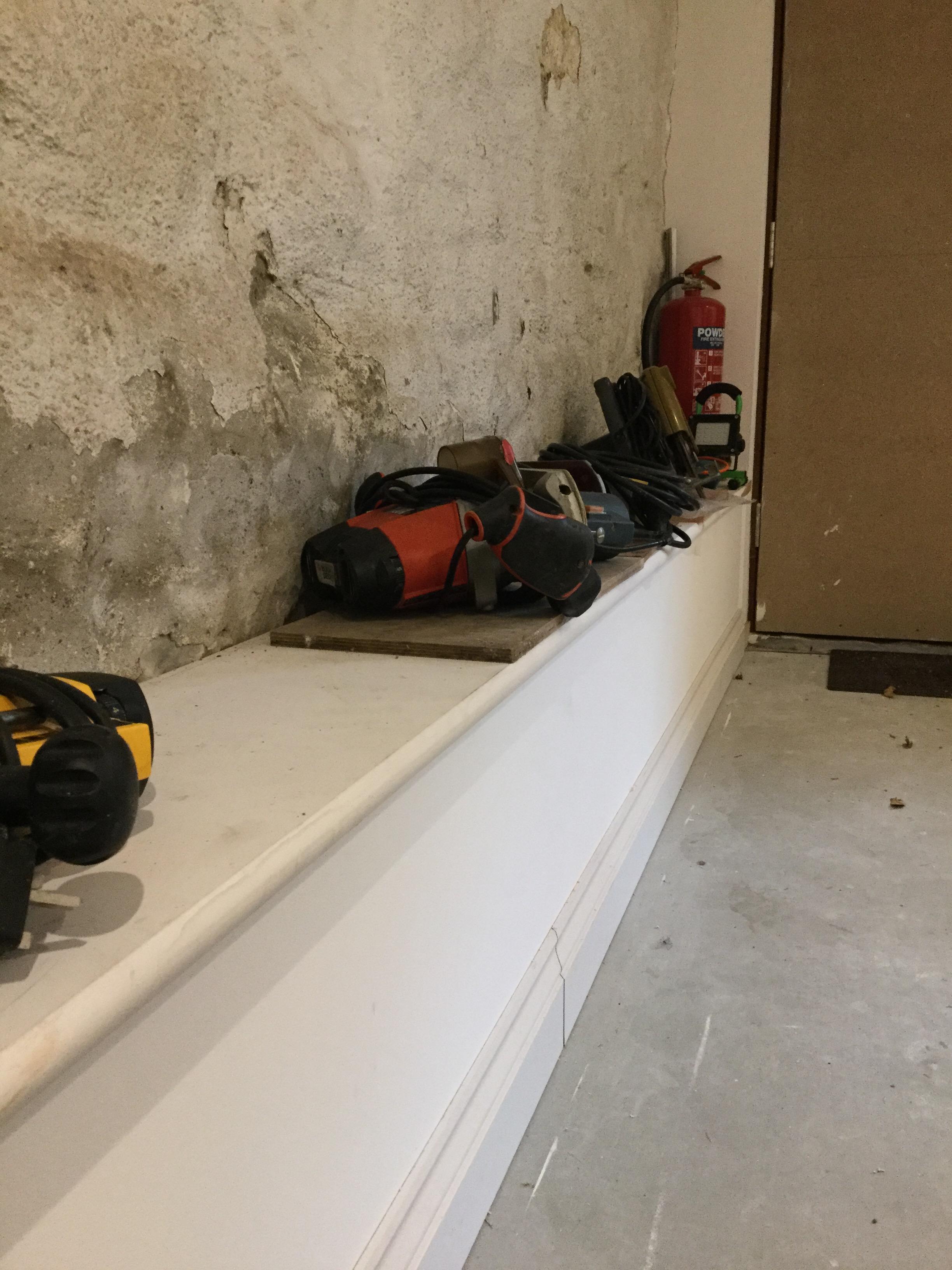

zoothorn Posted October 30, 2020 Author Share Posted October 30, 2020 @joe90 taken Most of a week this bloomin Boxing.. thanks for the help, sketches joe 1 Link to comment Share on other sites More sharing options...
joe90 Posted October 30, 2020 Share Posted October 30, 2020 Looking good, well done. Can see your multi tasking, three threads on the go at once, iPad, boxing in, ASHP. ? Link to comment Share on other sites More sharing options...
