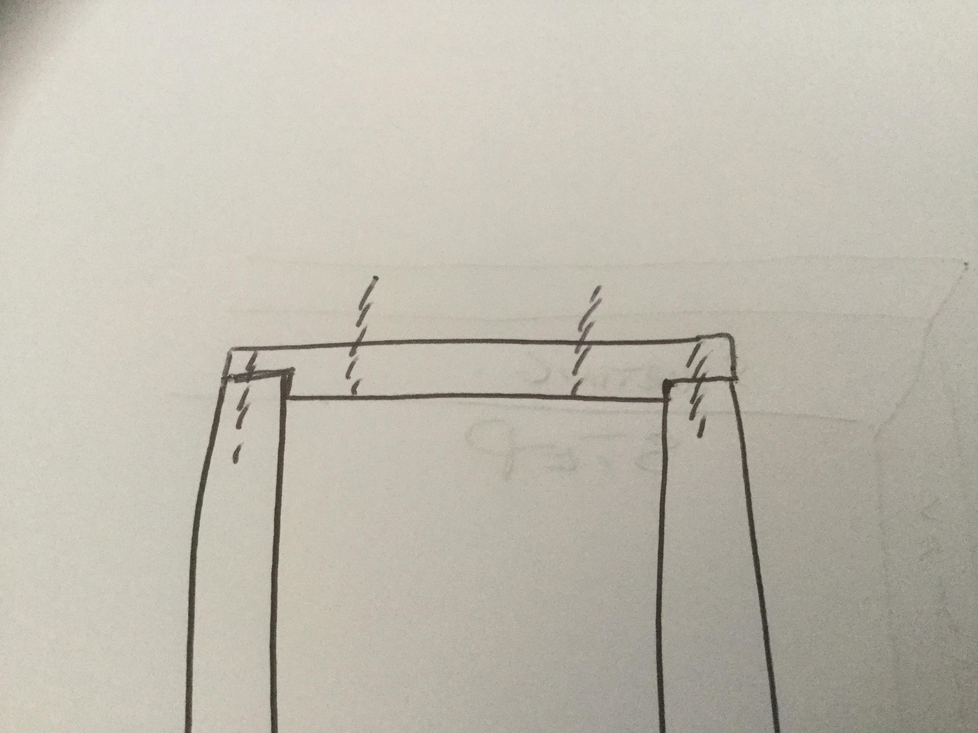

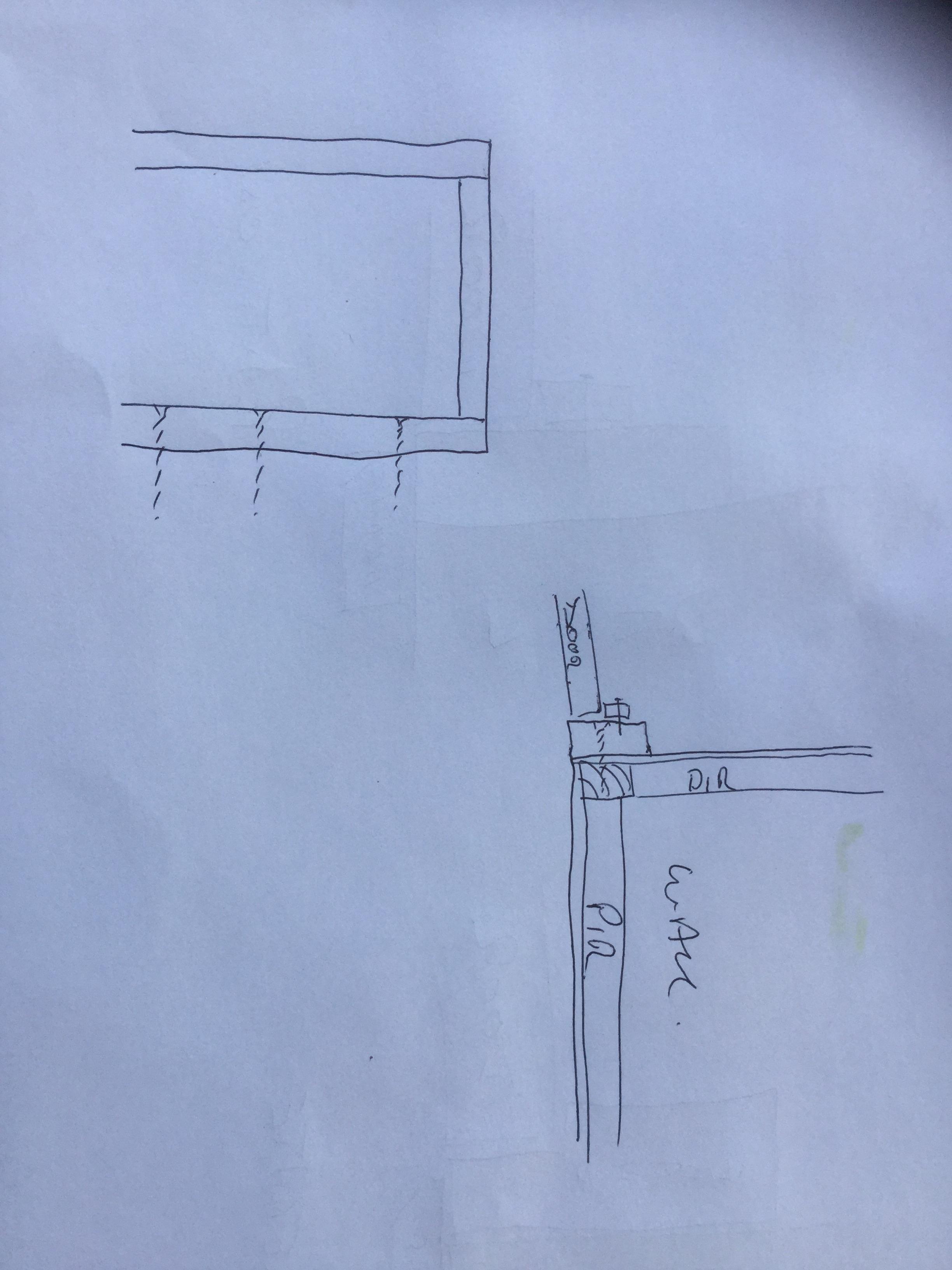

On 24/10/2020 at 15:49, PeterW said:
As the drawing from @joe90 that shows the difference with the frame types. The force on a frame is tiny - you can use the same frame for a 40kg fire door as you do for a 7kg egg box MDF
door, the difference is the hinges and how well you screw it to the frame.
If you’re making a door you may as well make the frame. Use 5x1 Planed All Round timber and then use the rest for your door ledges and brace, and then clad it with T&G floor board assuming you’ve got a standard cottage door.

I'm planning my frame job: so far Ive got ticked to get today '5x1 Planed All Round timber'. So referring back to Joe's Rebate or Plant-on sketch (understand the difference in design) the Plant-on looks the simpler to do, I assume, meaning no big rebate to rout: not easy to do for me here tbh. Is Plant-on sufficient here, with regards to my perhaps not-ideal structure I'm fixing the frame uprights to-?
thanks- zoot.
all my door stops are “plant on”. I just prefer them and more than adequate.

RIGHT, if it were me I would make my own frame from 130mm x 40mm planned square edge (or as near as you can), screwed to the upright timbers, remove plasterboard behind these if you wish but not necessary IMO. Verticals up to the ceiling Then tight fit top piece between them. (This will help stop hinges pulling frame away from the wall). Build your own “plank “ door and fit then buy 40mm x 15mm door stops and fit them to the door afterwards. Quick CAD drawing (crayon assisted drawing).
Just to recap- I'll be going as per Joe's sketch (terrific- really helps). IE I'm going to leave the pB in place/ fix timbers over it.
So the horizontal header bit.. just a friction-fit shaped piece? no need to rebate each end/ joint it to the uprights? and this the same 130x40mm planed square edge I assume (I guess this is same as Peter's 5x1 All Round planed).
The only way of fixing horizontal, is diagonal big f-o screws: is the the only viable way? Its gotta be spot-on flush to the verticals the only prob.. Im rarely good at diagonal fixing/ jointing perfectly. A bit of a sod tbh.

One thing that springs to mind before I start, is the fairly narrow W I have to play with. Ideally if I undid the pB each side I could gain 1" overall.. but logistics of doing/ tidying up adds a day's work for me. The carpeter is chasing me/ got to just get frame in > so he can work.
Do I have the option of putting the door opening instead of 'within' the two 5x1 uprights, on the 'face' of them instead? meaning a wider door by 1" or so, it sort of like a lid closing onto the short sides of the 5x1.
Im just wondering if there actually is any benefit from this, if the opening you go through, remains the same, as its governed by the 5x1 in the same position whichever way. The only difference in the opening being the plant-on bit is awol on my 'lid' idea.. still is less the plant's 1/2" either side tho.
I measure my kitchen (internal) door as same W as mine will be, if I go the standard way & it sits on the plant-on added pieces, like your sketch.
Narrow @ 28" opening (measured plant to plant) but never feels 'restricted' in kitchen.
So back to this idea. Its just the fixing in of the header that concerns me/ if the load is taken by this essentially/ how to get right.
I think you will have trouble trying to have the door “outside” the frame, if your worried about width then cut back the plasterboard which will give you an extra inch. Re the header, if fixing is a problem (why? What is above this?) then use no nails.

there is no load on the header, the building should have a lintel of some sort holding things up. If you put the header in first, the uprights (if fitted tight floor to ceiling) will hold it in place, aided by no nails.

Right, if you want the header to help keep the uprights against the walls rebate them slightly and screw. Fix the header to that stud work.
@joe90 ok understood, but isn't getting a header piece tight between though, effectively the same principle.. but easier to do-?

Screw the header to the top of the uprights and slide into place.
Ah yes.. didn't think of this! that's an idea but I was thinking best way to get this bit super-tight was fit L & R 1st, whittle down the header bit until I get it super tight. I'll never be able to get it super tight screwing it onj 1st. Rebating that bit.. not easy either.

screw the frame together as @PeterW suggests and slide it in, then  hammer Thin wedges under the uprights at the floor (which will be covered by carpet) and this will make it a very tight fit.
