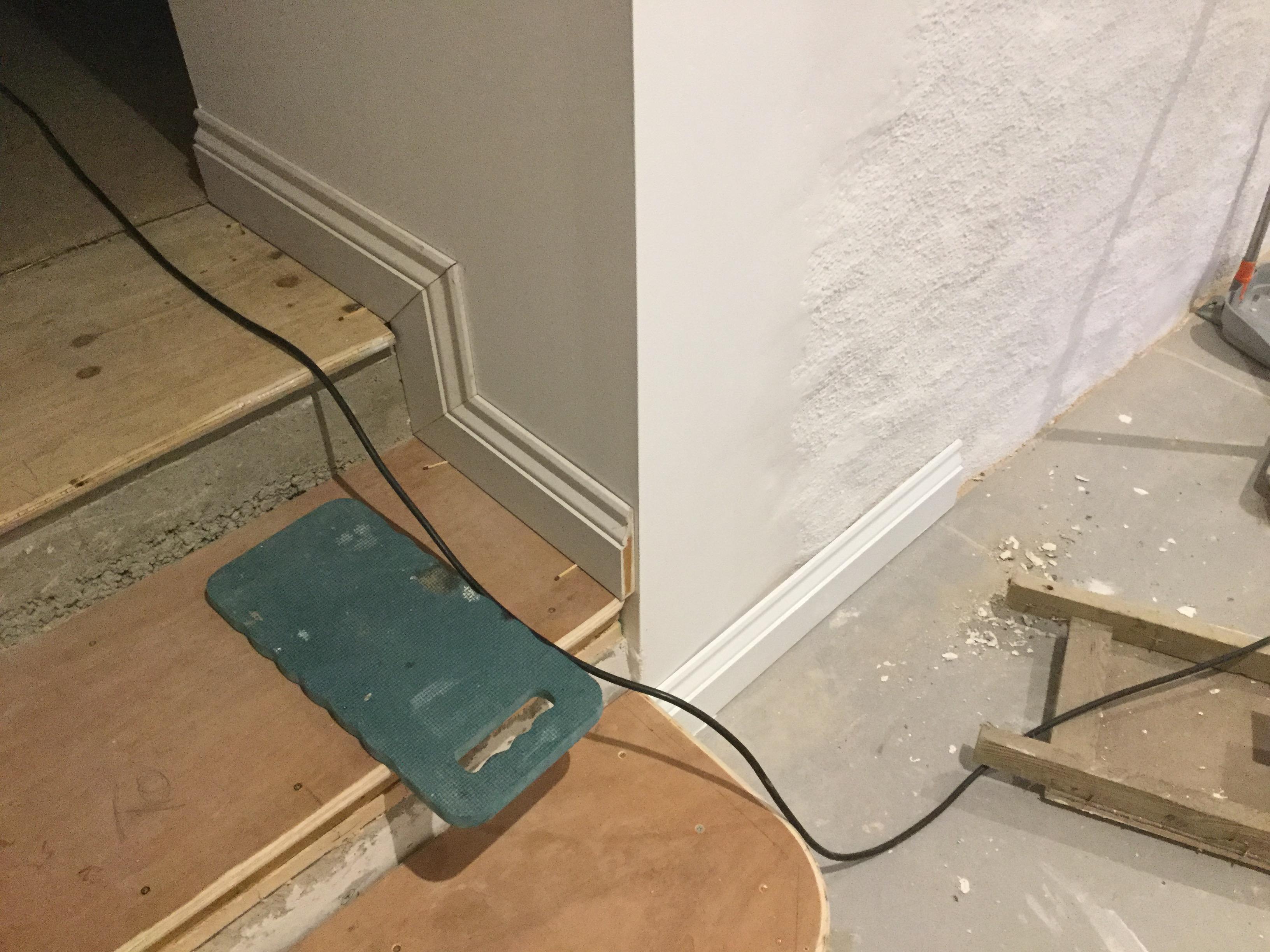

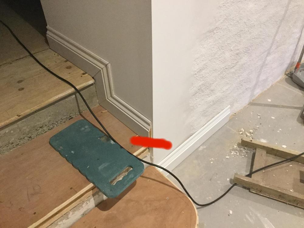

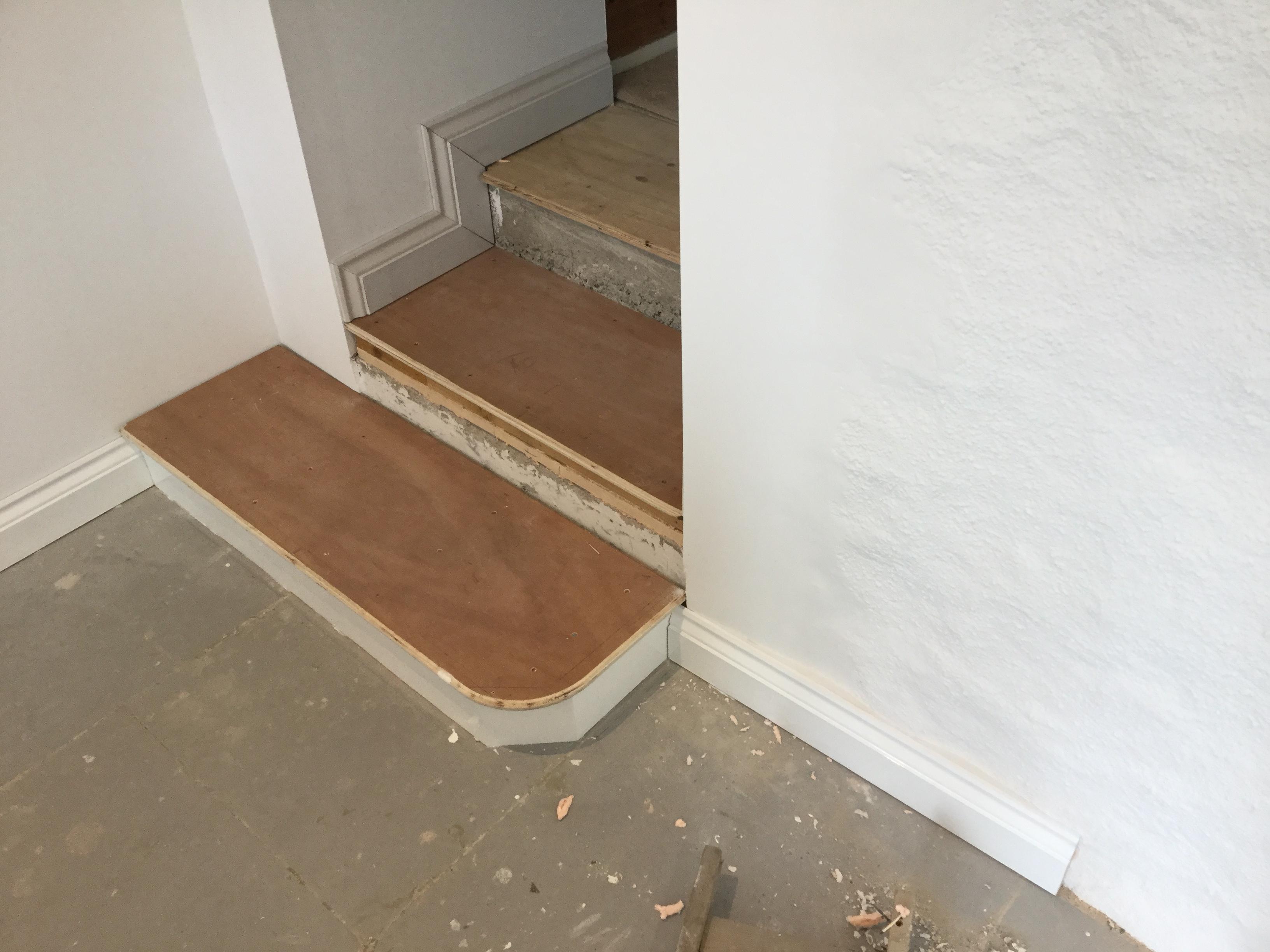

@joe90 joe what do I do here. These 3 skirt bits not glued in yet.
Ok I need to edge the front skirt bit w'summink as it looks odd (I can't continue it on into room- too tricky & no more skirt left, both L&R sides so has to end here). i know its a bit of a compromise.. but will have to do.
Pic will follow/ edit/ gotta jump onto my flippin ipda.. zootmultiflippintaskhorn.

I'd end it like that but put a 45deg chamfer on it.
@Onoff great that's a plan.. but in practice with a router I can only see the bigger 18mm section getting cut/ the profiley bit just gets left as it.
Is that what you had in mind? IE the 45* follow-guide-bearing on the bit will only hit the larger 18mm side.. it'll be above the profiley bit. I think.
@Onoff or did you mean champfer edge, with a chopsaw tilted over?
Any idea what these damn mdf ends can be painted with? I put woodpaint on, come back & its dissapeared/ gone back brown again.

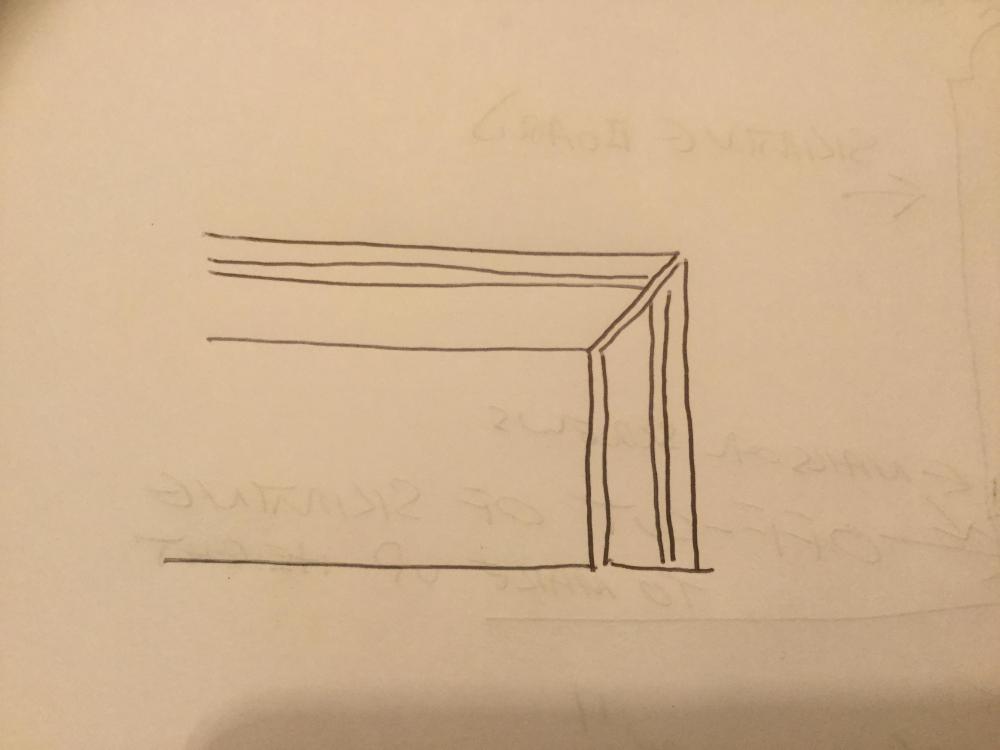

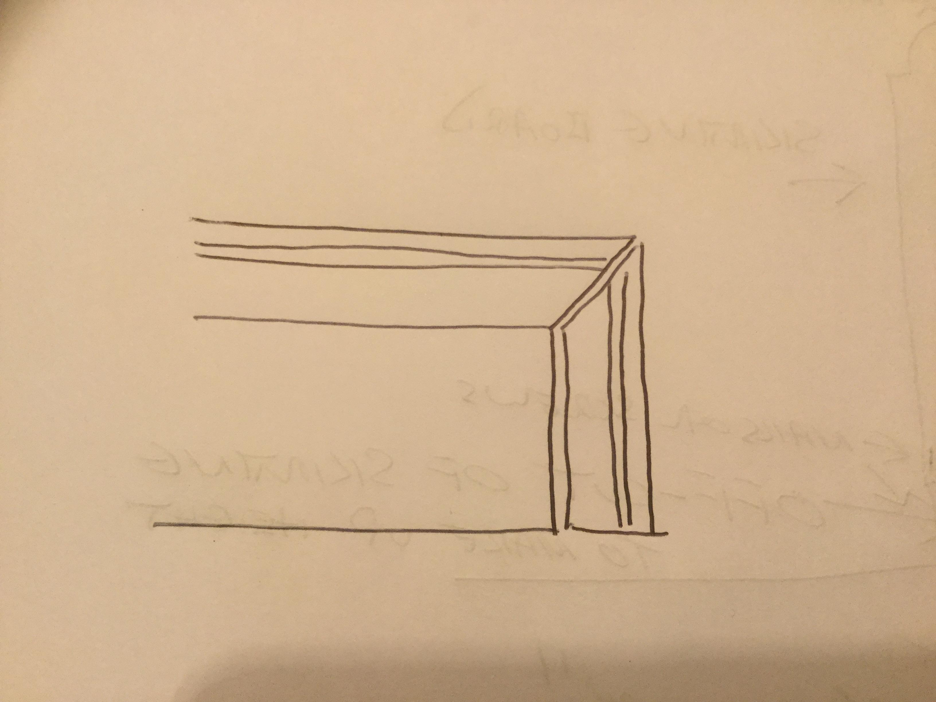

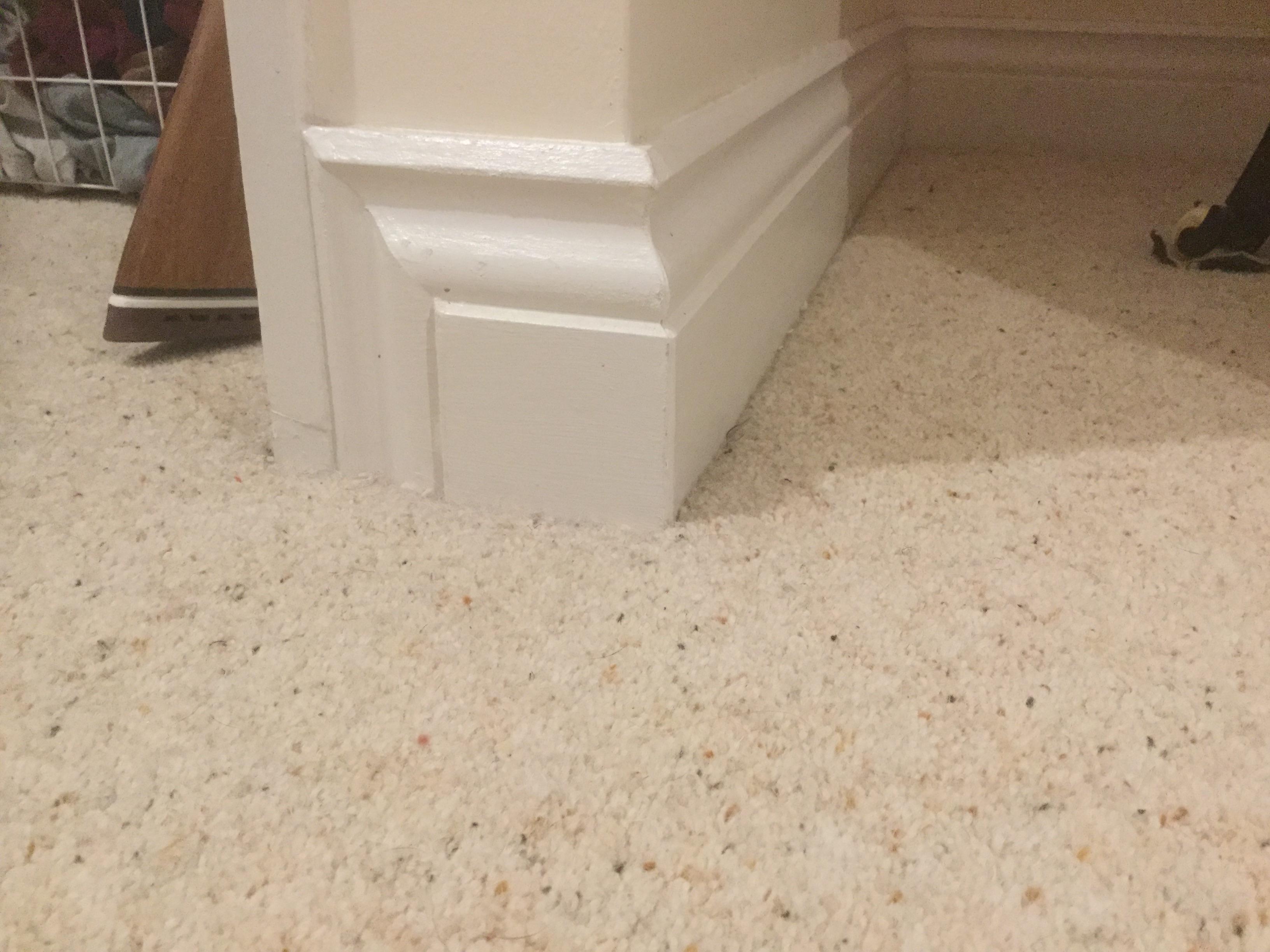

Nah, remember my pic way back. The one with the air rifle!!, it’s done like this..... gives a vety professional finish
edit, are you not going to put a door frame in?, that needs to be done before skirting, and the bit you cut off will do the edging ?

@joe90 I'm lost.. dunno where you're referring to exactly with the sketch joe.
Isn't Onoff suggesting just nipping off like 1/2" off my front edge of the mdf?

if that suits you but would prefer my idea.
@joe90That pic does my nut in. I can't figure it out, or rather can't figure out how that could be done with my area.

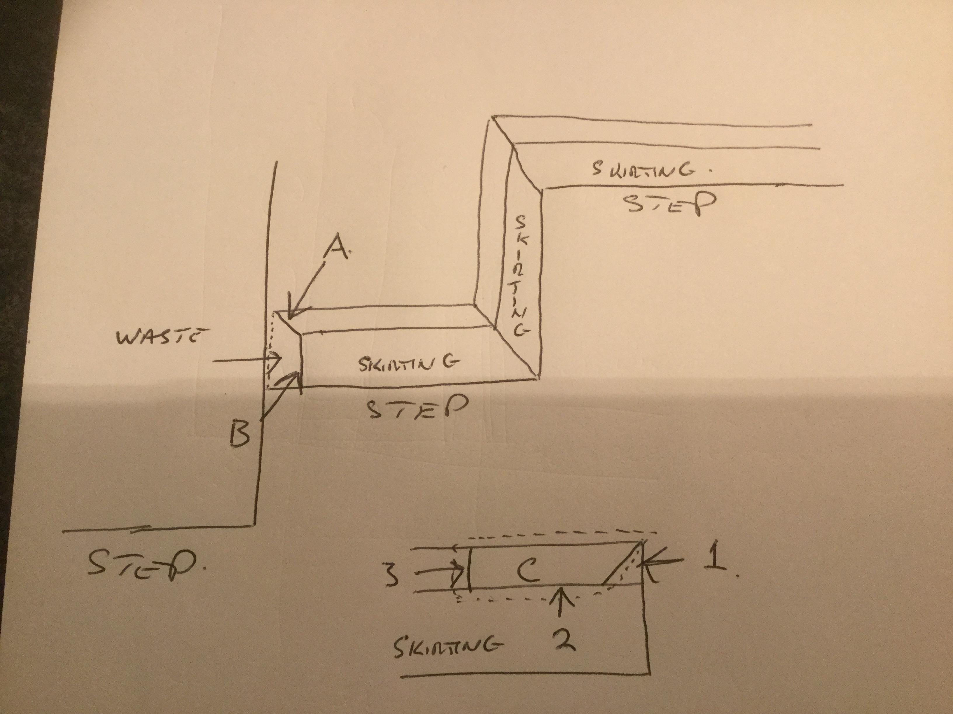

Right, woodwork masterclass coming up......
A/  cut bottom skirting piece at 45’ through moulding.
B/ from bottom of moulding cut 90’ to base of skirting, remove waste.
C/ from spare piece of skirting 1/ cut 45’ to top.
                                                        2/ Cut along bottom of moulding
                                                        3/ cut piece to length
glue piece C where waste was removed .
TAA DAA
On the next project have a look at using skirting blocks. More traditional but as a skirting block is a bit thicker you get a bit of play in the butt joint between the bottom of the door facing and the top of the block, also you get the same where the skirting meets the block. This  cuts you the slack to get the mitres right. Glue them to death and let the shrinkage take place at the block where it is more easy to hide.
While some of these traditional methods may seem like a lot of extra work they were not daft in these days and knew how to work with the materials they had at hand.
I meant just chop off with the saw set at 45deg:
4DA4F7A3-8A14-48E6-9A9B-E2BDFC2C096F.thumb.jpeg.1b597ca215c5e91c9f330b861c5e0a5e.jpeg.13cca5ad6443fb31aedb0dee3ff7b850.jpeg
@joe90 right Im on board with your idea now.. great thanks for that/ this will be neatest way. Nice idea whoever thought of it too.
These bits of skirt not fixed in yet: plan is to fix in all but the top step piece, as the door frame needs going in before this bit. Ive got carpeter penciled in tues you see.. so I need to do frame, plus put these skirt bits in, paint them all.. before. Jeepers.
@Onoff yes that's what I thiought you meant- I'm left with the annoying 'end' of mdf tho this way, which seems to remain brown mdf'y even after 2 coats of woodpaint unlike joe's idea/ the visible edge primed. thx

I did, I just could not face a cut end of skirting. Done it on a few projects fir others when I was working and customers always pleased. Use mitre bond fir the joint and it will set in seconds, bit like super glue for wood, no need to clamp just hold together for 20 seconds and it’s set. You might consider it fir those pieces of skirting down the steps as well! .   +1 on mdf primer.

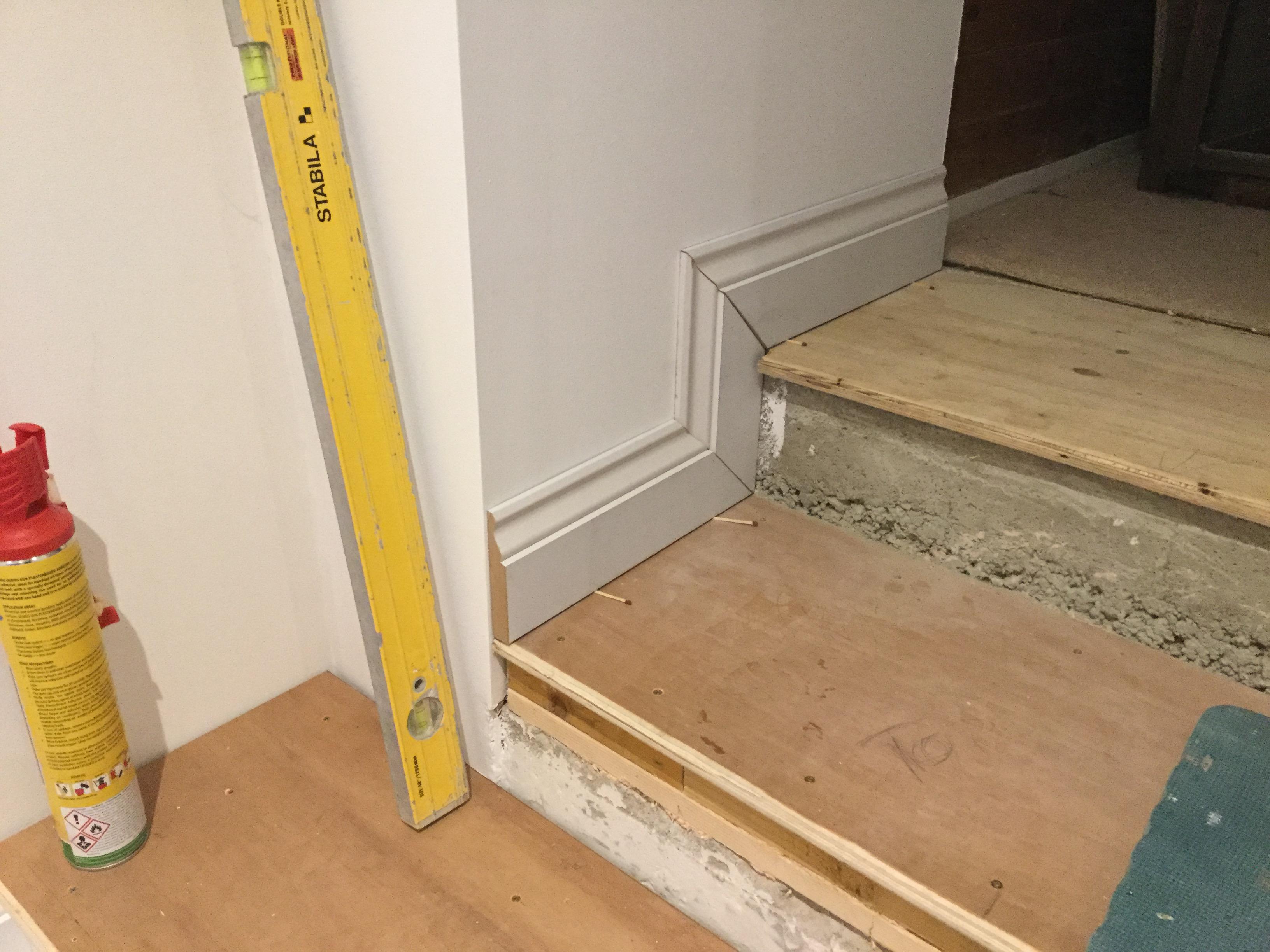

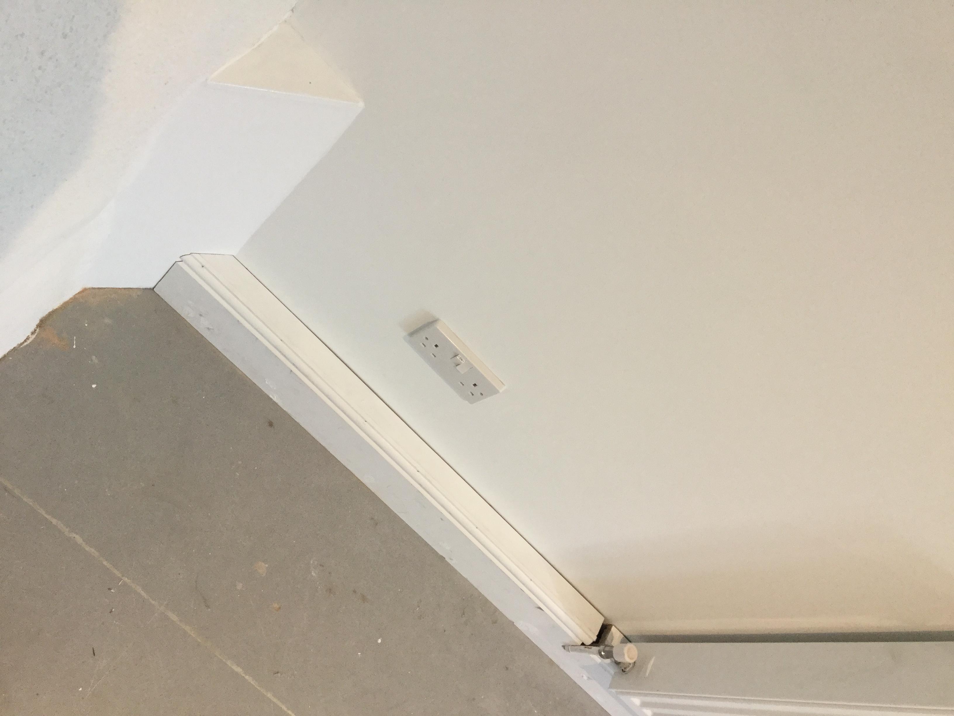

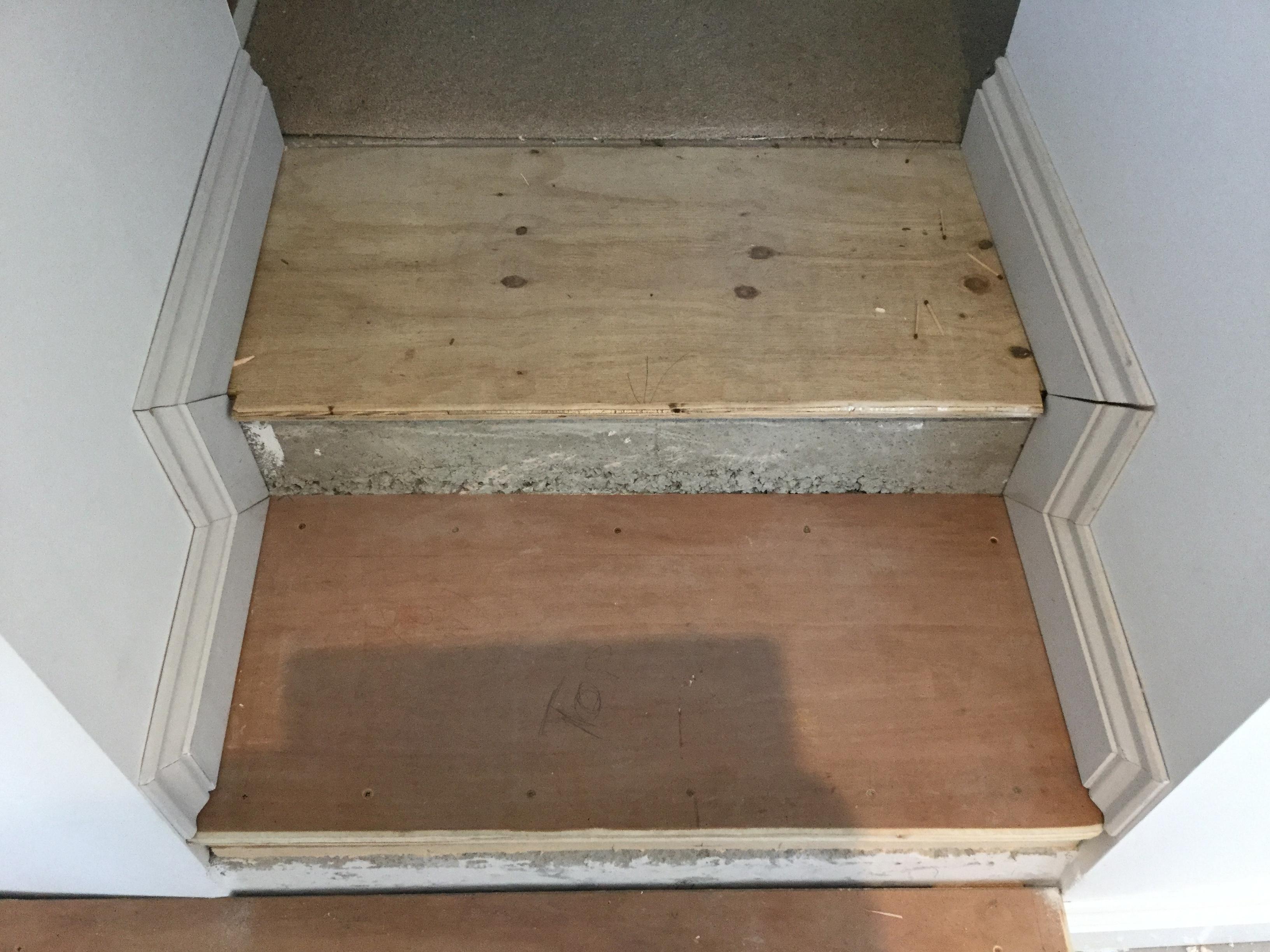

@joe90 progress so far.. the top step skirt piece not glued in, due to needing to be cut to the door frame/ leaving until.. but other two pieces each side are fixed in. Great idea yours.
Funny single skirt bit rhs.. the inny outy old wall prevented putting skirt all along, i offered it up but had to be a banana bending, not ideal to fix in With this pressure wanting it to spring out, or to carpet to surely. Even splitting into 2 bits dinnae work, a big iffset where they met. So compromised, bed will go next to it, and bedside cabinet covers it this side.. rrhs another something covering the vacancy.

Well done mate, looks really good, yes wobbly walls are a pain, that’s what filler is for.
You may get away with 5mm but I would do it in two goes. First fill and wipe with a baby wipe so it is below the surface of the gap, then when that is dry do another layer.
