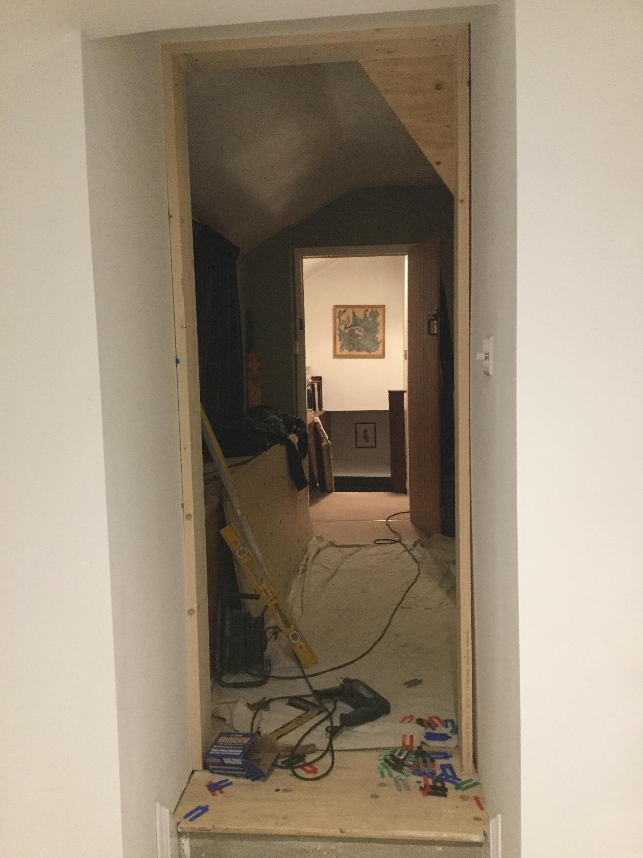

Which way do you mean joe? towards camera, or in away from camera ?
Anyway Ive had to crack on, so the top of lining is proud / towards us. Btm is flush. Ive got lining offered in/ plumb etc/ looks great. Packing away but all falling out/ sods. Anyway I gotta fix in the header really before packers i just thought. But before that I need to consider the block:
Ok next problem is the lower 1/3rd of jams will need to fix thru the pB > into the block behind (no timber on these two lower corners). Ok I'm loathed to move my lining now, spent ages getting it plumb/ sqaure etc.
Is there any way of fixing thru jam into the block, without moving the timber away? or is thye only way drill pilot hole/ remove whole shebang/ put in plug/ put whole lining back in-?

I drill with a 6mm drill through wood and into blockwork,  carefully tap rawlplug (red) into the wood , hammer it through  into the block with the screw and a hammer and then tighten the screw.
Or use 7mm drill and brown raw plug.

Frame fixings. Counterbore the jambs first with a flat wood bit. Then cover with the stops.

He probably used frame fixings.

be carefull drilling next to the edge of the block, especially at the top if the frame is proud, it will probably split the edge off the block, if it were me I would still move the frame into the opening a bit.
I think I have some in fact.. but wtf is the difference between them & a plug & screw?! does my nut in  (hence spark looking at me like an idiot.. I think cos I tried to use them, like you would a normal plug.. & couldn't work out why it kept spinning iirc).
You see unless I understand what the difference is, I cant really know how to use them properly.. & they'll spin again.

I think I can fix to the block ok if careful, & put them in the inside/ away from camera.. maybe fill nearside with pB glue foam as a fix.

Just done- but still dont understand. I have right here 8x80mm ones. I look at youtube it says drill 8mm hole > he fires it in, tightens it up in 30 secs.
If I have the plug section head, -wider- than the head of the screw............ how the flying feck can it pass thru the 8mm hole??????? magic?????
Ive never known such a head****. This is why I had to get my spark to do it once (did it 30 secs, but the ^ with some from this very pack, but Q remains). does my total nut in.

Going pretty good, lhs jam fixed in, solid, no frame screws! Had a bit of stud i could use, actually all the wobbly stud i was worried about fixing it to, all behaving.. major luck that.
I just got to kick out me rhs jam.. & nearly done:

It doesn’t ... head of the fixing ends up on the outside of what you are installing - the “plug” fits in the timber but doesn’t go all the way through.

Right!.. no wonder my spark looked at me funny. But I just tried it.. & disaster/ the screw spins in the plug/ no torque at all. 8mm drill hole, felt it go into the block behind, pushed it in, I mean wtf.

yes depends which fixings you have, some are hammer as Peter says, how did your spark do it, hammer or screw?, try bashing it in a bit then screw.
Tried another, got this one gently hammered in, but way too tight so then head has blitzed/ driver not anywhere near the power, cannot remove it. absolute disaster. thank -god- its the non-hinge side.. but I still need to fit it in. i dont suppose p'B foam glue will have the strength to stop it bowing out over time. hateful things.

Sounds like you did not drill deep enough, needs to be a bit deeper to accommodate dust etc. Did you have the correct driver bit? They are usually no 3,s
