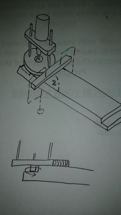

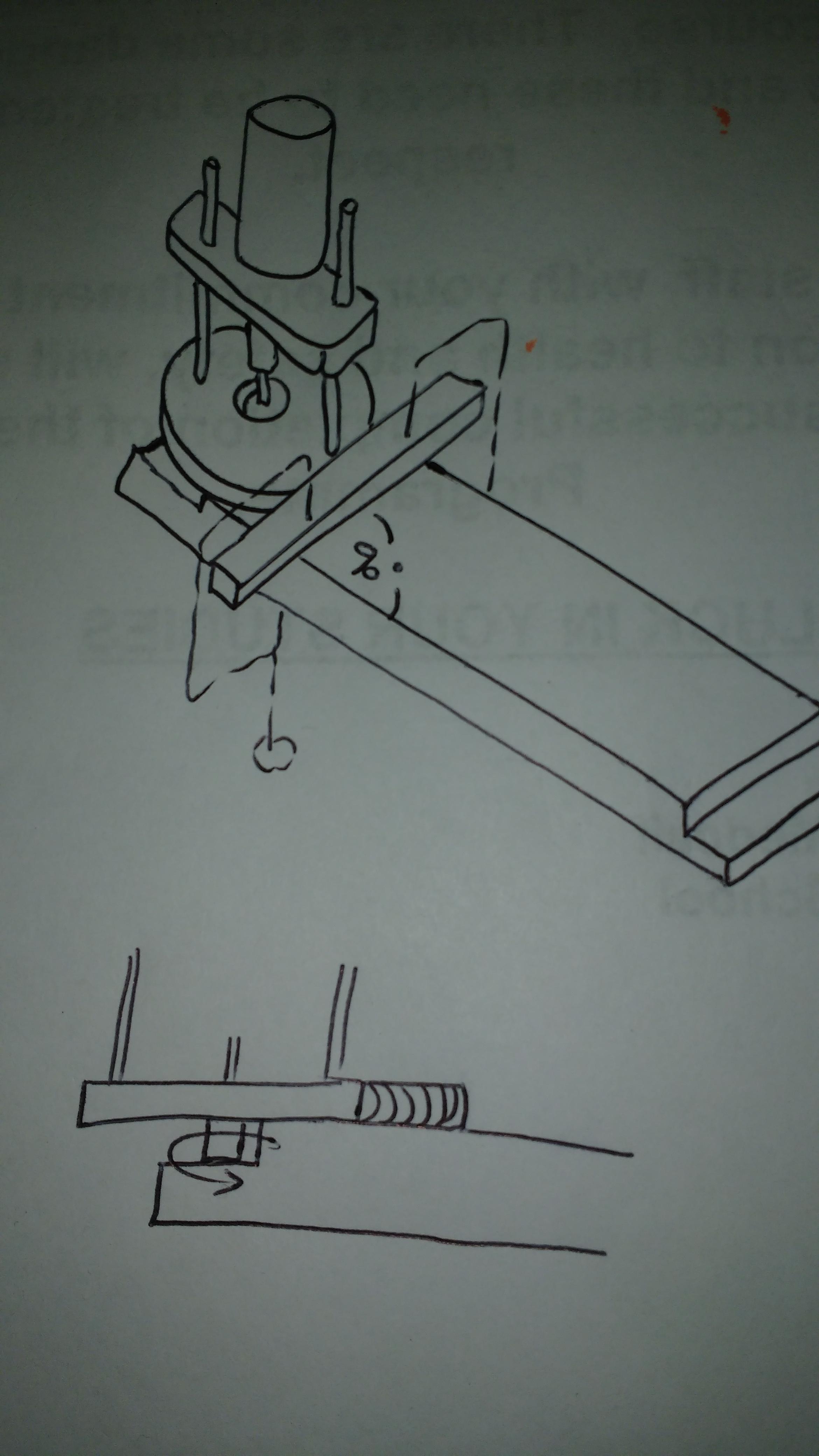

It's pi$$ easy. If making them yourself just clamp a bit of timber square and route against that. Old school would be a tenon saw to depth then chisel.
@Onoff very neatly done. I do get the rout idea too, & like your router doodle! But one difference yours to mine: you've fashioned the opening to accomodate a frame lining kit, with specific rebated positions, to accomodate a regular 2'6 or 2'9 door. Plus a regular door H too. I assume.
Me here I'm designated by my 800mm opening (actually 790mm cos its got a midrift hump). This will equate to a 2'4 door more or less. And the H likely different too (but here I guess its just a Q of nipping off two ends of the jams, even in your case there).
So as it seems better quality, & has the slightly bigger D @ 33mm, & has one side rebated already.. could I not buy a kit & just rout either header rebate 'inwards' 2"? then I know I have correct wood guages for a casing/ lining, one side rebated I could 'copy' (and also hasn't it got the planty bits inc too?)

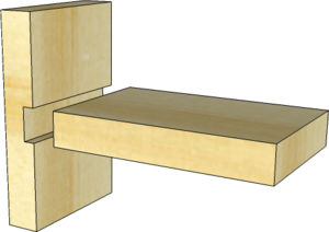

Ah I see! Yep, route another through housing to your heart's content Zoot! If the new housing overlaps with the old you can infill with a bit of any old scrap wood, glued and pinned to keep it tight.
A through housing joint:

Now -I'm- lost. Afaik, & looking at the b&q clip, I fix the jam into the rebated trench, screw/ fix.. then saw off the excess. So I don't understand why the trench bit if I sawing the excess bit off (just to keep it nice & perp b4 you screw it together-?).
Yes I think joe explained my plan. Just shift one rebate inwards, I think 2" or so, once Ive determined my header W.

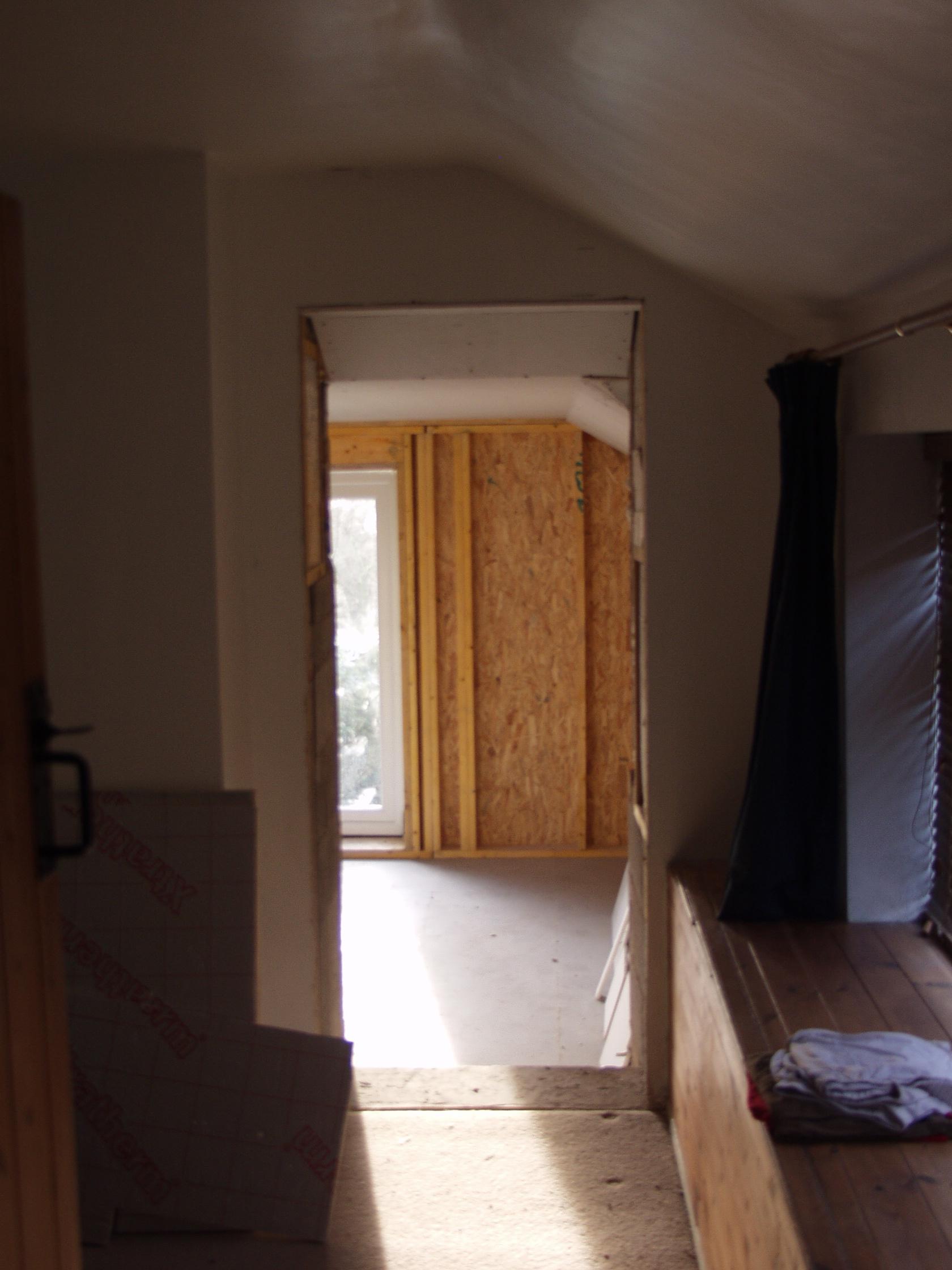

@Onoff ok made a start/ routed my new rebate slot. But Ive come up against a big prob immediately.
The two sides for the jams, where they fix to, are not bad/ just a few shims top & btm each side.
But I just put level on the upright, just around the corner (so where the facing arch will attatch to the side of the jam).. & to achieve it plumb, I have a 1" discrepency/ gap at the LHS top.. & a 1/2" gap at the RHS top.
So the frame will either stick out at the top (protruding into the bedroom the door opens 'backwards' into).. or if I put it in flush @ the top the arch will protrude at the btm/ huge gaps: I assume this way is n/a.
Can anyone help me out here? time is really pressing now.

I think I understand what you mean. So basically your walls are pi$$ed?
As ever, photos would help.
Whatever you do your frame needs to be installed square and plumb. I'm thinking architrave might mask the issue and you'll fill behind it.
The joys of an old house with wonky walls. Welcome to my world.
Edit: Is "arch" your shorthand for architrave? I've just spent minutes trying to figure where your "arch" is. Use proper English like wot we do.

What side are the hinges going on in this photo?
@Onoff hi there. Right hand side hinges, door opening twds camera. Yes arch = architrave (apologies).
My pi$$ed walls: ok so as we look at the pic, the wall facing us (as in where the new shut door will be) its TOP is tilting -away- from camera.
So when my lining goes in & I make it flush with the btm and PLUMB.. I'll have the lining 'jutting out' twds camera at the top.
I assume this is the correct way to put the sod in plumb -IE- not having the top flush to the wall up here.. because lining will be 'inside' the opening at the btm if I do it this way, & the arch won't be able to fix onto it.
