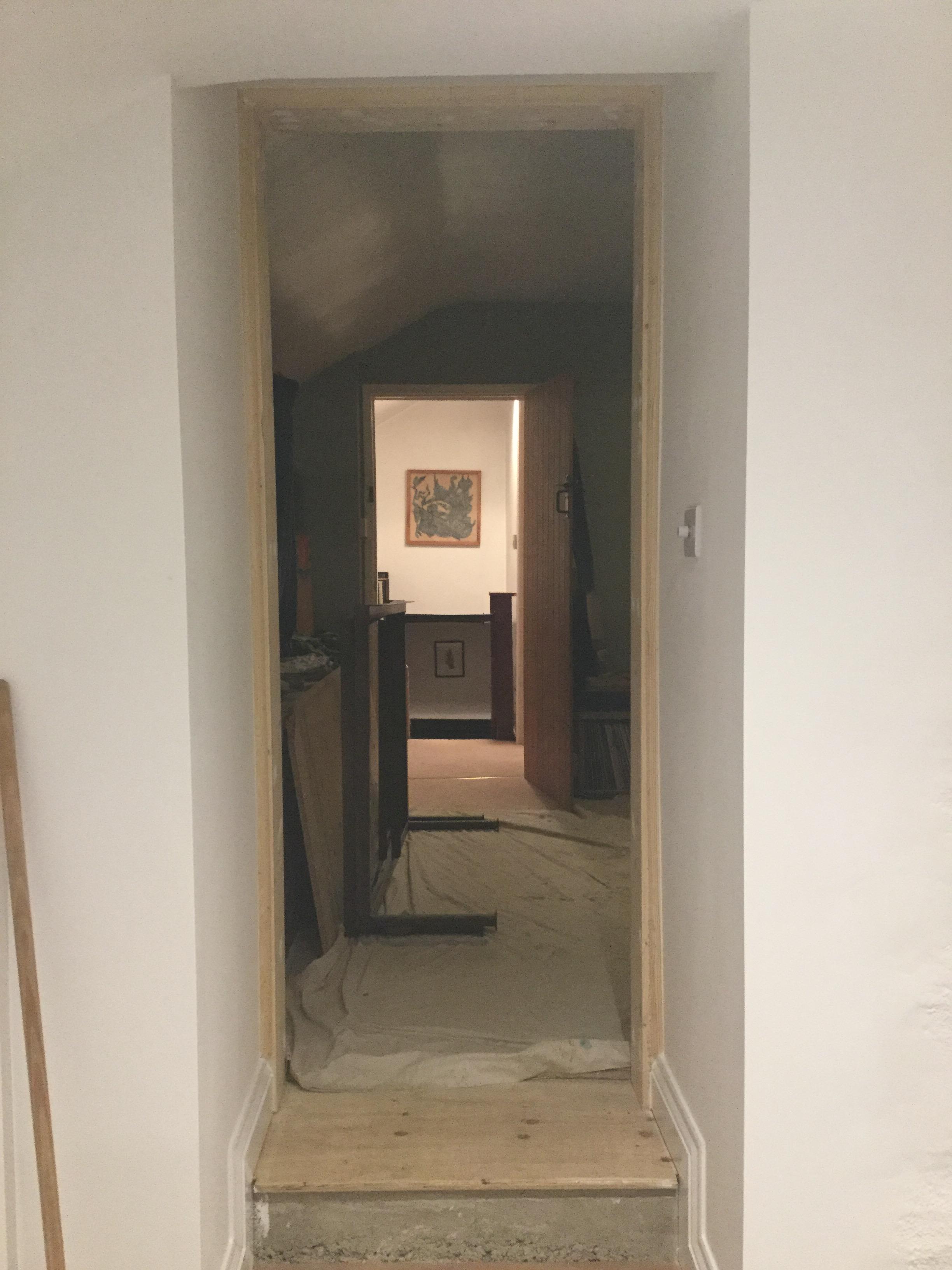

ok im really up against it timewise now. Carpet is monday. Ok so what do i do next, with this in mind.. ie just to prep ready for him?
i hve to put something covering the rearside, i cant put architrave here as its too wide. I gotta do whatever this strip is, then fix last but of skirting in, then presumably if he got to carpet in outy around it..  the 3 plant on pieces too. Then the ffrontside architrave strips on. Then paint it all 2 times. Jesush.
Quarter moulding.

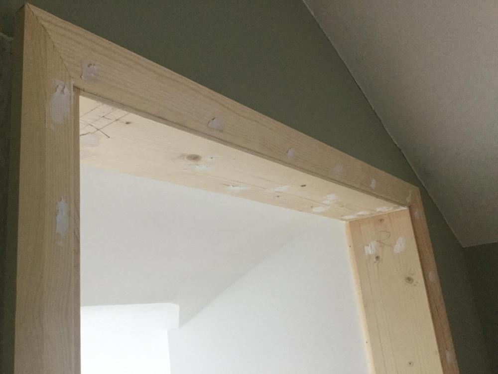

What architrave  to put on front.. my other doors have a very plain/ simple ramp type shallow slope, with a flat top. simple as. Be nice to follow suit. I guess I just pick one out once Im there.. But is there any specific word/ term for this fronside addition I can look online 1st? I thought arch.. was ceiling detail.
Seen your quadrant moulding stuff @joe90 thanks/ ok 25x25mm stuff going on the back side then.
You could run ordinary architrave through a table saw so it's the same width as the jam. Thus the taper would match the full architrave. Saying that it's common to have the architrave set back slightly from the edge of the jam:

Hi Onoff- no table saw this is the problem. I just need, ideally, to find the front section like your eg here (the back section I'll do joe's idea/ simply 25x25 quadrant moulding- great).
So is the stuff you've put on here, almost exactly what I need, called anything?
is it cut down 'architrave' or is it 'door lining moulding'? or another name? does it come in usual widths lke yours looks to be ~ like most doors similarly so.. or did you have to run this thru a table saw & maybe cut off 1" from its whole width?

Ok understood- Ive done the backside quadrant (a bit of a mess!) & frontside architrave/ found exactly same stuff as my other doors: I ve put it all 1/4" set-in allround for hinges.. if its not enough I'll have to chip away at it a bit.. bit needed all the lining width as it was only 27mm as it was.. so 21mm to fix arch.. to.
Ok Im seriously up against it timewise- these 4 bits plus last of skirting took the whole day. My other doors have the hinges tucked in between the arch.. and the edge of the door lining/ so I  cant do this now, but, I presume (hope to goodness) I can add hinges onto what Ive done, later-?

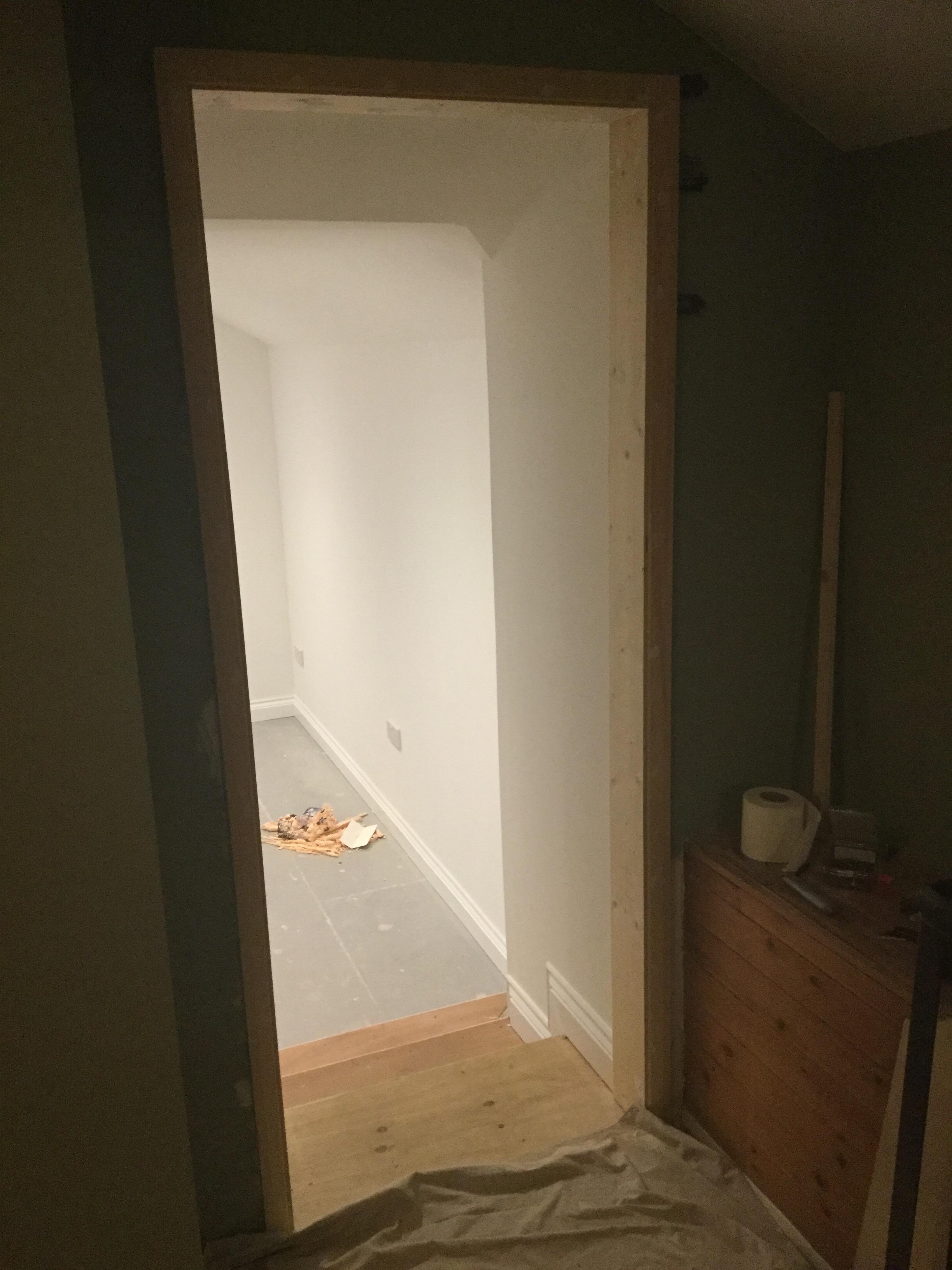

Right- last bit to consider is the easy-to-fit plant-on 3 bits 8am/ then blitz painting all day (I'll only be able to do 1x overcoat, not enough time to do 2x now) before carpet man monday.. hope to fk its dry. terrible night last night.. CH system woke me 3x during night so I'm majorly up against it now.
Could you run me thru where to put these plant-on bits.. do I have a choice where, or are theu dependent on something (door thickness-? what lactch/ catch thing I plan to use-? anything else-?).
thx zH
1/4” will be fine. Problem with the plant on door stops is you need the door to fit them too, frankly I would leave them off till you build a door, you can instal them with the door (when it’s built) and paint them afterwards, just protect the new carpet with plastic sheet when you do.

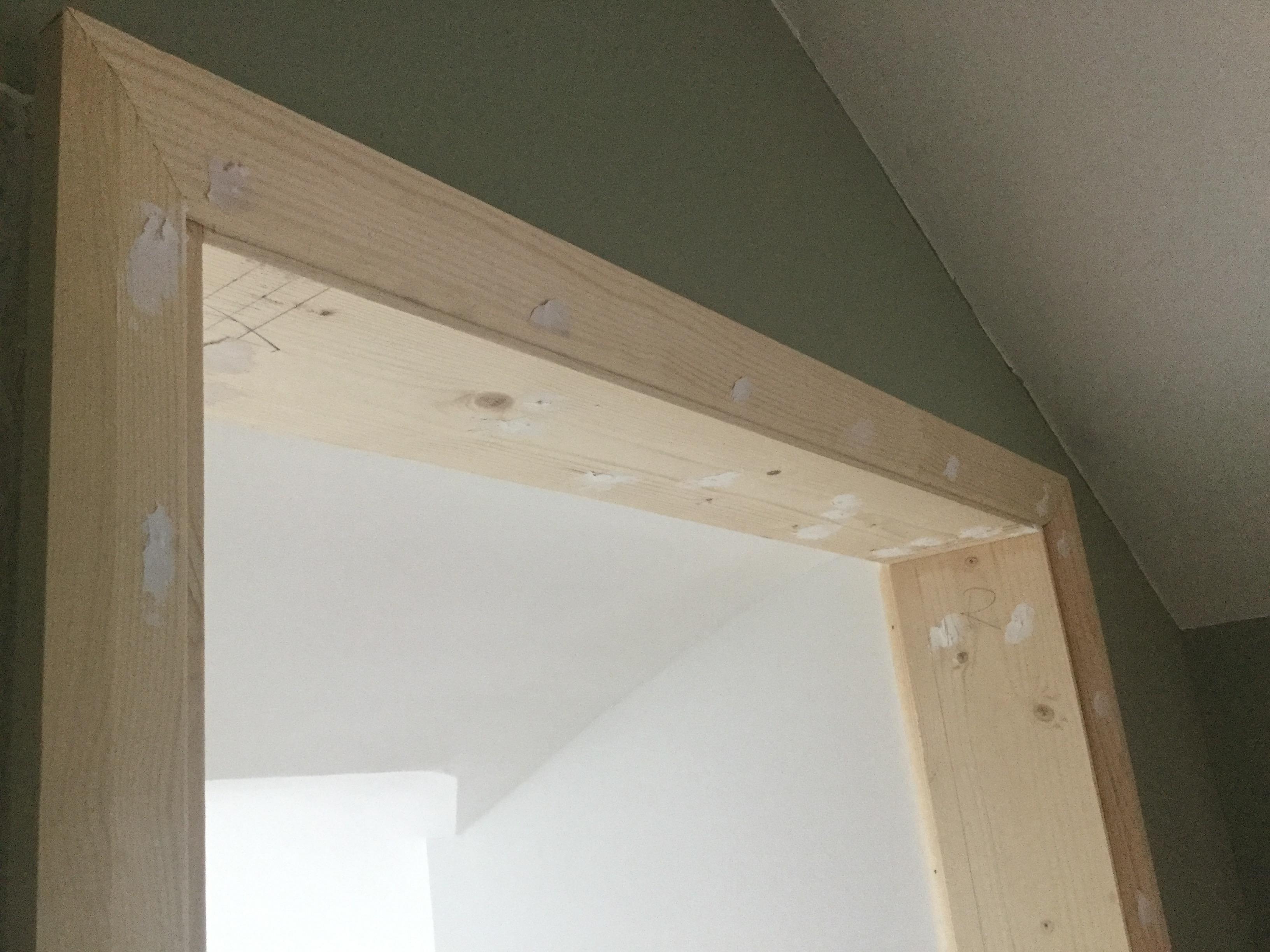

Looks like each side's a banana but is straight, bar a few mm's top to btm: even putting a square brace on both top cnrs, I still couldn't get sides plumb, so had to undo braces. So Ive got abot 3mm gap top L to top R across the width too.
Far from perfect. But I dont think I could ever get better for a 1st go.

Don't be surprised when you hang the door if it's flush one side where the hinges are and not the other where the latch is, either out at the top or bottom. A laser is tbh better imo to plumb frames in than a spirit level. Cross that bridge if and when we come to it!
When you pin your shuts on:
-Shut your door.
-Do the head shut first then the sides.
-Cut all to length.
-Slip 1mm packs between door and shut, allows for paint thickness
-Pin shuts using (supplied?) panel pins but don't knock them fully home until satisfied as to how the door closes
-Punch them just below the surface, fill and paint
Edited by Onoff

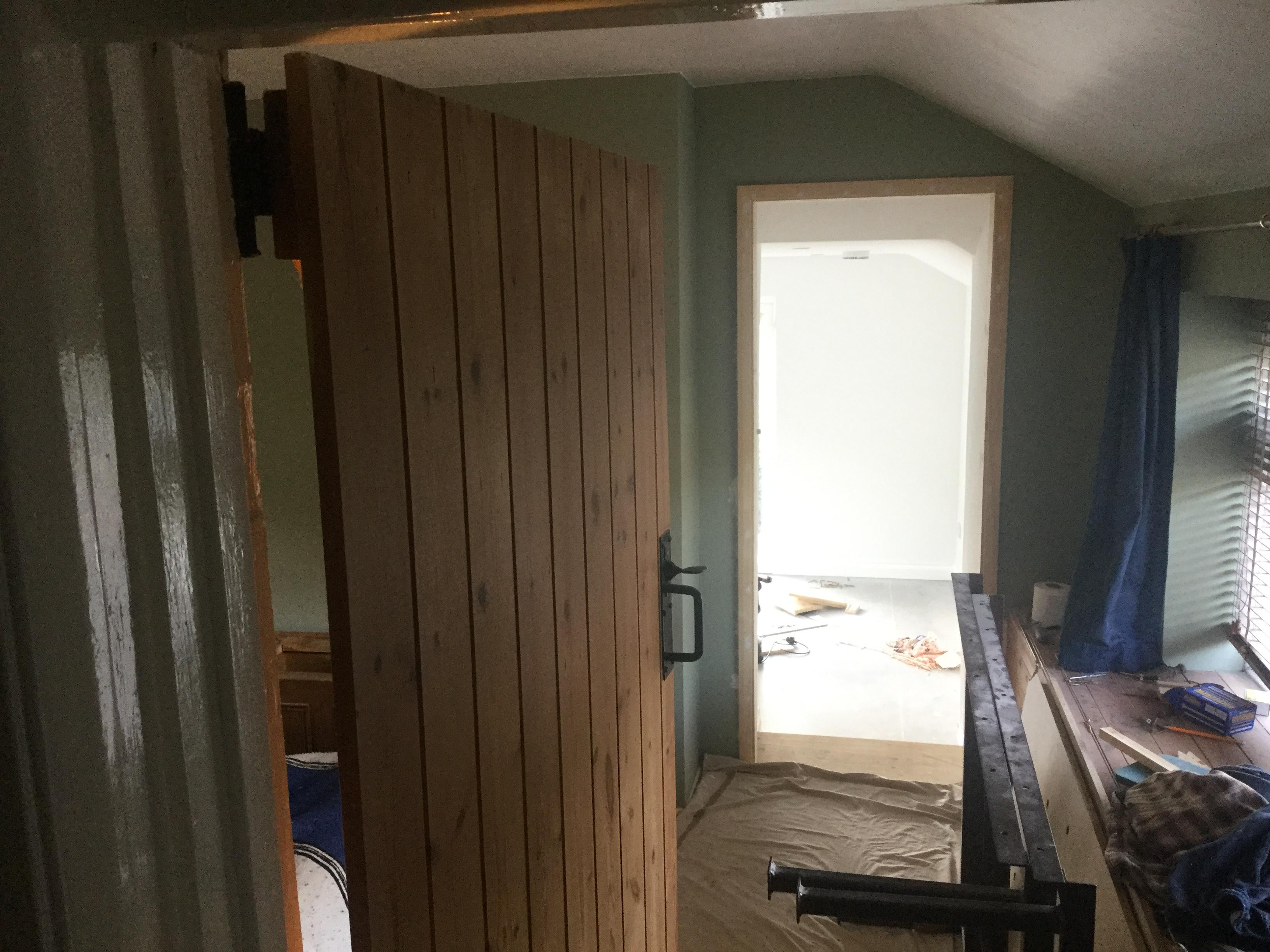

Are you going to just make a braced door or a braced and framed door?
Shuts will either sit against the boards facing the door or the braces.
I made a braced stable door for a freebie shed out of scrap. I just routed grooves in the edges of the rough 4x2 and used ply strips as tongues.

@Onoff nice barn door.. so many screws.. so yes this sort of thing, but good thing is i only have to match the decently diy'd standard of the other two nearby, and copy them, and get same t&g boards, even the same cheapo latches to match still fs in Charlie's.

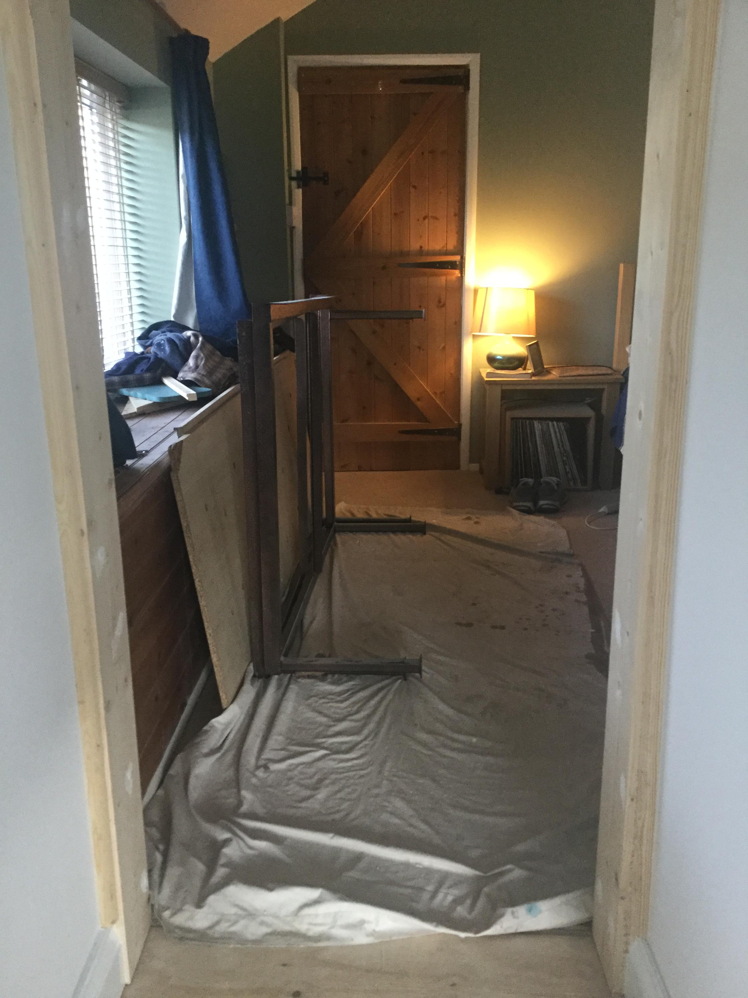

You can see the door I'm gonna copy in background of pic, circa 1985 or so. Basic, but do have an authentic cottage feel.
I'm just going to do this by skin of me teeth/ overcoat should be dry @ exact time carpet man comes. fingers x'd its dry.
