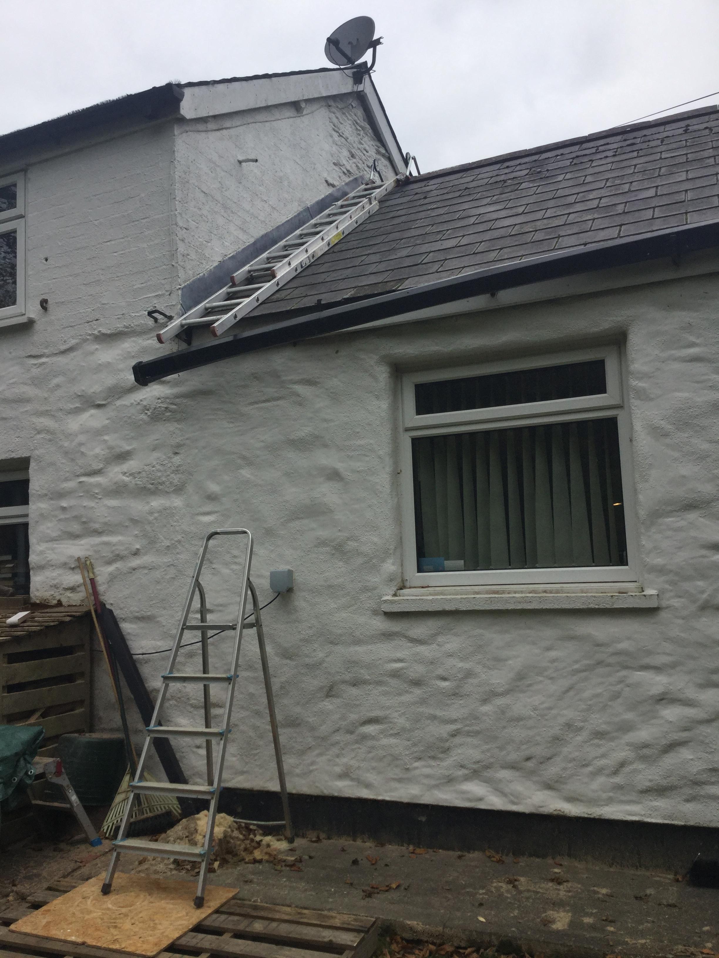

3 hours ago, zoothorn said:
Yes but how much, just 30min job to undo me dish? no if hooks designed to add to a ladder, & @ £13 clearance in jewsons. .they stay on!
What I was wondering if I'm only ever meant to use the top stage, even being 4' short of the gutter, then to use lower one against wall to get up.. but then s'how bridge the gap between is the prob I'm left with of course.
Yes for a roof ladder, you only use one section. It sounds like the ladder you have is too short to sensibly be used as a roof ladder then?

Well yes I realise each section is too short, but as long as they can be tied together, yes ideally clamped or bolted even, is there any reason then it can't be used sensibly as a roof ladder-?
13 hours ago, joe90 said:
yes this is a problem converting ladders to roof ladders, I got round it by using a u clamp and clamping two rungs together to stop the lower section sliding out. You could always just lash with rope tightly. https://www.ebay.co.uk/itm/10mm-Square-U-Bolts-With-Back-Plates-U-Bolt-For-Boat-And-Live-Stock-Trailers/173312961705?hash=item285a41eca9:g:7sAAAOSwcita9XG5
joe look ive got my ladder here, will be roping Sections together in a bit, and borrow i hope another ladder to get me up to the other.
But i have the last tiles to consider putting pressure upon, and how best to get from one ladder to the other. Obviously not via my steps, these just to undo gutter, if that is the right idea.. i dont even know this.

I have my sections lashed together now, one step shorter, the lash making a useful soft cushion on tiles too. So my roof ladder is sorted.
Can someone just help me with how best to get up to it, bearing in mind the fragile tiles nearest the gutter. It is far better / safer i ask, rather than jump in and attempt however 'obvious' it might seem. Its the transition between the tricky bit id assume.
And can someone just help, is it correct to have removed the gutter, or is it better to have it in place to perhaps rest another ladder against.. protecting the tiles even if damaging the gutter (surely the better option).
thx
Rest both ladders up the side of the roof with the one you will climb against the side wall if possible to stop it sliding. Roof ladder with hooks to the top facing away from the building on the clear side. Bag of sand or ballast on the bottom rung of the ordinary ladder will stop it moving too
Climb 3/4 to the top of your standard ladder (shoulder height to the gutter) then pull the roof ladder upward and lay it onto the roof and push it up so the hooks are over the height of the ridge. Then turn it toward you so it lays on the roof and pull it downward so the roof hooks engage. Now move it back toward the standard ladder so they touch.
At this point I would normally rope the two together and then come back get tools etc then head up.
Getting it down is reverse of above ..!
Borrow another  ladder with a ladder standoff - or make your own temporary standoff. Here's an example
and make sure the ladder goes way past your gutter, otherwise your knees will suffer (again).
Make sure the bottom of the ladder is braced properly (If I can I often use our car for that ) so that the bottom of the lowest ladder (of the three) cannot move under any circumstances.
As to the gutter - use your judgement : I'd remove it but I suspect that removing it might cause more aggro for you.
Make sure you can step easily from the lowest ladder onto the roof ladder safely. You might like to ask someone to stand and steady the ladder (as well as having jammed the bottom of it against something immovable ) to increase the level of safety. Make sure also that you can use both hands while on the ladder. In other words, haul tools up after you have climbed to where you need to work. Only move one of your limbs at one time: three points of bodily  contact at all times. If it's wet don't climb.

@ToughButterCup and @joe90 great help thanks. Did the buffer to stop the ladder shifting/ borrowing a ladder, thethered it to other.. & seemed a fine way to get up onto my roof ladder: which seemed perfectly safe even in its 2-sections tbh/ no cause for any concern. 15 mins to do. no slates dmgd.
A job well done- no more telly stuff in & on my house! well worth the 10:1 prep time to job time. Its called the zoot ratio.

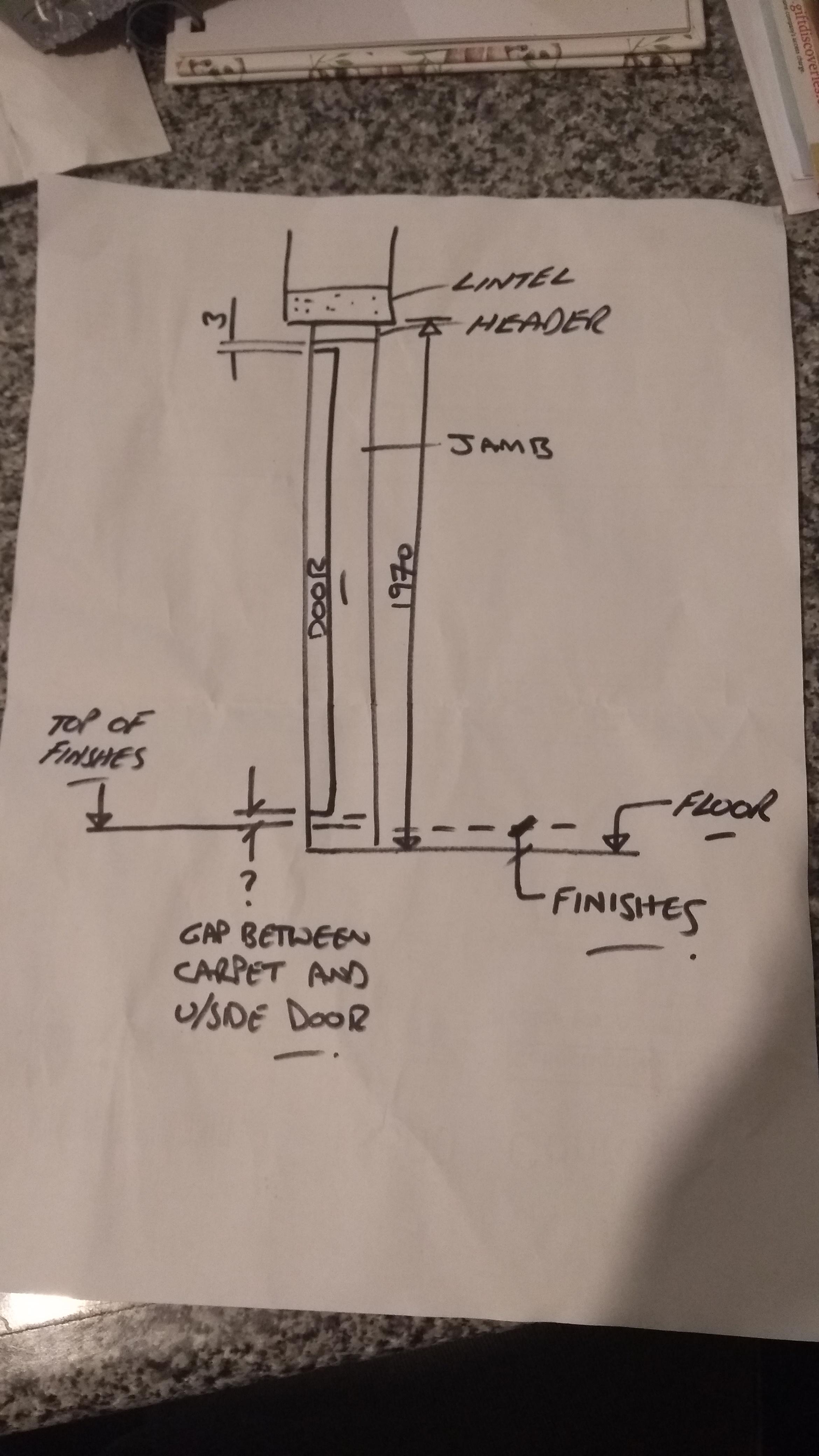

So all I can do is measure my opening: 1970 x 790mm.
@Onoff would it seem like the builder was aiming for a std 2'6 width, then whatever H happened. Will 1970 mean I'm ok for a 1981 door?
With my upvc french doors, if I only have 1875mm from door 'sill' step to door frame top (having to step over a 10cm frame bit too, not included).. then I'd hope I'm not gonna be as constrained heightwise as these double-doors. Why he gave me such low doors I'll never know- least cost to him?
Nope. If you have a 1970mm height from floor to lintel or whatever then a 1981mm door won't fit with out some trimming.
You have to factor in the thickness of the head piece of the frame. You then want a 3mm gap between top of door and underside of head.
What floor finishes are you having that the door will pass over when it's opened?
@Onoff  door has to open 'back', so it'll pass over the existing adjacent room carpet.
@Onoff sorry just re-read my daft Q re. my opening 1975mm & 1981 door! all these newfangled mm's.. I get in a pickle.
What I meant to say was, no I don't think I have enough room for a std H door (another factor of the extra depth 1ft fiasco, my ceiling's 1ft lower/ not where it should be & on my plan was a clear 1900 opening: not done then only today I realise: no reason given as I said etc).
1970/1975mm...neither will fit in a 1981mm gap! ? Get sketching then, to know where you're going. Something like this:
You want 3mm ideally at the top. At the bottom, how much it clears the carpet by is up to you. Sounds like you'll have to cut down a door height wise. Be aware that on cheapo doors there is just a thin strip of softwood around the edge that limits how much you can trim by. For example this circa £20 Wickes door.
Cut too much off and you'll be left with a void filled with corrugated cardboard. You can tbh just cut a bit of softwood to fit in there and just glue it in.
