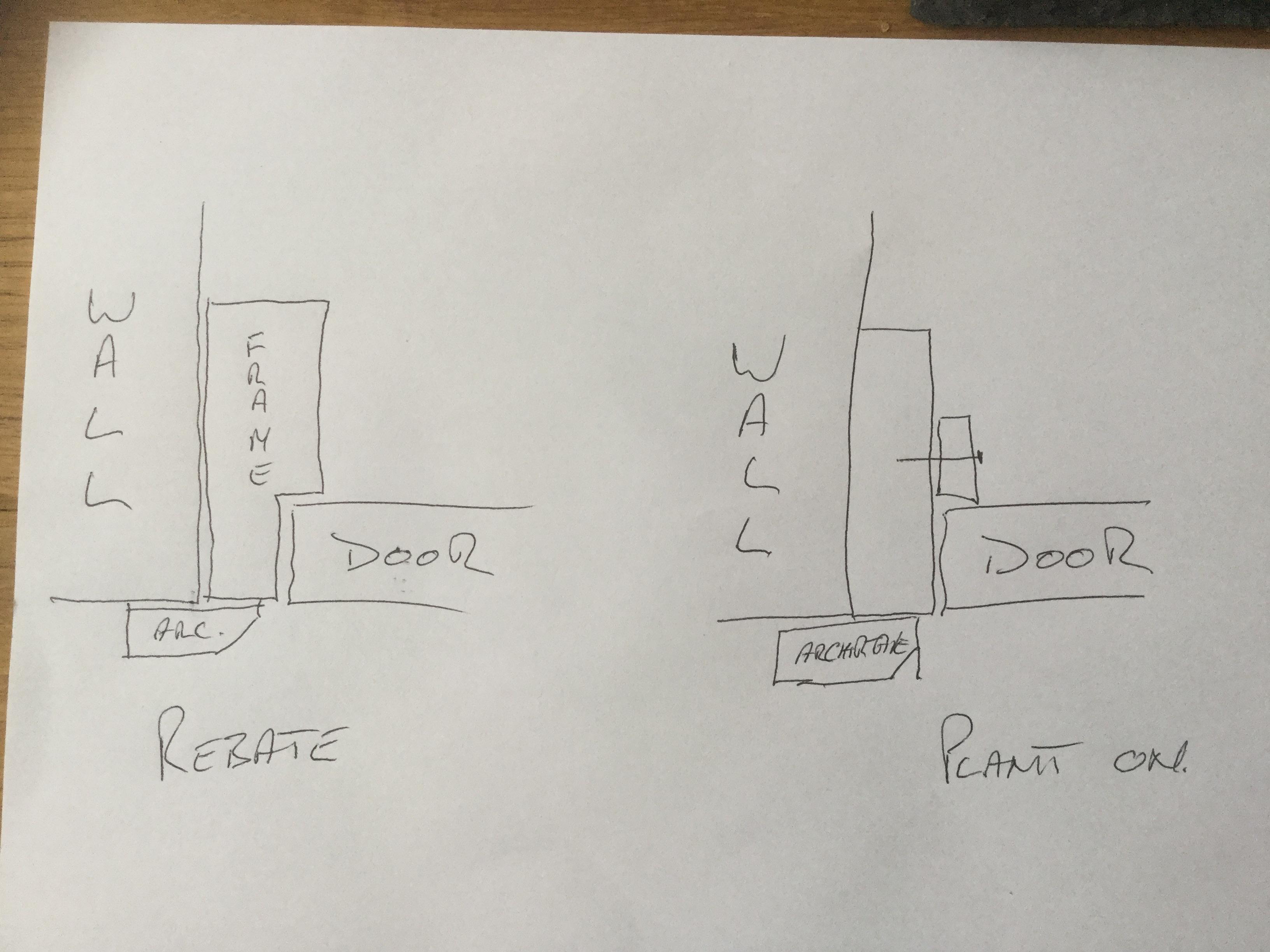

Ok so that will barely fit at standard frame and door, you need a door that you can trim possibly a few mm off both edges.
A standard frame may fit but (big but..!!) you’ll need to get a rebated frame as they get their strength from the thicker side of the framing.
This is an example of a rebated frame, you can get them from Jewsons but ask for a Rebated 5 inch Internal Door Lining

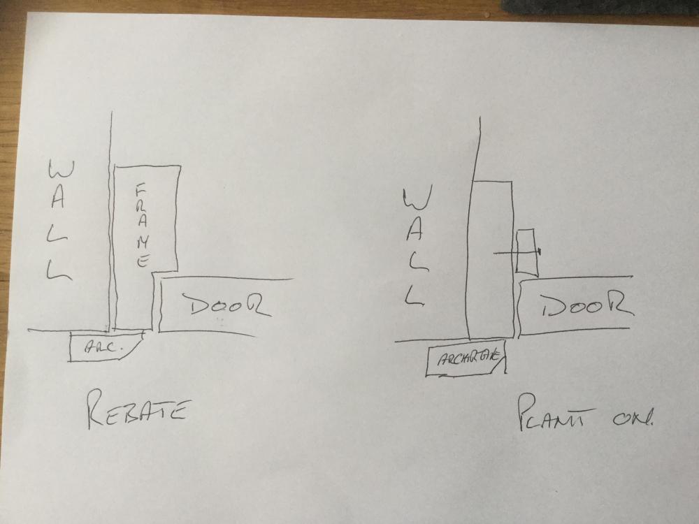

Two types of door frame, rebate vs plant on, I like plant on because you can make it fit the door exactly even if it’s a bit warped
As the drawing from @joe90 that shows the difference with the frame types. The force on a frame is tiny - you can use the same frame for a 40kg fire door as you do for a 7kg egg box MDF

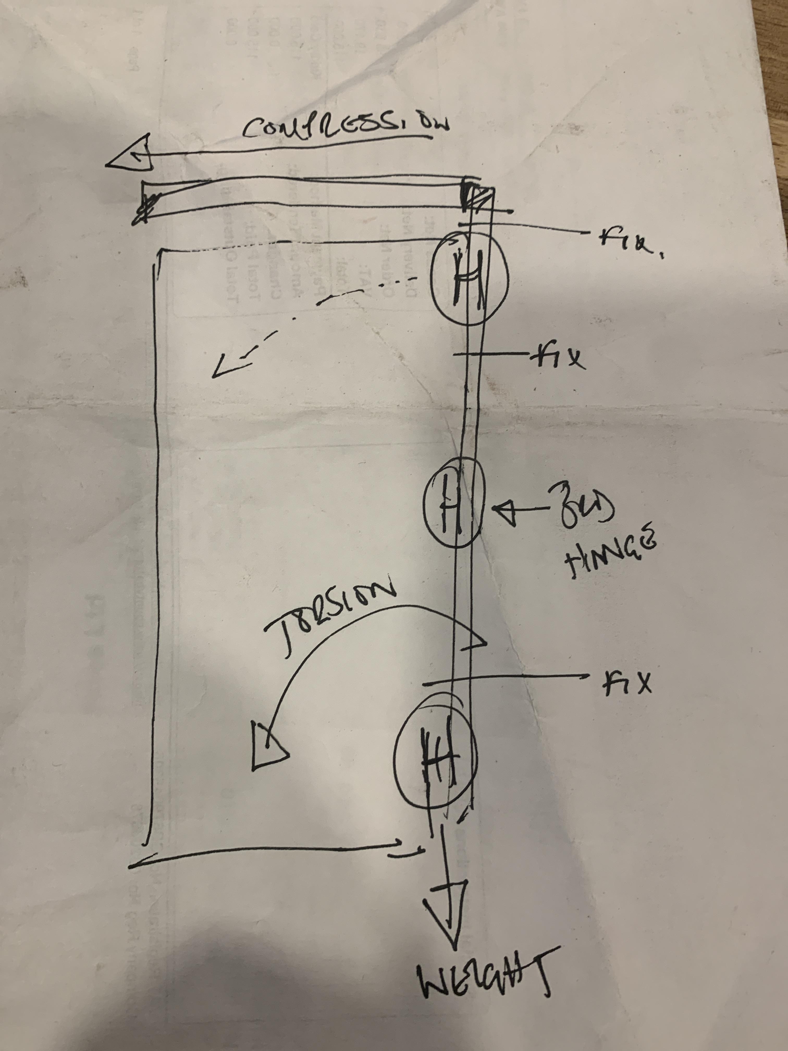

@PeterW I don't understand how the force on a frame is tiny. Even the t&g braced doors upstairs I took off to sand were heavy, so each will be pulling on the 2 hinges downwards on the frame,  & the frame attached to X.. so X has to have the same force applied to this too (Id think pulling inwards, wouldn't it-?).
Vector forces through the frame - the weight on the hinges is unequal, so the door is trying to rotate about the bottom corner when it is closed.. The hinge side of the frame is being restrained at the top by the compressive strength of the header. Hence the suggestion by @Onoffto replace this with ply weakens the frames resistance to turning so it is relying on the screws and fixings to hold in place. This is why adding a third hinge helps as it restricts the turning moment on the top hinge and the pull on the frame.
When the door is open it’s the frame fixings in shear that are stopping it twisting off the wall - hence the need to use a decent frame fixer into something solid. Two will hold a door, 3 are ideal, above and below the top hinge and above the bottom hinge ...
Suffice to say ....
Get the door, fit a frame and crack on ..! Unless you’ve just scored a nice 3” thick solid oak door off a cathedral, you’ll not have any issues ...
Frame nice and plumb and square and you’ll be done in no time.

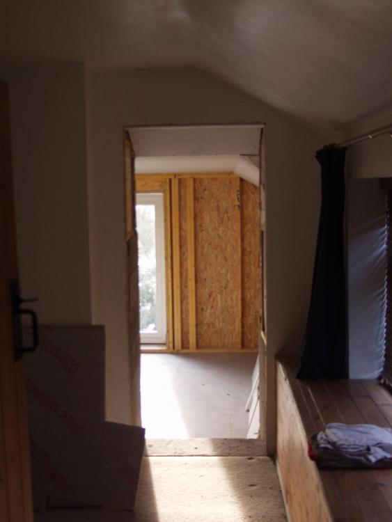

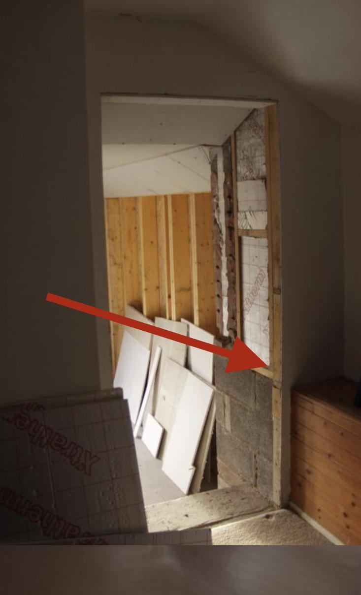

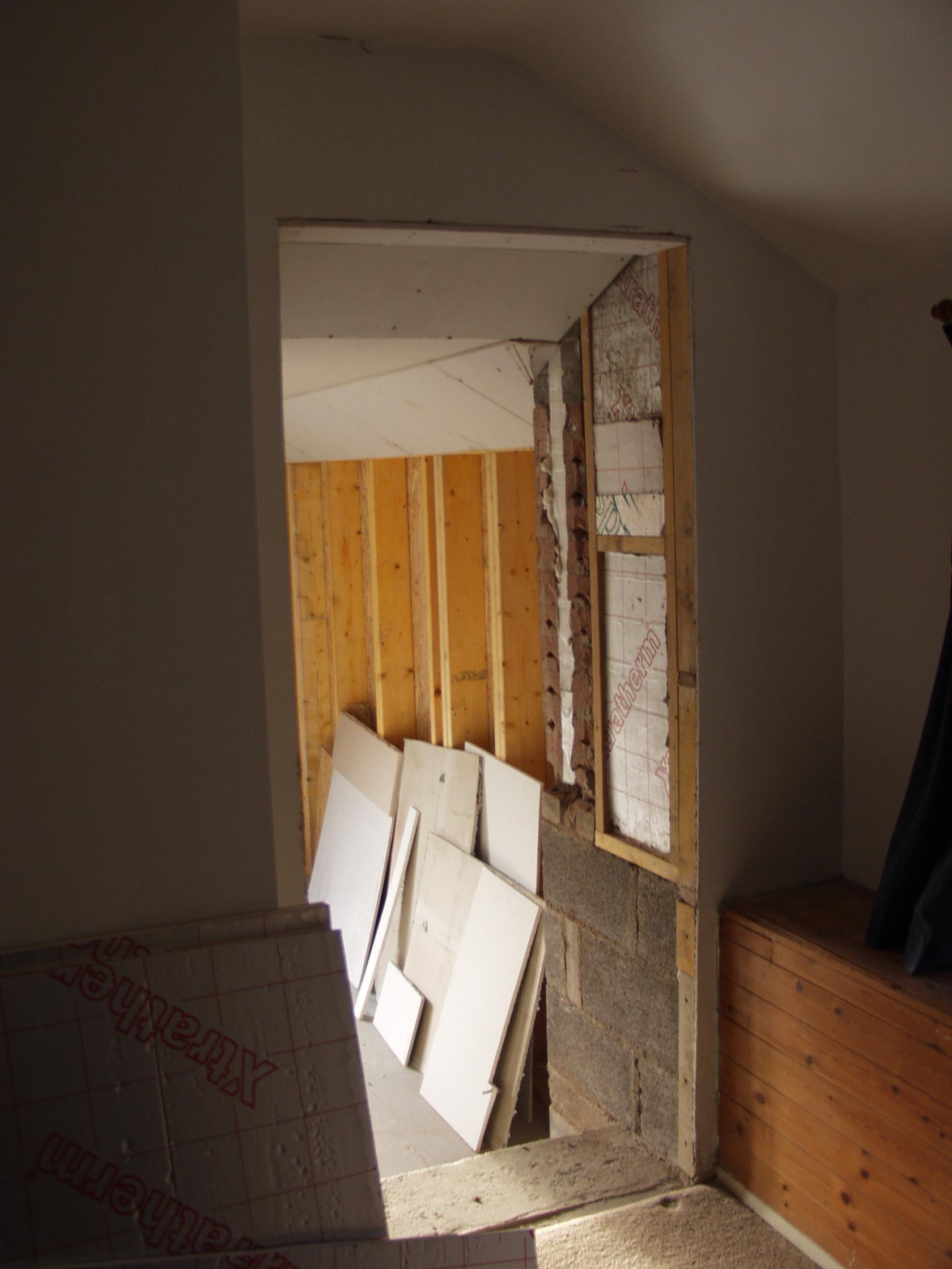

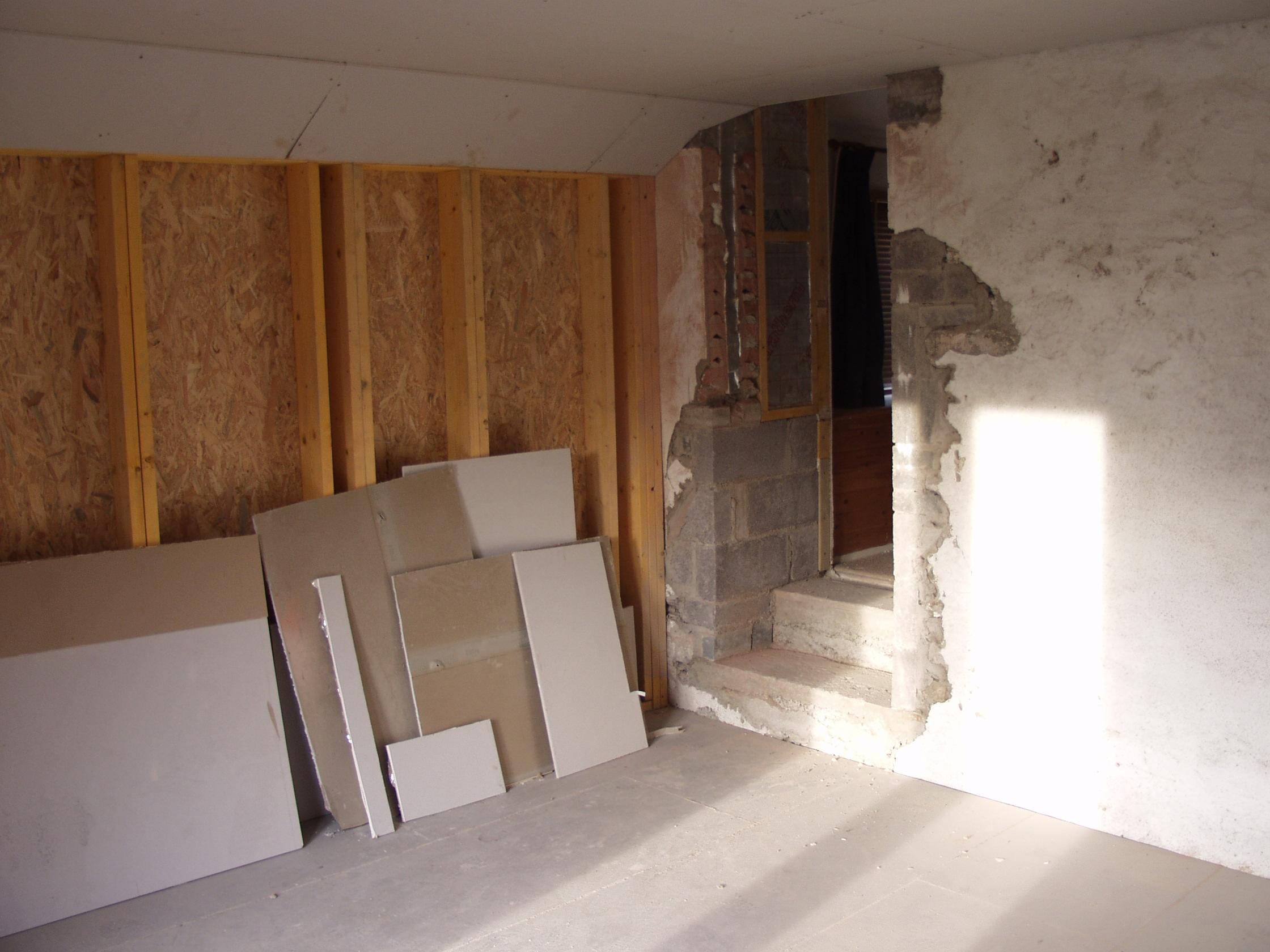

 Ok I get most of that thanks for explanation Peter. Its this bit that concerns me still though "hence the need to use a decent frame fixer into something solid".. considering my structurally poor mish-mash opening area, under my neat pB.
Thank god I did a pic of each side before I pB'd over. Ok so door to go top step side (in pic 2 nearest to you, opening twds you too).
zoot
I only seem to have a pic of one side here.. but, its the business side/ door opens from this side. The timber verticals might look ok, & pB helps sure it up.. but all a bit wobbly on gthis end here.
Both sides of the 'tunnel' the same: block lower section, crappy timber patch-job plus PIR between for uppermost 2/3rds. Poor header timber under this bit of pB too/ a bit wobbly.
So that vertical timber is where you are putting your door frame?, how is it fixed to the wall? Does the insulation go behind this timber? Do me a little sketch of what’s there in section.
Header is irrelevant.
So I would be carefully cutting back the plasterboard to get to the timber that is arrowed in the picture below, and then screwing the hinge side to that. Looks nice and solid.
