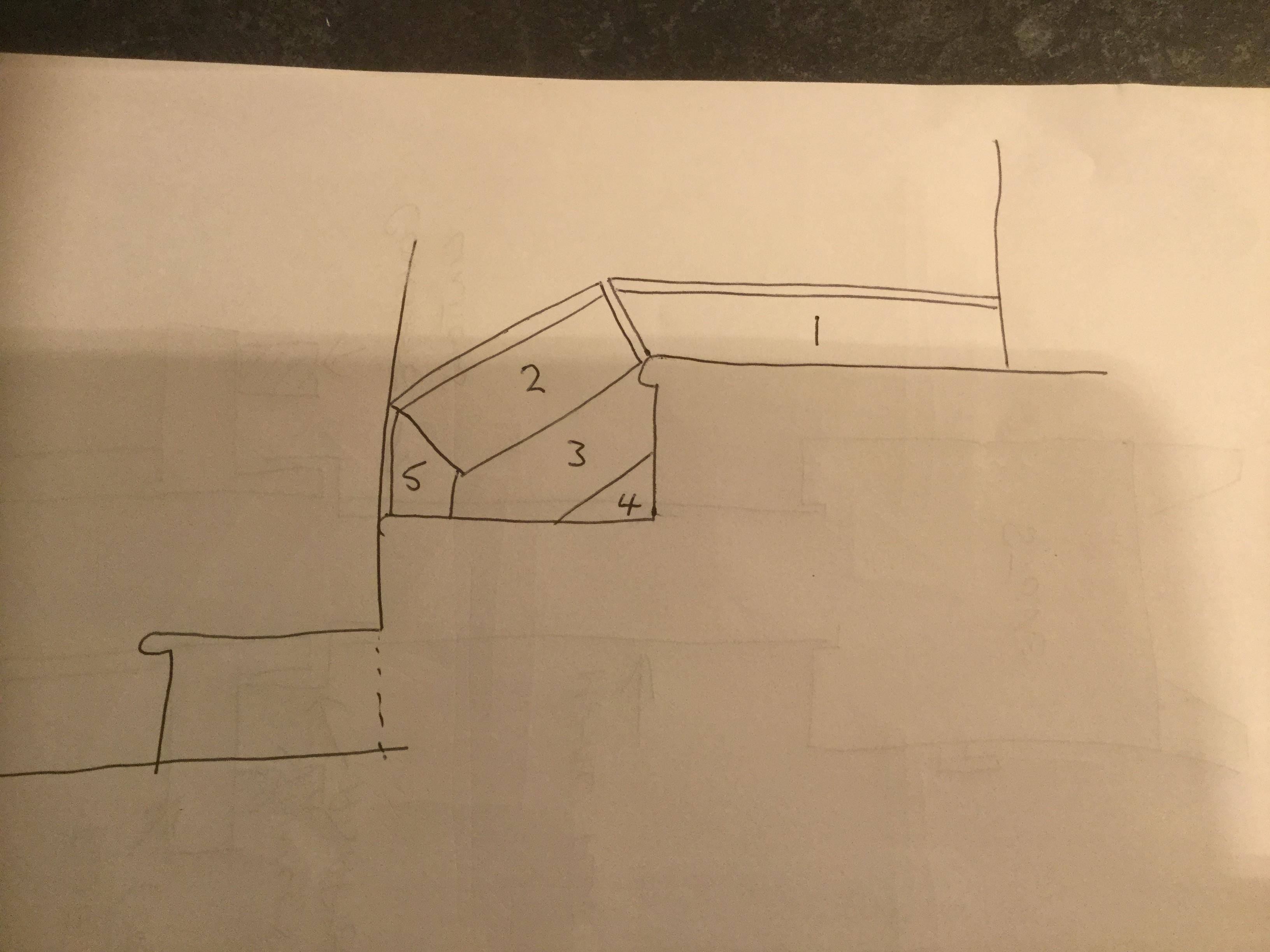

How about something like this:
You could cut simple housing joints with your router, both sides of the board (rather than the one side shown below) and the whole lot just slots together. Glue in the joints, weight on top whilst it sets. You could back with the cheapest 8"x4" hardboard/ply sheet.

On your last post have you considered trimming the sides of the end with a bit of skirting a bit of windowboard? You could have the bullnose at the front or top, and it would neatly flll your 2 inches of extra length, and finish it off visually. If you don't want to do that you could use a couple of pieces of 1 x 1 with quadrant or another trim on top.

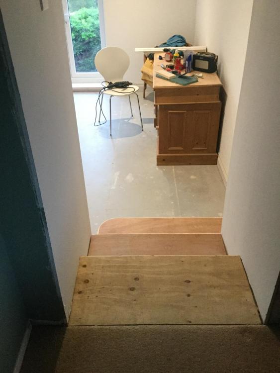

I've also made my 3 steps (taken a whole week!!) just gotta fix them down. Is Soudal plasterboard adhesive suitable to fix 12mm ply [and/ or mdf] to concrete? can't see it a heap different to pB > concrete (& it does say on can 'various wood to walls' is mdf "wood"?). Cant think how else to fix it. This being my top step.
Pics later. ipad! woohoo!
Edited by zoothorn

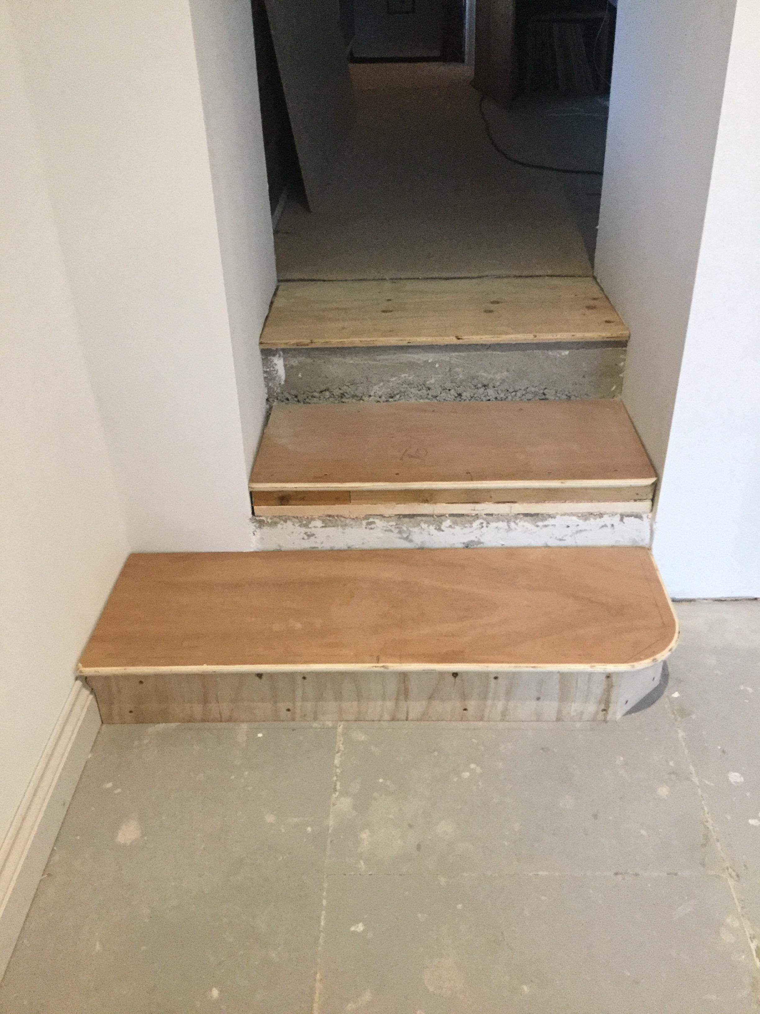

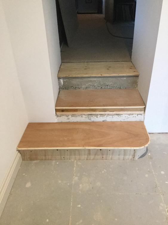

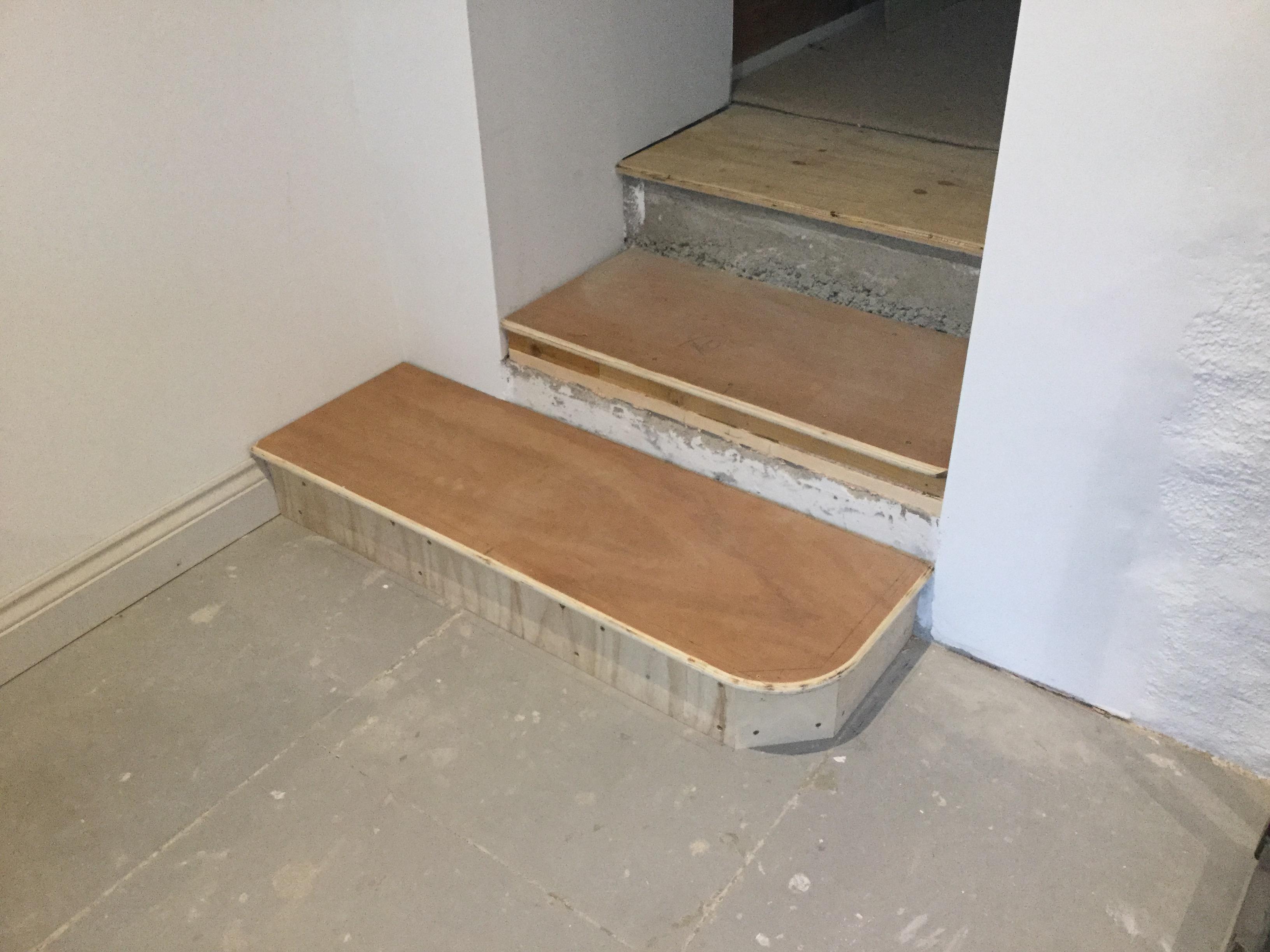

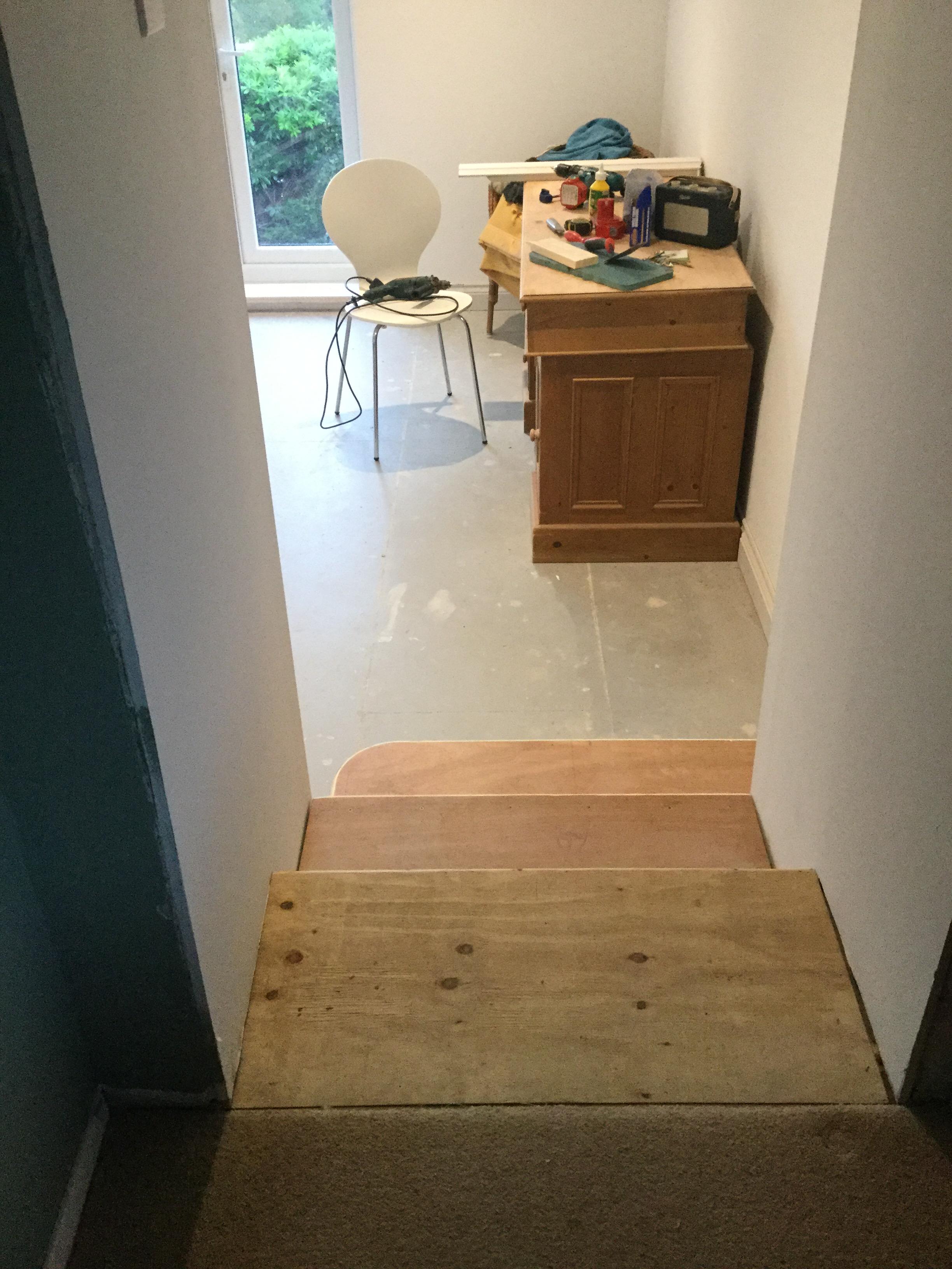

@joe90 reporting back, done me steps. Really do need skirting now as there are gaps galore at sides, knock thru walls uneven etc. The pB to wall glue is excellent for general wood to wall btw.
quite pleased, but by god took a whole week..
That’s really good mate, well done, you must be pleased?. Now, skirting, below is my take on what you need, you will need to plan it carefully but this will look great. Below is a (bad) sketch of what I would do, might be good to try it out with hardboard or something first to get the angles correct but after doing the steps I know you can do it.

Looking good Zoot the Hoot

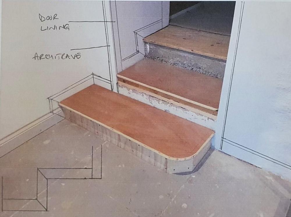

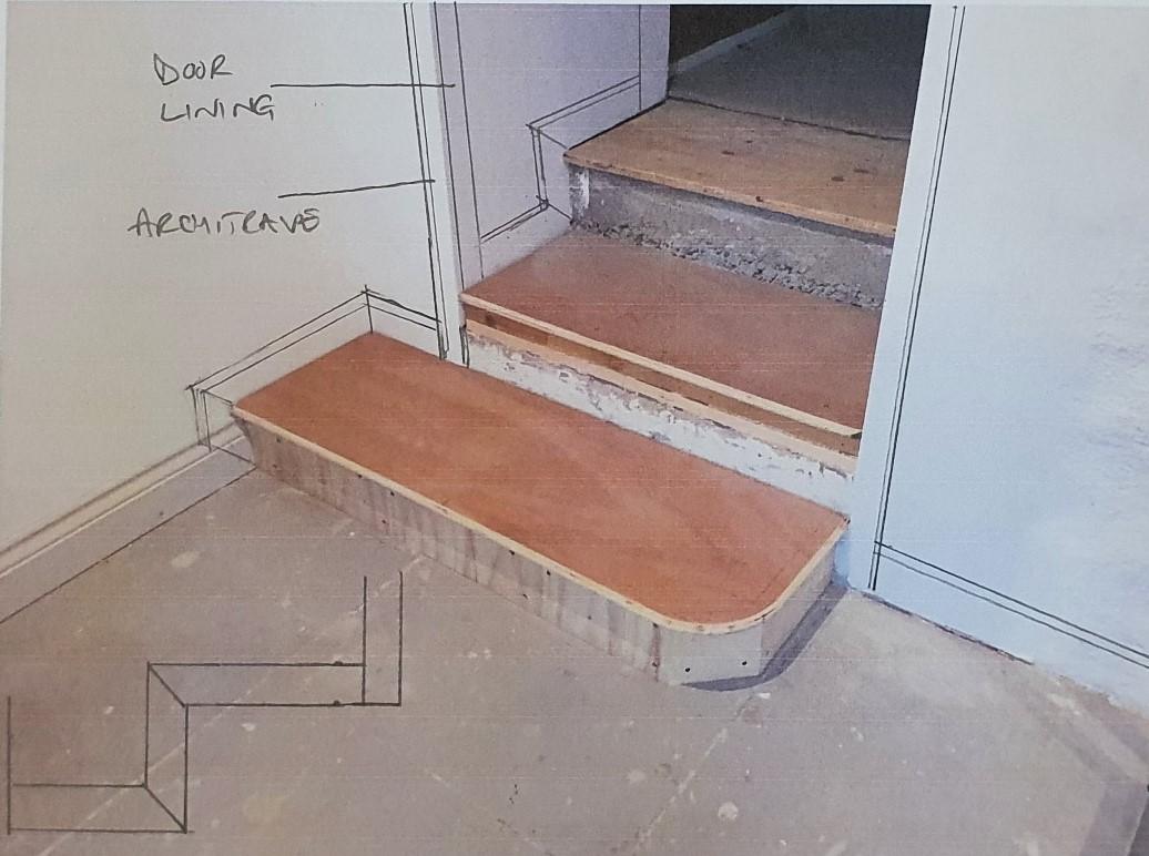

Nice work!  I think I'd also put a door lining (can just be a bit of skirting with the moulding cut off) in at the bottom and put architrave on in the lower room, so you'll have something to run the skirting up to and can terminate it neatly.  Something like this:
@Roundtuit hey that's pretty groovy! I think that's an easier method of skirting on the top & middle steps/ less material & effort than joe90's idea (tho I do like his slope). But the door lining you put in the wrong spot (door @ the junction of adjacent room carpet & my top step ply).
I'm a bit loathed to put an architrave vertical edge here too: I spent so damn long fashioning these wall corners, & they do look smart as is.
So I'd like to follow your idea along top step > down > across on the 2nd step. And also your skirt around the wide 3rd step (maybe too). But I need to somehow meet these two skirts -without- a vertical architrave between. Also how can I cut my existing wall skirt @ 45* in situ, if I do the skirt around wide 3rd step too. Hmm..

Well... it's raining again here, so can only work on other people's jobs!  I drew on a door lining top and bottom; the one labelled 'door lining' wasn't intended for your door, just something to run the skirting to, otherwise you have an awkward junction where the skirting on the bottom step needs to meet up with the skirting from the middle step.  Or... you could just not bother with skirting and carpet up to the edge.  It's only there to protect the bottom of the plaster, so if you're careful when vacuuming you'll be fine!
@Roundtuit damn, wish I'd known of the architrave vertical idea before the huge faff of cornering the pB edges here. Anyway I'm loathed to cover them now you see/ kinda proud of them. Would there be anything I could run up at this junction as a compromise, just up to the top of the skirting instead?
The world's your oyster!  Plain timber finishing just above the middle step skirting, or get creative, stick a decorative moulding on it (a bullseye maybe).  Just needs to look neat ?
