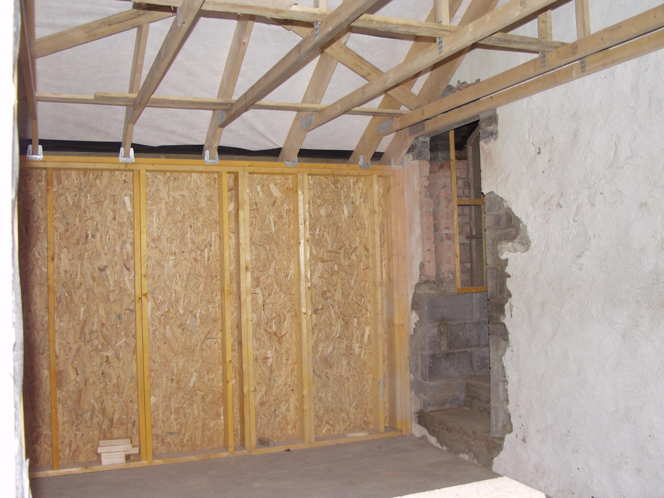

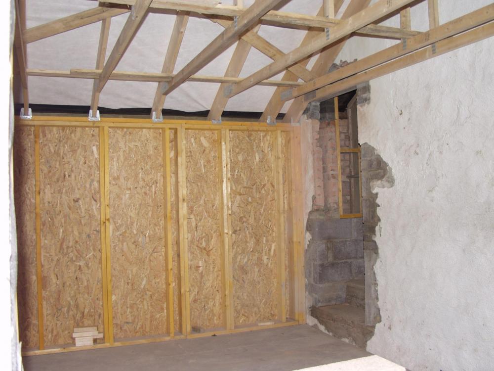

35 minutes ago, joe90 said:
So that vertical timber is where you are putting your door frame?, how is it fixed to the wall? Does the insulation go behind this timber? Do me a little sketch of what’s there in section.
Well yes the door is sheduled to go here.. but do I have solid enough timber in these verticals either side? they don't really fix to anything apart from the old adjacent room pB: they've just been stuffed in as quickest way to create the knock thru as 'finished' afaict. I do have the block lower 1/3rd area: the timber attatched to this.. I hope is better. Even attatching frame to the block.. but above there's only PIR tho.
Tbh I cant recall exactly what's in section here. I thought I'd taken more pics than I have.
If the vertical timbers look solid as Peter might think, they're not really. But if the frame only needs minimal structure here, & the door pressures all are taken up by the frame's joints top & sides, then it might be ok. But who am i to judge this is the thing.
What size is the timber on the wall?

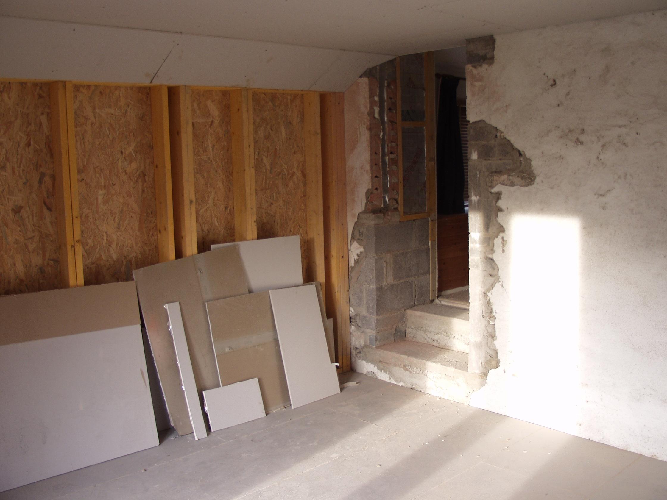

Not sure if this is going to help see what the header area actually is under the pB strip.. but maybe gives an idea of what builder's done?
Hi Joe- if you mean the vertical bit attatched to the brick, 2ft away from hinge line? 2x1? (this is the pic with the joists exposed).
The best idea of what's going on on this hinge side, is both pics looking at this angle, one with joists exposed.. & the later one where Ive packed in PIR bits between the timber. Apologies its far from ideal to establish what's been done.
There's an empty box/ void going on immediately behind the side PIR sheet.. well a well insulated box/ void, the btm of which is a block shelf top as it were.
no, the vertical piece of timber, floor to ceiling where you want the hinges to go!!!! How is this piece fixed to the wall, what size timber is it? 2x4, 3x2 ??? Your door frame is going to be fixed to this so we need to know if it’s strong enough to do the job!
This is what I was trying to explain. Ok this piece where I want hinges to go, is attatched only to two horizontal bits of stud, & to both pB's at the corner (I whacked a load of pB screws into it from the old pB side, as well as a good few into it from my 'tunnel pB' side.. to sure this timber vertical piece up best I could knowing I maybe putting a door in). Also its held in by soudal foam to the PIR.. but that n/a I'm sure.
I can't think that even if both pB's removed/ the timber piece exposed, it could be replaced with anything.. unless a new vertical is fixed instead here attatched to the floor -and also- to some point high above (but I think only slate felt/ slates directly above here: its within the old wall area you see, so no ceiling/ loft xyx structure).
I'm pretty sure Ive been left high & dry by builder here.. prolly just for me to put 'door on low step open into room' , even tho he knew it can't, bc of the ceiling intrusion/ shape, due to the whole damn thing being 1ft lower than it should be.. specifically & crucially my primary concern being the old ceiling H relative to new ceiling H: the entrance-in area specifically. This is what I was stressing so correctly (I think) about -whilst- it was built, but I was fobbed off & dismissed not only by the builder, but also the good folks on here siding with him hollering at me its "as it should be/ as it could only be made!!".
Now maybe they can see my point to demanding it -had- to be made to the plan (I was blackmailed during build & I said 'right stop please/ I need answers why' & builder refused to explain, got angry threatening to pull everyone off/ walk off, nastily: I'll always resent this). Ive never been in sush a stressed state in my life/ appalling. And so then I ask on here for support. And everyone hollers at me & sides with him. I was in a depression for remainder of build, worried what the repercussions would be: turns out many & they were just, & I'll say it till cows come home: just as I thought: this knock-thru area/ door being the biggest problem its left me).
If the build had the collars I was promised, on the plan he told me to make, & saw & agreed to (saying a v.good plan/ nothing suggesting it would be different, let alone a full 1ft difference in floor & ceiling positions, both rooms) so as to push this top ceiling up 1 ft.. I would be putting the door where it should be: fixed to solid corners opening into the new room.
The ceiling trusses did not have the collars. Well, specifically no collars on --both-- sides: as it is its been compromised by having a collar on only --one-- side, meaning the ceiling isn't pushed up enough. As soon as I saw the collars I sprinted out measuring xyz abc.. scratching my head thinking its 1ft lower, it defo is.. "it'll be fine" he says.. "builder knows best, you don't, its correct!!" I'm told on here.

RIGHT, if it were me I would make my own frame from 130mm x 40mm planned square edge (or as near as you can), screwed to the upright timbers, remove plasterboard behind these if you wish but not necessary IMO. Verticals up to the ceiling Then tight fit top piece between them. (This will help stop hinges pulling frame away from the wall). Build your own “plank “ door and fit then buy 40mm x 15mm door stops and fit them to the door afterwards. Quick CAD drawing (crayon assisted drawing).
