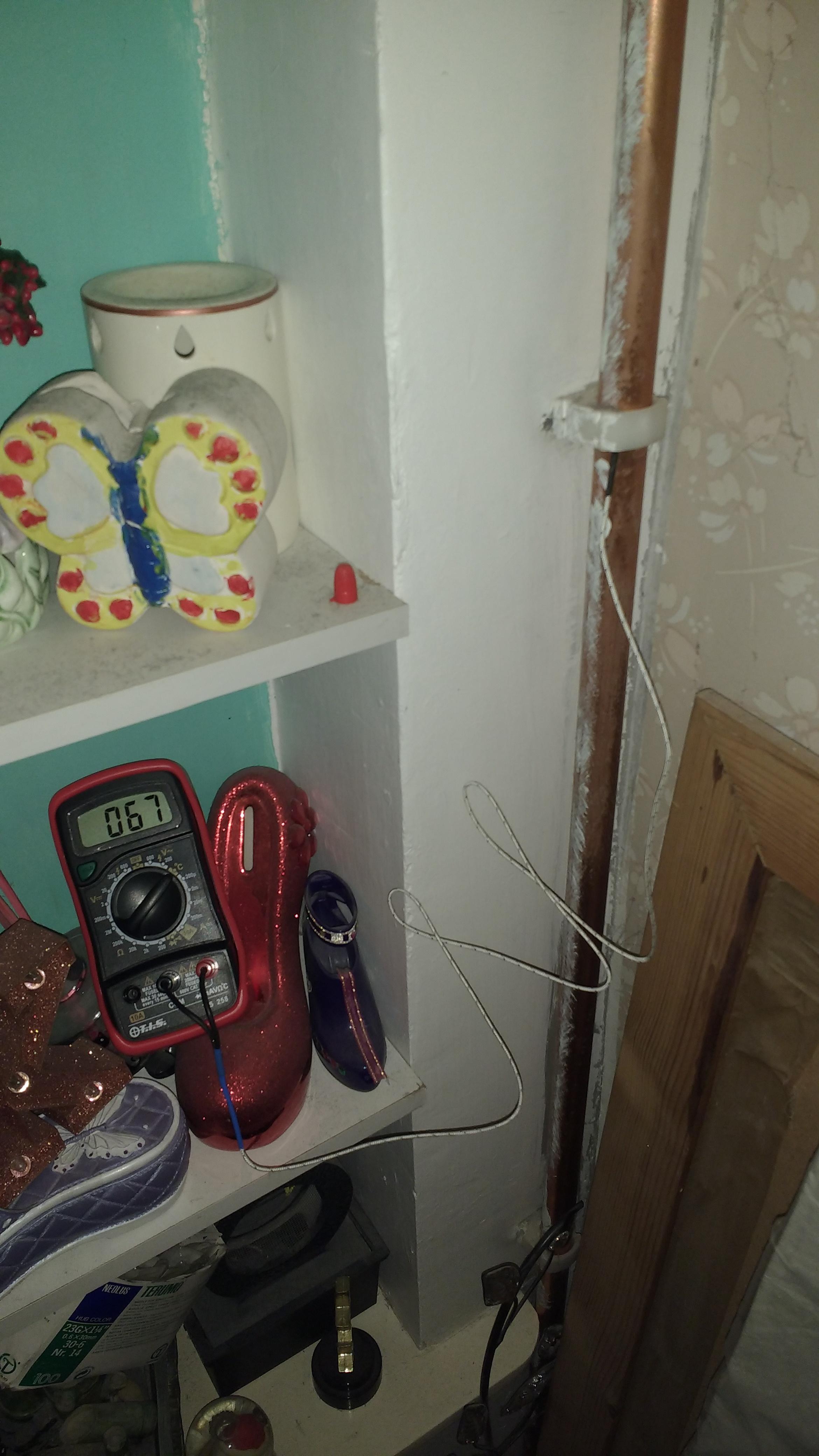

@zoothorn, this balancing lark is a real thing. People aren't just saying for a laugh. Picked at random but try this:
https://www.bestheating.com/info/a-best-heating-guide-how-to-balance-radiators/#:~:text=When you balance radiators%2C you,then your radiators need balancing.
As for a temperature measuring device you can pick up a multimeter with temperature probe like in the guide above for about a tenner.

I'm only trying to understand it PeterW. I do want help, but if I cannot make any sense at all of you stating my rads are unblanced, am I just meant to lie & say "ok I understand" ? (or be truthful & say with respect I do not understand until the reason given).
There -has- to be a plausible reason how you & joe can say my rads aren't balanced, when they all feel temp the same + same time they come on.
All I'm currently asking is if you can explain, even if repeating (I missed the reply with BS4592 in.. replies are missed/ Ive said this before, unless you refresh the page continually all day).
