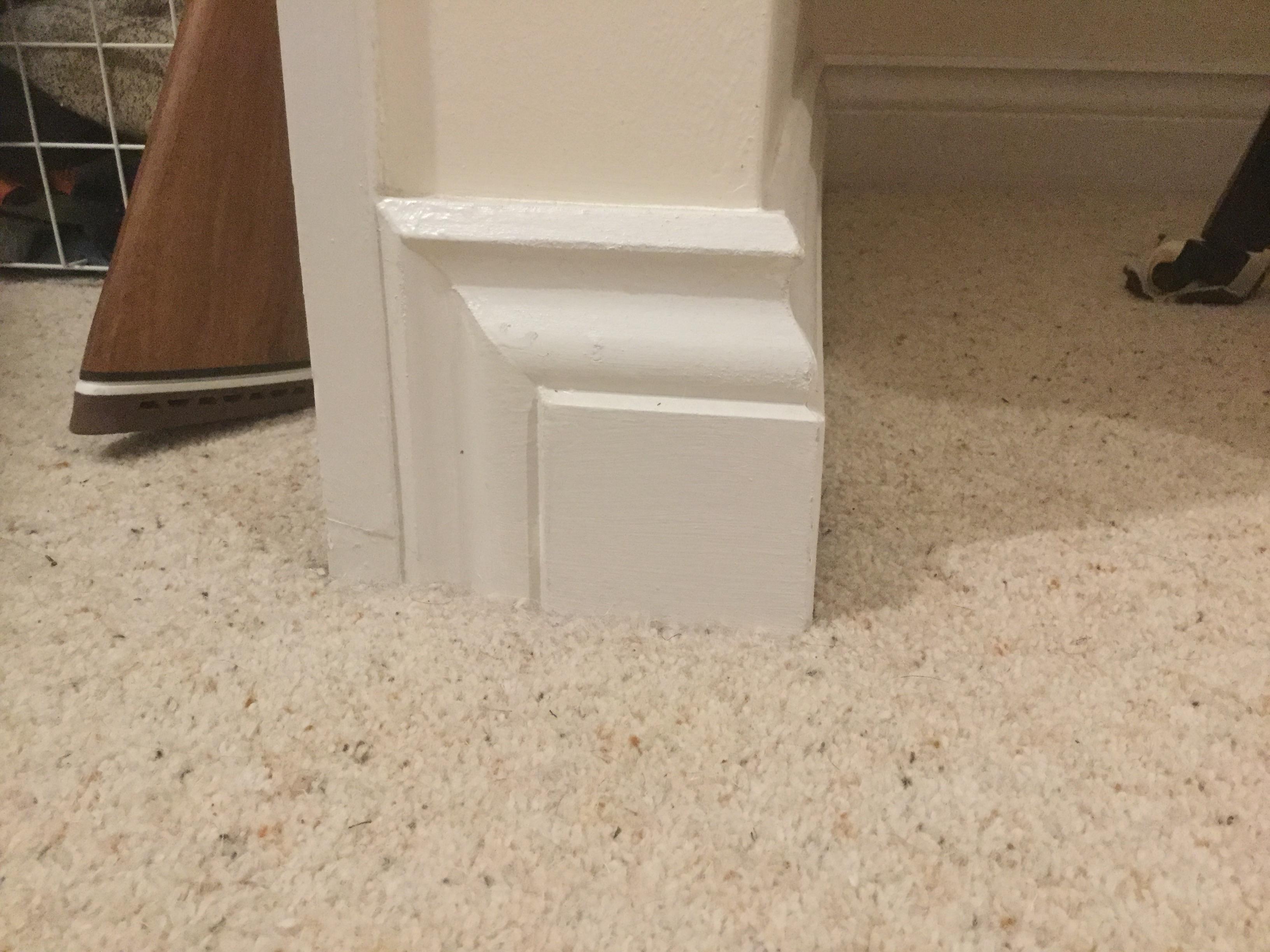

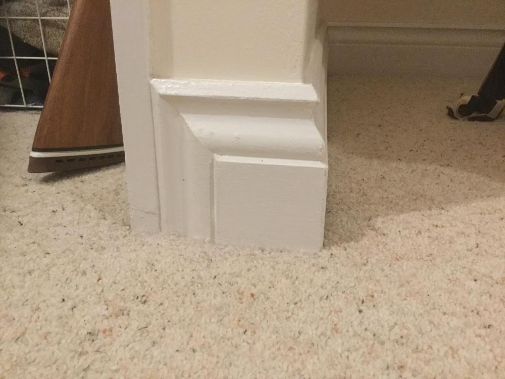

Right mate, photo of how I finish end skirtings, 45’ cut through top moulding and plant on end piece. Also need to plant on (glue) additional wood to make depth required. Hope this makes sense?
Is no-one going to question the gun in the photo??

As I said before, complete the steps then make a template of both sides. Additional width of timber made by “planting on” (glue on additional piece) I will spell it out when you have the template.

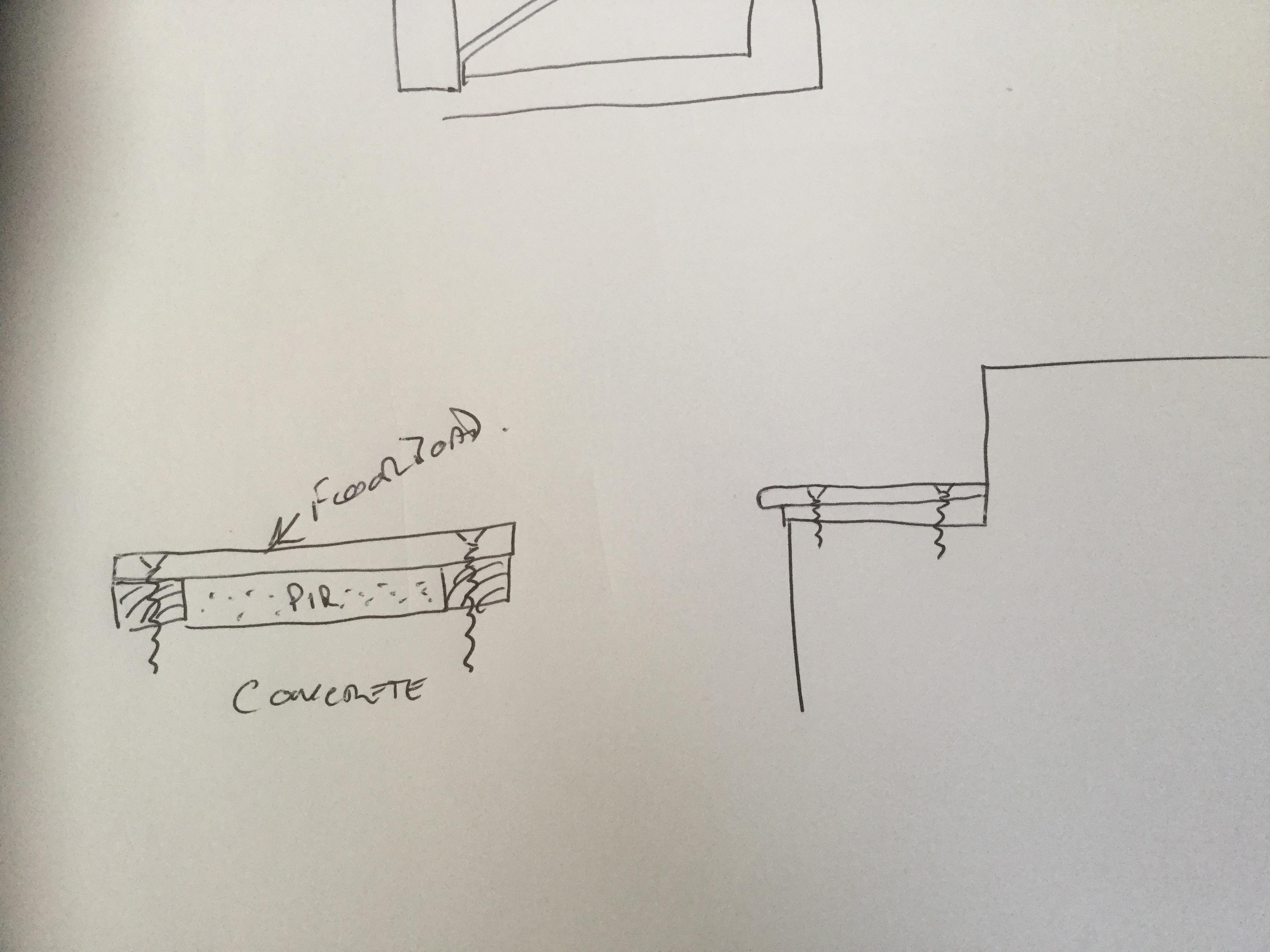

@Ferdinand enjoyed that zoot clip! yes I was skirted-out y'day. I think maybe I need PIR in middle step: concrete ontop of old wall as it is = a big area of cold into the room/ IE anything to reduce this.
So just a Q next of making these 2 steps then. The RHS will be visible, so I wonder how to make them? any ideas welcome.
Work out how much higher you need middle step. Baton either end and PIR in the middle, floorboard (off cut of chipboard flooring) rounded front edge, screw down to concrete. Make nosing (round edge ) a good inch out from front of concrete.  Do this then  Report Back and we will talk you through the bottom step.

@joe90 thanks for that joe.. Id honestly have bodged it if I hadn't asked. Is your idea with the rounded front edge to facilitate carpetting it?
What would you suggest.. carpet these steps, or, make the top bit the final step surface (in which case any chip board offcut or mdf I can find will need to be covered in something).
cheers zoot
No it’s just “normal “ for stairs, looks a lot better IMO.

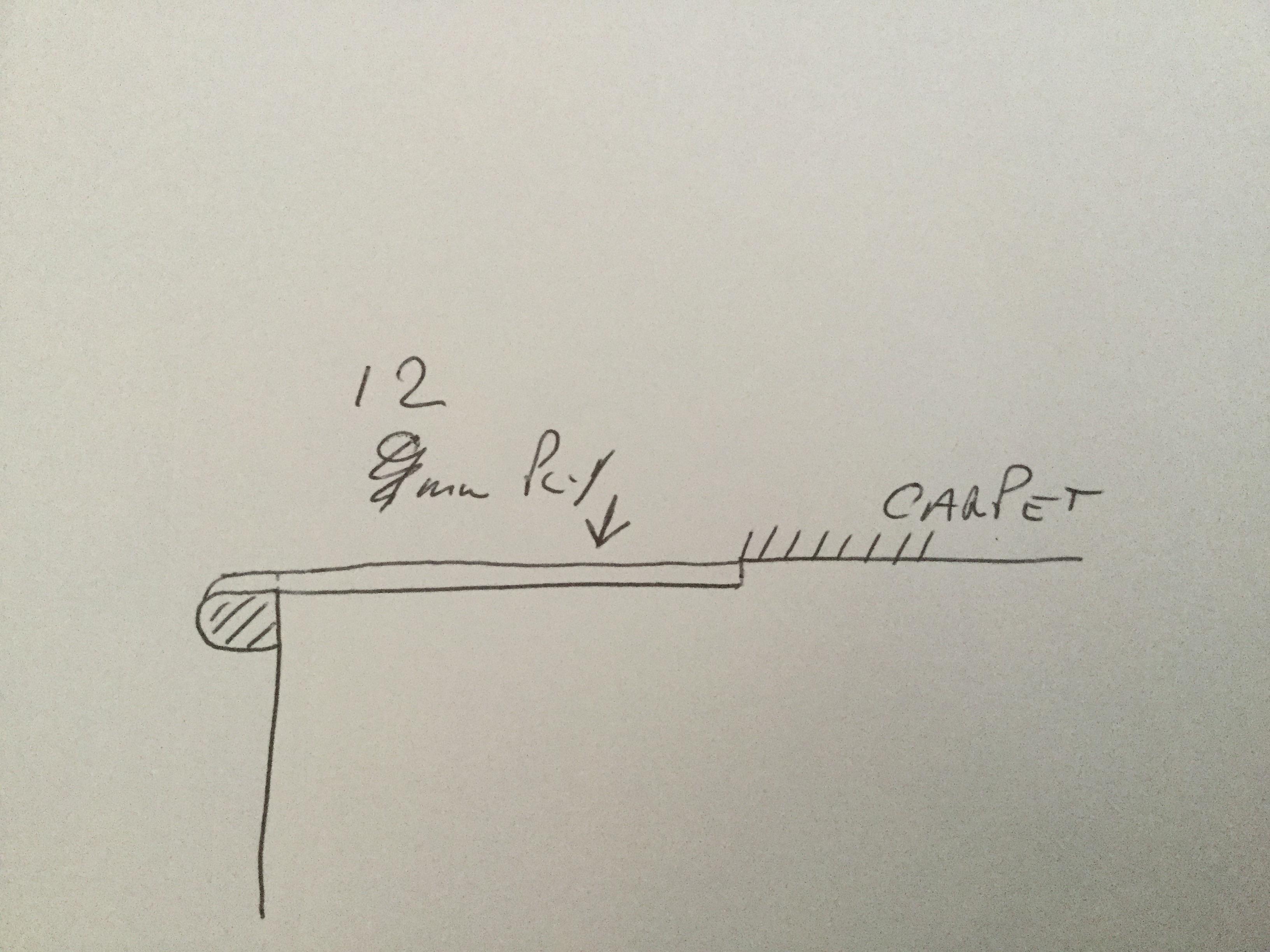

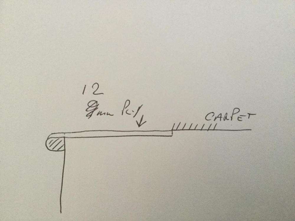

this would work fir your top step , with middle step use 18mm flooring and round it over and pack beneath to suite. Yes you can stick carpet to concrete but would you be satisfied with that? (I would not!).
Edited by joe90
@joe90 ok that's an idea to add s'thing under the 12mm sticky outy bit, thanks for the sketch joe. I do have some old marine ply 18mm for top of the middle step, if I can lower the 2x CLS 6mm. How long the sticky outy bit would you say is normal?
Is it normal for carpet to go over the sticky outys, in, & down the vertical step bit? Id assume on stairs etc this is typical no? I don't want to make step shapes, out of all sorts of woody tat knocking about (IE must be covered), that can't be carpetted over tho.
Just route a bullnose on the front of the ply etc if you're carpeting over it.
And or route your own bullnose using a bit of softwood and glue and pin to the edge of a chipboard floorboard.
yes, does not look right with just a square edge (IMO).
I would make it 20mm. Build those two then we will talk you through the bottom step.
