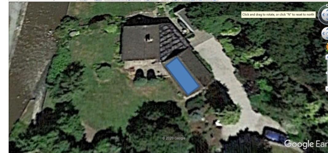

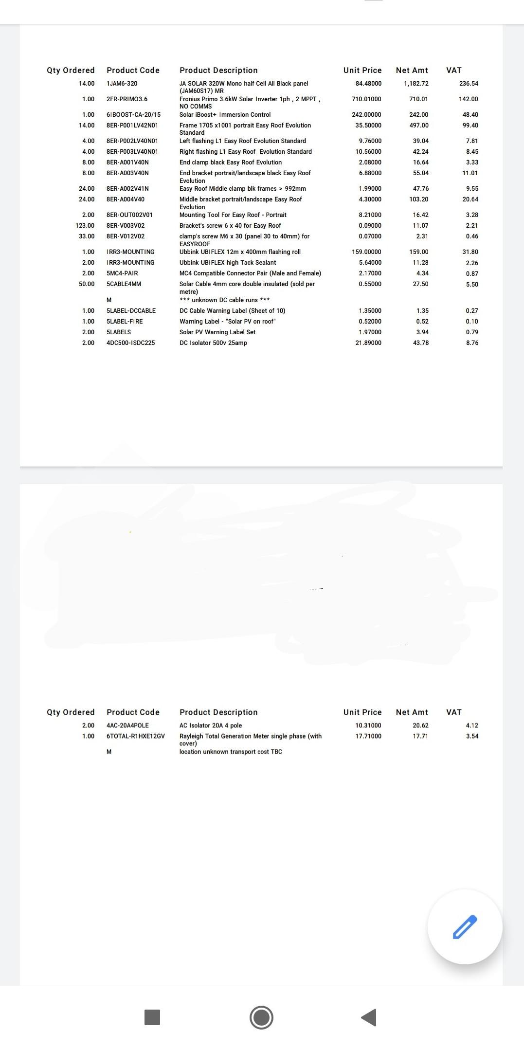

canalsiderenovation Posted August 26, 2020 Share Posted August 26, 2020 (edited) So, now is the time we need to decide whether to go for in roof solar on one side of the roof (old Google image for info). Note a lot of these trees have gone and there is no shading. My other half doesn't think it is cost effective and I'm trying to drive the cost down. We approached two companies, both MCS accredited who came back with some prices which seemed expensive. We aim to avoid getting prior DNO permission and as I understand it the Peak Wattage of the PV array should fall within the inverter’s power tolerance and it is the inverter’s maximum output capacity that needs to be 16Amp (per phase) or less in order to not require permission from the DNO fall within G98 regulations. The quote I've had from one supplier recommended by a few people here is attached and they said the spec they have quoted for means it won't need DNO advance approval. There is then the additional cost of our electrician and roofer fitting it. We will have our ASHP and the solar is for our use and to divert any excess to the immersion tank (300 litre minimum just waiting for quote). Would someone mind taking a look at this quote (14 panel system) and seeing if there is anything missing and if there is any way of reducing cost and things that should/should not be included. At these figures my other half is reluctant and doesn't think it is worth pursuing? I'm hoping @ProDave will be along too and other people that know far more than me @PeterW? Thanks Edited August 26, 2020 by canalsiderenovation Link to comment Share on other sites More sharing options...
tanneja Posted August 26, 2020 Share Posted August 26, 2020 Just to confirm, is that breakdown looking like £35k? Link to comment Share on other sites More sharing options...
canalsiderenovation Posted August 26, 2020 Author Share Posted August 26, 2020 2 minutes ago, tanneja said: Just to confirm, is that breakdown looking like £35k? Inc VAT just a few quid over £4k. Link to comment Share on other sites More sharing options...
tanneja Posted August 26, 2020 Share Posted August 26, 2020 (edited) Ah the quantity is included in the cost per item, no idea how i missed that, thanks Edited August 26, 2020 by tanneja Link to comment Share on other sites More sharing options...
LA3222 Posted August 26, 2020 Share Posted August 26, 2020 @canalsiderenovation that quote structure looks similar to how midsummer wholesale structure their stuff - check out their site and you'll get a flavour for pricing. They have a link to an app on their site which spits out the material quantities for you based on your roof size. Very easy to use. Easy to get a 'trade' login with them too for slightly better pricing. 1 Link to comment Share on other sites More sharing options...
ProDave Posted August 26, 2020 Share Posted August 26, 2020 So that's about £4K total in parts including the in roof mounting kit. How much will you save by not having to tile the majority of that face of the roof? Installation wise your electrician and the roofer should be able to fit that lot without difficulty. 1 Link to comment Share on other sites More sharing options...

canalsiderenovation Posted August 26, 2020 Author Share Posted August 26, 2020 2 hours ago, ProDave said: So that's about £4K total in parts including the in roof mounting kit. How much will you save by not having to tile the majority of that face of the roof? Installation wise your electrician and the roofer should be able to fit that lot without difficulty. Rough guesstimate around £3-£400 builder said (our roof tiles are Marley something or other so not posh slate or anything). Link to comment Share on other sites More sharing options...

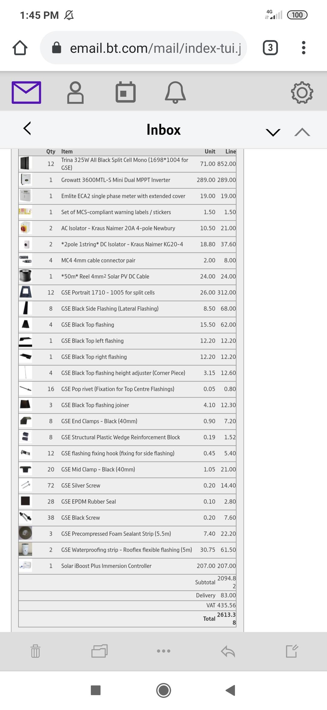

canalsiderenovation Posted September 3, 2020 Author Share Posted September 3, 2020 So some reduction on pricing and we some shoppinf around. Note we had to change from 14 panels to 12 as the roof was a bit smaller than initially predicted. They have changed the Fronius inverter 3.6 as the Primo will not work with 2 rows of 6 using these panels they have quoted for, instead a Growatt which is compatible. Does anyone have any knowledge of these products/comments on this pricing for the supply of GSE in roof panels etc and diverter for the water to immersion for ASHP? Link to comment Share on other sites More sharing options...
tonyshouse Posted September 3, 2020 Share Posted September 3, 2020 Try solar streets 4k for 4kWp 1 Link to comment Share on other sites More sharing options...
ProDave Posted September 3, 2020 Share Posted September 3, 2020 That revised quote is looking a whole lot better. 1 Link to comment Share on other sites More sharing options...
canalsiderenovation Posted September 3, 2020 Author Share Posted September 3, 2020 Just now, ProDave said: That revised quote is looking a whole lot better. I think so, just need to check what our builder/spark is going to charge for fitting. Link to comment Share on other sites More sharing options...
