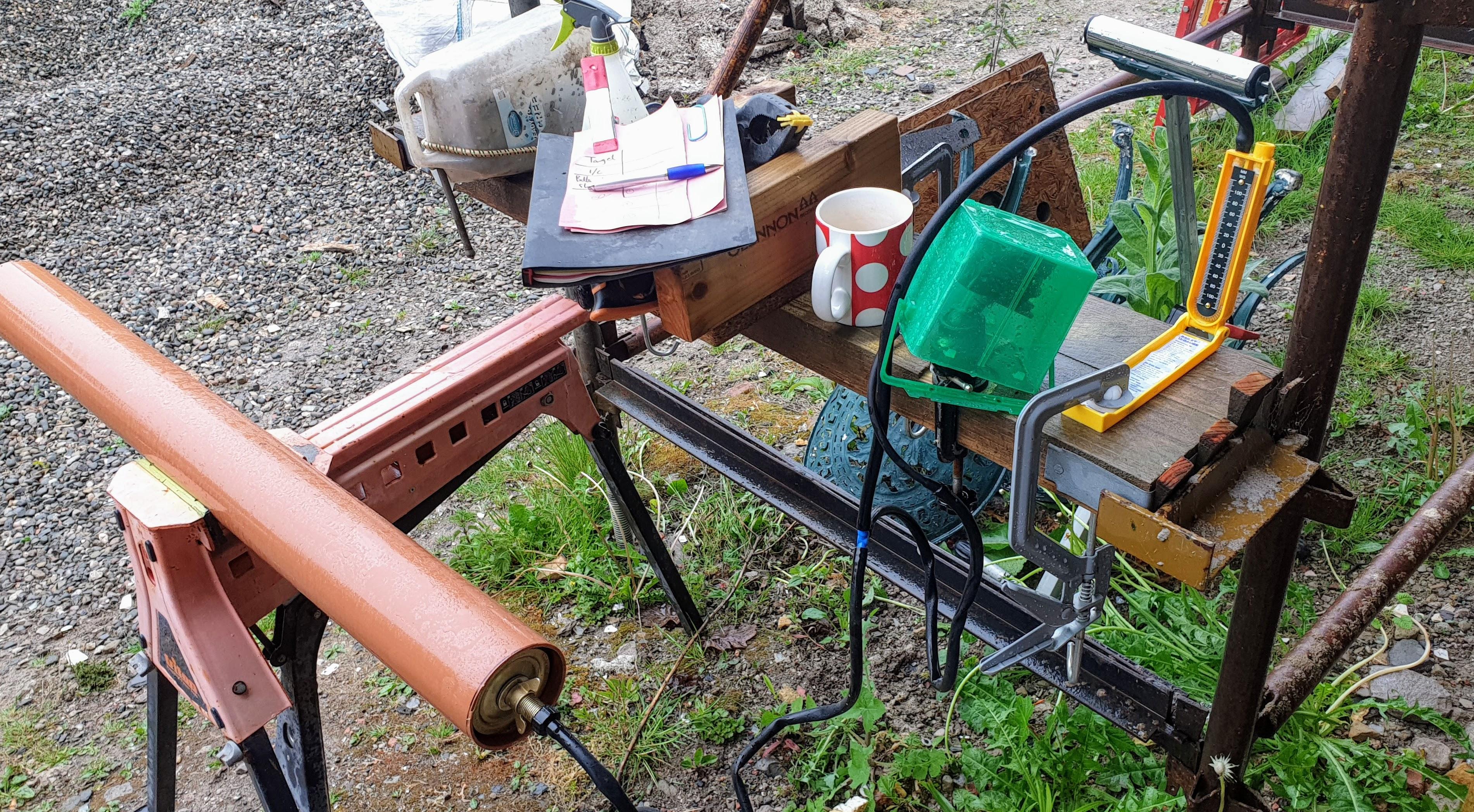

Bought myself a nice little test kit, and for whatever reason couldn't get the damn thing to work.
Tried a test rig before using it on the real thing. Bloody thing kept leaking.
So tonight, in the bath, instead of abluting, I'll give it another go. See where the leak is.

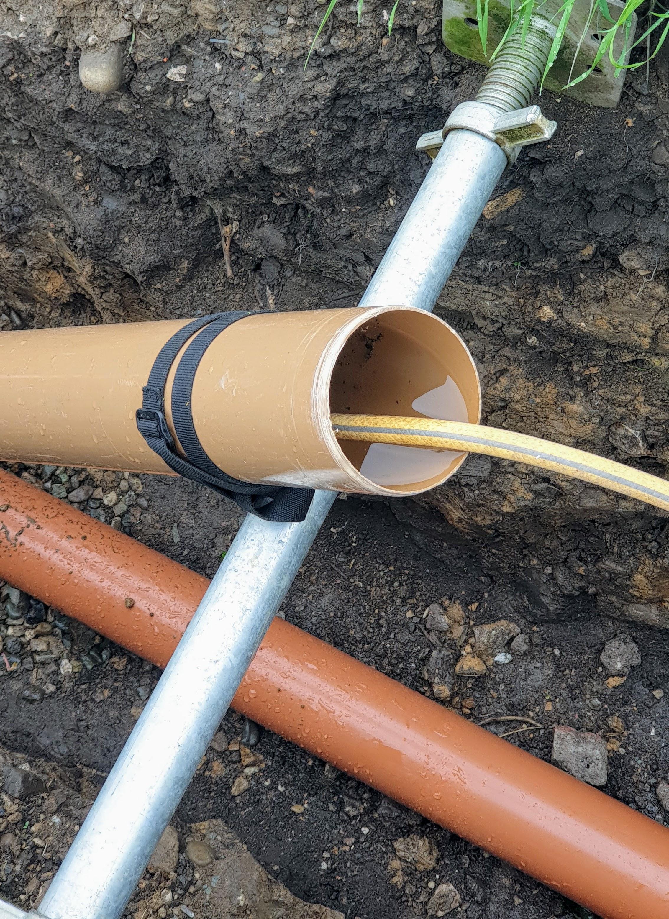

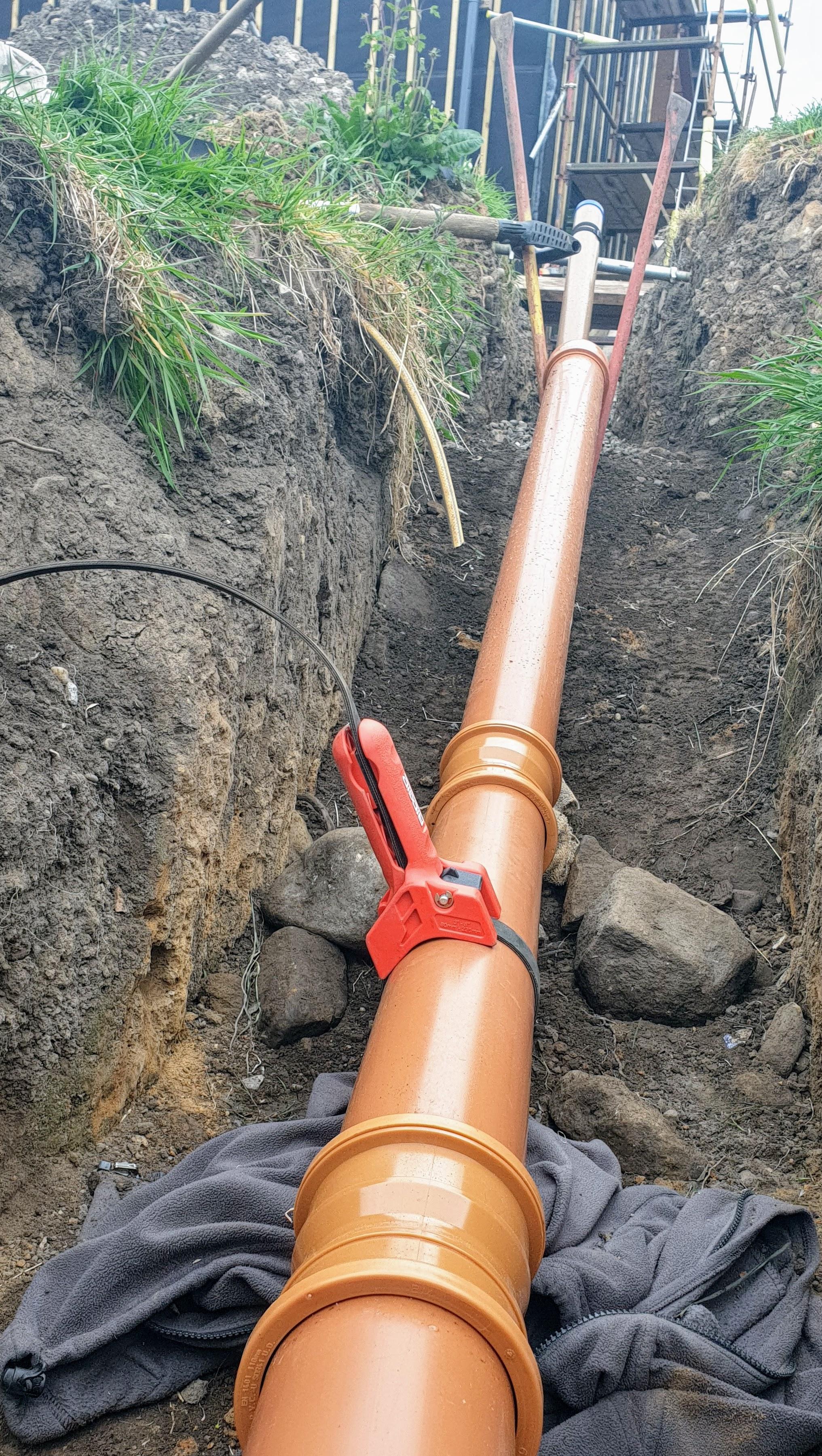

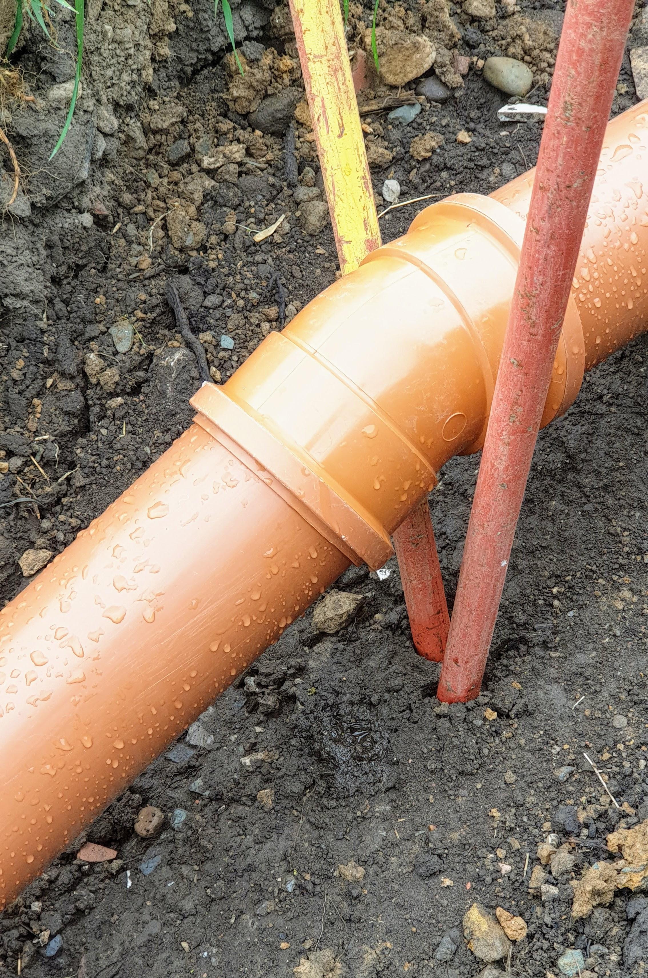

If I were to fill the piping up with water from the top of the rodding point (just visible) like this
I would effectively have a couple of meters water  pressure pressing on the bottom bungs, and maybe a bit less on each of the joints. As I started filling the pipe, my suspicion was aroused by the creaking of the plastic joints - specially this one
You can see there was a bit of a drip there, but I wasn't too suprised because its unsupported.
An hour later I got bored of checking the water level. It had gone down a bit: 100ml or so. So I went for a coffee.
The pipe is eight meters long or so - about 880,000 cc... (?)   How much is that? I dunno.
Pop! PPPPSHHHHHHHHHHHHHHHHHHHH !  I'd blown the bottom bung out hadn' I ?
Neighbour stuck his wizzened head over the fence, swallowed his tongue laughing.

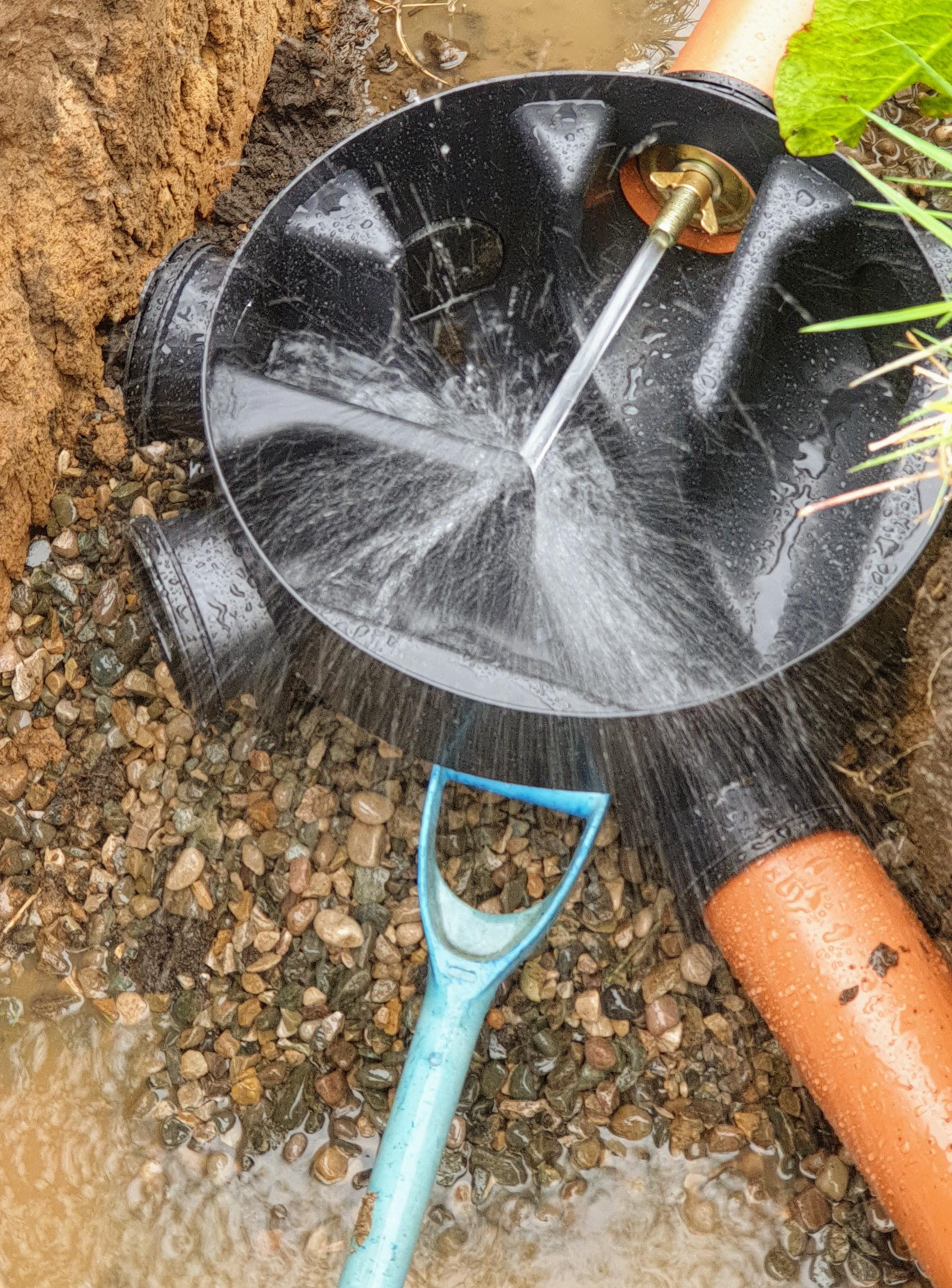

Tried it again. Full on Charles Atlas screwing the bung tight this time. Two hours later, got bored took the brass cap off the bung.
Got wet. Very wet.
I tested mine with a “cheap” bung and a head of water but it just would not stay in, it’s surprising how much pressure a few feet of head will give (along comes @SteamyTea with a graph ?).
I'm intrigued. Are you just testing your pipes are watertight? If drainage they shouldn't see any real pressure unless blocked should they.

I had exactly the same issue with a brand-new bailey kit like that. It turned out to be the rubber bulb pump leaks like a sieve from the "one way" inlet valve.
I didn't have the sense to test the kit first, it was only after I'd dismantled, cleaned and reassembled a couple of joints that I tried that and found the problem ? and subsequently from some googling established this is fairly common with the Bailey kits and general practice is to put a plastic clip on the tubing to the bulb once pumped up. Some of the instructions actually show that, though no clip is supplied.
Which, given they're pretty expensive for a few bits of plastic, I have to say I found fairly... disappointing...!

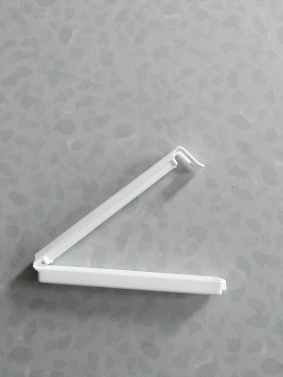

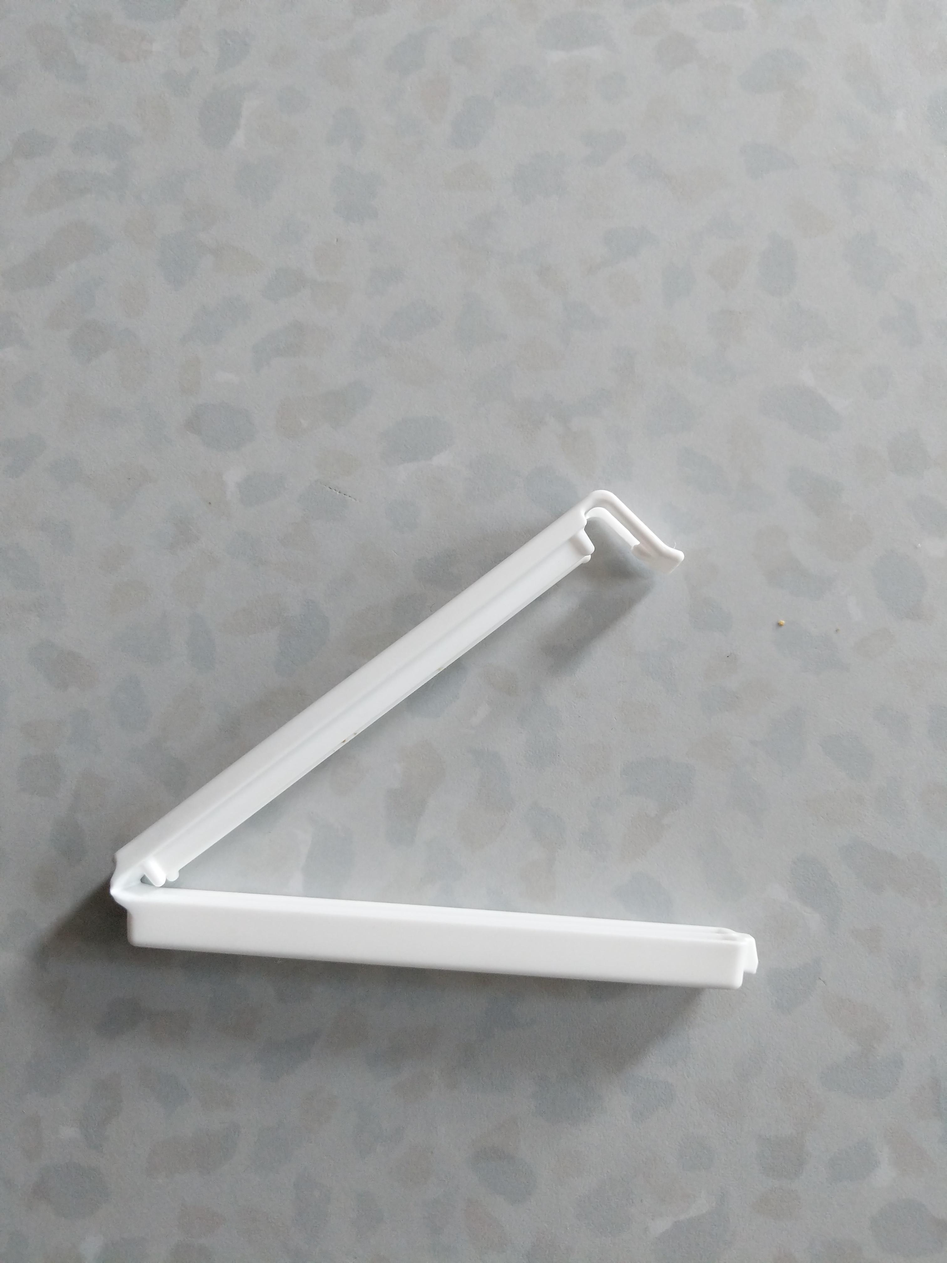

Anyone got any idea what I could use as a pipe clip? I've googled around a bit ... tried a clothes peg - a G cramp (that works, but it'd  bugger the line up in no time.) Those small plastic cramps are too weak.
I'm a bit short on lateral thinking today.... Help!
I used one of these IKEA food bag clips, folding the tube in half before clamping as per @PeterW - a decent clothes peg might also do if you told the tube first.
I nearly lost a bunk down the pipe - only just held onto the bugger.  3ft of water has more pressure than expected.  Enjoying your build so keep the 'sharing and caring' going.

Blew the bung out while doing the internal pipe test as well , this morning. Thats three meters of pipe (vertical) , so that makes about 300 litres of water pushing on it - 300 kg: you'd 'a thought I might have worked that out before hand wouldn'tcha?
