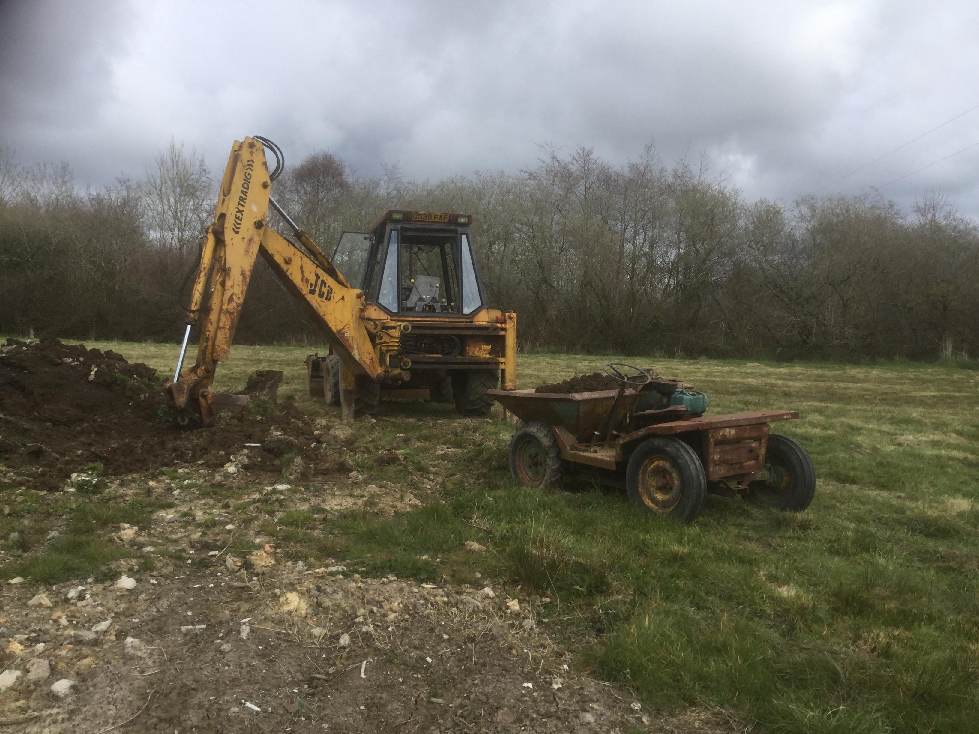

joe90 Posted April 3, 2020 Share Posted April 3, 2020 Well I have been doing some gardening (sort of!!!) but dumper refused to start so ended up stripping it right down, not sure it’s worth spending much money on a 60 year old machine. Link to comment Share on other sites More sharing options...

joe90 Posted April 4, 2020 Share Posted April 4, 2020 34 minutes ago, Oz07 said: @joe90 why don't you move it with front bucket probably fit more in than that dumper! our ground is still a bit soft so the JCB is better in one place that’s hard and the dumper good for spot loading ready to be flattened later. UPDATE, dumper broke, won’t start, Little compression, never been to bits (60 years old) guess what o am doing today? ? Link to comment Share on other sites More sharing options...

scottishjohn Posted April 4, 2020 Share Posted April 4, 2020 (edited) 1 hour ago, Roundtuit said: UPDATE, dumper broke, won’t start, Little compression, never been to bits (60 years old) guess what o am doing today If you have not taken head off yet and have access to compressed air and can make upan adaptor to feedi ncompressed air through and injector hole then get cengfine ontdc with vlaves shut on cylinder you are testing -put it ingear and block wheels .appl y90psi and listen to see where its going --up the inlet manifold ,out the exexhaust or icoming out if oil breahter . by doig this you will know what you need before you strip it looking ta istripped your bound to see things that are worn ,but they maybe are not your problem .this way you know where yuor comp is going . if you can borrow a proper cylinder leakage tester ,then unless its over 20% leakage it will be fine once its going - perfect engine will be around 4% could be simple as a vlave stuck open Edited April 4, 2020 by scottishjohn 1 Link to comment Share on other sites More sharing options...
ProDave Posted April 4, 2020 Share Posted April 4, 2020 Was the dumper burning much oil? Watch out for worn bores and rings and that "engine killer" the diesel engine running away burning lubrication oil. Usually only stops when it self destructs. If that happens the best advice is run. Link to comment Share on other sites More sharing options...
SteamyTea Posted April 4, 2020 Share Posted April 4, 2020 1 hour ago, ProDave said: and that "engine killer" the diesel engine running away burning lubrication oil. Usually only stops when it self destructs. If that happens the best advice is run. My Renault did that when the turbo oil seals went. Scared the shit out of the lad in the garage. Link to comment Share on other sites More sharing options...
joe90 Posted April 4, 2020 Share Posted April 4, 2020 (edited) Thanks guys, spent the day stripping it down, valves ok, bore etc ok, so took the injector out (don’t think it’s been out since new) and tested it and that works just fine (that surprised me!). Got blisters on my hand so don’t fancy cranking it again tonight ?, still feels low on compression, @scottishjohn will try that tomorrow. edit, just remembered, when I measured the rings in the bore there was about a 3mm gap but docs on the tinternet says should be about 14thou ?.?.?.. other measurements were not bad for 60+ years wear. answers on a postcard to .......... Edited April 4, 2020 by joe90 Link to comment Share on other sites More sharing options...
