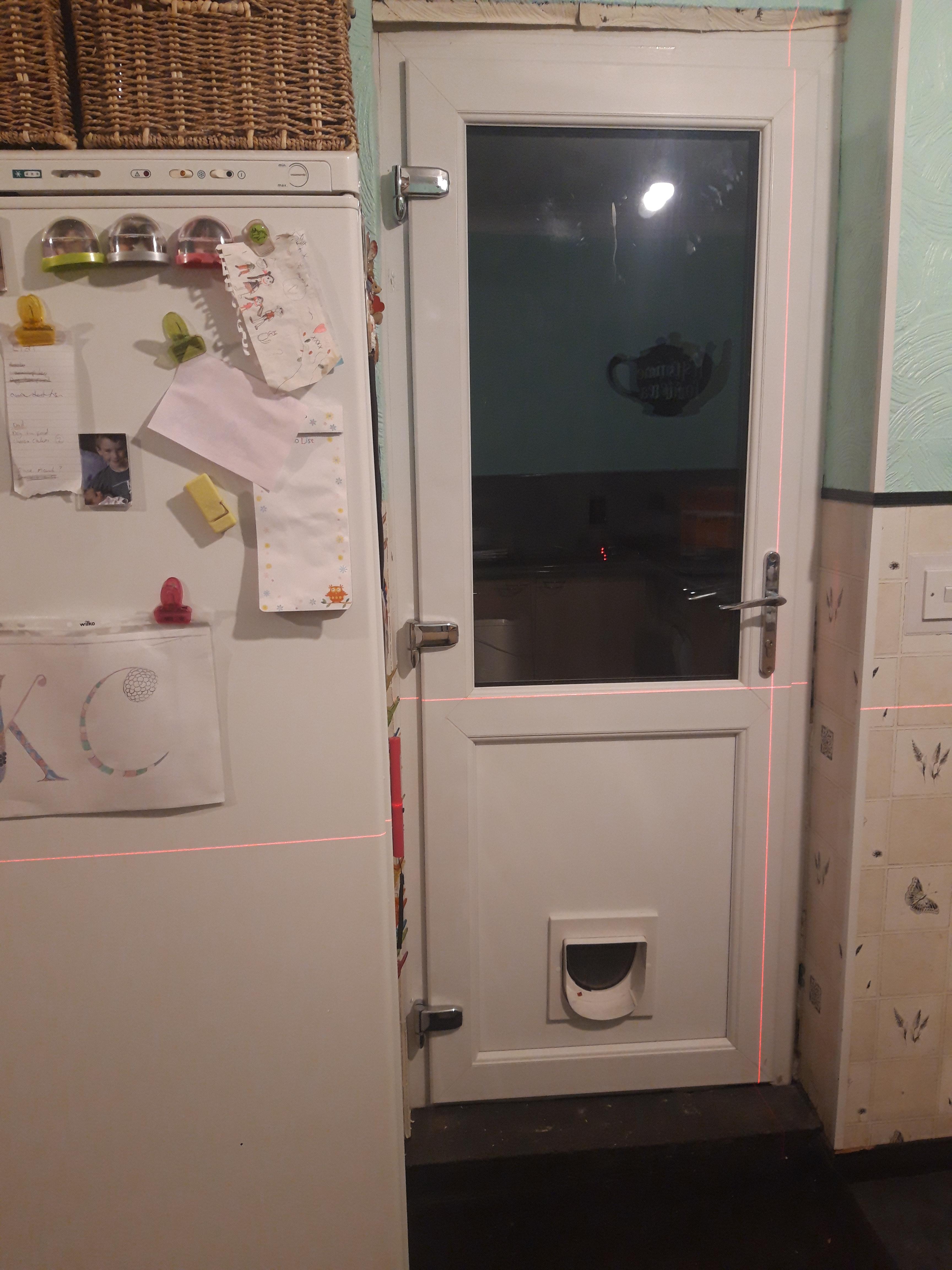

Think I need to get on with.....refitting this 2nd hand door I just put in. I used ordinary spirit levels. Rushed it a bit too tbh.
Didn't look right so stuck the laser on it. Should have used the laser first off and cut some wedges...but didn't! ?
