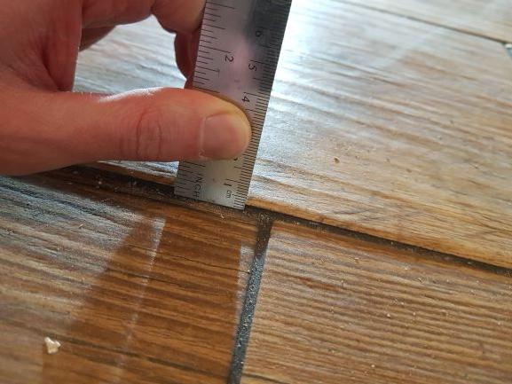

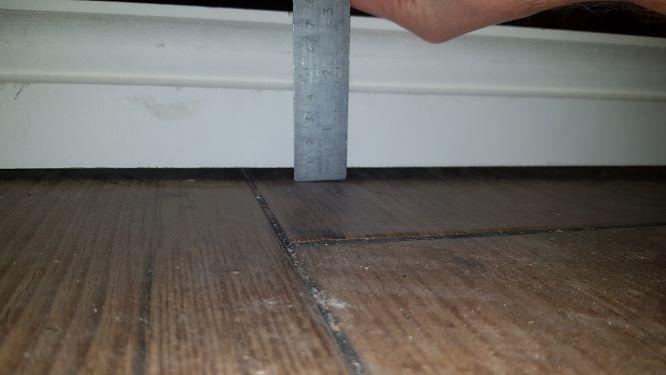

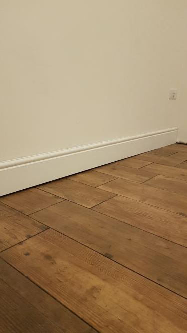

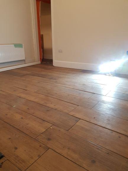

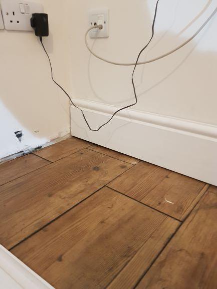

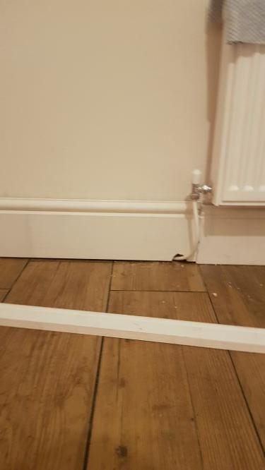

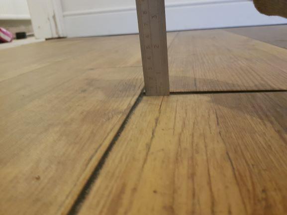

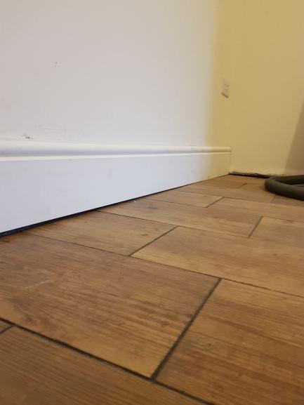

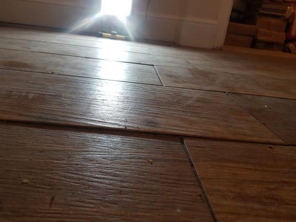

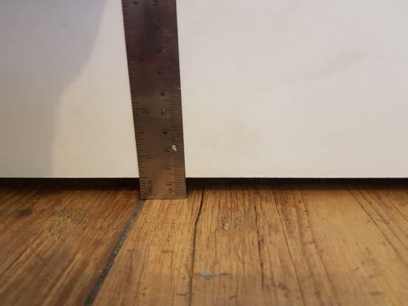

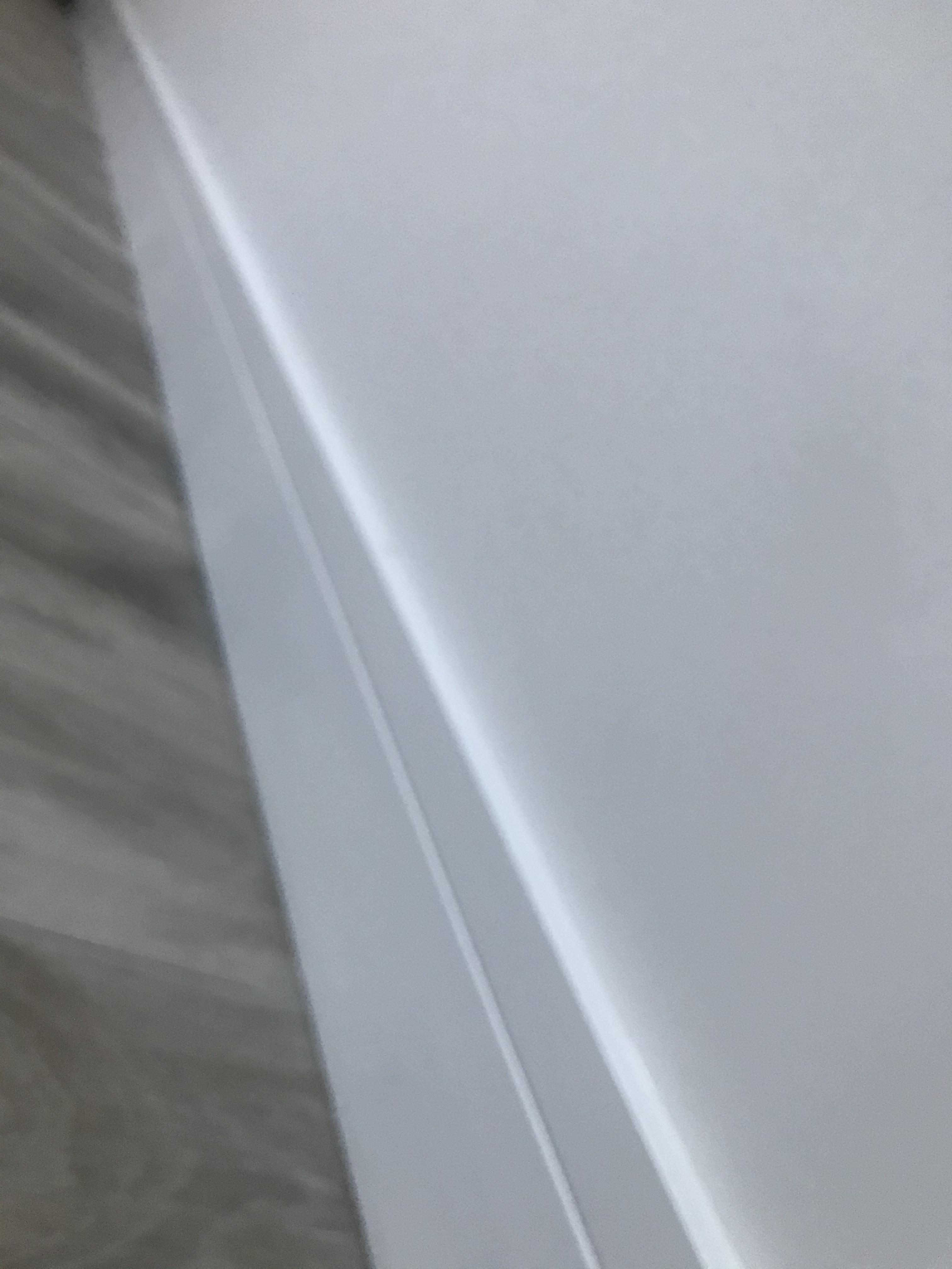

sjb1288 Posted December 6, 2019 Share Posted December 6, 2019 (edited) Hi All, I’ve just had 2 rooms tiled with oak effect ceramics and I feel a little disappointed with the final result. The tiler used self-leveller to even the floor prior to laying but I feel that this should have been done with more care, and that many of the subsequent problems are a result of this… I’ve used the closest thing I have to a 2m straight edge to check the flooring and I’m finding regular deviations of around 5-6mm. Offering up the skirting has highlighted a couple of areas far worse at 10mm & 14mm. The tiler has offered to rectify these two areas but I still have my doubts about the overall quality of the job and feel it was rushed. He spent no more than a few hours on the screed and then 3 days to lay both rooms totalling over 30 sq.m. I worry that in correcting these local defects with extra adhesive or whatever, he simply creates new problems elsewhere. There are also several areas of lipping affecting at least half a dozen tiles in each room of 2,3 & 4mm. The British Standard BS 5385 seems to say that 1mm is the tolerance for such narrow 2mm joints? The standards also seem to suggest a tolerance for levelness of 3mm over a 2m edge? I’ve only garnered this info online and haven’t actually read the specific standards but I’m wondering to what extent I could use this as a stick to beat him with? I’ve already paid £1000 in labour for the job but frankly I feel it isn’t justified. I know he’s legally entitled to try and rectify it but short of ripping it all up, I can’t see me getting a result that’s compliant with the relevant standards? I feel the best outcome for me would be to get him to fix what he can then attempt to get compensation for the rest.. Sadly I’ve already had to sue someone for a failed floor in the past so I’m all too familiar with the small claims process! Any help much appreciated., please see attached photos Edited December 6, 2019 by sjb1288 Link to comment Share on other sites More sharing options...

nod Posted December 6, 2019 Share Posted December 6, 2019 As a tiling contractor my initial thoughts are the bond (overlap) isn’t enough The square edge slats are unforgiving Tge floor needs to be flat Link to comment Share on other sites More sharing options...
joe90 Posted December 6, 2019 Share Posted December 6, 2019 I would not be happy with that from a “professional”, if I did that as a DIY job, then I would still be a bit miffed. Link to comment Share on other sites More sharing options...
nod Posted December 6, 2019 Share Posted December 6, 2019 Sorry I hadn’t read the text that accompanied the post I thought you had done this yourself so I was reluctant to be to harsh The whole floor needs to come up Trying to rectify this won’t help The going rate for a company is about £30 m2 for a good job 1 Link to comment Share on other sites More sharing options...
bassanclan Posted December 6, 2019 Share Posted December 6, 2019 It is no good, I would consider that a bad DIY job let alone a so called professional. I can't see how it can rectified without lifting at least half of the tiles Link to comment Share on other sites More sharing options...
mm289 Posted December 6, 2019 Share Posted December 6, 2019 Agree with the above I'm afraid, that is shocking. I laid some wood effect ceramic planks in our boot room last month, hated the job with a passion but it was too small and fiddly for the pro's to want to bother with. It took me forever, mainly because I didn't use enough self levelling so had to use a lot of adhesive, but i was using a 15 ft length of angle iron and a 2m spirit level constantly to make sure it came out reasonably level. Its not perfect but max lipping is maybe 1-2mm an no sigificant dips. To get that from a "pro" is appaling - trouble is as said above I can;t see how you fix it without pulling it up which means broken tiles, can you get replacements with matching batch numbers etc...... Really feel for you ?, pic of our DIY one below. Link to comment Share on other sites More sharing options...
bassanclan Posted December 6, 2019 Share Posted December 6, 2019 If there are a couple of spare tiles get two and clamp threm face to face in the centre to see if they are straight. There may be a massive bow in the tiles, which is often the case with the really cheap planks, but he should be able to overcome this with a bit of care. Did you notice if he was using a tile levelling system, or just normal spacers and a spirit level? Link to comment Share on other sites More sharing options...
Temp Posted December 7, 2019 Share Posted December 7, 2019 I think 14mm is way beyond what you should fix with adhesive (You would need a trowel with massive notches). It really looks like a floor prep issue. Not really sure what to recommend. If you can't face getting him to rip it all up try scribing the bottom of the skirting to match. Yes it's a bodge but should make it less noticeable. Link to comment Share on other sites More sharing options...

nod Posted December 7, 2019 Share Posted December 7, 2019 2 hours ago, AnonymousBosch said: Can you give us an idea of how flat flat is Gary? I ask because our screed varies by two or three mm over 5 meters ..... 3 to 5 mil is fine Ian We can cope with hollows and pre fill The main problem with these tiles are bumps I have a floor grinder which is like a large Hoover with blades I normally push this over the hole floor to take the high spots off Well work spending 50 quid and hiring from speedy for the day 1 Link to comment Share on other sites More sharing options...

Mr Punter Posted December 7, 2019 Share Posted December 7, 2019 It is not acceptable. He may have some defence if the tiles are banana like, as I understand is quite common with the planks and it would also explain why they have been laid with a very small bond. Take 2 tiles and place them back-to-back, then face-to-face to see how flat they are. Link to comment Share on other sites More sharing options...
scottishjohn Posted December 7, 2019 Share Posted December 7, 2019 2 minutes ago, Mr Punter said: He may have some defence if the tiles are banana like, as I understand is quite common with the planks No not really,as a professional he should have checked the tiles before laying if its such a common problem and if not flat -report to customer before commencment of tile laying 1 Link to comment Share on other sites More sharing options...

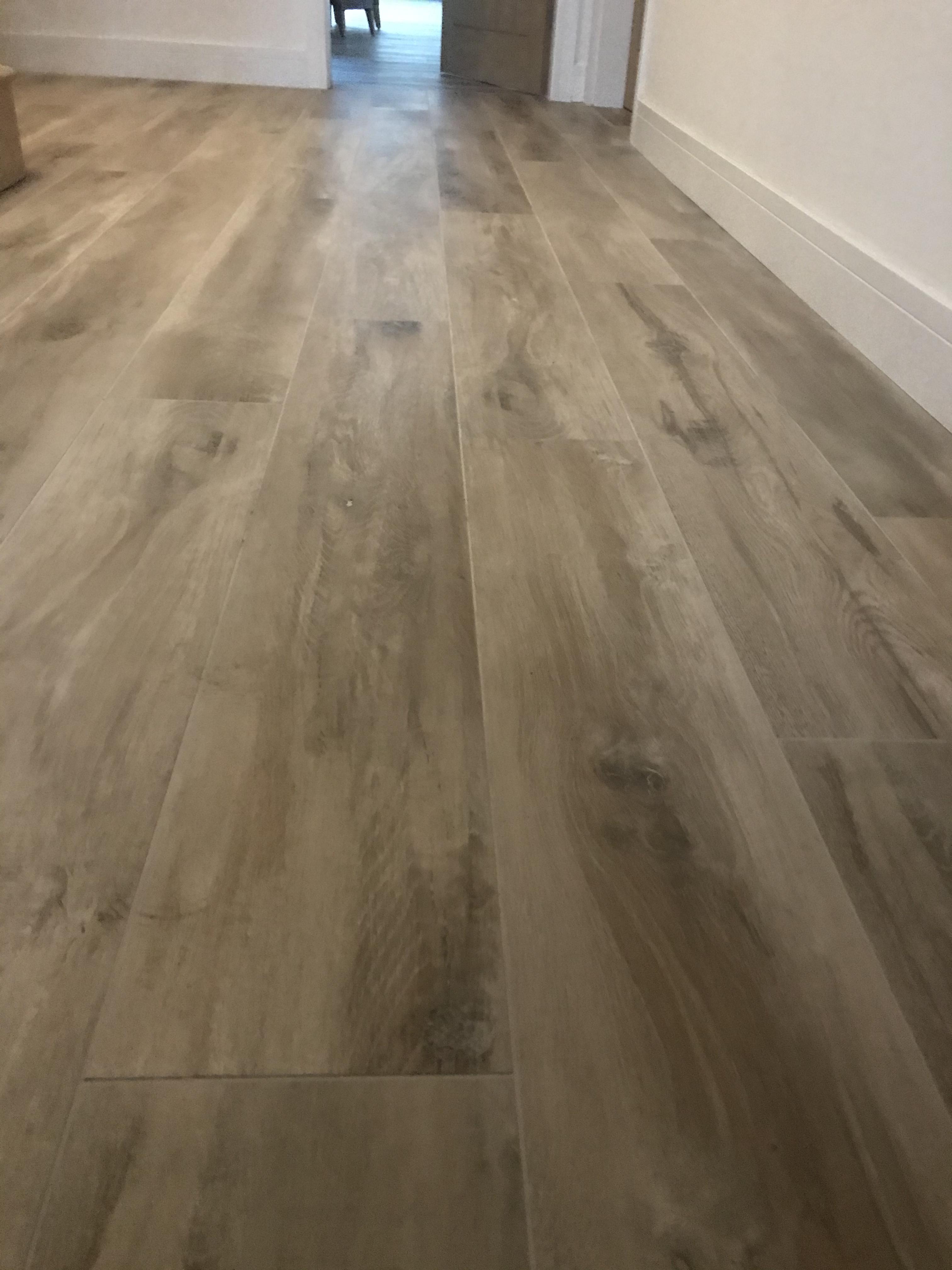

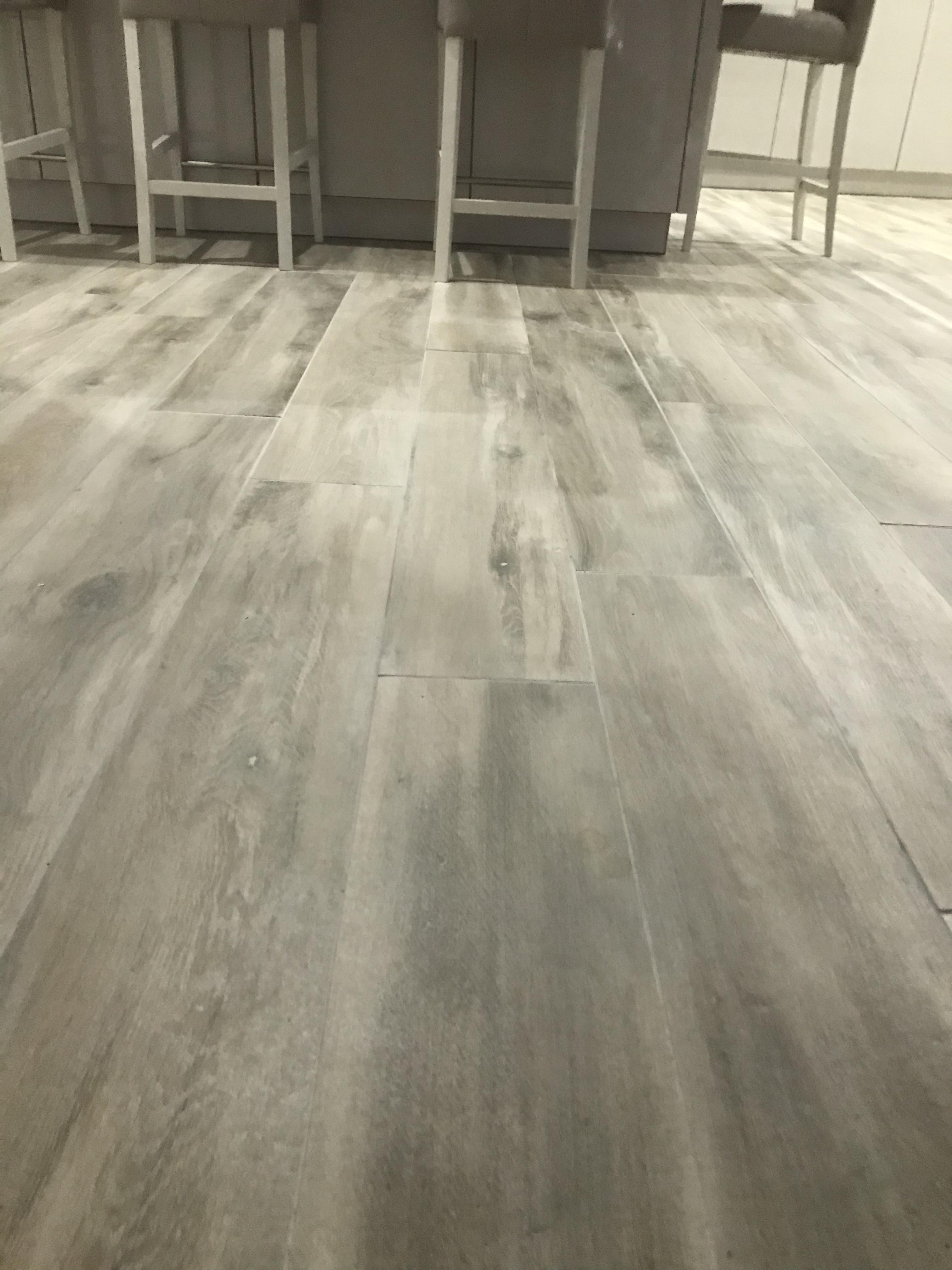

nod Posted December 7, 2019 Share Posted December 7, 2019 I tiled ours with my able assistant (Wife) 250 m2 over four days I didn’t use self levellers but made sure the floor was flat Your tiler will quote tolerances 2 to 3 mil with this type of tile you can live with Skirtings should be pretty tight It May be one for small claims If you go down this route Contact a registered tiling company for a small fee there estimated will list the faults and cost to rectify Good luck 1 Link to comment Share on other sites More sharing options...
scottishjohn Posted December 7, 2019 Share Posted December 7, 2019 4 hours ago, nod said: Tops will tell you that there is always camber on the 1200 & 1500 planks that they sell Turkish The Italian are more expensive but flat and don’t need a level Ming system maybe that is the point we should take from this cautionary tale -- If you buy cheap ,then better check qualkity very carefully before laying the extra in adhesive to get a good job could be the cost difference between cheap and good Link to comment Share on other sites More sharing options...

nod Posted December 7, 2019 Share Posted December 7, 2019 7 minutes ago, scottishjohn said: maybe that is the point we should take from this cautionary tale -- If you buy cheap ,then better check qualkity very carefully before laying the extra in adhesive to get a good job could be the cost difference between cheap and good I know I keep saying it But the Italian laser cut tiles are a joy to lay There’s a reason why some tiles are retailing at 50 while similar are 18 The ones I’ve pictured are 53 plus vat in the showroom I bought a direct load from Italy for 29 including vat and delivery Not one bad shaped tile no chips You can easily tell the Italian tiles as the glaze runs over the sides to the bottom of the tile preventing chips and the wood print is much more realistic Spanish are not far behind Link to comment Share on other sites More sharing options...
