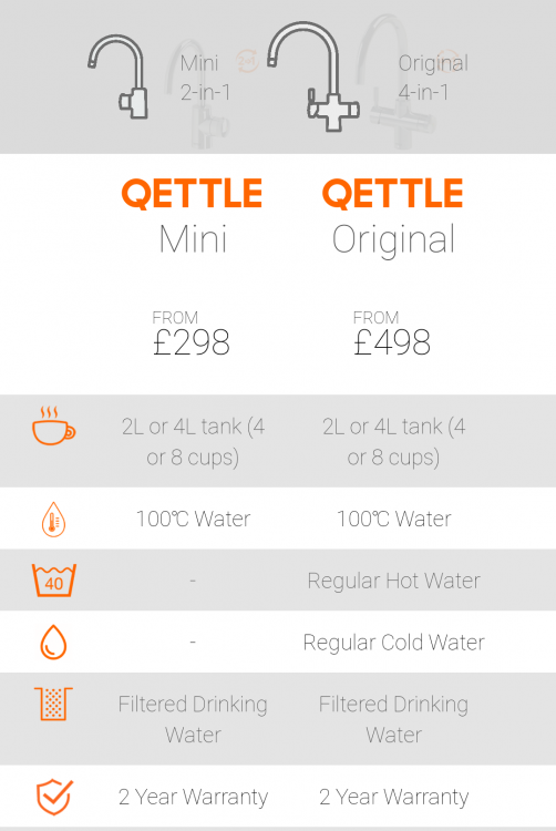

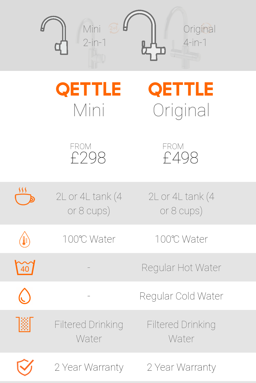

Jenni Posted October 26, 2019 Share Posted October 26, 2019 I seem to get a lot of sm adverts for this one - https://www.qettle.com/ Link to comment Share on other sites More sharing options...
Construction Channel Posted October 26, 2019 Share Posted October 26, 2019 5 minutes ago, Jenni said: I seem to get a lot of sm adverts for this one - https://www.qettle.com/ That does seem to tick most of my box's...... Link to comment Share on other sites More sharing options...

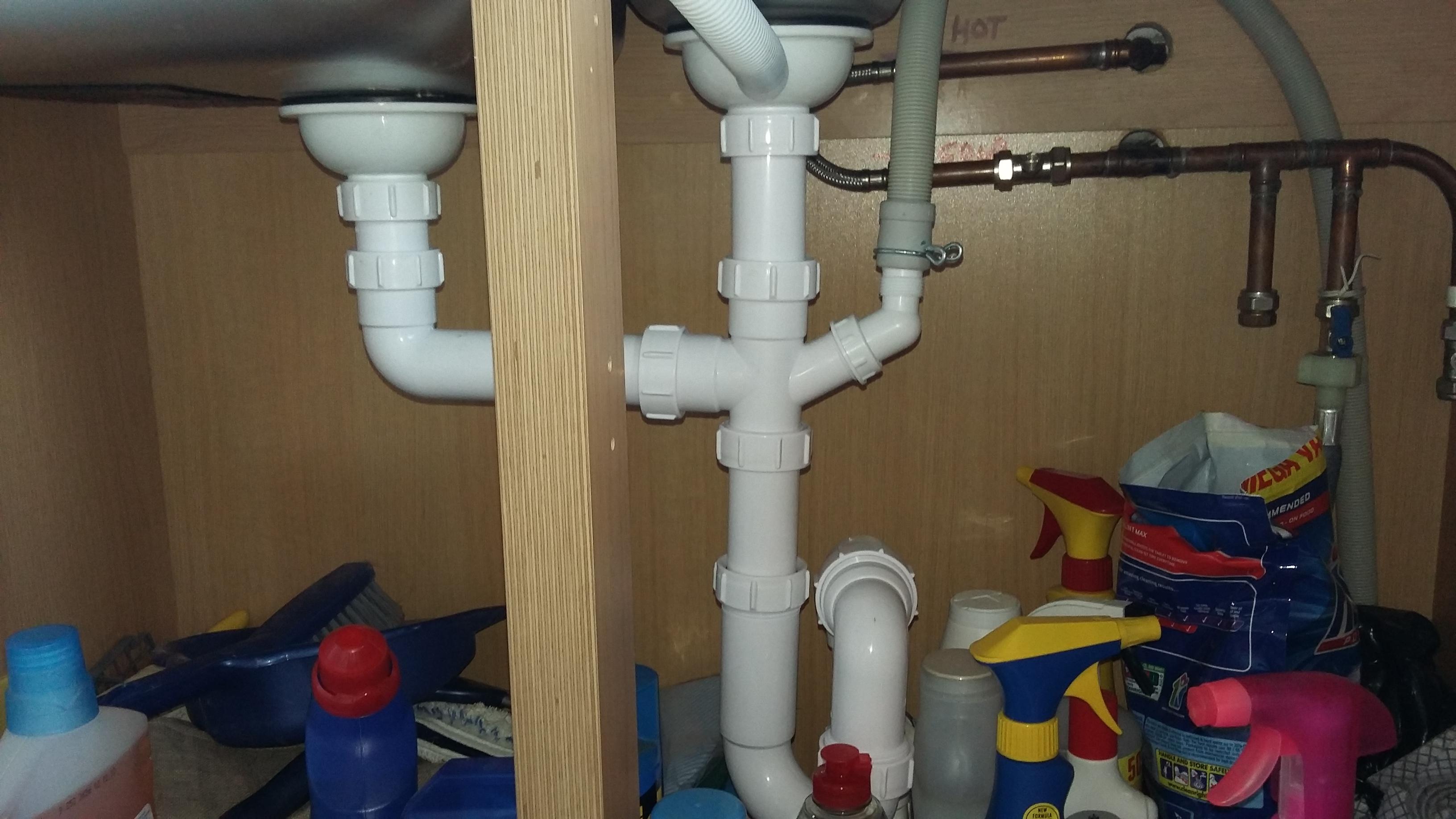

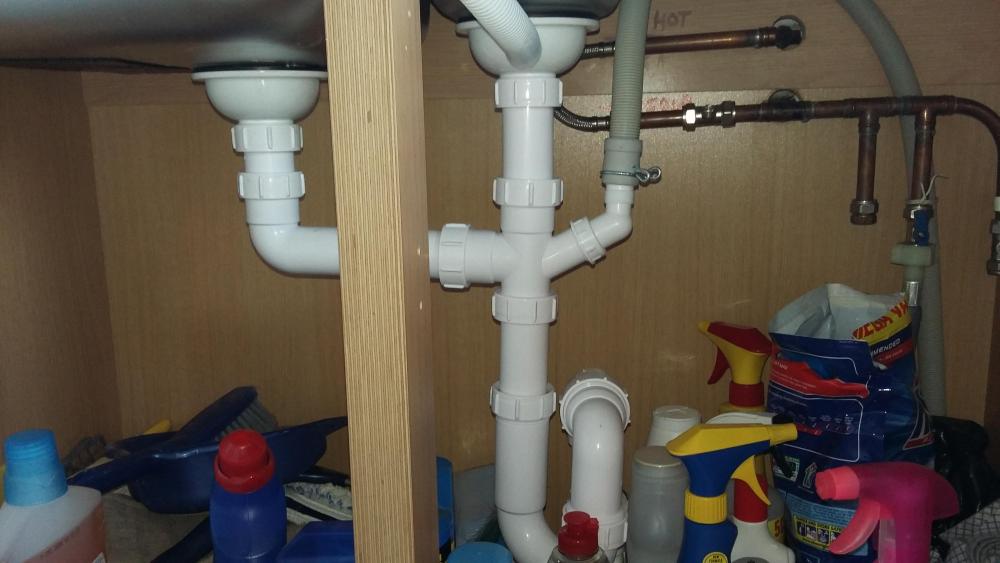

ProDave Posted October 26, 2019 Author Share Posted October 26, 2019 My next question is connecting the tundish discharge. I have a 2 bowl waste kit very much like this one https://www.screwfix.com/p/floplast-double-bowl-sink-trap-kit-white-40mm/80588 It connects the two sink bowls and has ONE point to connect an appliance, currently used by the dishwasher. The MI for the HW tap says to connect the tundish via a bit of hose to an appliance connector. So todays question, is HOW to add a second appliance connector to that sink waste set, OR can someone point me to a dual bowl sink waste kit that has TWO appliance connector points? (I need to buy one for the utility room, so the one I have could move to the utility room if I buy a new one for the kitchen) Link to comment Share on other sites More sharing options...
PeterW Posted October 26, 2019 Share Posted October 26, 2019 3 minutes ago, ProDave said: It connects the two sink bowls and has ONE point to connect an appliance, currently used by the dishwasher. The MI for the HW tap says to connect the tundish via a bit of hose to an appliance connector. So todays question, is HOW to add a second appliance connector to that sink waste set, OR can someone point me to a dual bowl sink waste kit that has TWO appliance connector points? (I need to buy one for the utility room, so the one I have could move to the utility room if I buy a new one for the kitchen) McAlpine WM11 one has two appliance connectors. https://www.wickes.co.uk/McAlpine-WM11-Sink-P-Trap+Twin-Nozzles---38mm/p/226994 Not a fan of the Floplast one you linked as the horizontal run from the second sink can collect crud, dry out and start to smell. Much better to put a pair of traps on - usually works out cheaper too - so you can keep using one if the other blocks or needs cleaning out. Link to comment Share on other sites More sharing options...

ProDave Posted October 26, 2019 Author Share Posted October 26, 2019 This is the waste I have in use at the moment I could add the in line adaptor either in the horizontal section from the left hand bowl, or in the vertical section above the trap. Set up this way, the main larger sink is the left hand one so that horizontal section of pipe gets plenty of flow so should stay sweet. It is the vertical drop from the half bowl that gets less use. This is the standard 2 bowl sink waste that Howdens supply. This is presently connected to a temporary sink that will be moving to the utility room. When we do the boiling water tap it will be part of finishing the kitchen involving a new sink and a stone worktop, plus the boiling water tap. I need another waste. I could move this one with the sink to the utility room if a more appropriate one with 2 appliance wastes was available. Link to comment Share on other sites More sharing options...
dpmiller Posted October 26, 2019 Share Posted October 26, 2019 A self-cutting adaptor on the vertical section above the trap? BES 6957 or similar... 1 Link to comment Share on other sites More sharing options...
