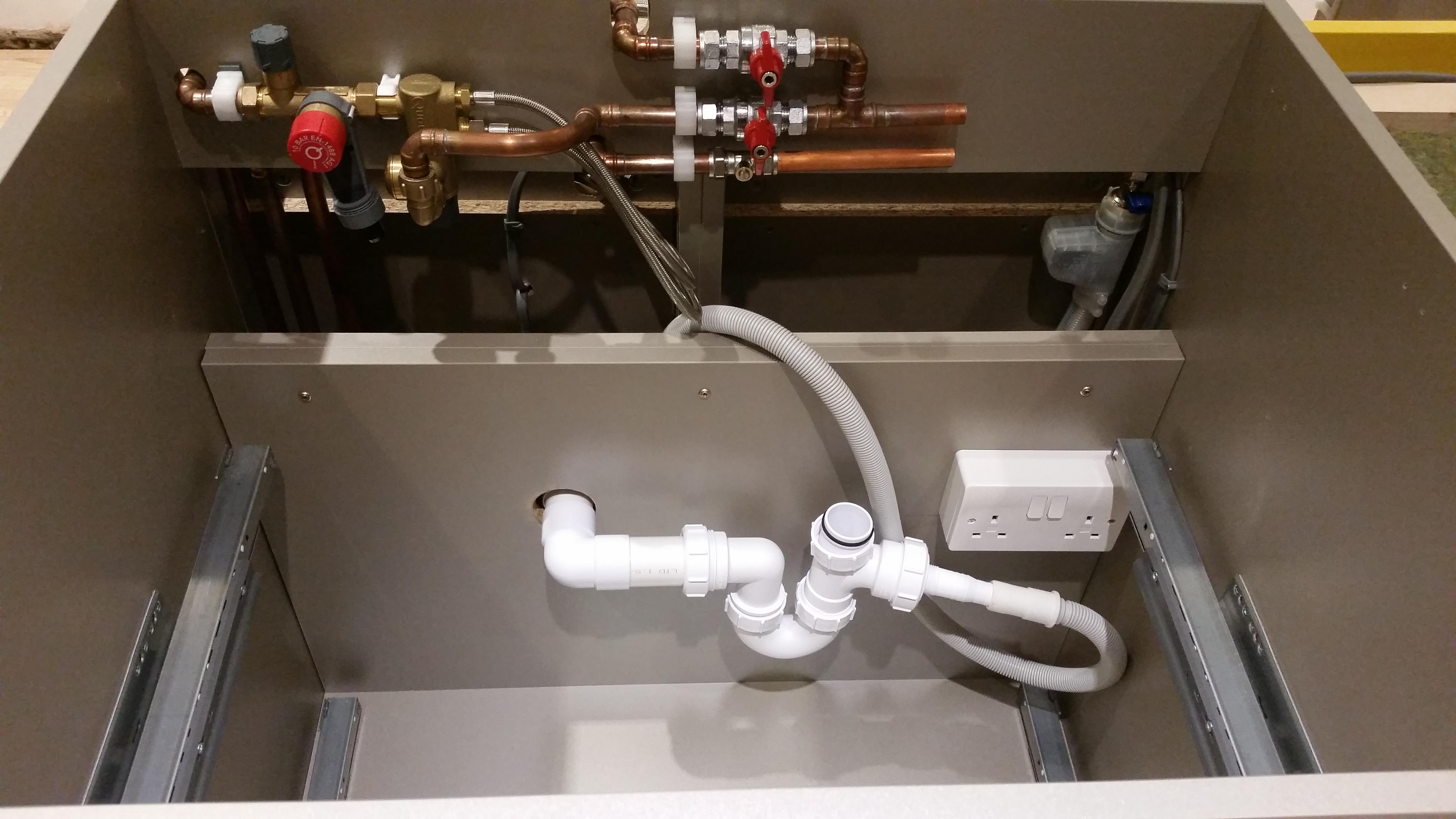

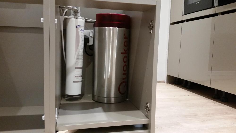

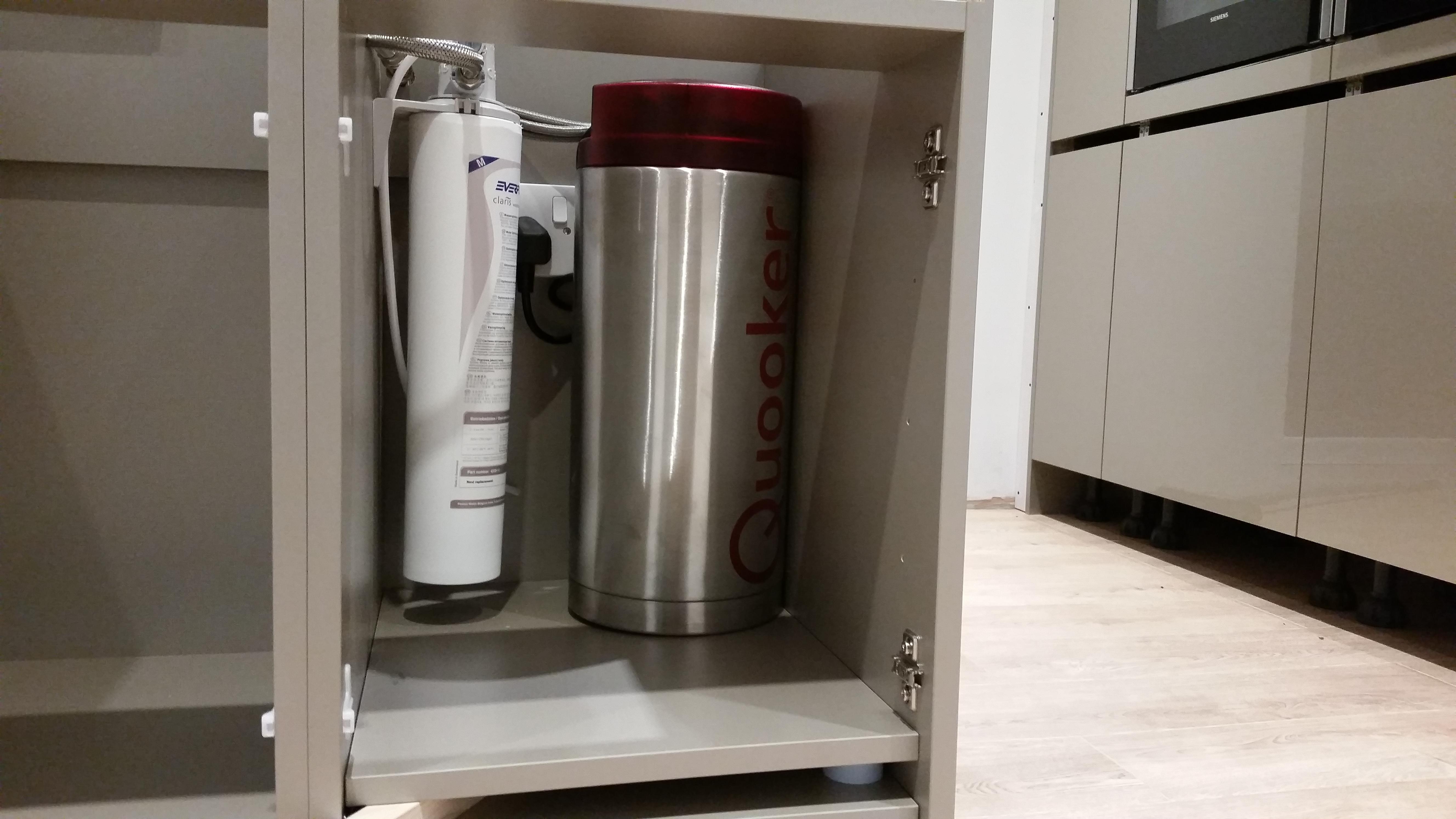

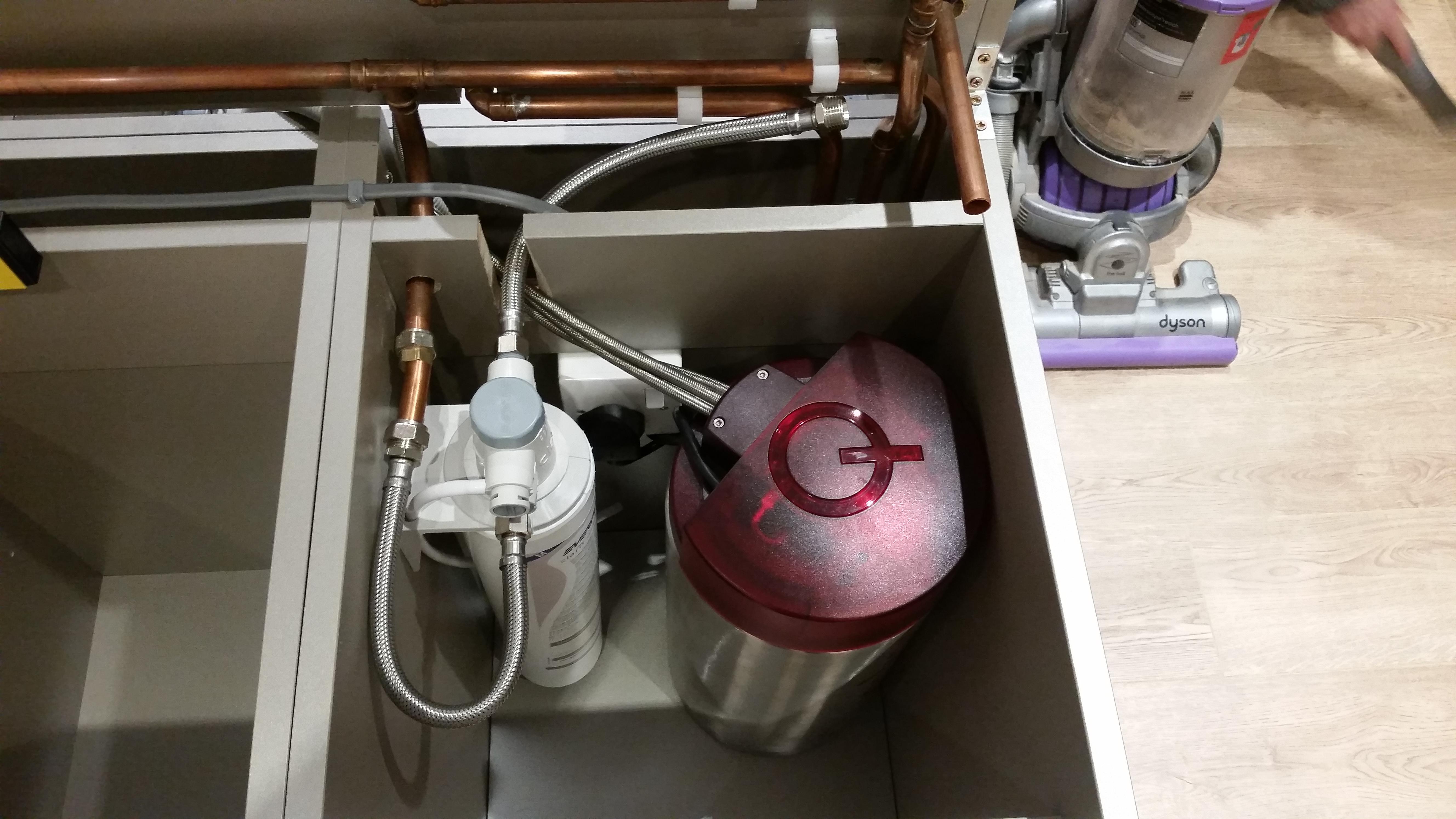

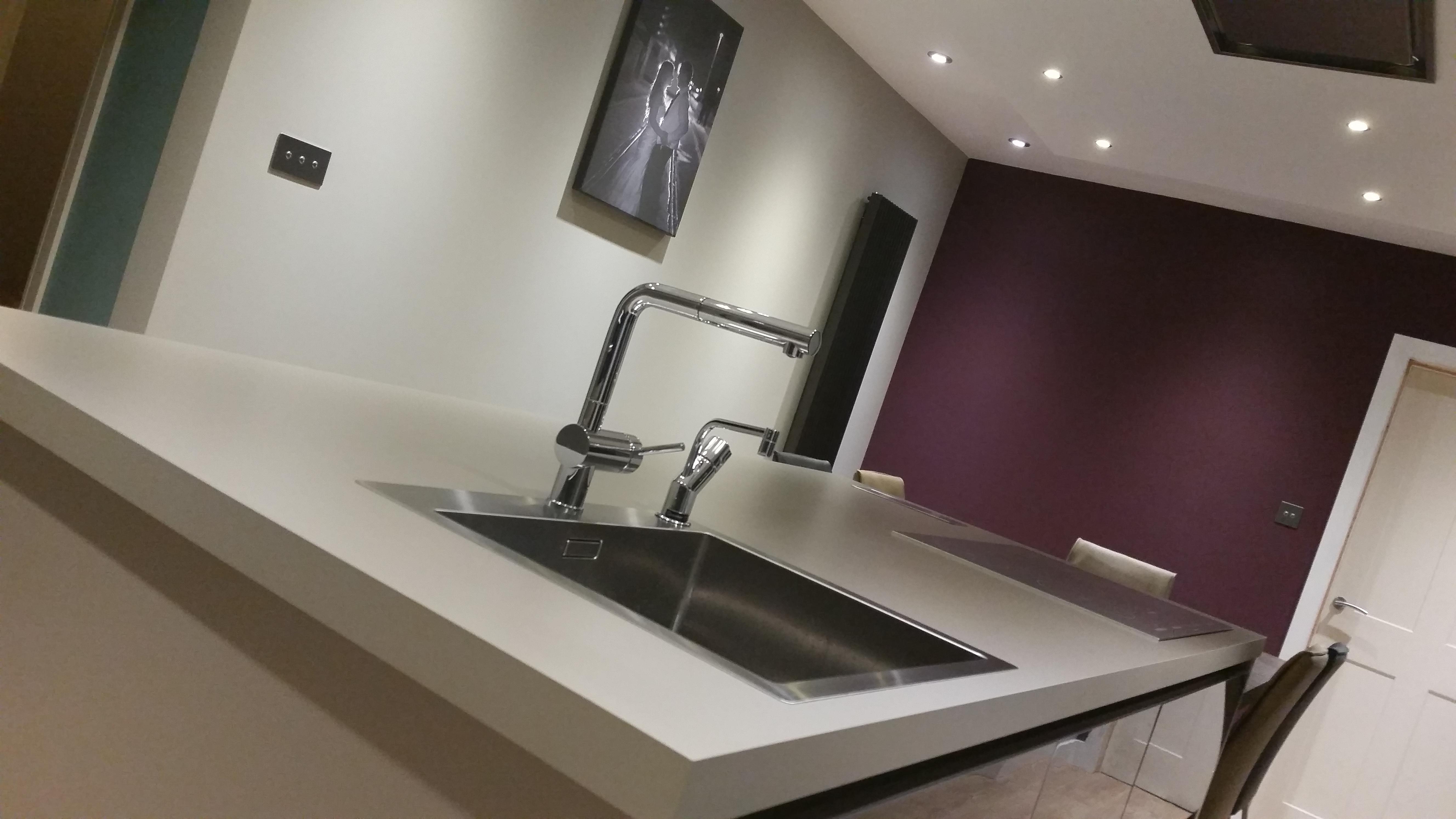

November 10, 20197 yr I'll always fly the flag for Quooker. We fitted ours when our Kitchen went in about 5 years ago. It's the 7 Litre standalone one (overkill, but I got it RIDICULOUSLY cheap). Here's my DIY plumbing effort, it's fitted in it's own cupboard, along with a catering-grade filter. The cartridges for the filter are expensive, but I've changed it twice in 5 years and am still getting crystal clear Tea. I'm in the South East, where the water is terrible. It hasn't missed a beat. Not once and I'd definitely buy another if we get to go ahead with our self-build. Oh, the sharp-eyed among you might spot my little plumbing trickery. I fitted a divert system. In the event of the boiler failing for any reason, reverse the positions of the 2 red taps and the domestic hot water for the kitchen sink will be supplied from the Quooker (ours was before they did the combined taps etc).

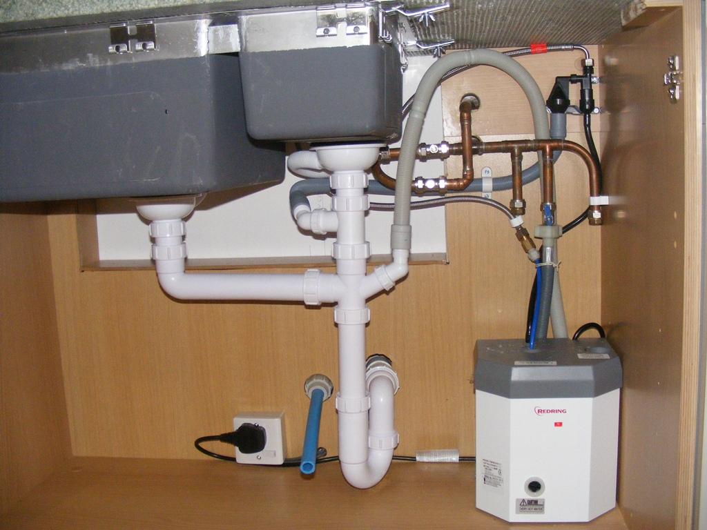

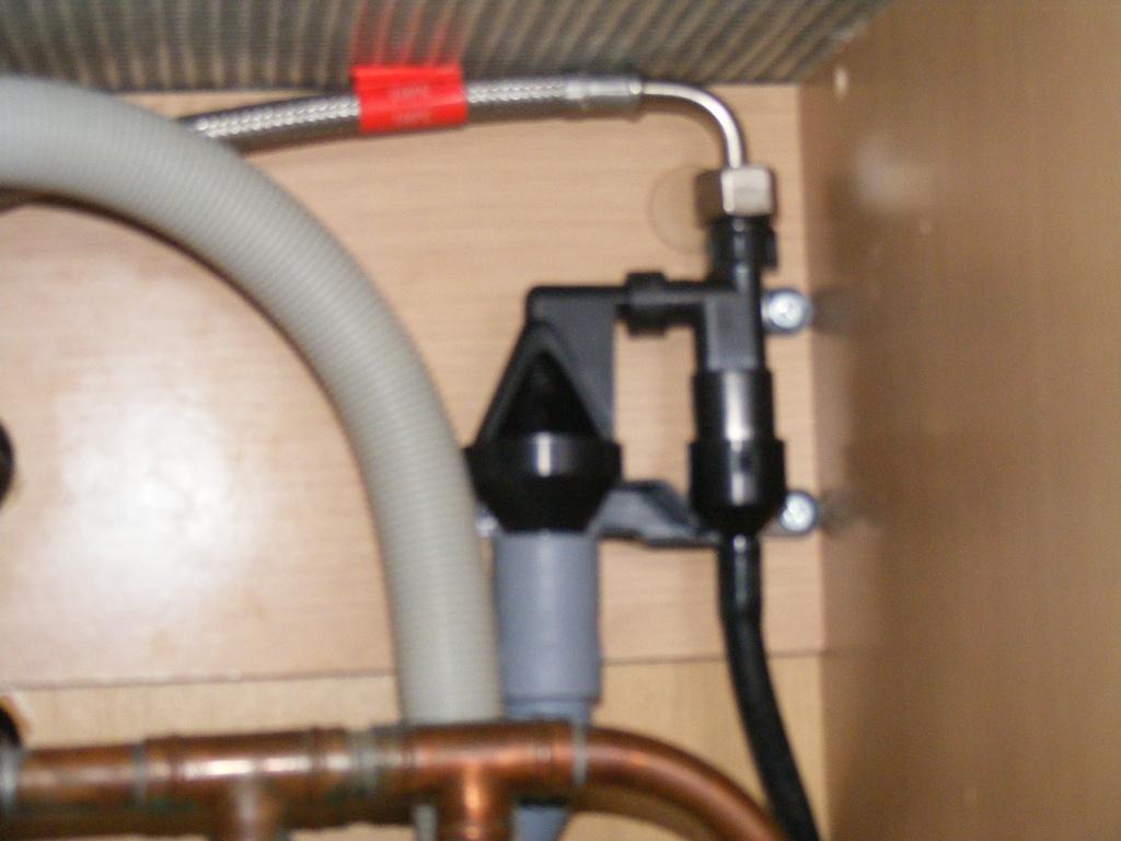

December 16, 20196 yr Author I finally got my Lamona / Redring boiling water tap installed today. That's using the McAlpine additional appliance connector below the half bowl, and the standard appliance connector below it for the dishwasher. I have yet to put the sink unit back together and fit the shelf in it. Fitting the tap was easy as I fitted it after the worktop was in, but before the sink was fitted. Hopefully if ever I need to change it, the large cut out I made in the rear of the unit will afford enough access. There is one issue / oddity. All the time you are running the boiling tap, some of the water discharges through the tundish. Here is a (sorry very poor) picture. The black hose is the boiling water out from the heating tank. The braided steel hose goes off to the actual tap outlet. The grey hose from the bottom of the tundish goes off to the drain via one of the appliance connectors. Can anyone explain exactly how this is supposed to work. If it is "normal" for some of the boiling water to go straight down the drain then that is disappointing and wasteful. Otherwise I have some sort of problem. I did as the instructions said and mounted this tundish as high in the sink unit as possible.
December 16, 20196 yr Ours periodically spurts a bit into the tundish, just before the thermostat shuts off, I think. I reduced this a bit by turning down the pressure, as ours came with a adjustable pressure reducing valve on the input. Reducing the pressure also reduces the amount of spitting from the tap. One thing I did add to ours was a time switch (just a standard immersion timer) in the supply, plus a shut off (holiday) switch high up right at the front of the cupboard. The timer means that the boiler is only on during the day, and the shut off switch makes it easy to go around turning stuff off when we go away.
December 16, 20196 yr Author I have re read the manual and it says it is normal for the tundish to "drip" during normal operation. I definitely have a flow, not a drip. I am going to temporarily run the discharge hose to a bucket so I can measure how much is discharging. A phone call the the technical help line is called for, but not until I can find a non 0845 telephone number for them (not included in my call plan and as I found out once, VERY expensive to call) EDIT: just done that test. If I fill a mug with boiling water, about a quarter of a mug full of boiling water goes down the drain. That does not sound right to me.
December 16, 20196 yr Sounds way too much to me. Ours just lets a few drips out for maybe 10 seconds, once every hour or so, probably as the boiler comes to the boil. Is there a pressure reducing valve on yours? On ours, this is combined with the pressure relief valve and outlet to the tundish, and is adjustable to set the required flow rate at the tap. You can just see it in this photo, the relief valve knob is right above the tundish, the pressure reducing valve control knob is the smaller one to the left:

December 18, 20196 yr Ahhh i have just checked my one (redring from howdens) and i have a deffinate flow from the tundish aswell, my feeling is that it is a safety feature as i would not like boiling water coming out the tap at mains cold pressure as that could be pretty dangerous
December 18, 20196 yr Author I managed to phone them yesterday. Having gone through a load of checks with them on the phone to confirm it was installed properly, they agreed it was wrong and have ordered a replacement drain valve thing. But they can't say when I will get it as it's presently out of stock. It works okay as it is, but being a poor self builder, I don't like the thought of roughly 25% of my boiled water just going straight down the drain.
