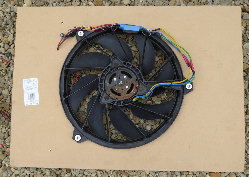

Jeremy Harris Posted October 24, 2019 Share Posted October 24, 2019 12 minutes ago, joth said: Does someone have a guide to making this home made blower? Sounds a fun project. I'm assuming it's really just for diagnosing leaks not making an accurate measurement? Photos of mine: I used an old car cooling fan, with the motor replaced with a brushless DC one for better speed control. The motor and speed controller are standard model aircraft parts from China (Hobbyking, I think). The speed is adjusted using a model aircraft servo tester, fitted with a better knob. The thing runs from the DC power supply in the photo. It's massively too powerful for testing a passive house, but was fine for finding air leaks in our old, 1980's, house. The bit of MDF was cut to be a tight fit into an open bedroom window. 2 Link to comment Share on other sites More sharing options...
Ed Davies Posted October 24, 2019 Share Posted October 24, 2019 6 minutes ago, joth said: I'm assuming it's really just for diagnosing leaks not making an accurate measurement? Yes, that's right. It won't be calibrated so there's little you can say about the actual air change rate but it'll show up leaks and, depending on how you use it, may give you an idea of relative changes in leakage. Here's a thread on the subject from the other place. Sadly, the pictures seem to have disappeared: http://www.greenbuildingforum.co.uk/newforum/comments.php?DiscussionID=7396 1 Link to comment Share on other sites More sharing options...

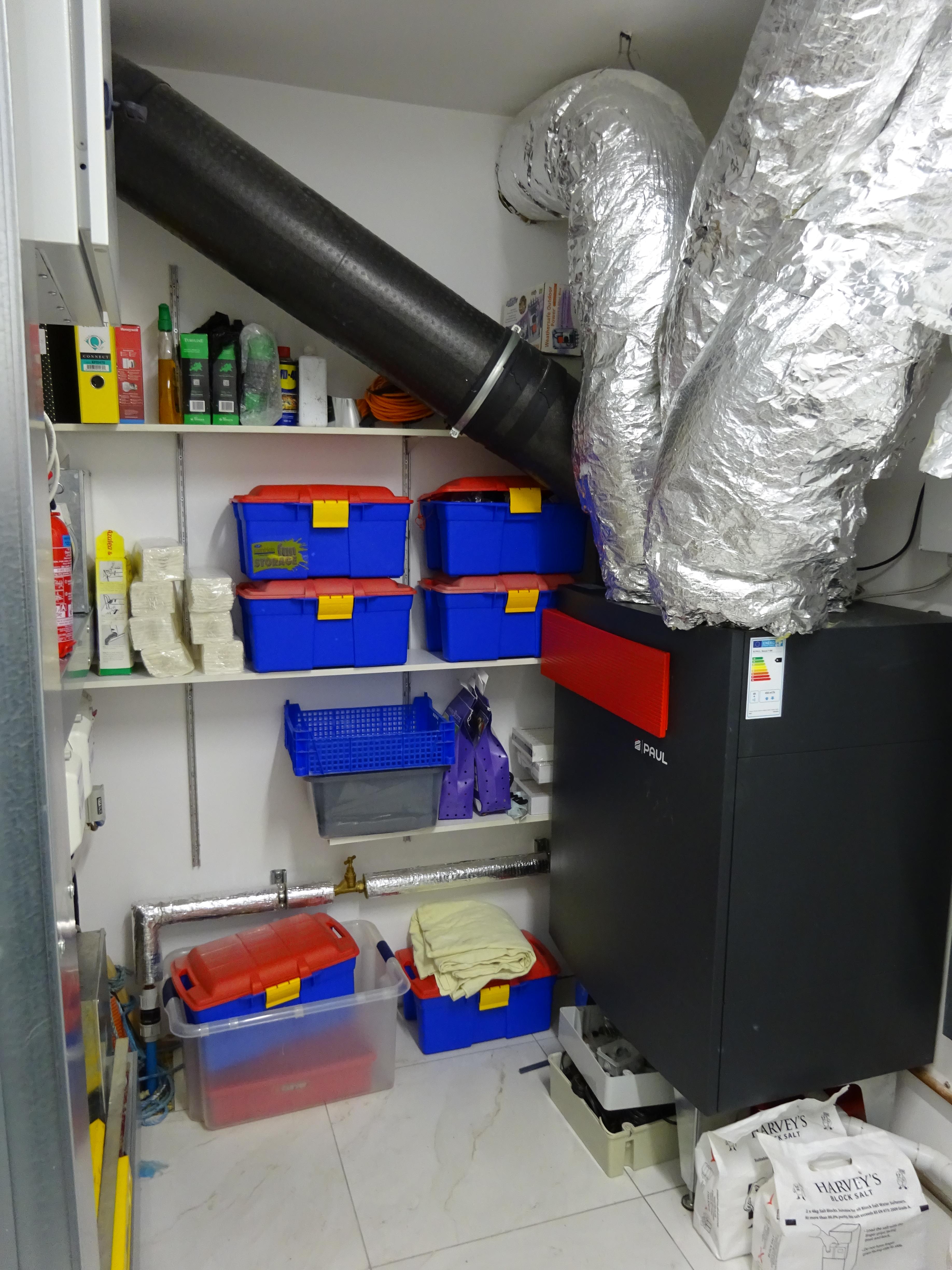

HerbJ Posted October 24, 2019 Share Posted October 24, 2019 (edited) On 24/10/2019 at 08:44, jack said: I know others who've had Paul units installed who are very happy. @HerbJ is one, from memory. Yes, I installed a Paul Novus 450 in 2016 and it has been operating successfully and quietly since it was commissioned in October 2016. I routinely change the filters. It is installed in a reasonably Plant Room , which is accessed from the garage and is adjacent to the downstairs cloakroom and pantry/utility room. The MVHR unit is mounted on feet, directly to the floor (passive foundation) and not attached to the TF structure, so no vibration induced noise.. I ensured that good sound insulation was installed on walls and ceiling. When in the Plant Room, the MVHR unit is relative quiet in normal operation but the noise increases on boost, but not enough to be uncomfortable when working in the room ( cleaning golf clubs as I was on Monday). Outside the Plant Room, in the garage or house, it is completely silent, though if you have really good sensitive hearing you might just hear a very low noise on boost, when you are in the cloakroom. The MVHR unit has flexible silencers to connect to the steel ducting, which goes to the two plenums in the room above ( see plenum). I have also wrapped both the flexible silencers and the insulated extract duct (from the MVHR to the outside extract grill) with a layer of aluminium foil faced ductwrap insulation, which made a noticeable reduction to sound level on boost. The Plant Room is located immediately, below the Guest Bedroom and there has never been a noise problem. In fact, the inlet and extract plenums are installed in a service cupboard in the guest Bedroom and they are completely silent. The plenums are connected by steel ducting and a large silencer before the inlet plenum and a flexible silencer on the outlet from the extract silencer. All the inlet and extract vents in each room are reasonably silent except for a slight increase in noise on the extract in the Family Bathroom when on Boost. Edited October 25, 2019 by HerbJ 1 2 Link to comment Share on other sites More sharing options...
