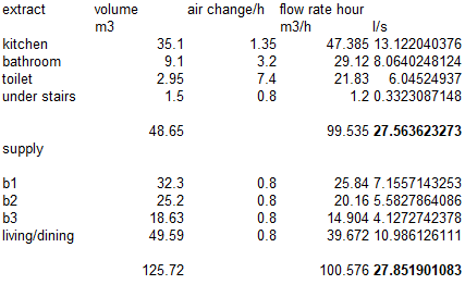

@Ed Davies I got this chart from another topic and used it for my house. The chart was done this way just so I can balance the supply and extract. The extract side isn't enough to satisfy building regs (minimum extract flow rates from the kitchen (13l/s), bathrooms (8l/s), utility room (8l/s) and WC (6l/s)) in normal operation mode, so I will need to set the boost to meet the minimum flow. If something is wrong please let me know.

To balance the system out, I can only meet BRegs on boost and I understand that this is acceptable.

@Savage87, forgive me if I've missed something earlier in the thread, but have you had an air test on the property? If not, it may be worth doing so before even considering installing MVHR as, if the airtightness is not great, you may find that no MVHR unit is going to work efficiently.
There are two building regs requirements to meet.  The first is that the whole dwelling continuous background ventilation rate has to meet or exceed 0.3l/s/m2 of total floor area.  This needs to be on the normal ventilation setting, not boost.  The other requirement is the extract rate from designated rooms, 13l/s from the kitchen, 8l/s from bathrooms and utility rooms, and 6l/s from WCs.  This can be on boost, but in all probability the requirement to meet the whole dwelling ventilation rate on the normal setting will dominate.
The system must be balanced at the continuous ventilation rate, but can be allowed to go out of balance a bit at the boost rate if that's unavoidable.

@JSHarris From the chart that I produced on my first post the values in bold
14.78 + 14.82 l/s = 29.6l/s this is for the continuous background ventilation rate which exceeds 0.3l/s/m2 ( 90 x 0.3 = 27l/s) have I calculated this correctly?
The extract rate from designated rooms are shown in l/s below and I can't acheive under normal operation mode, but will be able on boost

Looks like the whole dwelling background ventilation rate is the same as the required extract rate for the kitchen + bathroom + WC, then.
The kitchen needs 13l/s, the bathroom 8l/s and the WC 6l/s, so 27l/s for extract, and if the net internal floor area is 90m2, then the whole dwelling continuous background ventilation rate is also 27l/s.  It's often the case that the whole dwelling continuous rate ends up being the thing that determines the ventilation rate needed, which is handy, as it saves having to mess about considering the impact of boost settings, as boost isn't needed to comply with the regs and everything can be set at the background rate.
To put things in perspective, I reckon I managed to get our old house pretty well sealed, but it was around 15 ACH at 50 Pa at a guess.  Our new build is far from being the most airtight here, but it came in at 0.43 ACH during the air test, so around 35 times more airtight.
