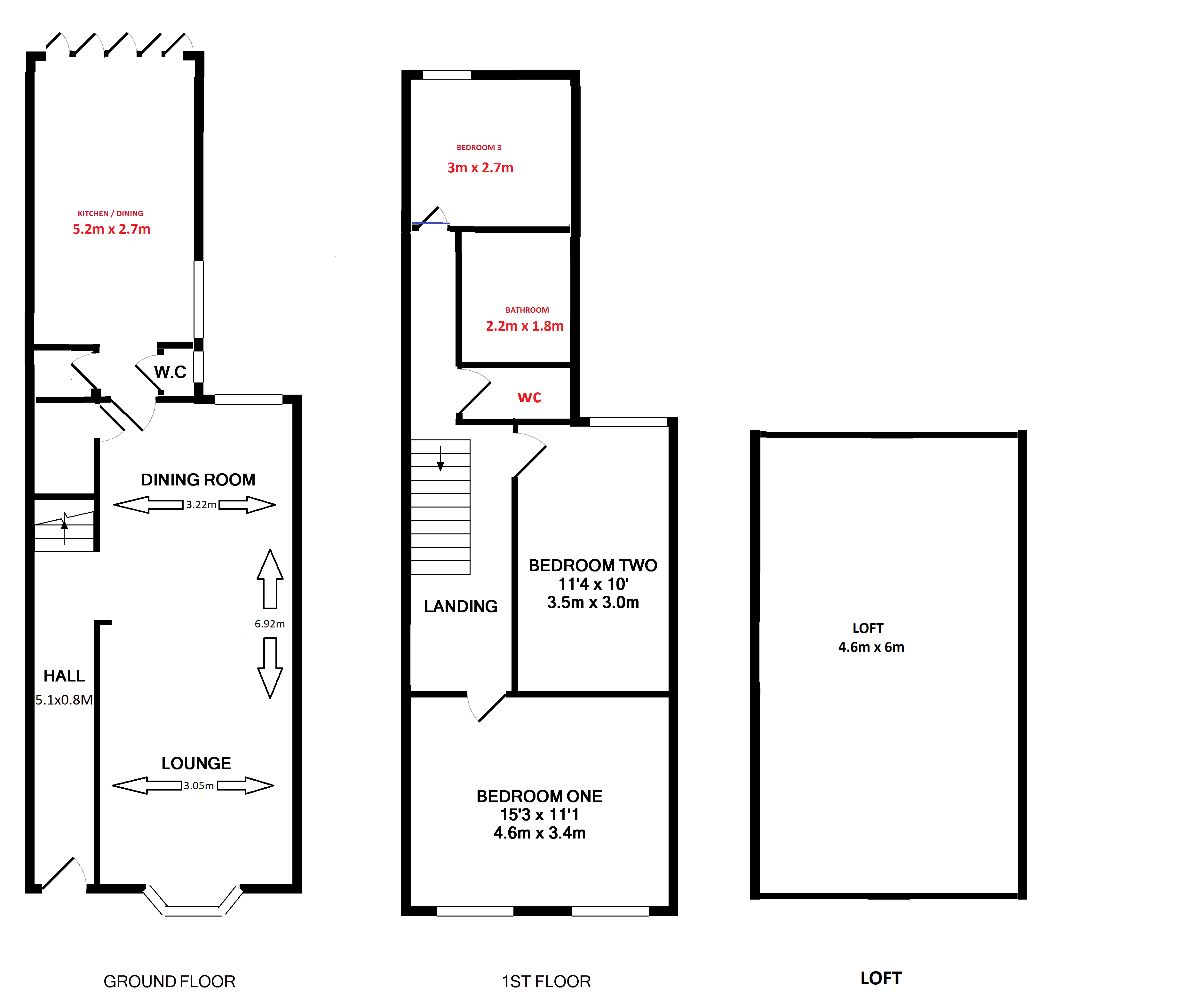

Hello everyone, I'm Alex, I moved in to my victorian mid terrace 7 years ago and I have been gradually been refurbishing it over the years and now I'm at the last stage doing the kitchen up. Most of the work has been done by myself apart from the plastering, which I have tried but it's not for me :)
I'm looking to get a MHVR unit into the loft and use a radial ducting system throughout the house. This forum has helped a lot, I've been reading loads of topics but I still have a couple of questions that I don't have ansers to.
I had a couple of quotes in for the unit but I'm leaning towards the Domus HRXE (possibly the HRXE-H), I can really afford to spend more than 1000 pounds for the unit and this would be under budget. If someone has a better idea, I am listening.
https://www.domusventilation.co.uk/ventilation-solutions/fan-range/mechanical-ventilation-heat-recovery-mvhr/hrxe
I have looked at several units to see the fan settings/speeds/flow rate so I can choose wisely but I don't really understand how to read these charts. I calculated that I need a minimum extract of 52.5m3/h (48m3*0.3*3.6).
Would this be enough for setting 3, 13.5l/s extract?
Does the volume flow rate reffers to only extract or both supply and extract combined?
What are the Pascals all about? :)
Floor area = 90sqm total of which ground floor is 44sqm and first floor 46sqm
Extract volume = 48.64m3 (kitchen/bathroom/toilet/under stairs cupboard)
Supply volume = 125.72m2 (living+3bedrooms)
When it comes to the ductwork, I'm been told that a rigid system is better, but the semirigid works as well.
Currently looking at the Airflow Pro semi rigid system. What do you guys this, is this ok?
My wife has only one requirement, that the system is quiet.
My understanding is that once you increase the air velocity above 2.5m/s that's when it starts to get noisy.
I was looking at the charts for the 75mm duct https://www.ribaproductselector.com/Docs/9/00139/external/COL285316.pdf on page 4 and it shows that 2.5m/s air velocity it can carry 28m3/h at 2.2Pa/m resistance. The longest pipe lenght that I need to fit is 9m.
The extract for the kitchen needs flow rate of 28m3/h based on the volume of the room and I'm a bit worried, would I need to run 2 ducts to the kitchen?
Does anyone know what is the maximum lenght of pipe that I can fit before I get into trouble?
Enough question for now.
I've attached my floor plan.
Any help is much appreciated!
This is a DIY project, the same as the rest of the house :)

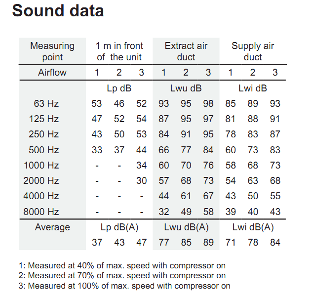

Might be worth checking to make sure that the MVHR is actually OK and to spec as far as noise goes.  I remember reading somewhere (may have been on Ebuild years ago) of someone that had a problem with noise from an MVHR that was due to a faulty fan, or maybe fan bearing.  Noise from something like that might well be worse when the unit's running at a higher fan speed, so that may be something to check.
Although the manufacturers can be a bit creative when it comes to things like sound levels, our Genvex is at the noisy end of the spectrum for these things, as this excerpt from the manual shows:
The key figures here are the ones that cannot easily be silenced, the left column that gives the sound level 1m in front of the unit.  The duct noise is really neither here nor there, as the silencers will remove most of that.  Even with silencers and additional insulation I would still very definitely not want to have a unit like this in a loft space above a bedroom!
As a guide, you don't want anything louder than about 30dB(A) in a noise-sensitive location.  If the choice of location is limited, then it's best to choose the quietest model you can find, rather than rely on trying to reduce the noise by additional insulation, etc, although the downside of that is that it may cost more.
