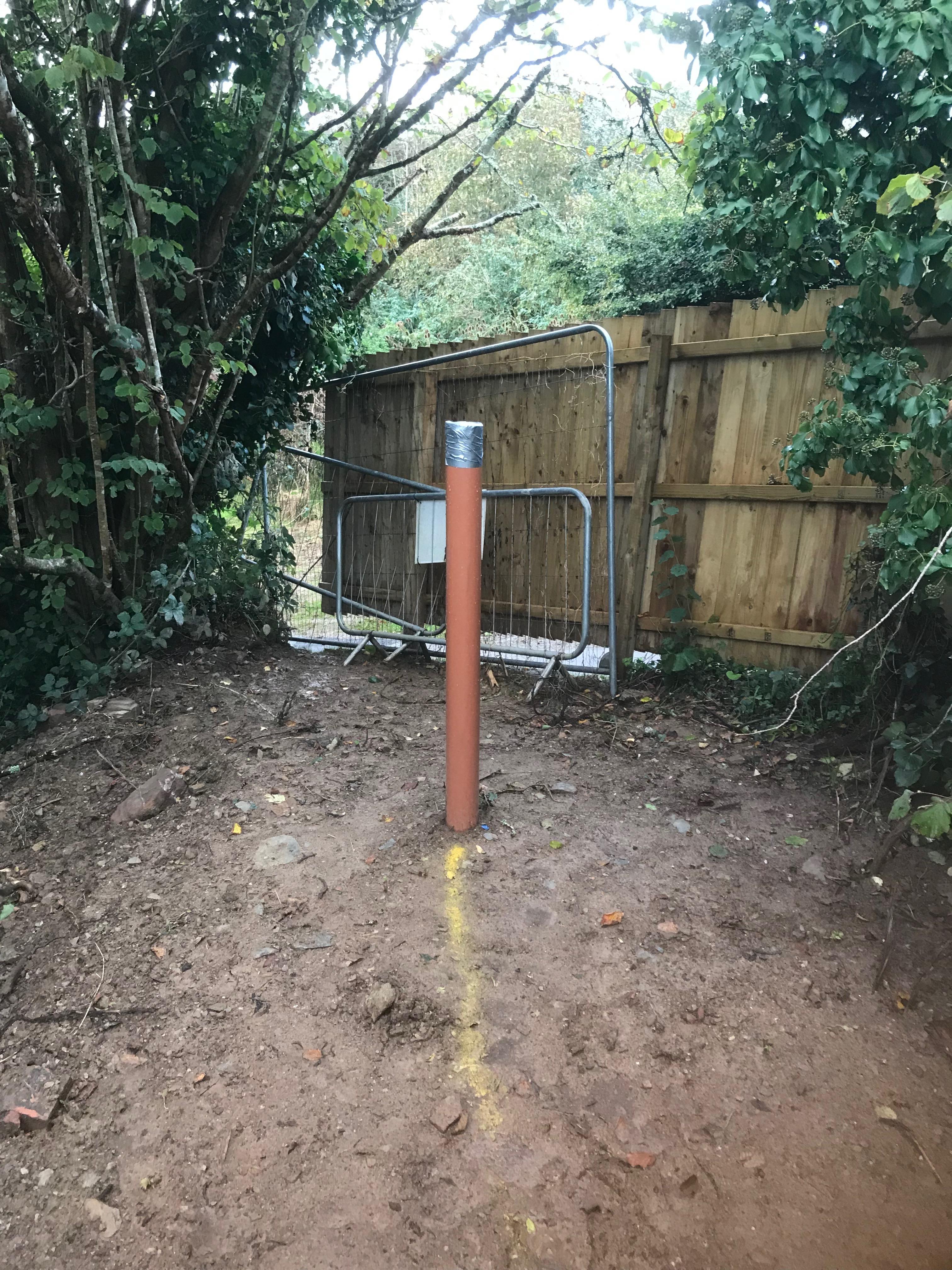

redtop Posted October 19, 2019 Share Posted October 19, 2019 so, getting a portloo on site will be a pain, getting it emptied will be impossible. but I have a mains sewer connection, terminating in the pipe shown below and I have water. So thinking I can cut pipe down, fit toilet on top and put up a toilet tent. Pipe isn't blocked where it goes into sewer. so question is, whtas the easiest way to connect from a garden hose to a toilet? obviously cheap and easy the way to go Link to comment Share on other sites More sharing options...

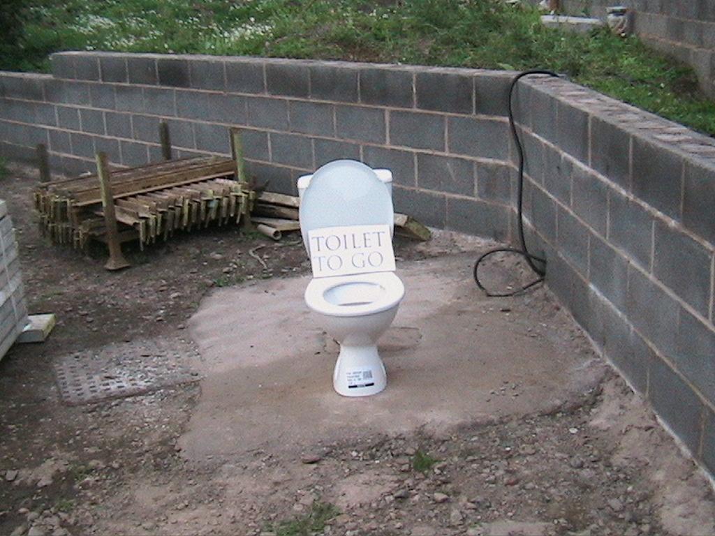

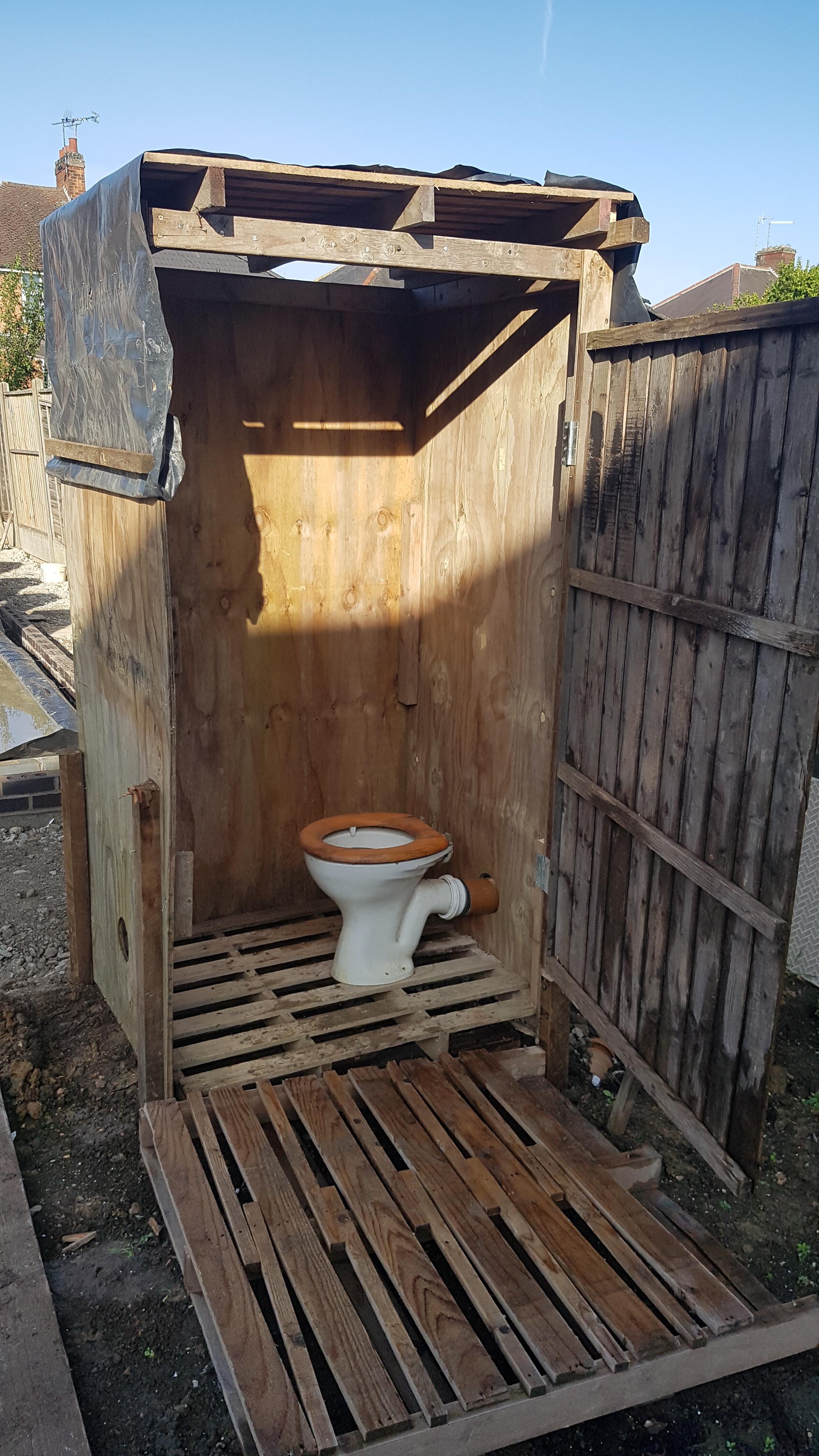

Onoff Posted October 19, 2019 Share Posted October 19, 2019 I'd cast a little base and job done. Build a Tardis sized enclosure from pallets etc. (Turdis?). You can go from garden hose to 15mm copper temporarily with a hot air gun to soften the hose and jubilee clip to feed your cistern, basin etc. @newhome has a great picture from memory of a wc sitting in the middle of her floor slab after the temporary enclosure was removed. 1 Link to comment Share on other sites More sharing options...

Russell griffiths Posted October 19, 2019 Share Posted October 19, 2019 Why connection from a garden hose ? if you have water on site, cut into it stick a bit of 20mm mdpe with an adapter to a push fit tap connector and connect to toilet. Find a free shed on face book and put a shed up with toilet, hand basin. Link to comment Share on other sites More sharing options...
redtop Posted October 19, 2019 Author Share Posted October 19, 2019 4 minutes ago, Onoff said: I'd cast a little base and job done. Build a Tardis sized enclosure from pallets etc. (Turdis?). You can go from garden hose to 15mm copper temporarily with a hot air gun to soften the hose and jubilee clip to feed your cistern, basin etc. @newhome has a great picture from memory of a wc sitting in the middle of her floor slab after the temporary enclosure was removed. yep, its the garden hose to the pipe bit I couldn't work out, end up spending more on fittings than I will on the toilet if not carefull Link to comment Share on other sites More sharing options...
Russell griffiths Posted October 19, 2019 Share Posted October 19, 2019 1 minute ago, Oz07 said: man after my own heart Nice bit of ventilation ?? Link to comment Share on other sites More sharing options...
redtop Posted October 19, 2019 Author Share Posted October 19, 2019 Just now, Russell griffiths said: Why connection from a garden hose ? if you have water on site, cut into it stick a bit of 20mm mdpe with an adapter to a push fit tap connector and connect to toilet. Find a free shed on face book and put a shed up with toilet, hand basin. only because the water is 50M away and is 32mm MDPE into a 3/4" tap already fitted to a post; be a right pain to strip it down, add in a connector, etc; all all of the temp bits to be thrown away when done. Garden hose will be re-used Link to comment Share on other sites More sharing options...
Onoff Posted October 19, 2019 Share Posted October 19, 2019 If you want to get technical there is a hose to Speedfit type connector: https://www.travisperkins.co.uk/push-fit-fittings/jg-speedfit-hose-connector-15mm-x-12inch/p/853987 Honestly I've used the copper pipe/jubilee trick on loads of repairs to extend 1/2" garden hoses. You can also dip the hose in boiling water to soften it. I'd say freezing up might be your biggest problem? Link to comment Share on other sites More sharing options...

newhome Posted October 19, 2019 Share Posted October 19, 2019 1 hour ago, Onoff said: @newhome has a great picture from memory of a wc sitting in the middle of her floor slab after the temporary enclosure was removed. Not on the floor slab, this is where the parking area now is, and before the enclosure was put up. The enclosure eventually blew down (not with someone on the bog thankfully!). Worked well during the time we needed it. Link to comment Share on other sites More sharing options...

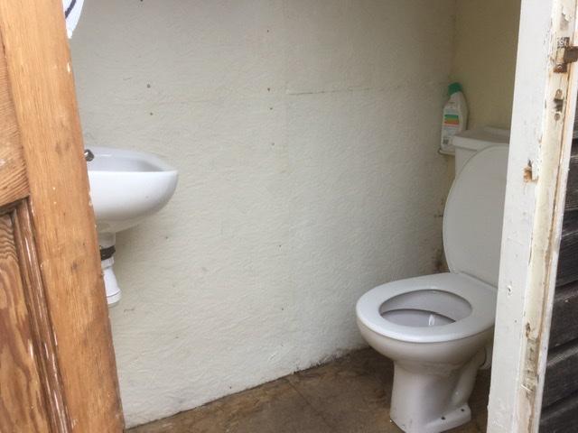

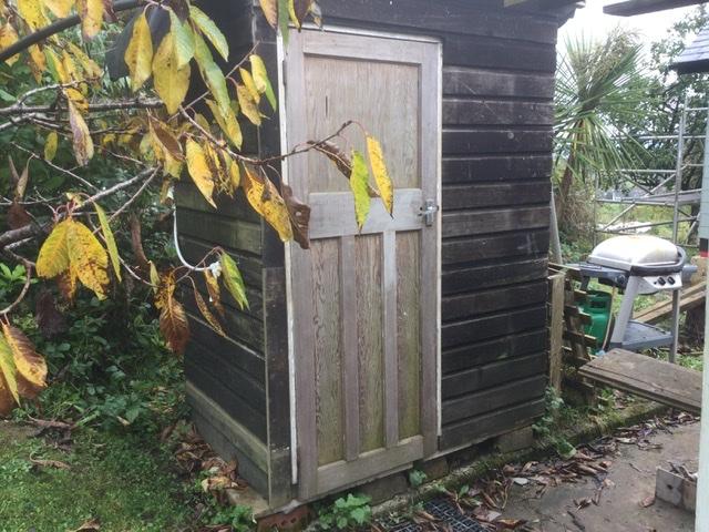

Triassic Posted October 19, 2019 Share Posted October 19, 2019 (edited) Here’s my site loo, it’s made of recycled timber, loo and sink. It’s connected to the septic tank. It regularly gets praised by its users as one of the best they’ve used. Edited October 19, 2019 by Triassic 1 Link to comment Share on other sites More sharing options...
ProDave Posted October 19, 2019 Share Posted October 19, 2019 ^^ That reminds me of our first trip to Oz. We had a meal in a remote restaurant that was little more than a shed, with the dining area on a veranda. The toilet was in a shed at the end of the garden and looked very much like that. SWMBO refused to use it, there had been an advert about that time on UK tv depicting such a facility down under with a .spider hiding under the loo seat. It never ceases to amaze me a woman's ability to "hold on" Link to comment Share on other sites More sharing options...

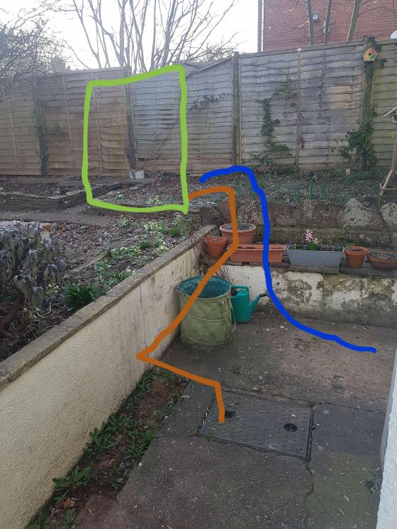

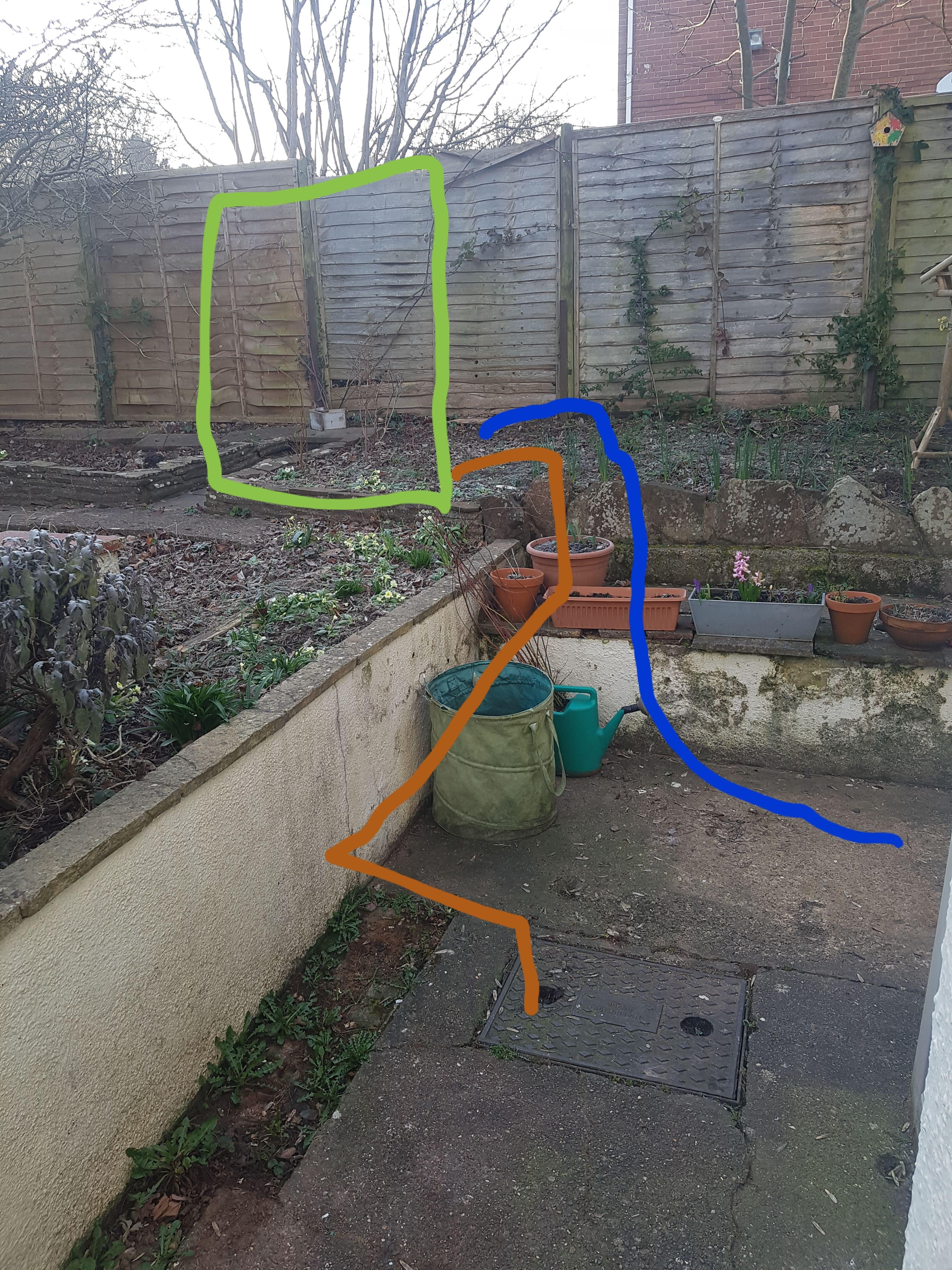

Moonshine Posted March 9, 2021 Share Posted March 9, 2021 (edited) Bringing this thread back from the dead, as i need to sort mine out. I am looking to buy (ideally second hand) a mains connected loo, one of these types. https://www.toiletsforsale.com/product/mains-connected-portable-toilet/ I can supply cold water via a tap and the mentioned speedfit nozzle hose connector, but what to do about the waste? Below is a picture of how i can set it up, and i think that i need to butcher a inspection cover to put a 110 diameter pipe through it and bend to go with the flow down to the drain. I can seal the hole around the drain pipe entrance to the inspection cover, thoughts Edited March 9, 2021 by Moonshine Link to comment Share on other sites More sharing options...
markc Posted March 9, 2021 Share Posted March 9, 2021 1 minute ago, Moonshine said: Bringing this thread back from the dead, as i need to sort mine out. I am looking to buy (ideally second hand) a mains connected loo, one of these types. https://www.toiletsforsale.com/product/mains-connected-portable-toilet/ I can supply cold water via a tap and the mentioned speedfit nozzle hose connector, but what to do about the waste? Below is a picture of how i can set it up, and i think that i need to butcher a inspection cover to put a 110 diameter pipe through it and bend to go with the flow down to the drain. I can seal the hole around the drain pipe entrance to the inspection cover, thoughts If you are installing the inspection chamber, add in an extra branch (can be capped later) for the temp toilet. If the chamber is already there and unlikely to need an inspection then a temporary cover will be ok. Link to comment Share on other sites More sharing options...
Moonshine Posted March 9, 2021 Share Posted March 9, 2021 2 minutes ago, markc said: If you are installing the inspection chamber, add in an extra branch (can be capped later) for the temp toilet. If the chamber is already there and unlikely to need an inspection then a temporary cover will be ok. Its to an existing drain (image now added) Link to comment Share on other sites More sharing options...
markc Posted March 9, 2021 Share Posted March 9, 2021 Ah, yes i see now. Temporary cover will be fine, just make sure its strong enough and restrained from shifting when knocked Link to comment Share on other sites More sharing options...

Moonshine Posted March 9, 2021 Share Posted March 9, 2021 27 minutes ago, James94 said: Why spend all that money on a toilet, just a cheap shed and toilet from B&Q or similar place. Resale value will likely be pretty good, and probably will have a net cost of ~£300 for the life of the project. Cheaper / easier than a knocked up shed and sanitary products 54 minutes ago, markc said: Temporary cover will be fine, just make sure its strong enough and restrained from shifting when knocked Going to strap it to that wall at a fall, then 90 degrees to the inspection over. Link to comment Share on other sites More sharing options...
