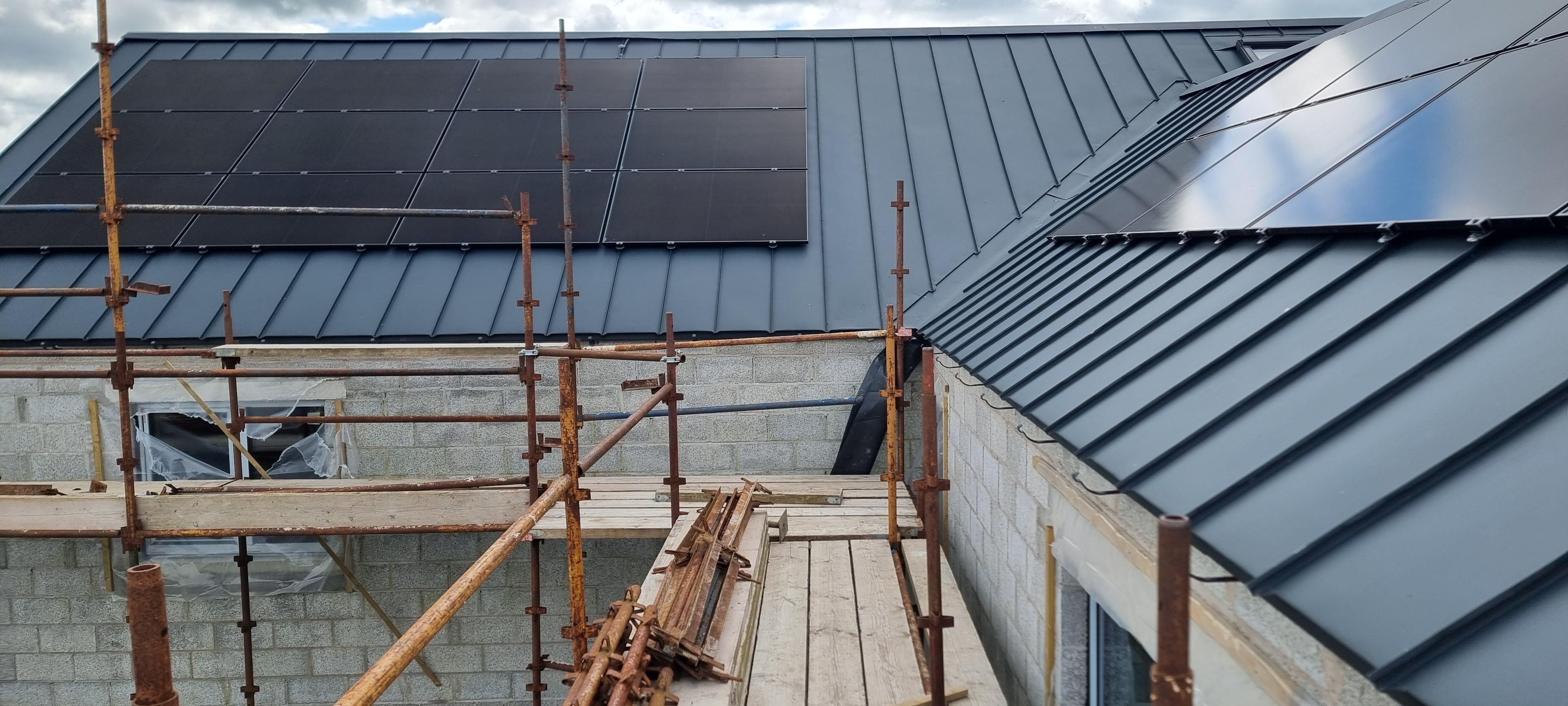

I take it all back. It took three blokes three and a half days to put the panels on the roof and connect them up and I love them. (cables run to ground floor no isolator) They will come back to install the inverter that I will supply (install price included) so not a bad deal at all considering some of the outrageous profiteering from a many solar installers. The fitters took their time to line everything up and cable tie all the cables off the roof. I know some people just hate the look of panels but I actually quite like them and should have maybe put some on the front SW elevation instead of keeping them hidden at the back of the house. My builder hates the sight of them. Yes I did powdercoat the clamp disks to match the roof colour 🙄
