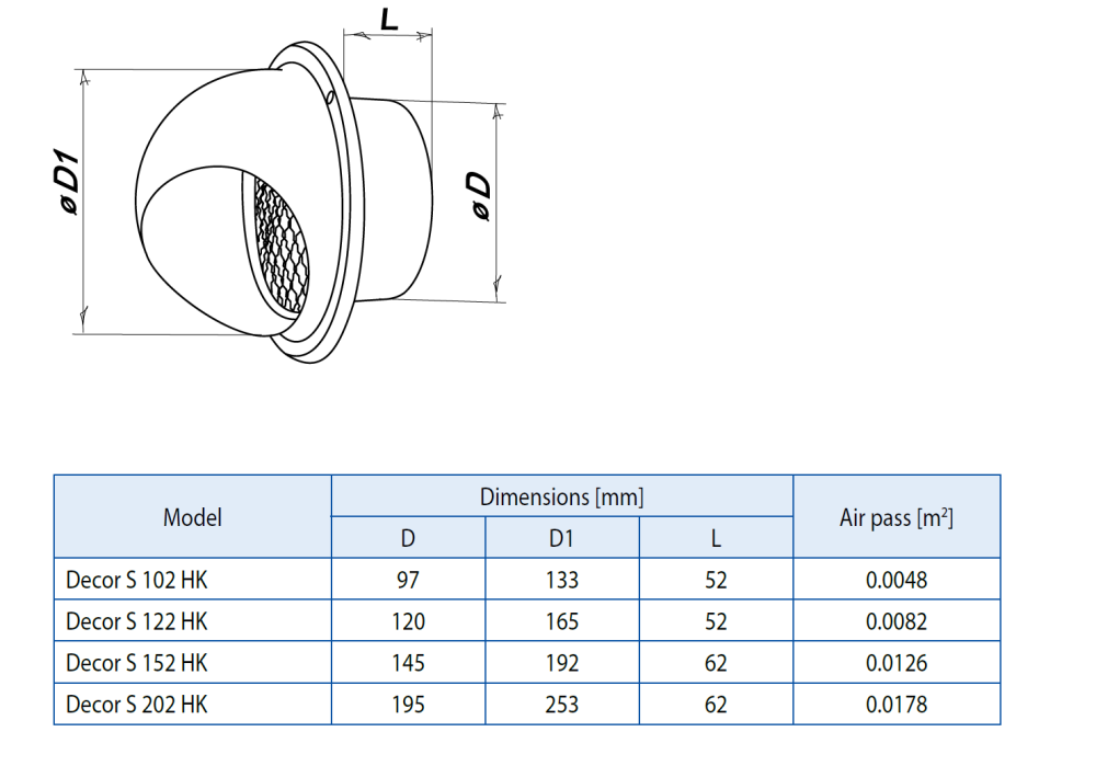

This seems like a good idea. What pipe and vent did you use through the wall? My concern is that the 200mm comfopipe has a 280 outside diameter. Thats seems like a very big hole through a block wall. I'm looking at a 200mm blauberg plastic pipe to a 200mm blauberg vent as an alternative like this: The 200mm comfopipe should slide over the blauperg pipe ok I think and then it looks like the external cowl from the same manufactruer will slide into the rigid pipe ok. As well as looking easier to install through a smaller hole in the wall the bull nose cowls are a third of the price of the zhender grills. I suppose my unknowns are: 1. Would it be structurally ok to have a 280 mm hole in a block wall for the Zhender 280 insulated pipe to go to the outside? (I can get a firm to core drill it thanks to @Conor's advice elsewhere, I hust dont want the wall to collapse π¬) 2. Do I need insulated pipe through the cavity? The cavity is insulated anyway. -

This is what I would like to use, but, AFAICS, BPC don't sell either the Comfopipe or Ubbink, just the hard plastic duct and then the insulation to go round it. Which is much cheaper but looks a bit crapper. I can see my builder rolling his eyes, again, when I tell him I want to do something different π My next stupid question is what is the best way to terminate the foam duct at the vent in the cavity wall? Does the foam pipe go throught the cavity to the vent? Or alternatively, run a peice of 180mm thin plastic duct through the cavity wall and join the foam duct to that? -
