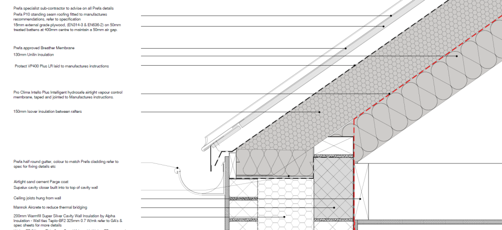

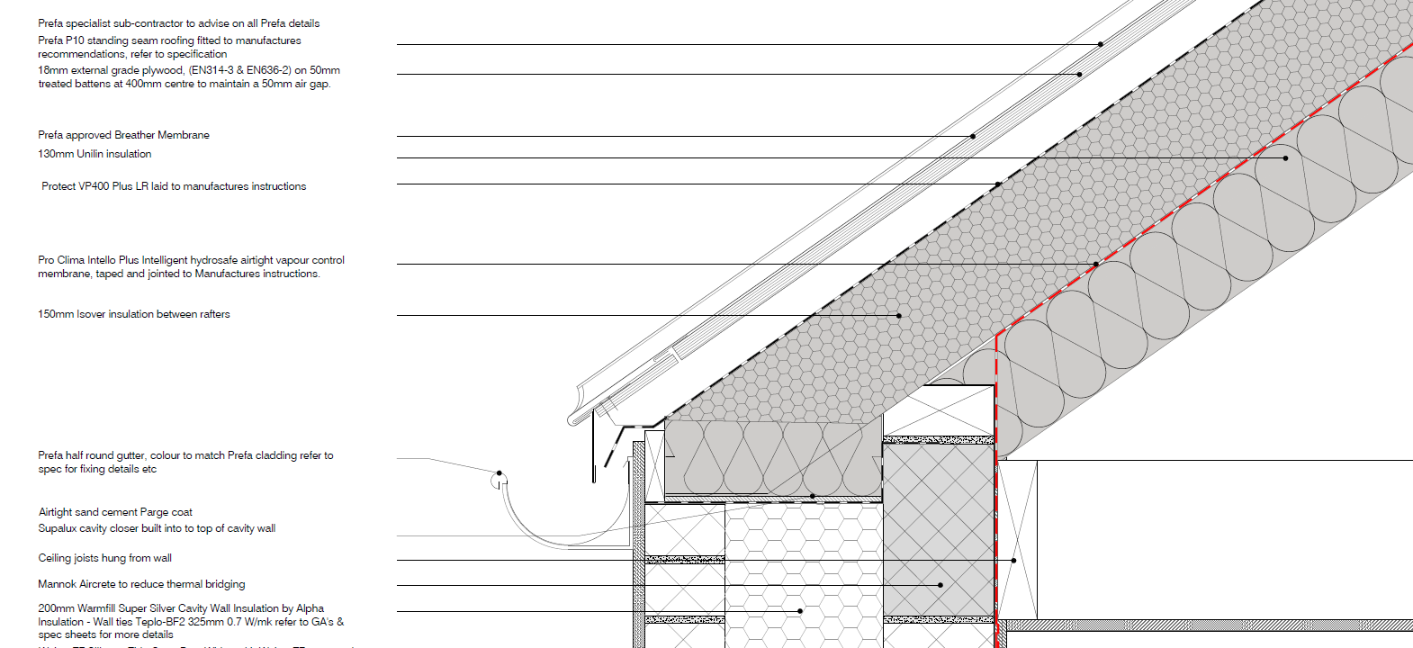

  8. This has become a bit of a hot topic this week between myself, builder and architect. The architect recommends the cavity closer to be supalux board but at a U value of 0.17 W/m K is not great as it will bridge the cavity. Supalux does however carry an 'A' fire rating. The alternative, bosig phontherm has a much lower u value at 0.08 and is marketed as a cavity closer. https://www.ecologicalbuildingsystems.com/product/phonotherm-200#technical-details ... but phontherm is, AFAICS, not fire rated. The builder would usually push some PIR into the cavity with a block return. Great u-values but hardly fire-rated. (and how would this be plastered over) I guess this is, in part, a building regs question around fire-rating of cavity closers. Do build regulations allow the use phontherm board / PIR to close the cavities?
