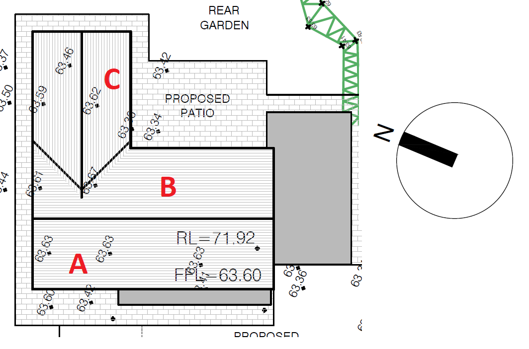

  2. I'm currently trying to allocate space for all the electrics and other plant and need some reassurance and guidance. Its a block cavity passive house on insulated slab and warm roof. ASHP, UFH, active cooling with fan coils and 8kW pv. Plans are like this: ... with plant originally planned to be housed in 2 plant rooms (each about 3m by 1.2m) like this: Room A: ASHP outside, UVC and buffer tank. Room B: MVHR and patch panel/hub etc. ( part to be split into towel store at some point) I had originally anticipated the meter tails would also enter room A and the consumer unit would be in that room, with the inverter outside. However, the scope has expanded to a hybrid inverter with battery so it can't really go outside any more. I explained to my M and A consultants that I would prefer to keep the heat generated by the invertor outside the thermal envlope (something they had never heard of before) and so their proposed solution is to run meter tails through a conduit from meter box M under the insulated slab to position C in the garage, where the the inverter and battery and consumer unit would be installed. While this seemed like a good idea at the time, I am concerned that (i) the garage, being well insulated and more airtight than most commercial houses (and not ventilated by the MVHR) may overheat anyway, and, (ii) having the CU in the garage (which is outside the airtight envelope) may invite trades to penetrate into the garage to access the CU leaving various cable runs through holes in my otherwise airtight plaster. So, having paced up and down scratching my head since yesterday, what do you all think? 1. Is the CU in the garage a bad idea for airtightness, or am I overthinking this? 2. Where should I put the inverter / battery / CU? 3. Running conduit under the slab for meter tails from M to C seems terribly overengineered when I could run the tails into room A, is it over-complicated? 4. Similarly, the M and E proposal to run openreach fibre from P1 to P2 in conduit under the slab goes against my principles of keeping things simple. Why not go through the wall into the ceiling void? 5. Should I move the MVHR into the warm roof and the CU/inverter/battery into room B? 6. Maybe bring the meter tails into room A and the CU in the boot room next door? With fan coils planned to go in loft above room B for cooling, then maybe that is the right place to avoid invertor overheating ... ? So, where should I put all this stuff? Should I stick with my M and E advice and leave as is? All comments welcome. I need all the help I can get.?

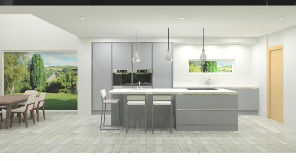

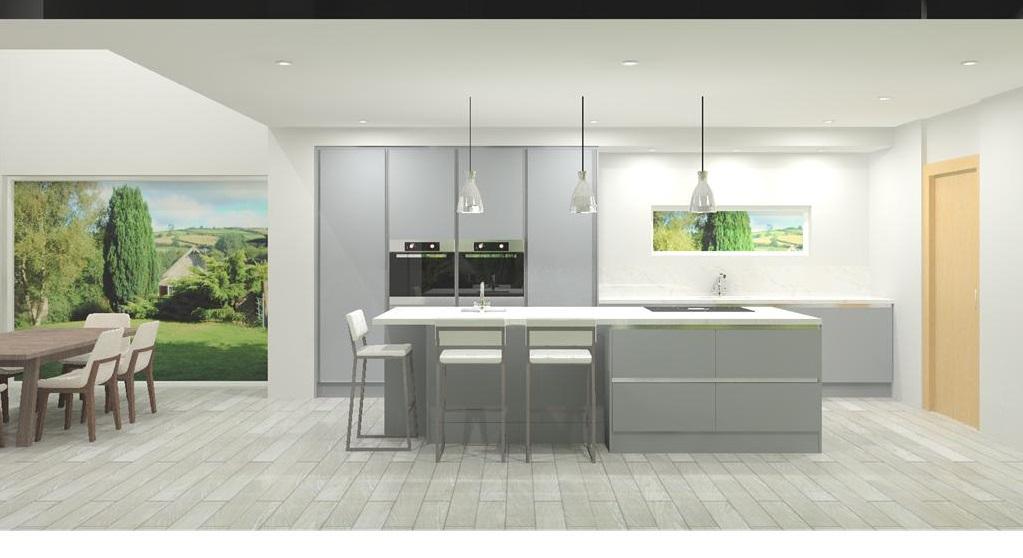

  5. Thank you for the image. That's the sort of overhang I want. So looks like we'll be getting a quartz worktop. The ceramics like Dekton just aren't strong enough for more than 25 cm overhang, and the cutout for the prep sink makes it even worse.
  6. Speaking to two kitchen designers for our new build and its a nightmare. This is still a work in progress, but Designer A has provided the following design, with the unsupported corner. Sorry about the crap resolution. Worktop is quartz. Designer B, a German kitchen designer whose components we actually quite like, is very keen to remove the prep sink and move the hob into the centre of the island. He was very keen to persuade us that sinks on islands are always a bad idea because they always splash and require mopping up. Wife was symapthetic as she's never been overly keen on the prep sink but I detected a whiff of bullshit. On reflection I suspect the real motive here is maximum profit for least effort by designing a rectangular island under a dekton worktop with unsupported 20cm overhang on two sides. The more I think about a 20cm unsupported Dekton overhang the less keen I am, but would be very grateful for any comments and answers to the following in case I am being overly cautious. 1. I still think the prep sink on island makes sense, with Quoker tap because its at the tea end away from the work end. I am mindful of course of costs and impact on services required under insulated slab. Those that have both prep sink with boiling tap and hob on island, would you do it again? Any downsides? Is the prep sink a good idea or should I cave in and resort to a single sink? 2. Am I right to be concerned that a 20 cm overhang is not big enough to sit comfortably on stool with knees under? 3. Does Dekton chip at the edge as comments in other threads suggest and if so then should I go for quartz instead? 4. Does quartz have better strength for (depending on thickness I guess) unsupported corner overhangs? Is a 35cm unsupported corner overhang on a quartz worktop a good idea, or is it likely to break? 5. Would it be better to replace the corner overhang with a supporting carcass and instad have three stools in a line under a deeper overhang (facing the ovens in the image above) that is then supported at both ends? Intuitively this would be stronger. 6. Is Silestone another brand of Quartz? 7. What is generally the cost difference between Dekton and Quartz? Any other comments on our kitchen design most welcome!
