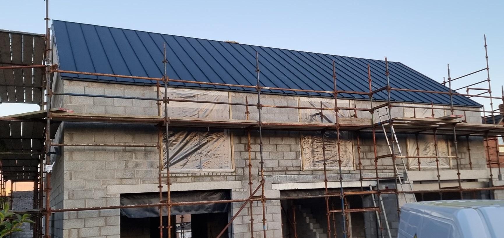

My aluminium statnding seam roof is currently being installed. It looks great from a distance. Up close however every seam is scratched at the crimping point. The crimping tool is bare metal with no rubber edges to protect the roof. The metal roof installers are not on site today hence I've not had a chance to discuss this with them yet. Is this acceptable?

Our roof buildup is like this: ... which is from the good practice guide for metal roofiing (FTMRC). The standing seam company have understandably requested same buildup from our roofers. Instead of using ply on top of the battens we are usaing timber sarking board, but this came from the metal roofers as they think it is a better option than ply. The sarkng looks great, almost a shame to cover it up. Like this: I have been told that the membrane that will go between the sarking and the standing seam will be waterproof. Not just a debonding layer. I hope so because right now storm Debi is pulling those un-taped laps away from the nail holes π«

The sarking is required for the standing seam. Good point. Yes it would make absolute sense. Why didn't I (or my roofers) think of that? I guess its because most roofs are tiled and so this is how they always lay the membrane.

The standing seam installer said that ply is ok, and he would get membrane on site to cover the ply immediately to protect it from any rain before the standing seam is installed on top. That would rely of course on my roofers working in dry weather and covering as they go. The standing seam supplier did say, however, that if it was his roof then he would use sarking board. Thank you all for your comments. Very helpful and reassuing. Timber sarking board is now ordered π
Today's decision is whether to use traditional sarking board or ply under the standing seam. Buildup is : standing seam - membrane - ply/sarking - battened ventilation gap - membrane - rafters - insulation. 35 degree pitch. Sarking board will be timber with 3mm gap between. Laid horizontally on vertical batten. Builder tells me the real timber sarking will last longer than ply. Cost is about the same. I guess its easier to leave the sarking up in the rain during the build without damage so cynic inside me suspects this is guiding builder's recomendation. Timber sarking or ply? Which one's best?
