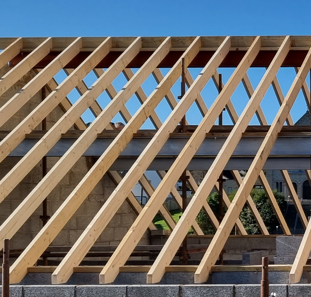

  17. To reserrect this old thread, we are going to use 150mm isover metac glass wool to full fill between rafters and up to the breather membrane. (Metac seems about twice the price of knauf frametherm which looks like the same product so may need to review this 🤔) The plan is for the glass mineral wool to be pushed all the way down to close the cavity and then for the blown beads to go up to meet the mineral wool. Here's a pic from earlier today: Wall plate to be attached to top of outer leaf. 250 cavity. So the roofers have asked if the insulatoin is suitable to close the cavity and also suggested to close the cavity before the breather membrane is installed on top of rafters. Which seems like sensible advice. So, just to reassure me here, is it ok to close the cavity with between-rafter glass mineral wool? It seems sensible enough to me. Do I need to do anything else? To close the cavity I assume I can just squeeze the Metac/frametherm between the rafters without any need to cut it (to accomodate the bump at the inner leaf wall plate) or anything. Am I missing something? I welcome any advice here from those who actually know what they're doing.😬
