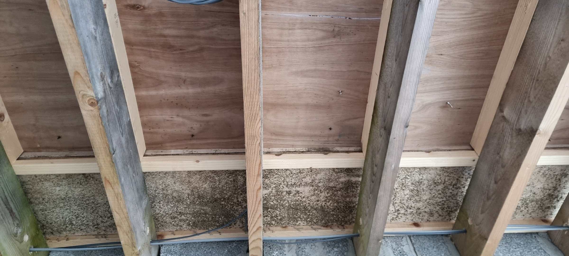

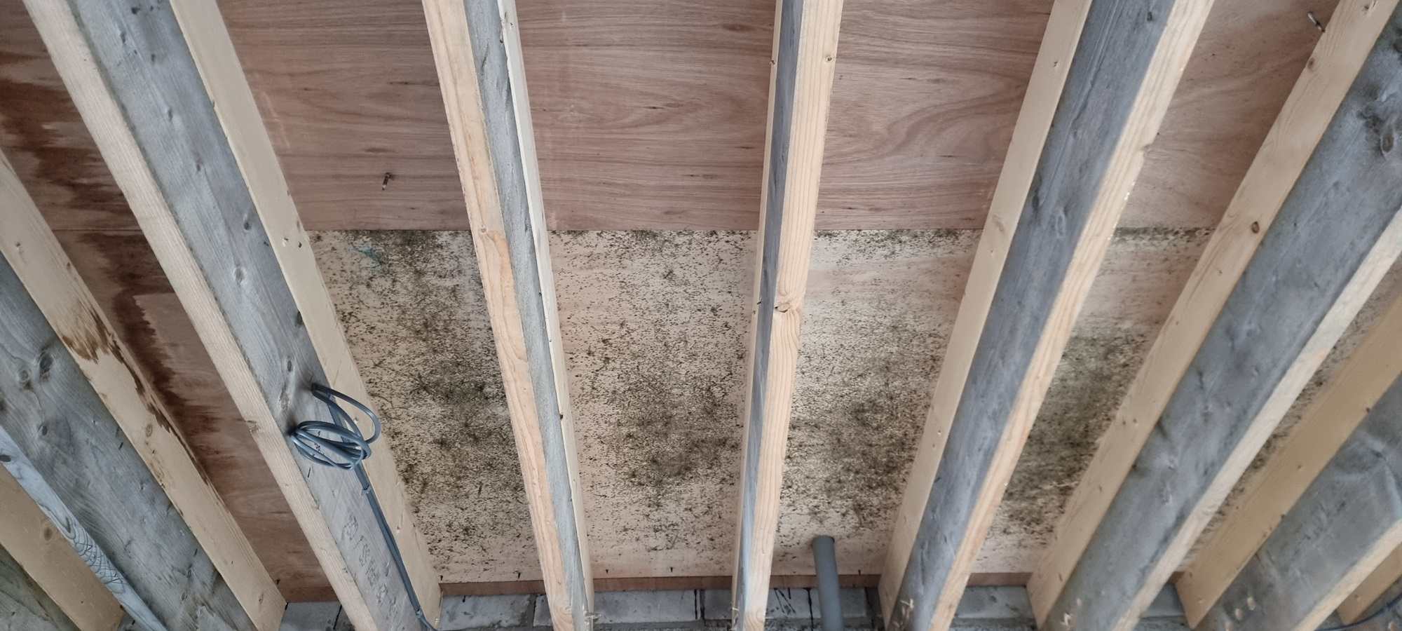

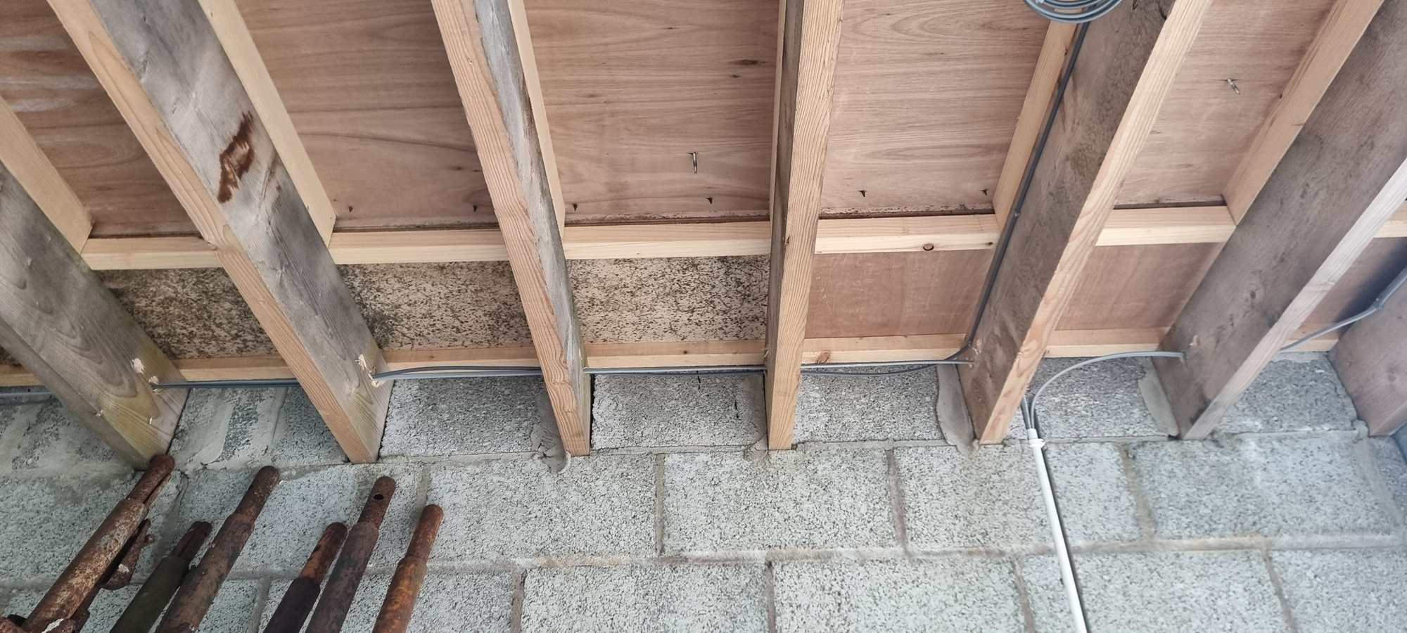

.. but there is no mould on the treated grade 3 ply. Only the cheap substitute sheets. Which are not to the listed spec. I just find it intensely frustrating when trades substitute specified materials for cheaper alternatives to make a few quid at my expense.
Phantom braking, insurance : Agree with both of these, although I don't do long long motorway drives very often so the phantom braking is not a big deal for me. The rest are all things I like. I like the app-service-system, and the suspension feels just right, and I like no-buttons. I hired a Mercedes eq recently and hated the sea of buttons. I'm on my second model 3 and very happy. Although with Musk turning to the dark side this may be my last.
I've just done some basic maths from the builder's invoice for the ply and there is no way that he ordered enough Grade-3 ply to cover the whole roof. I am quite certain that there has been, for whatever reason, a bit of substition here. 🙄
Yes it is. I should add some context here. The builder ordered the ply and subbied the roofers. My guess is that the builder, as usual, ordered the absolute minimum amount of ply to try and maximise profit. I suspect he didn't order enough so the roofers ran out of material and, to get the job finished on the same day, got a couple of extra sheets from the local builders merchant. Which is less than a mile away. The pictures show just a small section. Only about 10-15% of the sheets look different. Oops, I just noticed the two pictures in my original post are actually the same affected area, so here is the other affected area on the other side of the garage. The mouldy sheets are much lighter in colour (where they are not mouldy!) Is this a big deal? The roof is watertight and so replacing the ply is not easy.
Another day another issue on site. So on our garage flat roof drawings WBP ply is specifed. I checked with the builder and, sure enough, the invoice lists "MALAYSIAN 8 x 4 x 18mm Complies with EN13986 EN636-3 Structural use" Which I think is ok and meets the WBP spec, right? So far so good. However.... Not all sheets are the same colour. Some are lighter in colour and are affected by mould, where the darker sheets appear mould resistant. Some questions: 1. Am I right to suspect that the mopuldy sheets are not the same as the other sheets and not to the required specification? 2. If the answer to (1) is yes, then apart from being really annoying, how bad is this? 3. If this is a problem, then what should I do about it?
