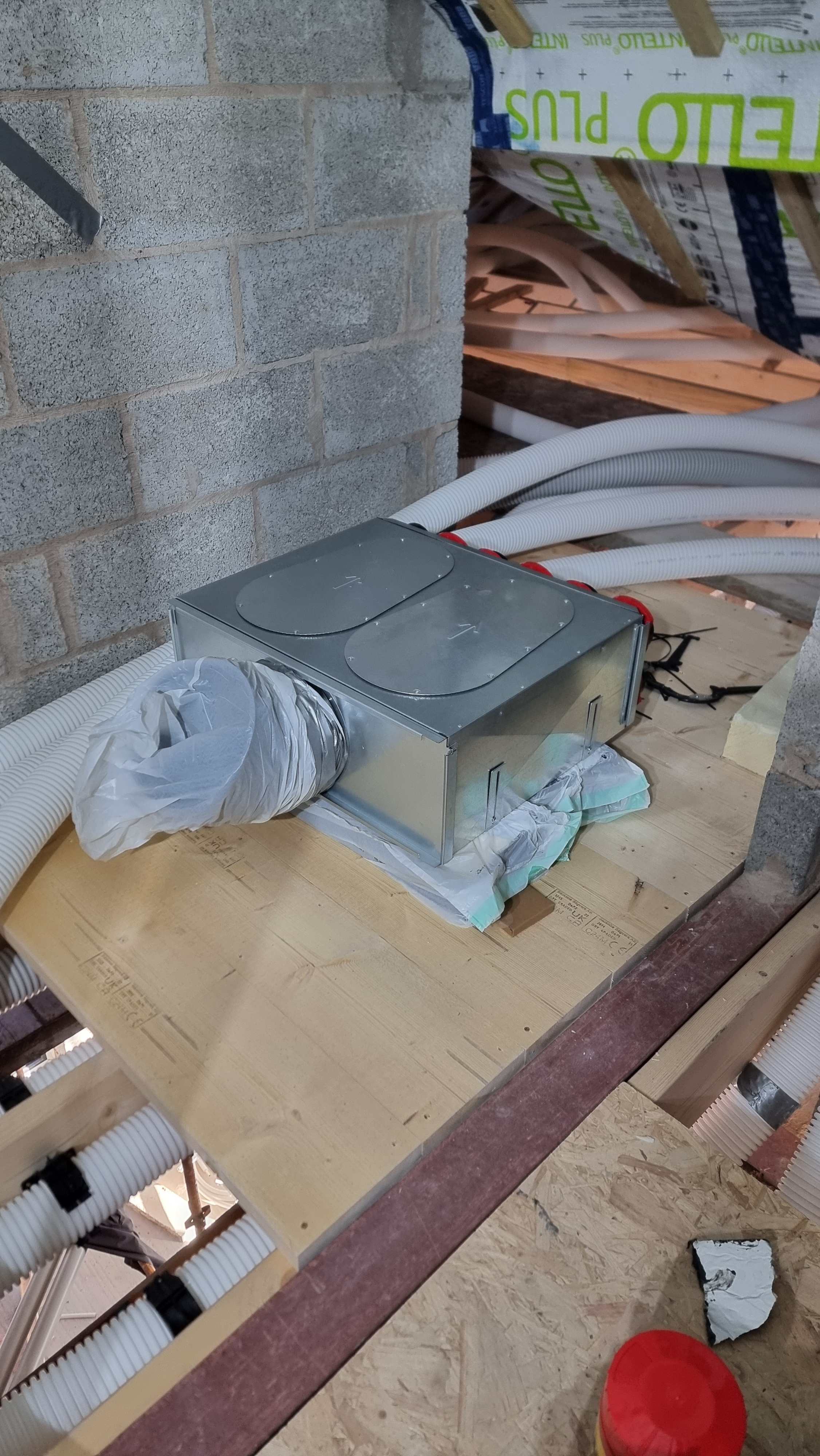

Why are you running a branched ductwork? Far better and easier to install with zhender manifolds with attenuators on top of the zhender unit and then 90mm semi rigid ducting to each of the rooms. And probably less noise transmission between rooms (hence all the silencers in the ducts on your plans) Is your loft space warm and inside the airtight envelope? If not then do not even think about putting the unit in the loft space, too much hassle insulating ductwork and sealing penetrations. -

I have read that dips in ducts can gather condensation. Is this only an issue for exhaust ducts carrying moist air? To explain, we are running ductwork along the eaves in the warm loft but then changing direction 90 degress to run parallel to the ceiling joists to the MVHR manifold. At some time in the future we would like to board the centre of the loft hence we would need to dip the ductwork into the void in the ceiling joists and then bring back up into the loft space the other side of the roof. Hence the dip in the duct under under the boarded area. We only need to do this for two supply ducts so hopefully no condensation and no issue. Also, is it ok to run the ducts on top of 400 centre joists or board the loft at the eaves first? Or am I overthinking it?
