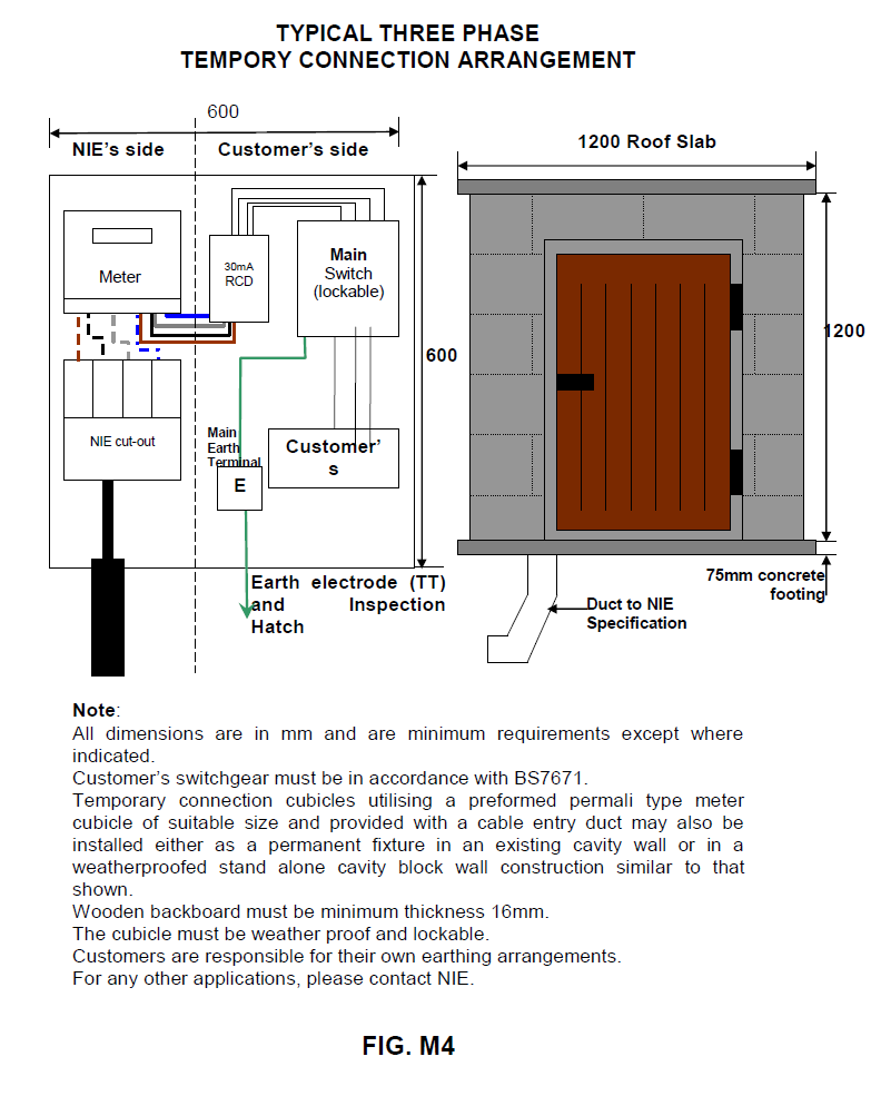

  3. NIE have told me that the temporary connection is disconnected after 12 months. It is possible to request an extension if the build is not complete but NIE will at some point disconnect the temporary supply and insist on a meter cabinet on the wall. Which is crap because as I see it there would be three conduits running down the wall from the meter box to the ground, (i) supply in, (ii) conduit running under house to internal CU, and (iii) conduit out to EV charger at front of house (near to where the kiosk would otherwise have been) I've asked NIE on twitter messaging to explain why they prohibit meter kiosks that are allowed in GB. It will be interesting to see if they come back with a reason.
  4. I had hoped to do the same. Three phase supply into big kiosk aout 15 metres from house. From kiosk run 3 phases to EV charger close to kiosk and another 3 phases into house. Well that's what I had hoped to do until talking to NIE today. NIE have told me that they only connect temporary supplies to a kiosk. They do not allow a permanent supply to a kiosk, only to a metre box on the wall of the house. Which means running more cable from the house back out the route of the suply to the EV charger. What a pile of crap that is. Has anyone in Northern Ireland got round this restriction and installed a permanent meter in a kiosk away from the house? I assume not.
  5. Tesla and Renault Zoe have 3-phase chargers on board. Modern Tesla's are 16 amp 3-phase so 11kW. Nearly all public AC charge-points here in Northern Ireland (by ESB) are 3-phase. I'm assuming the OP drives a Tesla 🤔 We're planning a similar setup with a 3-phase charge-point near to a 3-phase meter kiosk, so this thread most informative!
