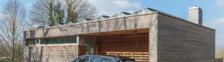

The building has a flat roof, so they were trying to hide the array behind the parapet. For the calculations I did to get to a 30kW system, however, I used PVGIS and an optimally-orientated ground mount array to work out how much PV was needed for 600kWh in December near Aberdeen. That was for year-round optimisation to be fair - if I give it a near-vertical orientation to optimise for winter (tricky for ground-mount on a windy site) you can get it down to ~24kW or so. It's still very weather-dependent though so you probably want generator back-up anyway. https://www.bere.co.uk/assets/NEW-r-and-d-attachments/Lark-Rise-Interim-Monitoring-Report-171201.pdf is also worth a read here - details of how actual performance compares to modelled. FWIW I think the main thing they missed out on was hot fill for the dishwasher and possibly washing machine - clothes washing and dishwasher is about 12% of total demand, and is pretty easy to shift to DHW from a heat pump. Most dishwashers will take hot fill (and clean better for it, at least in my experience), washing machines are a bit less clear but given the lengths they're going to in order to minimise electrical demand it's a very cheap way of making a sizeable saving. -

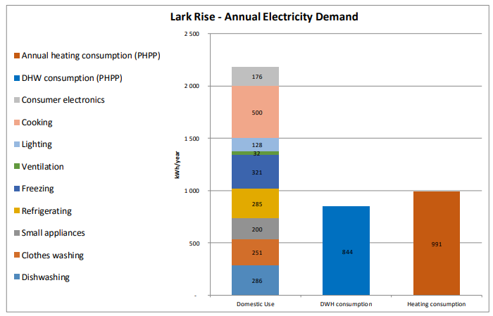

https://www.bere.co.uk/assets/NEW-r-and-d-attachments/Lark-Rise-Self-consumption-study-by-Energelio-160429.pdf is worth reading deeply if you're seriously considering going off-grid. It's the calculations for how close to autonomy you can get with a ~200m2 Passivhaus in the southern UK with 13kW of PV and a battery of varying sizes. Even with a very big battery (40 kWh in this case), in December it's still importing ~60% of electricity demand from the grid. Per PVGIS for Aberdeen, you'd need at least a 30kW ground-mount system to meet demand in December, which is the hardest month to handle - in the process producing 27,000 kWh nearly all of which would go to waste. You could probably downsize a bit as you're looking at a smaller house, but given how well insulated the example given is you're going to struggle with getting a 50% reduction without going full Passivhaus. Going off-grid with only PV and batteries in the UK is exceptionally hard. Assuming you need 500 kWh in December to give you some margin (most of the power coming from PV throughout the year), you only need a steady-state power of 700W to keep things going which isn't huge. Small wind turbines are very site-specific and a bit of a lottery though - average capacity factor seems to be in the 15-20% region (inferring you'd need ~5kW installed power), but can be very high or low. One interesting note - heating demand is 1000 kWh of electricity a year in this model and DHW another 800 kWh/year. Take that away and over an **average** year, you'll be able to run everything else 100% on PV. In the model the COP is assumed to be 2.8, so heat demand is 5100 kWh/year => equivalent to about 400 kg of Propane. So an LPG boiler plus standby propane-fuelled generator in case you get a week of miserable weather might be a decent option in your case. As noted the power draw will be very low from it - it's only there as a backup for the few times a year that the batteries run out and need a top-up, so fuel burn and running hours will be relatively low. Resale value is going to be higher on-grid and running costs a bit lower, but not shockingly so. It's really important that the house is very low-energy though - the cost per kWh of off-grid energy is much higher than on-grid. If it was my build, at £30k I'd go for a grid connection (mostly considering resale and the faff-factor), but if it ended up being a lot more (£50k+) then off-grid is feasible. -

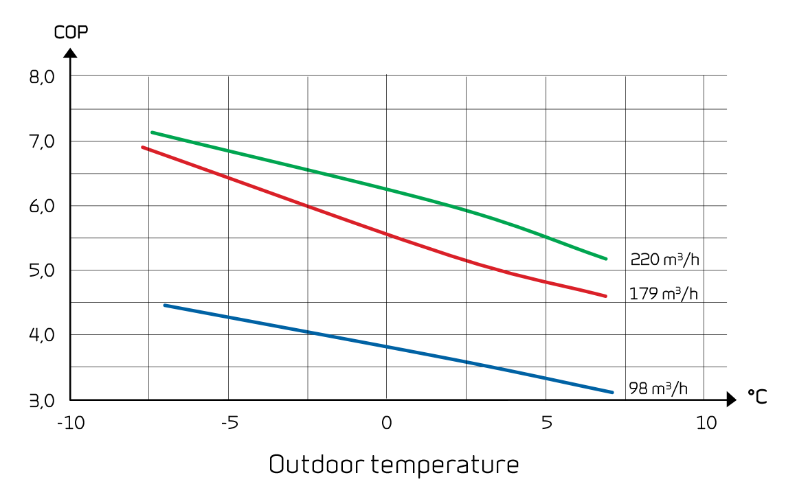

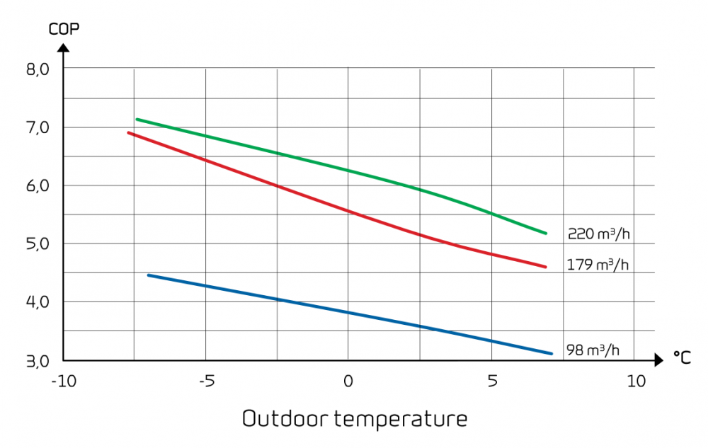

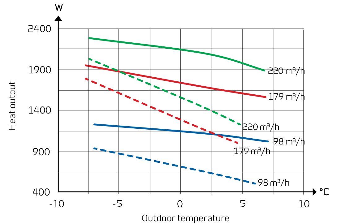

There is normal SCOP data out there for versions of it (AIR and GEO) - the other versions are an exhaust air heat pump only, which is essentially what @Gone West has done as I understand it with a similar system from a different brand. Since they use some of the waste heat for hot water, SCOP will vary depending on how much solar gain you have, etc. so I don't know if they can really calculate it sensibly. They have some under "Technical Data --> Planning Data" which nicely illustrates the problem - you get very high SCOPs because it isn't using the outside air as the only heat source, which is only achievable if you have significant internal gains. The cooling is linked to the MVHR system - as I understand it then it can cool the supply air to 10°C below the temperature of the return air. As it's a reversible system then it'll be broadly similar to the heating graph shown - without very high air change rates you're going to have less than 1kW of cooling. That might work in your situation (our PHPP says 600W of cooling is required for no overheating and never opening a window for ventilation), but will be heavily dependent on house design. Eventually decided against it because the hot water size is quite limiting (180 litres) and the extension tank makes for a very bulky system which doesn't fit well with our house design. Cooling is certainly possible in other ways - lots of people on here have used slab cooling very successfully (running cooled water through the underfloor heating pipes), and it's also possible to put a water-to-air heat exchanger in the MVHR supply duct to provide additional cooling.

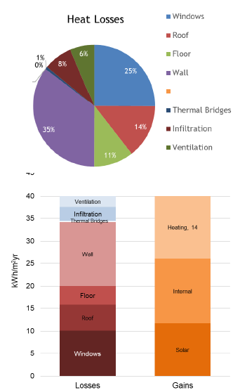

Assumption is that if we go for cavity wall we'll end up using standard concrete blocks and a wider cavity - 250mm is pretty straightforward and would leave us at something like 10 kWh/m2/year keeping the other assumptions the same. Aerated concrete blocks are what the architects had as their default in PHPP and because it worked really well first time they didn't worry about optimising it. We've clearly got plenty of headroom if we go down this route. No decision on cavity ties yet - not really needed at this stage, will look at this in detail later on if required. Because it isn't a tight site thicker insulation versus stainless ties is an easy cost tradeoff to make. Expecting to use wet plaster internally anyway rather than dot-and-dab, simply because it will feel more solid. Thinking is that this layer will end up with lots of holes in it (sockets, floors, etc.) and an additional airtight layer on the outside of the blockwork leaf will make life a lot easier - more upfront cost with reduced cost of rework later. Realistically I'm not going to be able to be sitting on them every day, so a more robust design is important. There's a trade-off here between cost and performance, which I'm trying to understand. You aren't going to have air moving up and down in a blockwork wall, instead it'll be pretty directly in to out through cracks, and two imperfect airtight layers are very unlikely to have the faults lining up with each other. For instance this means that there is no real need to seal around cavity ties perfectly with a peel-and-stick membrane if the rest of the wall is well covered. This increases the chance of getting things right first time.
Bumping this as we've just got the PHPP model back for a design nearly ready to go to planning, and cavity wall is looking a lot better than we thought it would. We're planning on a brick outer skin no matter what build system we use (cost + blending in with the rest of the village), and PHPP says that 200mm of Dritherm 32 plus aerated concrete inner blocks and a brick outer leaf is good enough to hit the targets since we've got a very good form factor (~0.15 W/m2K gets us to Passivhaus - the form factor is 2.4 which is one of the best the architects have seen for a Passivhaus). That starts to get interesting as any timber frame system with a brick outer leaf rather than slips is looking like >500mm rather than ~400mm. Airtightness is a significant concern if we go down this route because unlike the timber frames where there are a large number of companies with a track record of delivering a package which meets the airtightness requirements. A 200mm cavity is actually pretty close to a conventional build (150mm), so if there is a builder-friendly way of putting the airtightness barrier inside the cavity that would make getting good airtightness with non-Passivhaus focussed builders a lot easier since we'd only have to control penetrations and roof/window/door junctions. I'm aware of the use of painted on liquid membranes, and our architects have been playing around with some peel-and-stick membranes intended for this sort of application (probably something like this), as well of the use of a parge coat/wet plaster on the inside for airtightness which I'd prefer to avoid. Is anybody aware of any alternative solutions to achieve the same thing?
