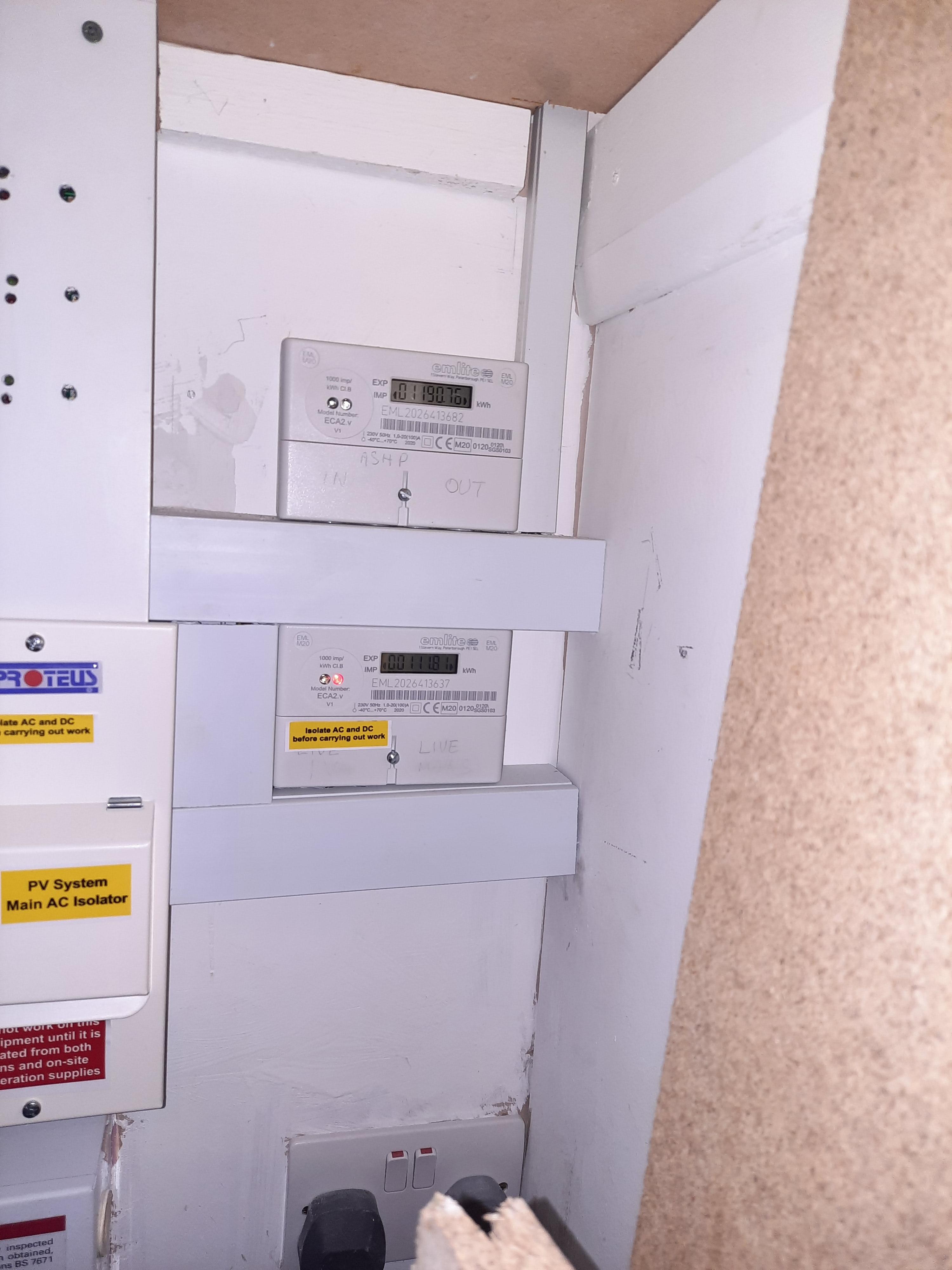

Having installed an electric meter for the ASHP the effect of changes can be measured on the amount of power used during similar weather days.  Also having used bottle gas for 3 years there are records of how much energy was used before the ASHP was installed for heating and hot water combined.
