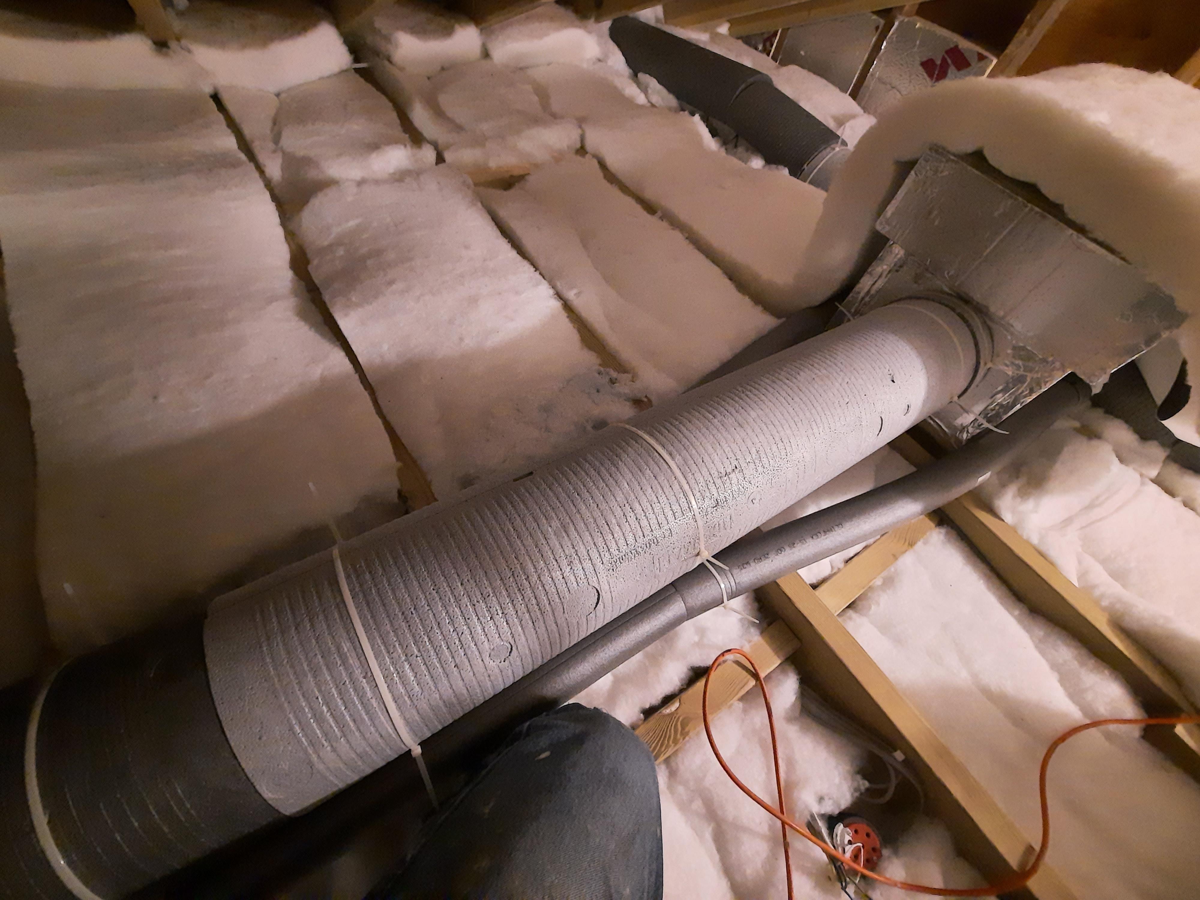

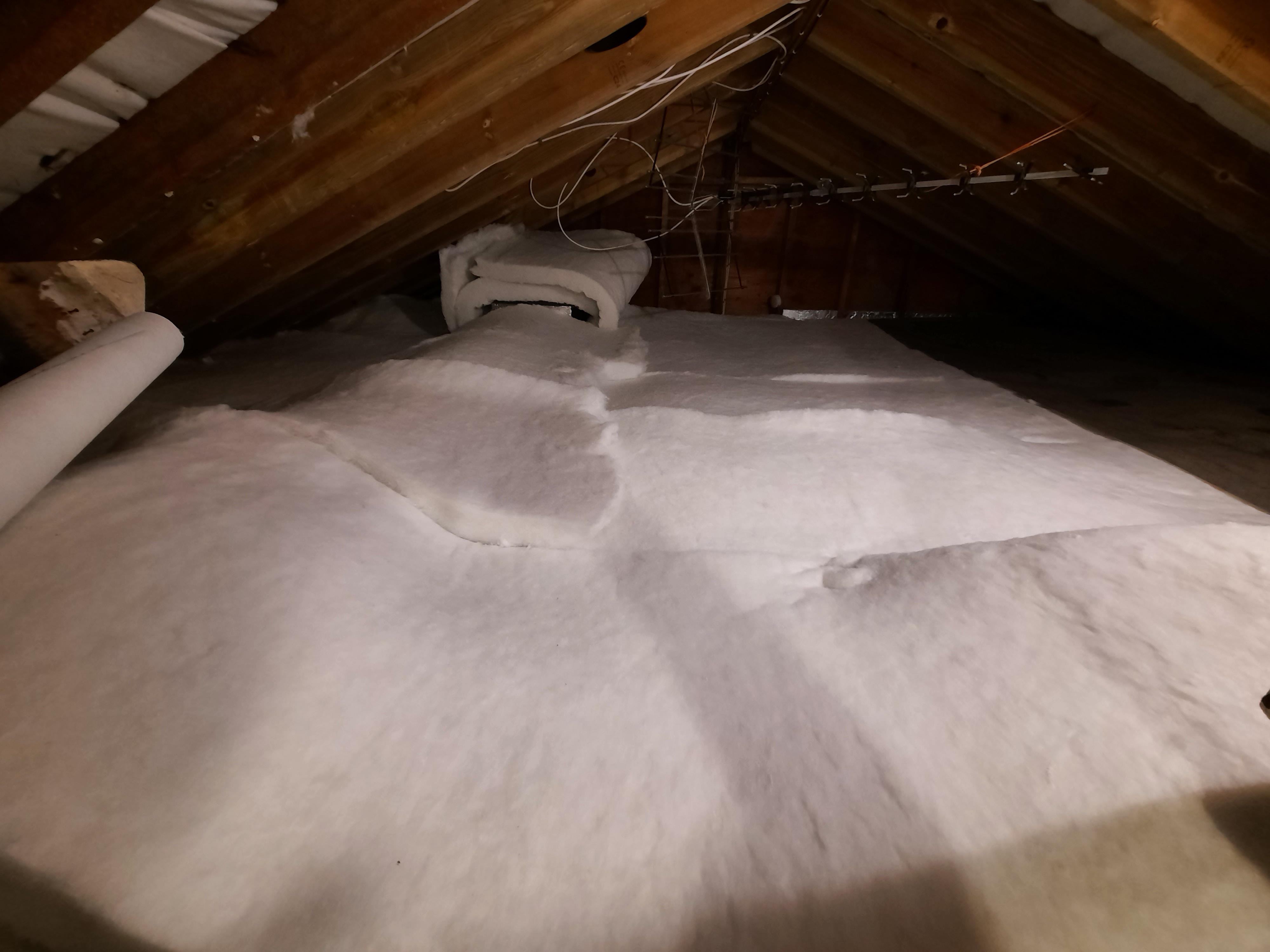

Well the ducting is all buried under a foot of insulation in the loft.
The coil boxes have also been covered more since the photo.
Noted the temperatures of the incoming air at the inlets in the ceilings against the outside temperature. Inside 20C ish, outside 7.8C, incoming air 20C ish.
By my calculations this seemed to good to be true and I realised, eventually, that the air was being warmed up as it passed along the ducts inside the thermal envelope of the building.

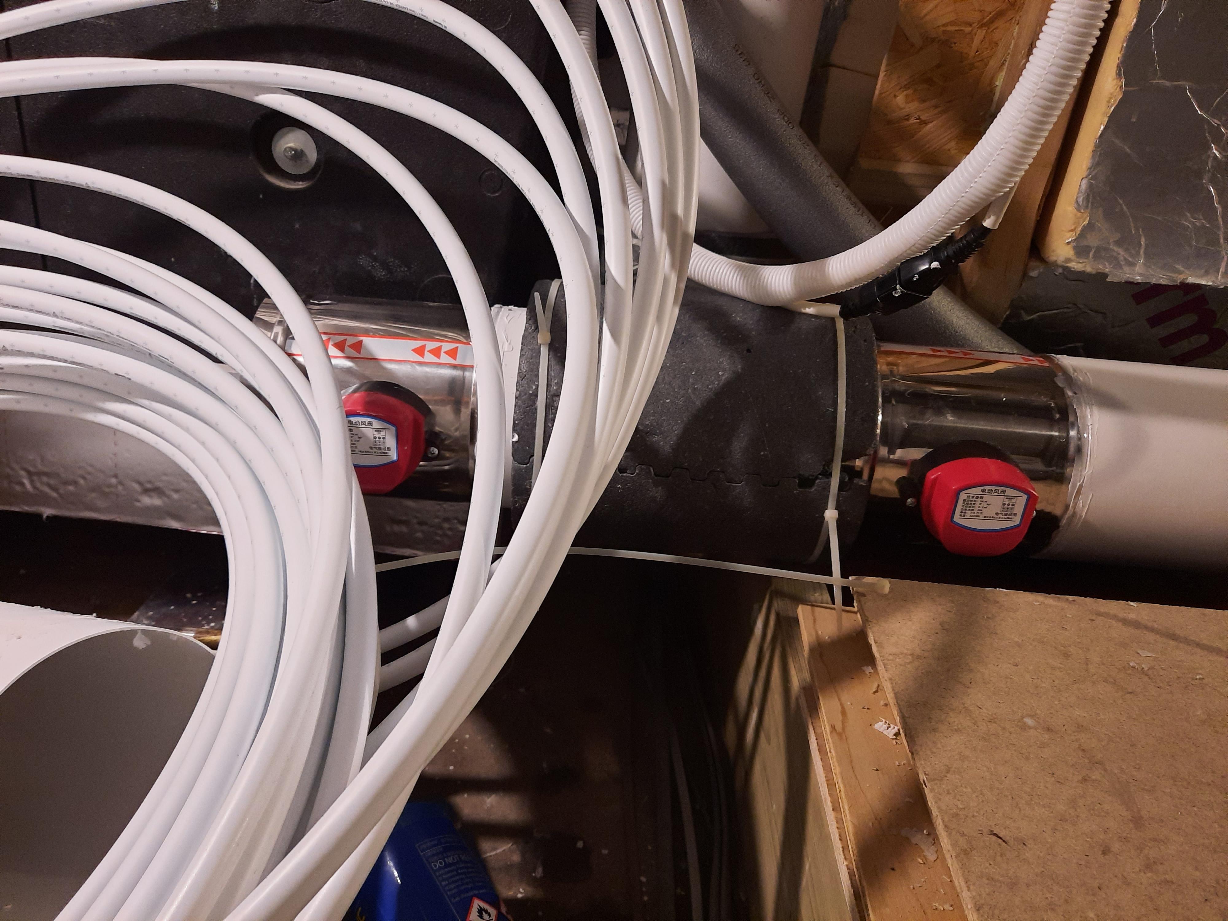

The coils definetly work. Ran one briefly as a test and the inlet air was 25C. Will need to wait for a much colder day to test them properly, but basic result was 14 litres a second gave a temperature rise of about 7C between coil on and coil off.
The pump for the radiators and coils has been set to maintain the same pressure as the flow increases and reduces as the TVRs open and close.  The flow to the coils will need to be adjusted as the return temperature is too high.
