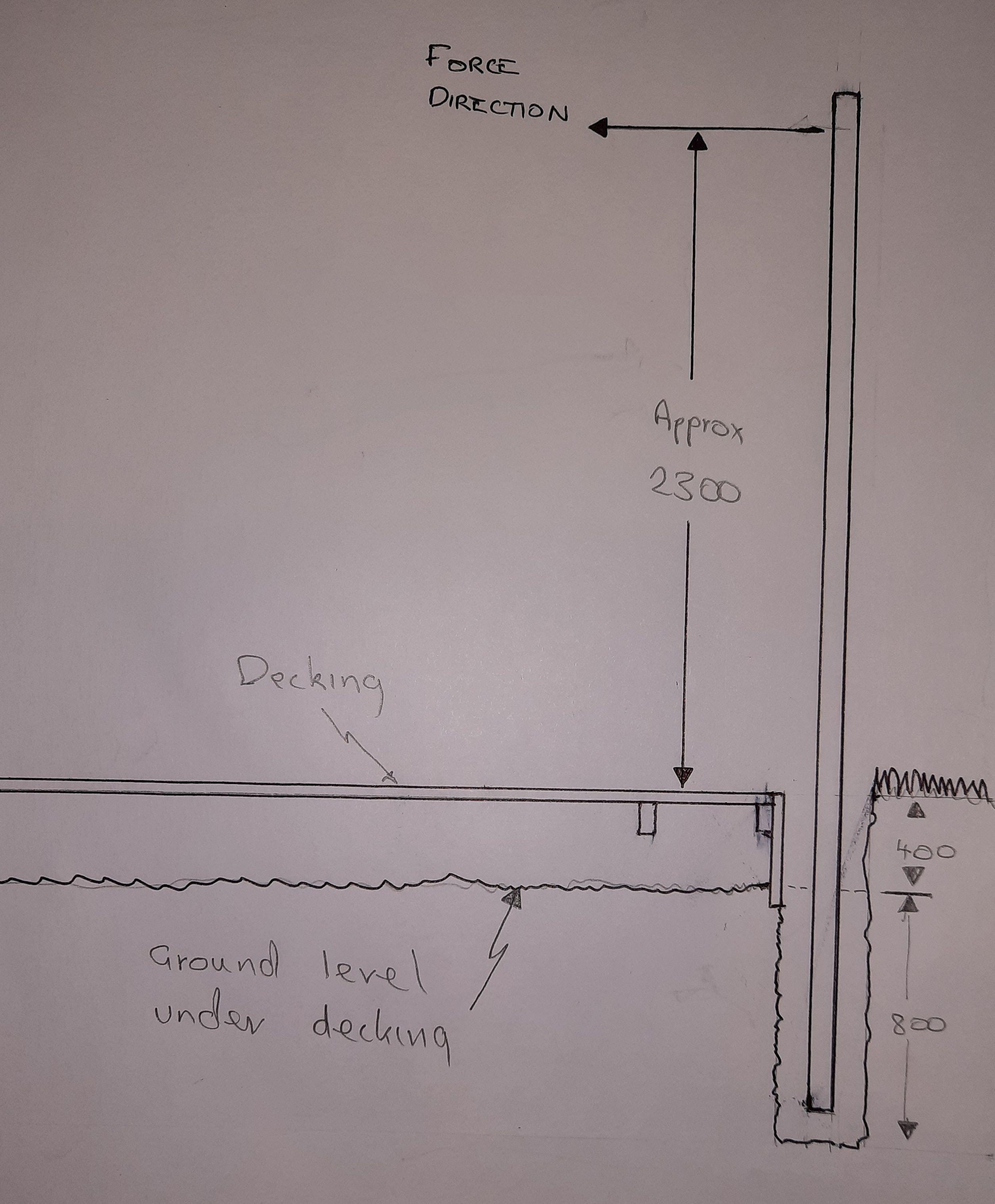

Steel post installation design. Help needed
Marvin replied to Marvin's topic in Landscaping, Decking & Patios
Hi @CarrerahillThanks for your info. I did think of moisture problems, that's why I was thinking of filling using a foam gun. No air inside no moisture inside? I did think of drainage at the bottom, However I was concerned with the water table.- No rain here for 7 weeks and the soil at 1.2m down is very damp. Would it rise up the steel box when the water table rose again....? -
Yes I do the same. 👍 -
Hi @Conor, Thanks. External metal all to be painted. Below ground. Good idea about the bitimous based paint. I will use it below ground. -
Thanks yes not structural. Has Postcrete the same density as concrete (i.e. not porous)? Would it be best to let the concrete rise up in the box steel or cap the bottom off? -
I have to fit two 3mm bare steel 80mm by 80mm box posts into the ground. There is no room for a base plate and bolts to fix them to a lump of concrete so I am going to treat them like fence posts. As the first 400mm down in the hole is unstable due to decking etc I have dug a hole 1200mm deep to take the posts. I am going to use Postcrete The posts will stand about 2400mm above the hole and have a horizontal force of about 60kg at about 2700mm above the solid ground. What are the best options to avoid the post rusting when its in the ground. Obviously painting the outside and covering the top. Paint the inside? Foam fill the inside? Concrete the inside? Cap the top and bottom? Vent the top to let humidity out but no rain in? Wrap the bottom in plastic but make sure no water can seep between the plastic and the metal? Suggestions please.
